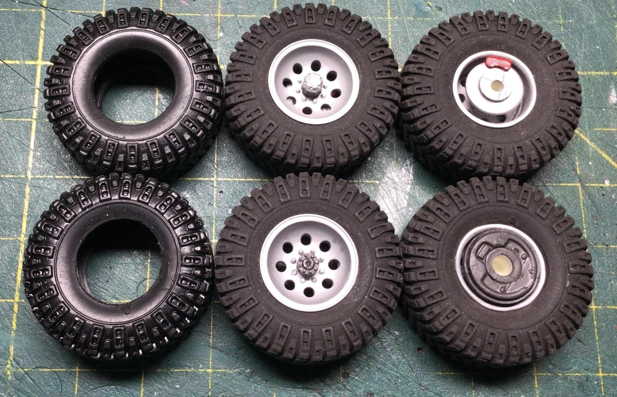

NOBLNG Posted November 17, 2022 Posted November 17, 2022 (edited) I have only done tires using crushed glass and low pressure in my blasting cabinet to get rid of the sheen. Edited November 17, 2022 by NOBLNG 1
