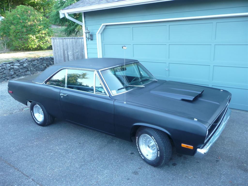

redscampi Posted November 21, 2022 Posted November 21, 2022 Guys, one of the things I want to do is to create a replica of most, if not all of the cars I've owned in my lifetime. One that I'm really interested in at the moment is my 72 Scamp. I know there are Dusters and Darts and Demons around, and I know of one Scamp in resin (Bandit Resin I think) but no one answers emails from that site. Gone? What kits would be the best donors to get the nose and rear sections from while remaining somewhat cost effective? Here's the car I want to replicate. It had a 360 in it and the rare-ish high back split bench seat. A car I should have never sold...
1972coronet Posted November 21, 2022 Posted November 21, 2022 With some cobbling, you could: 1.) Start with the Revell 1968 Dart (body, frame/suspension, engine compartment) 2.) Front clip from the AMT 1971 Duster 340 3.) Rear bumper/quarter panel extension from the MPC 1970 Dart (an 'exhibition' car; nowhere close to stock) 4.) Dash -at least the instrument panel- from the MPC 1975/1976 Dart Sport (mix & match with the Revell dash) 5.) 340 engine from the aforementioned '71 Duster 340 6.) Torqueflite from the Revell Dart big block or the AMT 1971 Charger R/T 440 Not sure how detailed you want to get with upholstery patterns -- you'll have to scratch build -at least partially- the front seat. the rearmost section of the trunk lid will need to be partly scratched. The hood scoop is available in resin (Hart's Parts, IIRC), as is a bench seat for the AMT '71 Duster 340. Stock -non-Sharktooth- grille is also available in resin (also from Hart's). I hope that this is of some help.
Oldcarfan27 Posted November 21, 2022 Posted November 21, 2022 (edited) Get the L.A. Dart kit. Bashing that with the AMT 71 Duster and the Revell 69 Dart should provide you with enough parts to build your replica. Best wishes. Addendum: just repeated the same thing that 72coronet said. Edited November 21, 2022 by Oldcarfan27
moparfarmer Posted November 21, 2022 Posted November 21, 2022 Nice car when you are done I expect but the high back bench seat was the base seat in the base Scamp..Optional seat was split with center armrest in deluxe interior..Sold those in the day..
redscampi Posted November 21, 2022 Author Posted November 21, 2022 Wow guys, very informative, thanks! Sounds like I need about 3 kits to get the basics and then do a bit of scratch building. Not opposed to that, just not sure of my skills in that regard. Thanks for pointing me in the right direction.
redscampi Posted November 21, 2022 Author Posted November 21, 2022 15 minutes ago, moparfarmer said: Nice car when you are done I expect but the high back bench seat was the base seat in the base Scamp..Optional seat was split with center armrest in deluxe interior..Sold those in the day.. Thanks for that info, did not know that. I do know I had to pay extra for the high back upholstery from whoever I bought it from at the time. I had a Dart parts car that had the center arm rest seat. Maybe I should have swapped it out.

1972coronet Posted November 23, 2022 Posted November 23, 2022 (edited) 17 minutes ago, Mopar maniac 74 said: I just ordered a scamp from bandit a couple months ago. Couldn't get an e mail either so called him. He called back had 1 in stock I sent him a check and 10 days later had a scamp. It is a nice body and fits the revell dart kit well. IIRC, that Scamp is based upon the Revell 1969 Dart GTS. I seem to recall that the Bandit Scamp has 1972 "universal" side markers on the rear (1971 markers on the front fenders). I'm sure that you're already aware of this, but the 1971-1973 Scamp and Valiant used the rear bumper and tail lamps from the 1970 Dart. The difference is the 1971 & later "Plymouth" bumper has slots for the bumper jack (and the battering ram bumper guards for 1973). In other words, the MPC 1970 Dart F/C bumper, etc., could be used on your Scamp build (no one will notice the lack of bumper jack slots). **[EDIT]** Here's a built-up of the Bandit 1971 Scamp (see link). Apparently, those rear side markers are correct for 1970-1971. I stand corrected. Bandit Resin - Gallery - 1/25 Scale Resin Parts and Accessories for Model Cars and Trucks (banditresins.com) Edited November 23, 2022 by 1972coronet

redscampi Posted November 23, 2022 Author Posted November 23, 2022 31 minutes ago, 1972coronet said: IIRC, that Scamp is based upon the Revell 1969 Dart GTS. I seem to recall that the Bandit Scamp has 1972 "universal" side markers on the rear (1971 markers on the front fenders). I'm sure that you're already aware of this, but the 1971-1973 Scamp and Valiant used the rear bumper and tail lamps from the 1970 Dart. The difference is the 1971 & later "Plymouth" bumper has slots for the bumper jack (and the battering ram bumper guards for 1973). In other words, the MPC 1970 Dart F/C bumper, etc., could be used on your Scamp build (no one will notice the lack of bumper jack slots). Thank you for the link and additional information. I suppose one could crate jacking slots in the bumper if so inclined.
