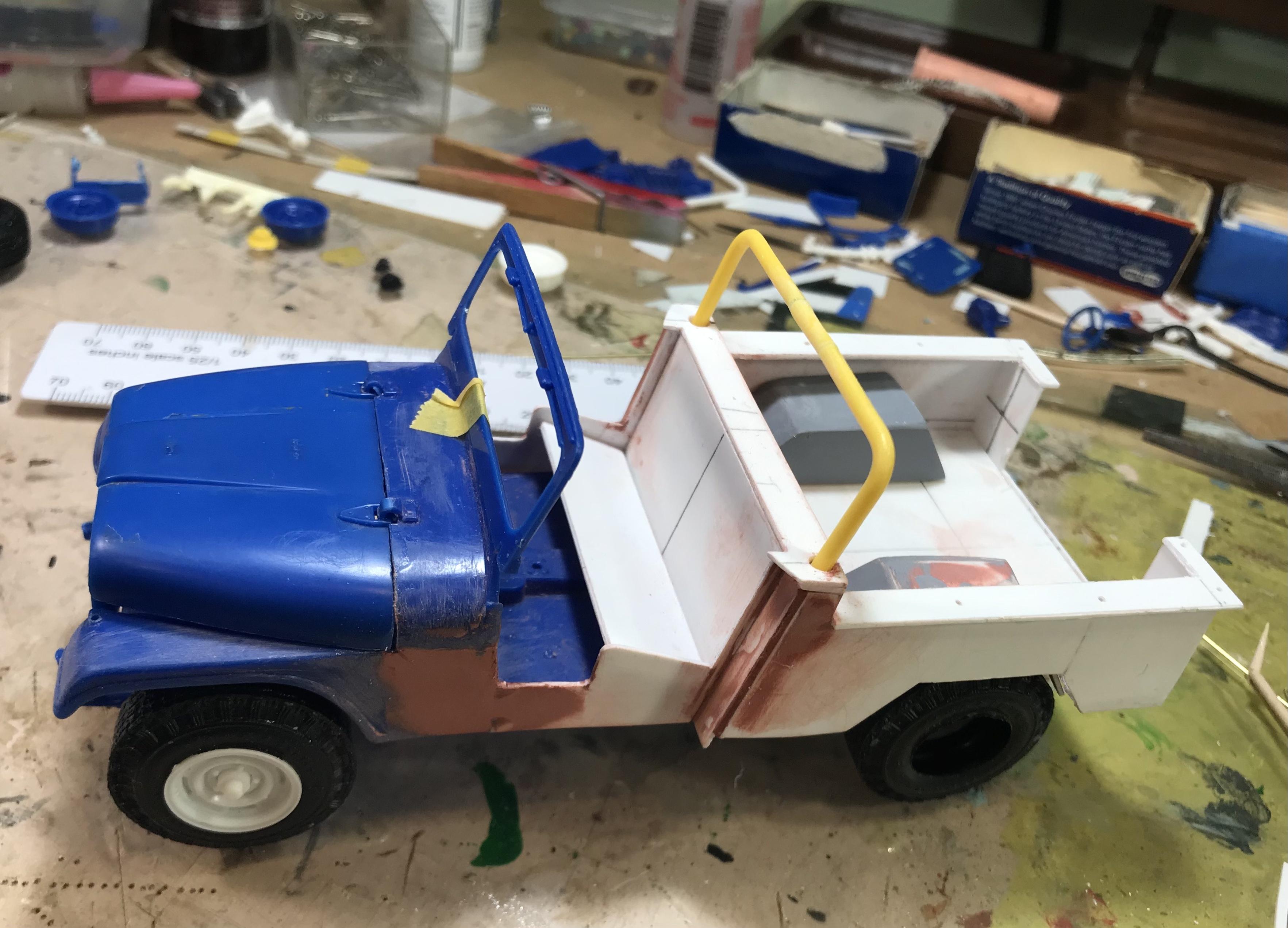

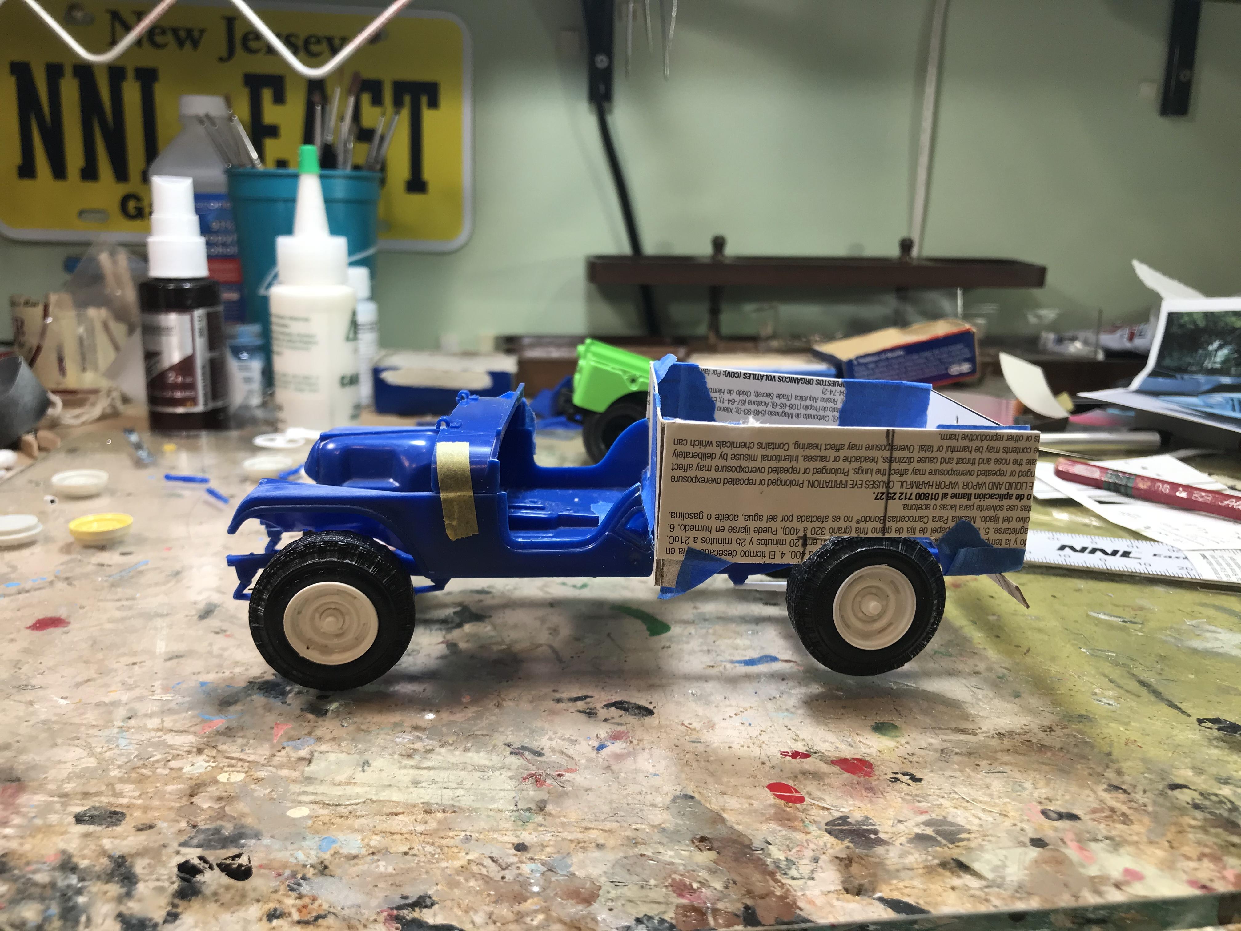

Tom Geiger Posted November 21, 2022 Posted November 21, 2022 You asked for tips on working with plastic sheets.. I love this old Jeep with a fabricated body. And it’s all straight lines! Step One- measure off your project. Then cut and assemble panels from cardboard. You have no real investment here, and you may have to do it several times. Save the expensive plastic sheet stock! Once you are happy with your cardboard mock-up, take it apart and use the individual pieces for templates to cut the plastic sheet! Hope this helps!

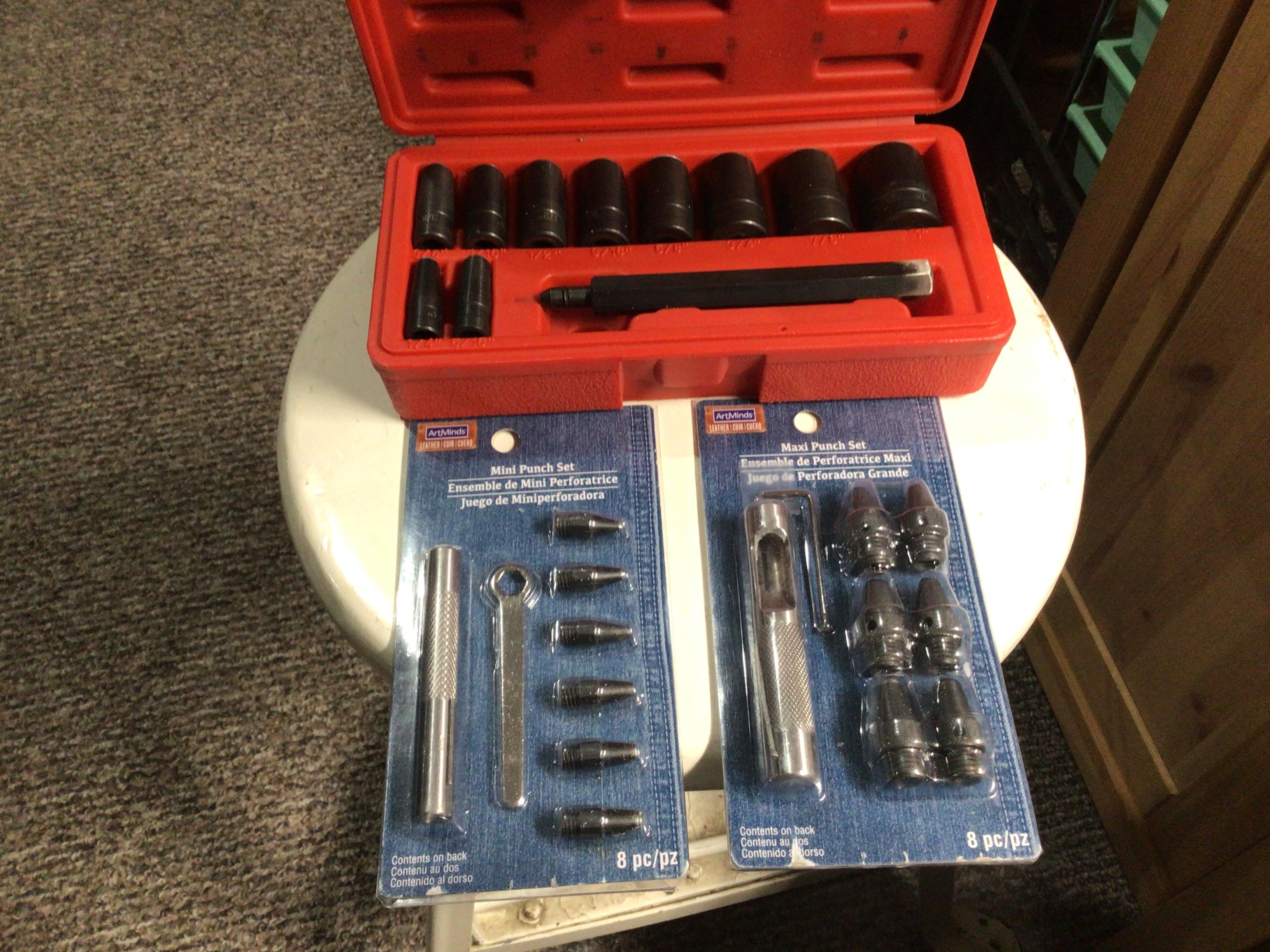

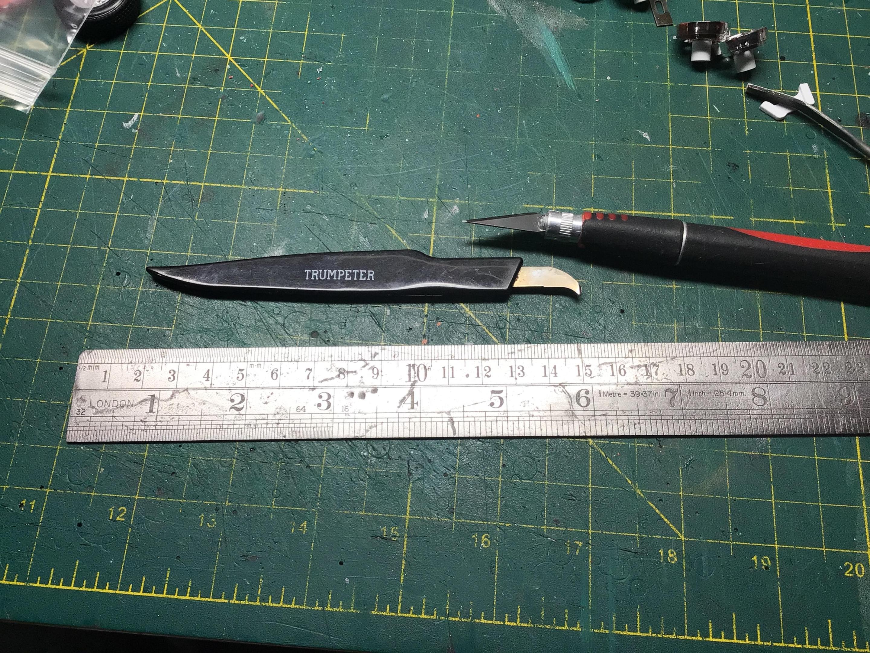

NOBLNG Posted November 21, 2022 Posted November 21, 2022 First, get a cutting matt if you don’t have one. Then a nice wide steel ruler for guiding straight cuts. You can use a scoring tool or the back side of a hobby knife for thicker styrene. Almost any cut won’t be perfectly square….so a large flat file can be used to square it up if necessary. A set of hole punches work best for perfectly round holes and discs. And like Tom says, cardboard templates are your friend.

TarheelRick Posted November 21, 2022 Posted November 21, 2022 Where did you find these punches. I have a set of the Harbor Freight ones, that I have had for several years.
NOBLNG Posted November 22, 2022 Posted November 22, 2022 2 hours ago, TarheelRick said: Where did you find these punches. I have a set of the Harbor Freight ones, that I have had for several years. The smaller Art Minds ones are from Michaels (leather working section). The larger ones I believe are from Princess Auto.
