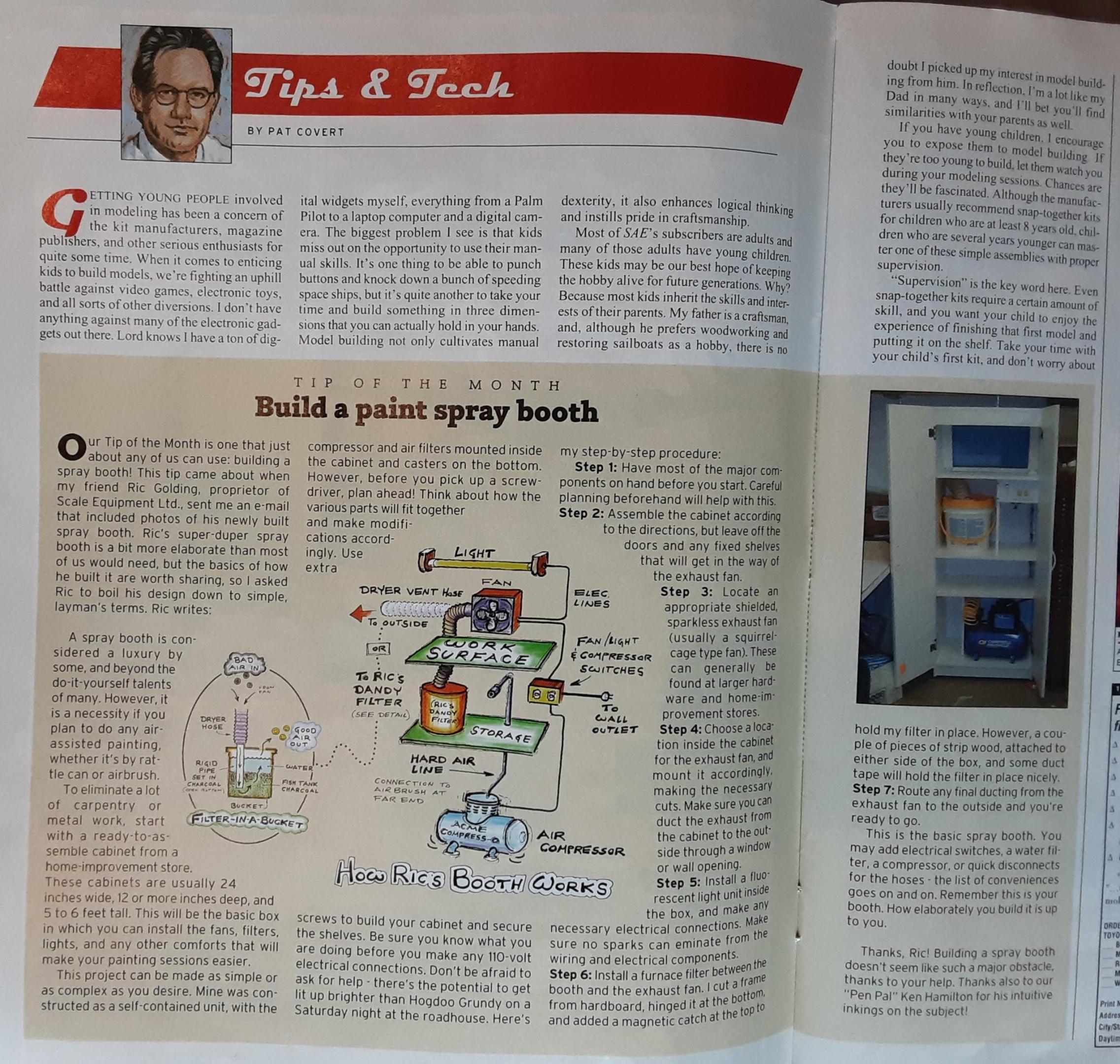

Mothersworry Posted April 18, 2024 Posted April 18, 2024 If yer a DIY type you could build a pretty nifty paint booth that does not require outside venting. In Scale Auto Enthusiast magazine, issue number 135, January 2001 on page 22, Pat Coverts Tips & Tech column detailed building a self contained paint booth. The fish tank type filtering system is pretty clever Fer what it's worth... Administrator....I don't know about copy right laws but I don't think posting the article here is a violation of some law, if I'm mistaken please delete. 1
