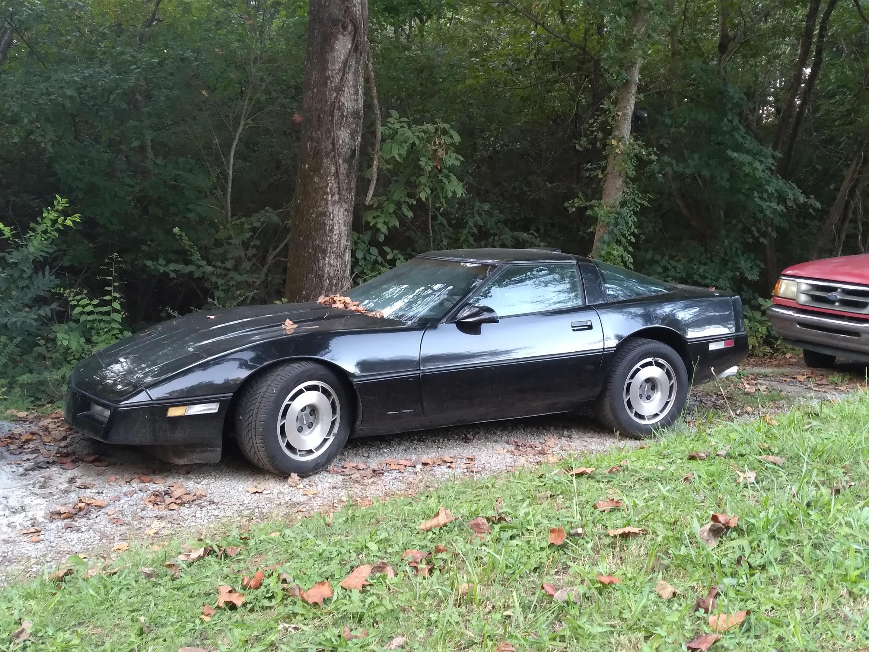

Scott8950 Posted November 25, 2022 Posted November 25, 2022 5 minutes ago, Can-Con said: It's just a base model 305. ? I owned a 85 and a 89 years ago both were fun cars. Now I'm tinkering with this, it's stock at the moment with a few upgrades coming. 1
Can-Con Posted November 25, 2022 Posted November 25, 2022 1 minute ago, Scott8950 said: I owned a 85 and a 89 years ago both were fun cars. Now I'm tinkering with this, it's stock at the moment with a few upgrades coming. Nice!. I like those mid-'80s Vettes a lot and black is the perfect color for them.
Scott8950 Posted November 25, 2022 Posted November 25, 2022 2 hours ago, Can-Con said: Nice!. I like those mid-'80s Vettes a lot and black is the perfect color for them. Thanks. I'm a 80s car fanatic. This car is a 87 with 63k miles.
