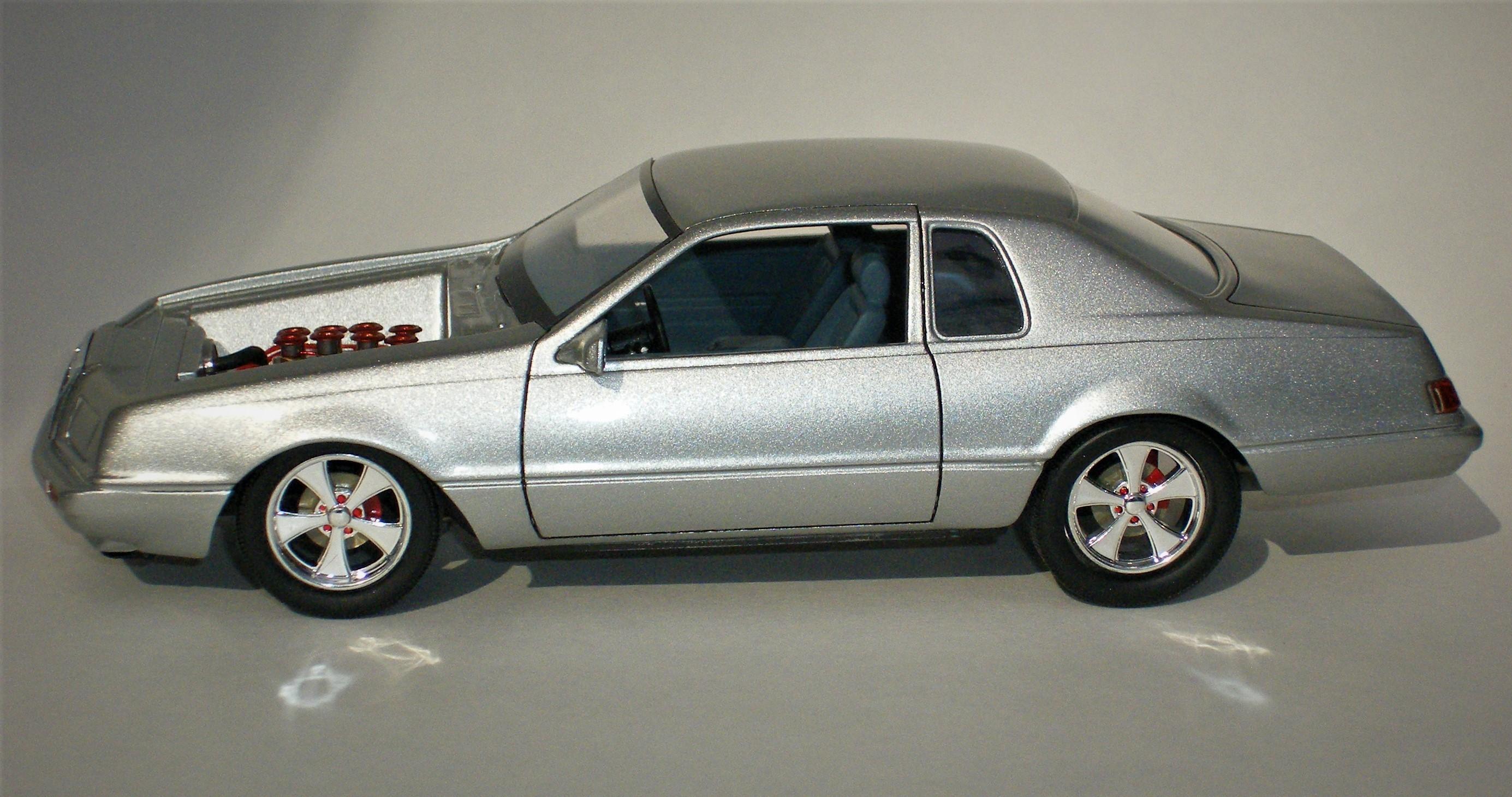

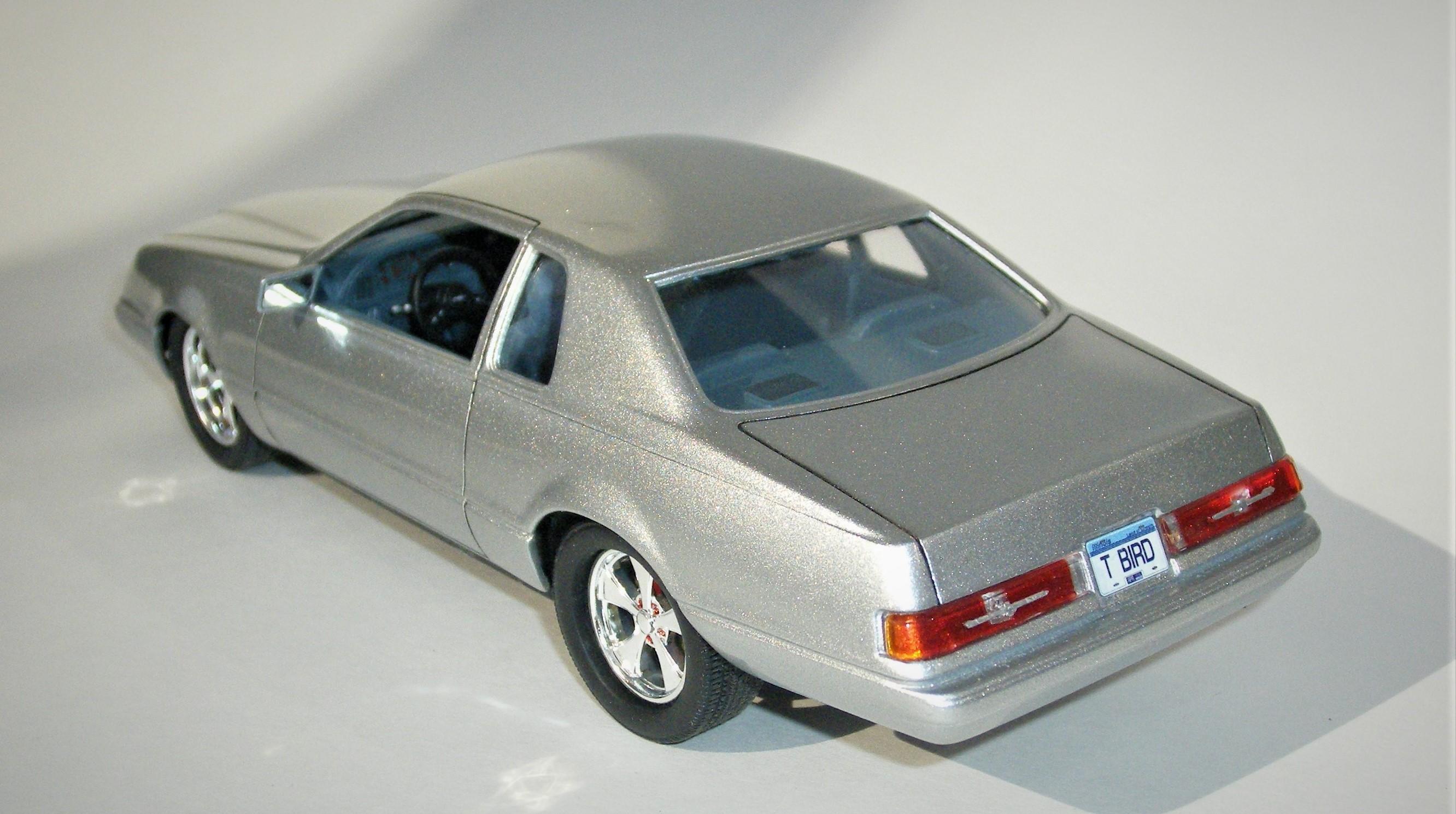

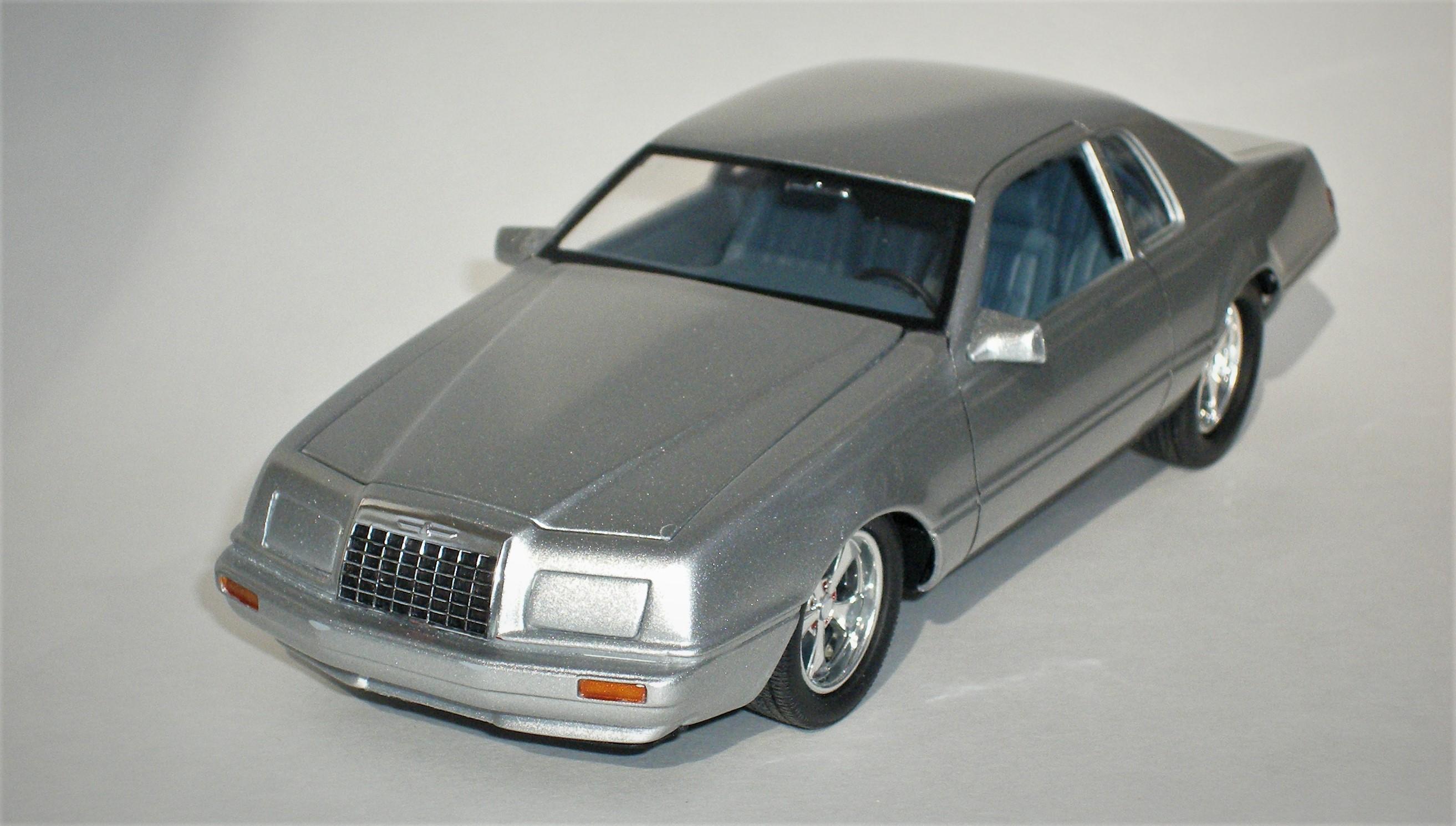

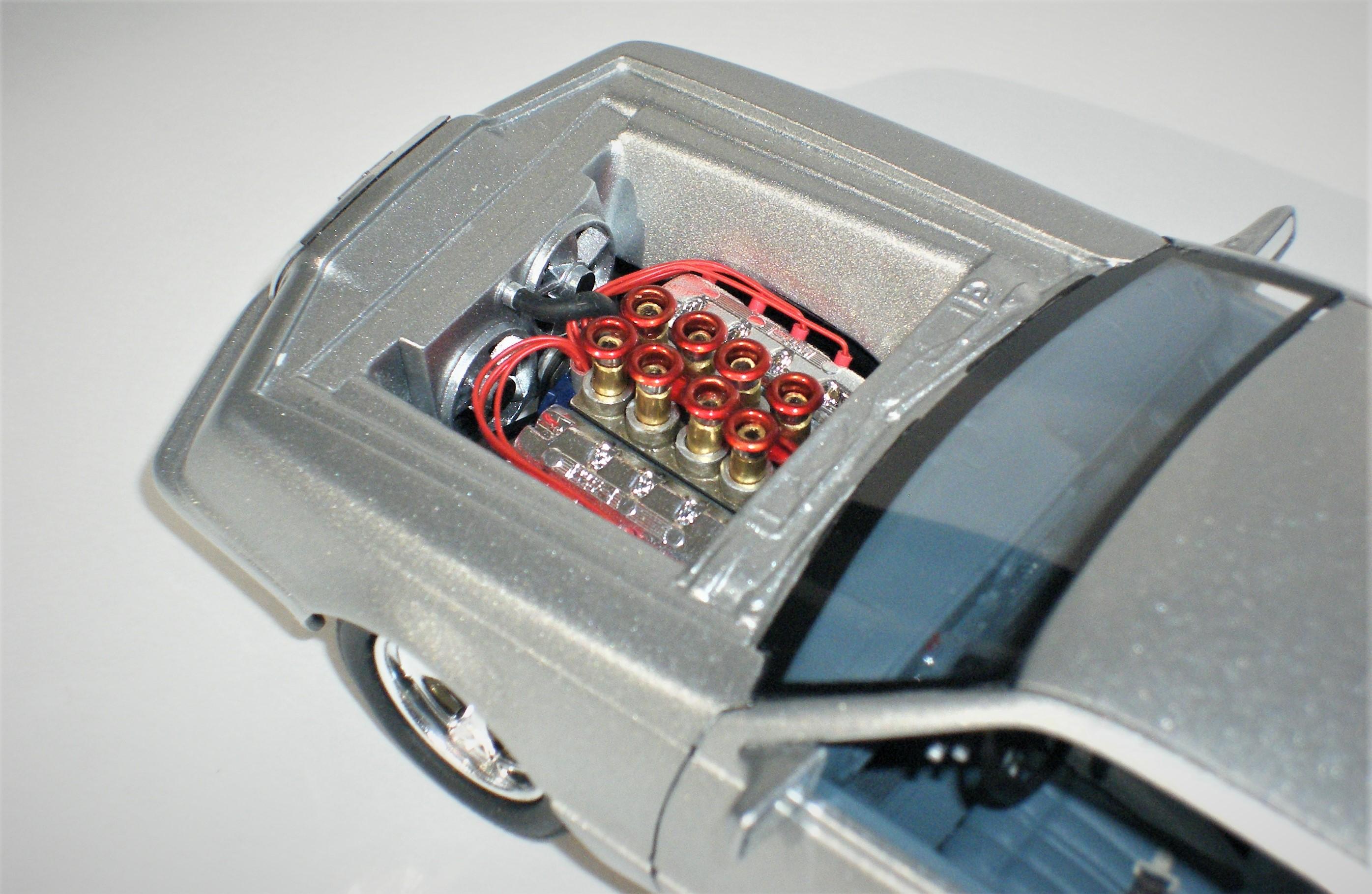

Claude Thibodeau Posted November 24, 2022 Posted November 24, 2022 Hi Zenon! I did just that a few years ago (see pix below). I transplanted the 87 chassis/interior AND rear quarter wheel openings on the Monogram 85 TBird pro-stock body. I customized the front end with hidden headlamps, and threw in a 429 Boss with scratchbuilt injection for fun. The bodywork required to blend the lower quarter panels on the Pro Stock body took some time, but it fits. Good luck with your project. I did mine because I had an 85 1/1 Turbo coupe back then. Nostalgia... CT 1

Claude Thibodeau Posted November 25, 2022 Posted November 25, 2022 13 minutes ago, Zen said: Please dig out your old attempt at this, would love to see it. Claude, your T bird looks very cool. I have a real 86 that I would like to replicate. Hi Zenon! Thank you. Whatever you attempt, stay away from swapping an 83/86 roof on an 87/88 body. Much easier to just fit the rear wheels opening: the roofs are substantially differents, notably the rear window and pillars. And the trunk lid. Good luck! CT

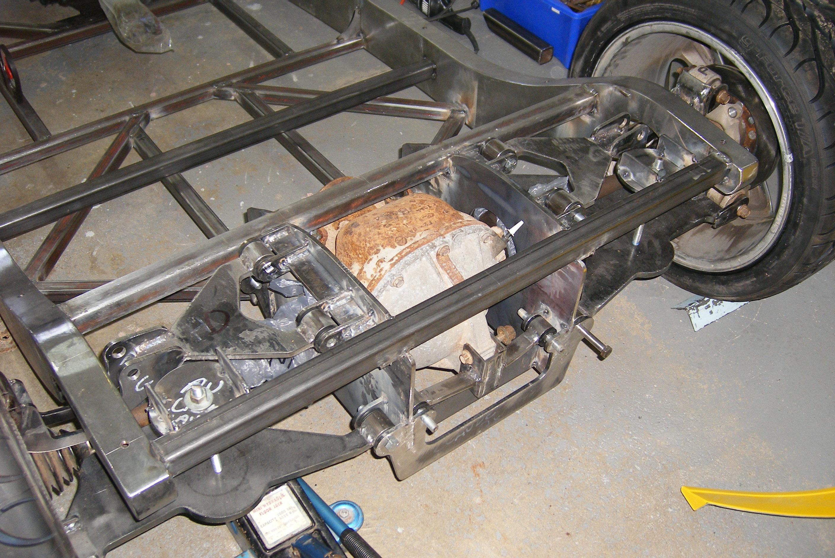

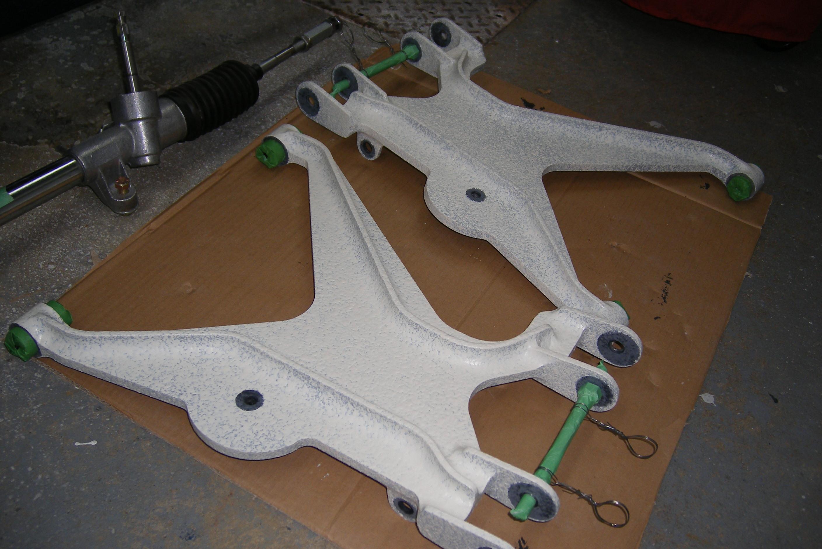

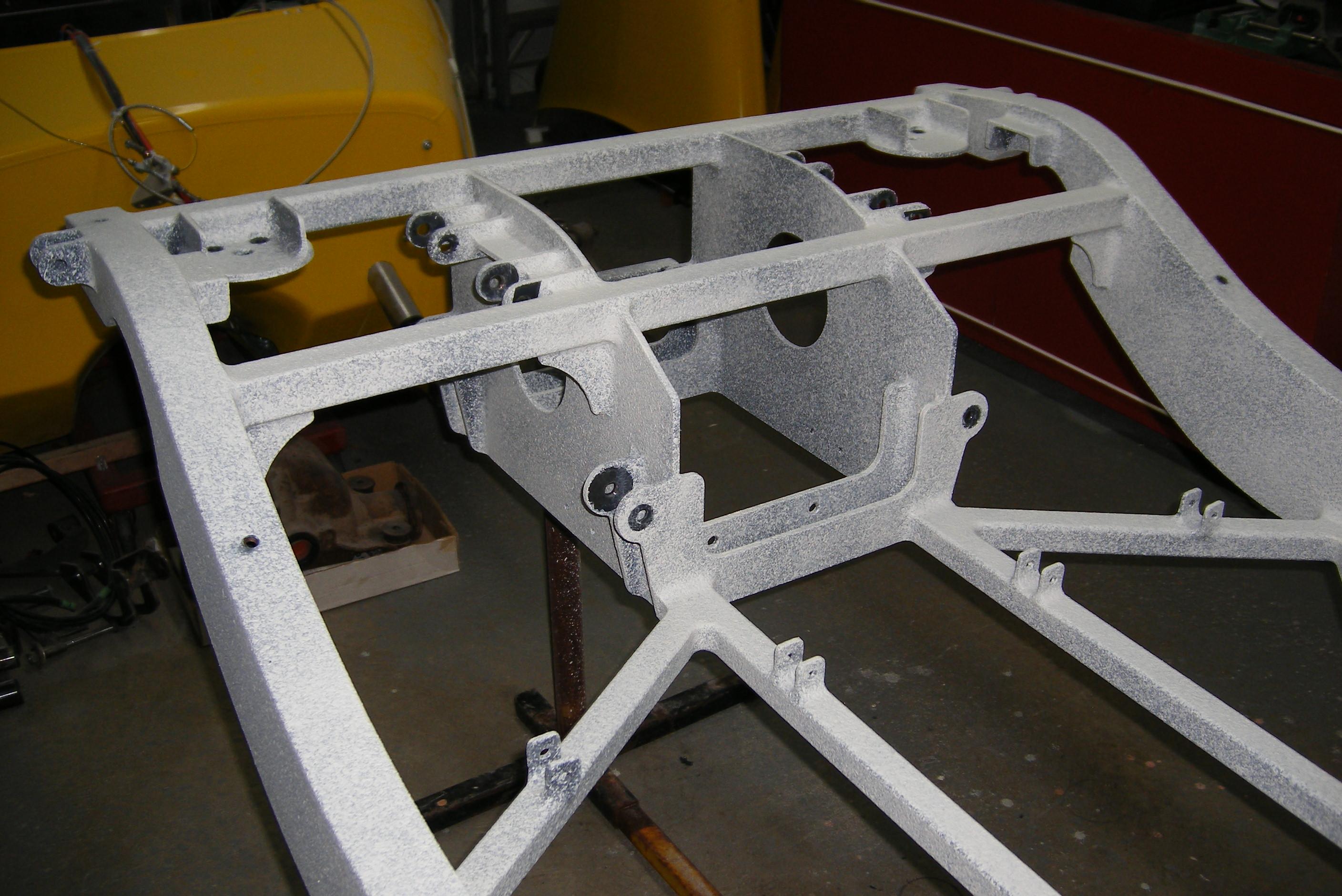

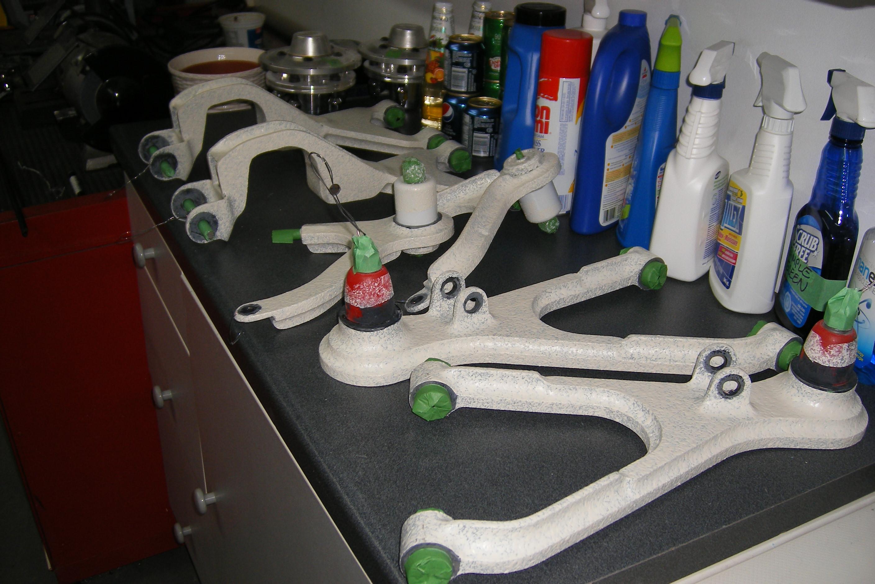

Claude Thibodeau Posted November 25, 2022 Posted November 25, 2022 13 hours ago, stinkybritches said: 1989 was the first year for the IRS. I had an '88 with the 5.0. It was a nice enough car, but nowhere near as nice as the '90 Super Coupe that replaced it. The ride and handling was night and day different between the solid rear axle '88 and the IRS '90. Hi Rob! That IRS was primo material for putting a real cheap IRS on a 1/1 rod. I did it on a 33 roadster, building custom upper and lower arms (the OEMs are extremely heavy, so). See for yourself... CT

mk11 Posted November 28, 2022 Posted November 28, 2022 On 11/24/2022 at 1:43 PM, Claude Thibodeau said: Hi Zenon! I did just that a few years ago (see pix below). I transplanted the 87 chassis/interior AND rear quarter wheel openings on the Monogram 85 TBird pro-stock body. I customized the front end with hidden headlamps, and threw in a 429 Boss with scratchbuilt injection for fun. The bodywork required to blend the lower quarter panels on the Pro Stock body took some time, but it fits. Good luck with your project. I did mine because I had an 85 1/1 Turbo coupe back then. Nostalgia... CT Beautiful work on those quarters, Claude. If there's any color that would put bodywork to the test, you certainly picked it.
Claude Thibodeau Posted November 29, 2022 Posted November 29, 2022 2 hours ago, mk11 said: Beautiful work on those quarters, Claude. If there's any color that would put bodywork to the test, you certainly picked it. Hi Mike! Thank you. Indeed, there is so much sparkle in that Diamond Dust Testor's lacquer, that you are right: the slightest glitch or wave will show. Oh well... CT

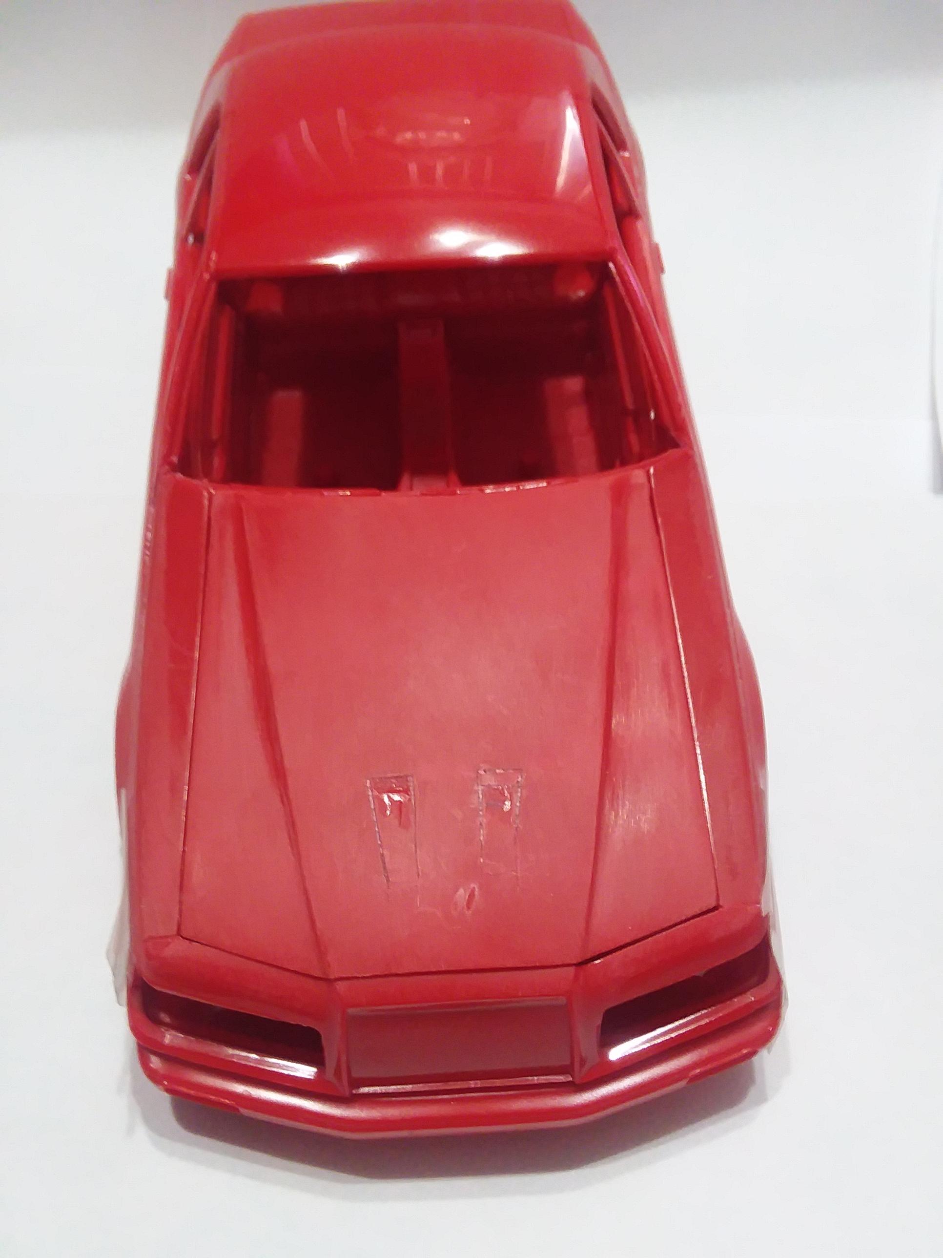

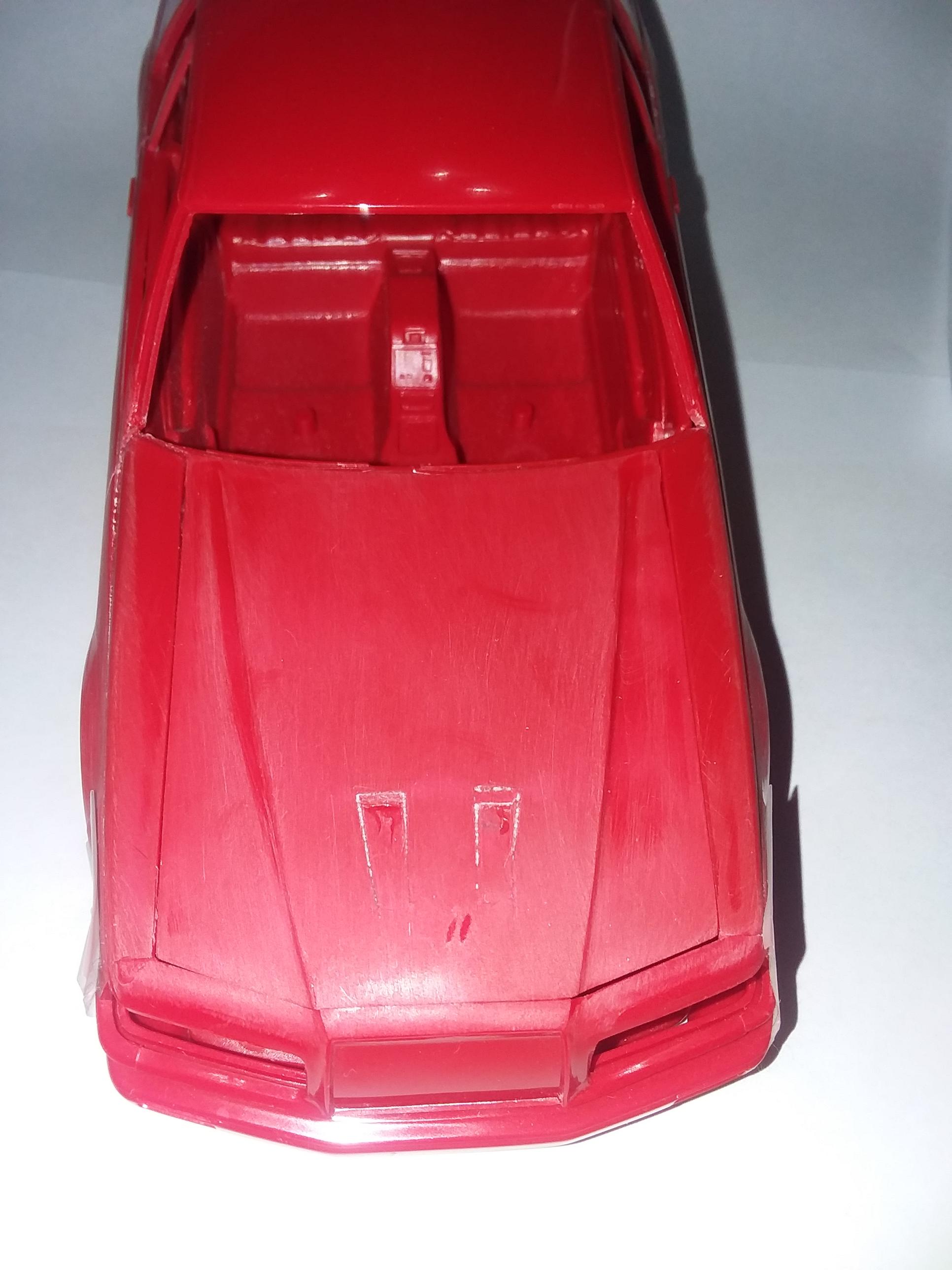

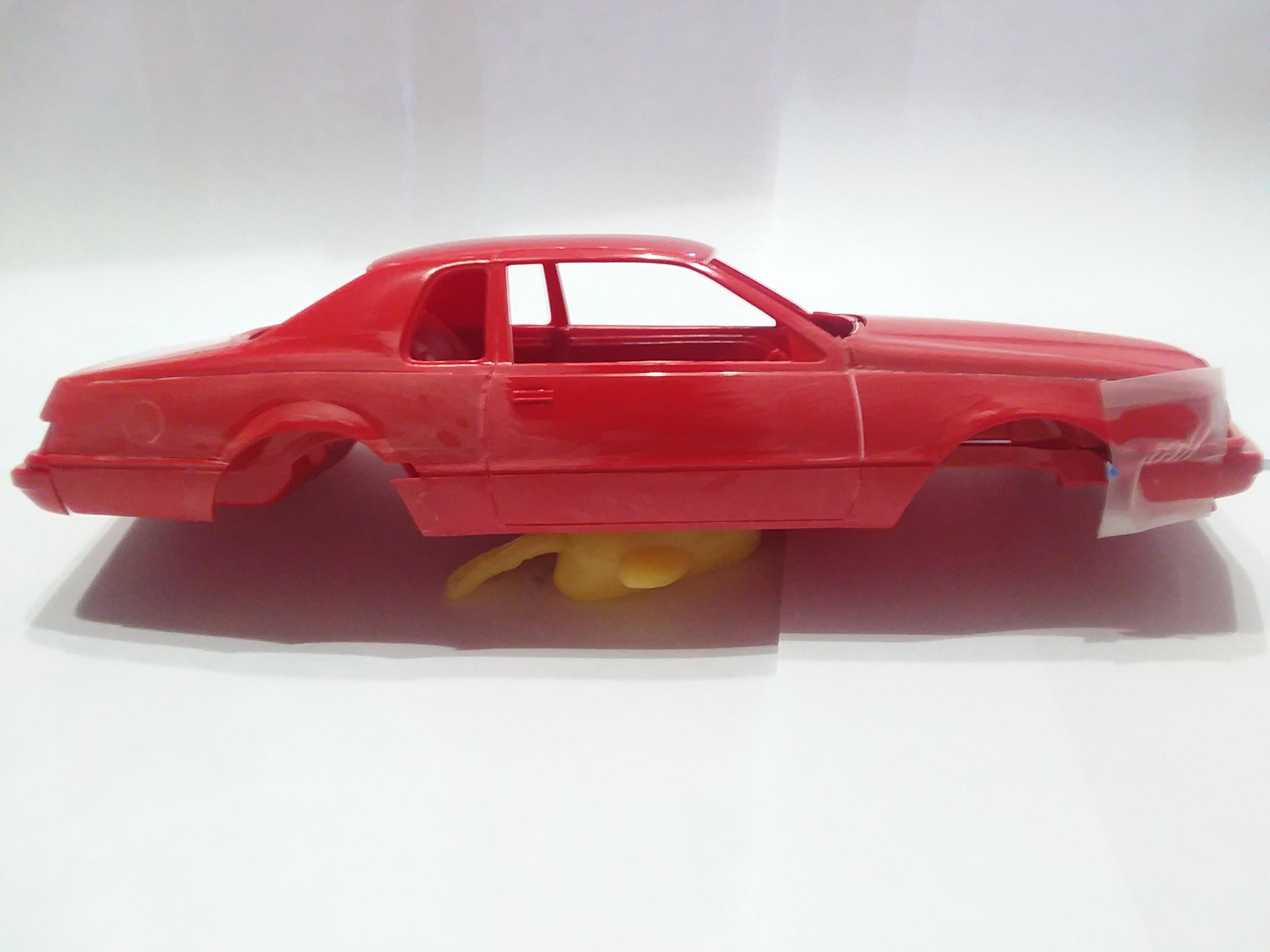

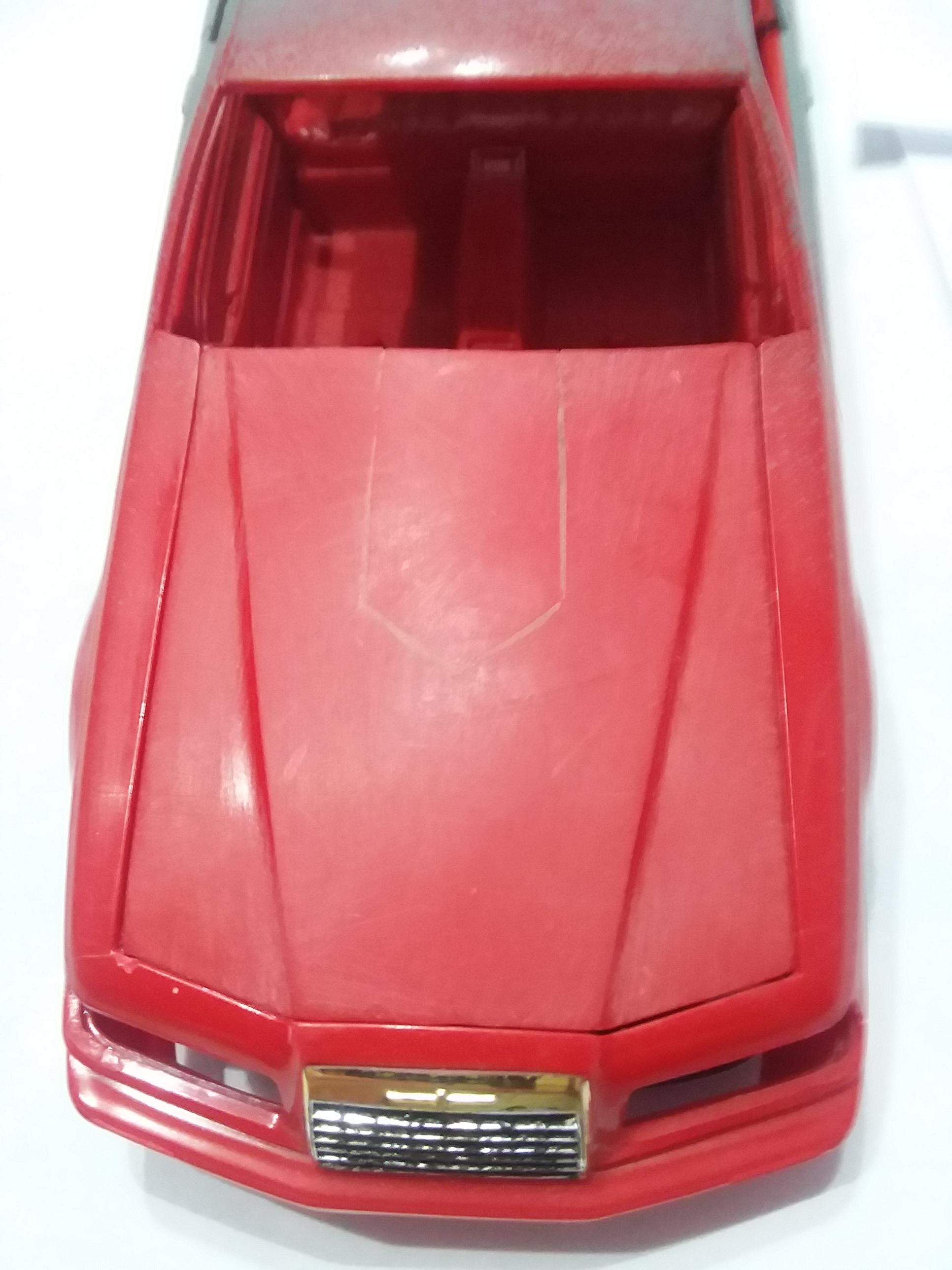

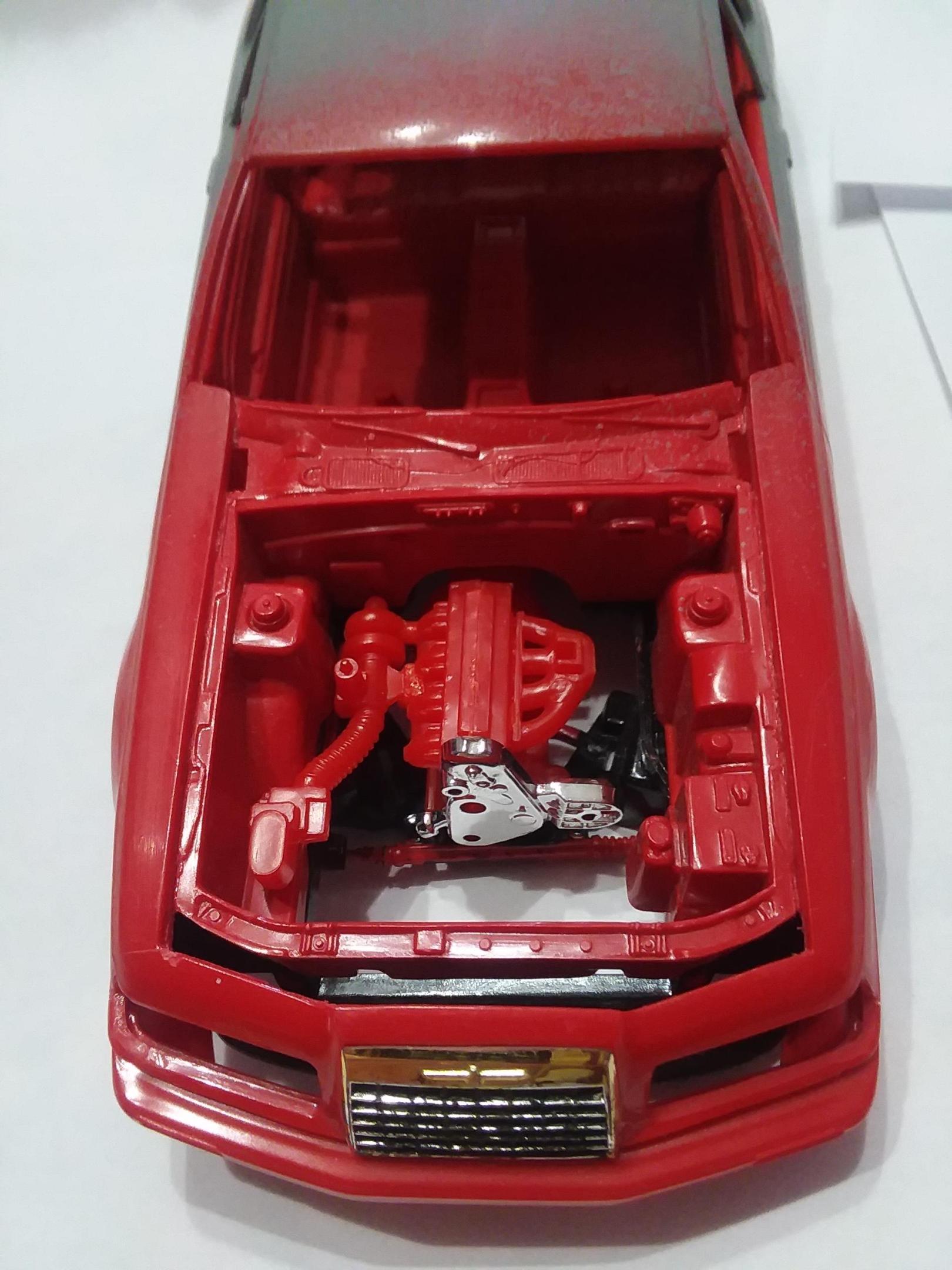

Oldcarfan27 Posted December 5, 2022 Posted December 5, 2022 (edited) Here's my two projects. The first one has the primer on it and was started 30 years ago after seeing the article in a model mag from way back when. I think it was written by George Bojacuik. Project stopped because of the lack of Ford 10 hole "phone dial" wheels at the time and I couldn't think of how to make the side trim look correct. I now have 2 sets of the wheels. The other was a reboot build. This time with the entire underhood piece including the fender tops and a different take on making the smooth hood. Edited December 5, 2022 by Oldcarfan27 2

Oldcarfan27 Posted December 5, 2022 Posted December 5, 2022 2 hours ago, Zen said: Interesting........... So, are both attempts based on using the 86 pro stock body with the rear 87-wheel wells/quarters swapped? Correct. Look closely and you can even see how I did the cuts.
