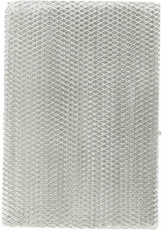

Fat Brian Posted November 26, 2022 Posted November 26, 2022 They make this aluminum sculpture mesh, it's very fine and soft to conform to surfaces. I might try copying a body with this stuff then trying to deform it. Once it's crumpled to your desired crumpliness you could cover it with something to replicate the sheet metal.
ABC Auto Industry Posted November 27, 2022 Author Posted November 27, 2022 (edited) 43 minutes ago, Fat Brian said: They make this aluminum sculpture mesh, it's very fine and soft to conform to surfaces. I might try copying a body with this stuff then trying to deform it. Once it's crumpled to your desired crumpliness you could cover it with something to replicate the sheet metal. That's an interesting idea too, and it sounds a bit simpler than the epoxy trick. My only concern is if it'll hold the weight of the truck, and given how big and bad this truck is going to be, that's important to me. EDIT: On second thought, considering there'll also be other car parts under the body like an engine, interior bits and what have you, I might just go with it. Edited November 27, 2022 by ABC Auto Industry
