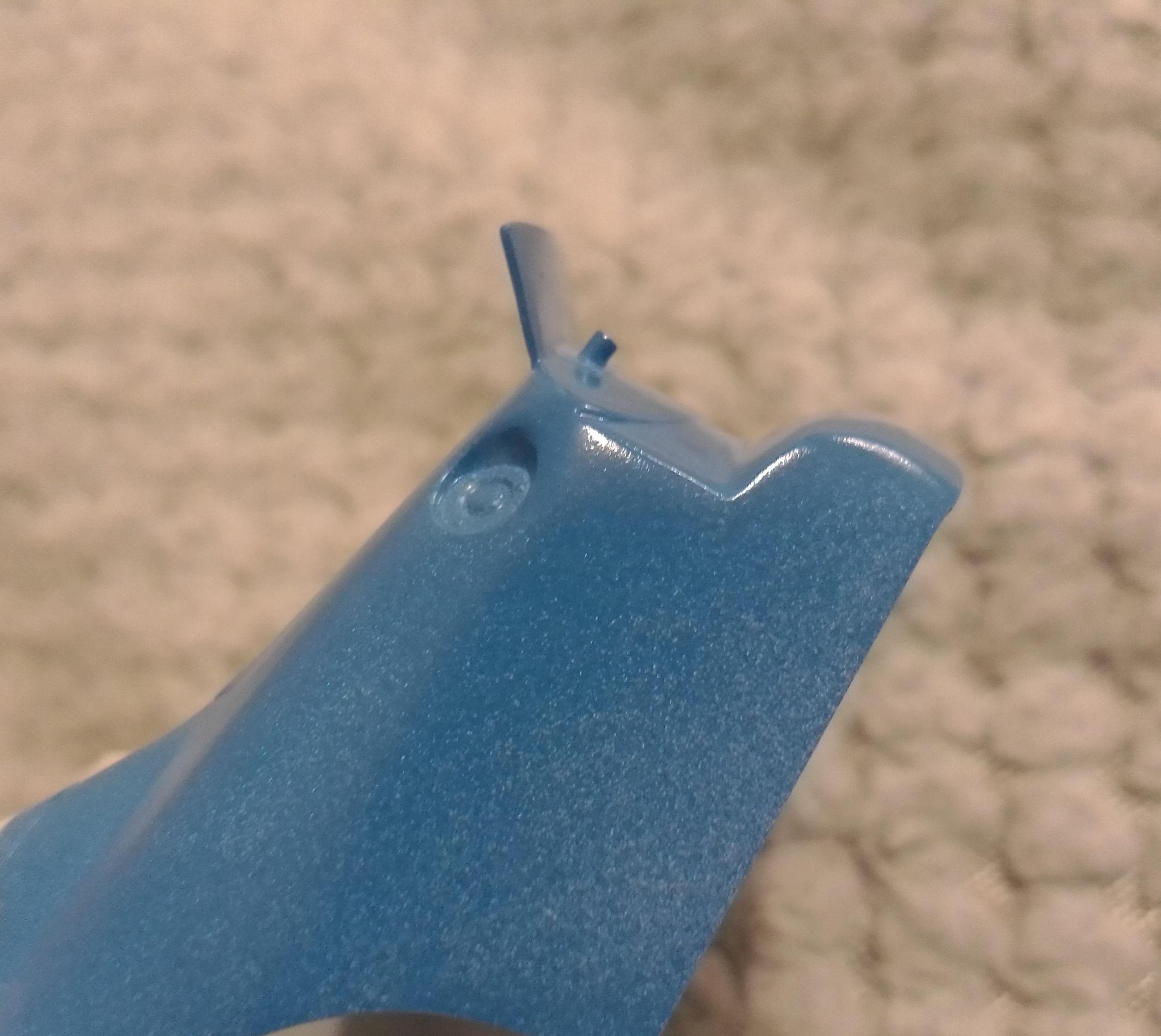

D.Pack Posted November 26, 2022 Posted November 26, 2022 Hi everyone. A new forum member from UK with a first post on how to proceed with sanding out faults. Never had to (or cared to) do this before. So, I stopped to spray this bodyshell as I had some debris in the paint. No problem, I'll just sand it out, but then how much to continue sanding? You can see the primer showing, is this normal when builders are sanding between coats? How is the new paint going to lay?
OldNYJim Posted November 26, 2022 Posted November 26, 2022 You’ll definitely see the primer pop through if you’ve only laid a light coat on and then sanded back a little - doesn’t look like any cause for concern from this end If you were painting something transparent colored (a candy, or something that doesn’t cover very well and requires multiple coats) then you might have more issues, but that color you’re using looks pretty opaque. When I get a little dust or grit in my paint I’ll sand back to where it’s smooth and then carry on where I left off - no biggie (and best to fix it now rather than try burying it and ending up with a mess) 1 2
Rick L Posted November 27, 2022 Posted November 27, 2022 In my own experience, I agree with this. I prefer using lacquer when painting bodies. I carefully watch for dust on each pass of spray. And if I see any trace of dust, I stop immediately. You can’t bury it with more paint. Flash it with air if possible and wait for it to dry completely. When dry I can usually flick the dust off with 500 grit paper and continue with minimal damage. 1

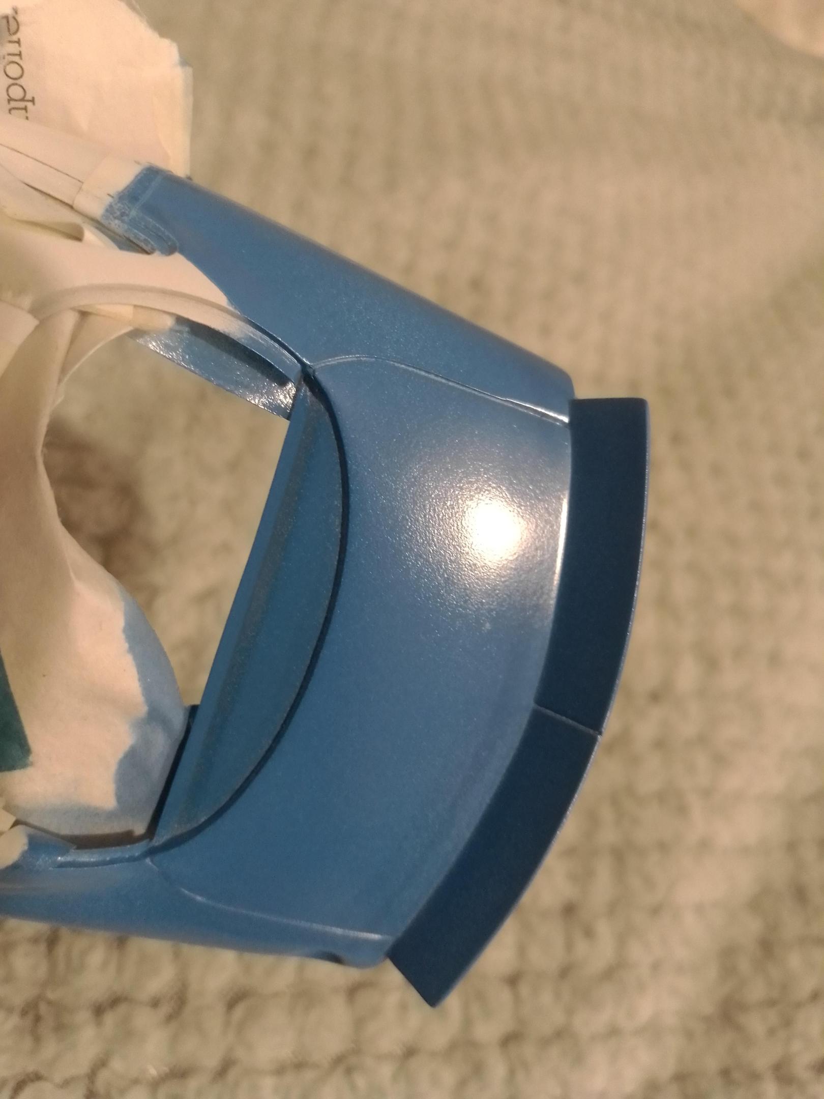

robdebie Posted November 30, 2022 Posted November 30, 2022 (edited) Not a straight answer to your question, but still a solution: with the technique shown in the video link below, I learned how to paint a body super smooth without orange peel in one go. No sanding between coats required. The Paasche H (or equivalent) is essential I believe, it doesn't work with a more sophisticated airbrush. https://www.youtube.com/watch?v=lCKZ_fo4eW0 Here are some test parts that I painted with various brands of enamel paint. Rob Edited November 30, 2022 by robdebie
