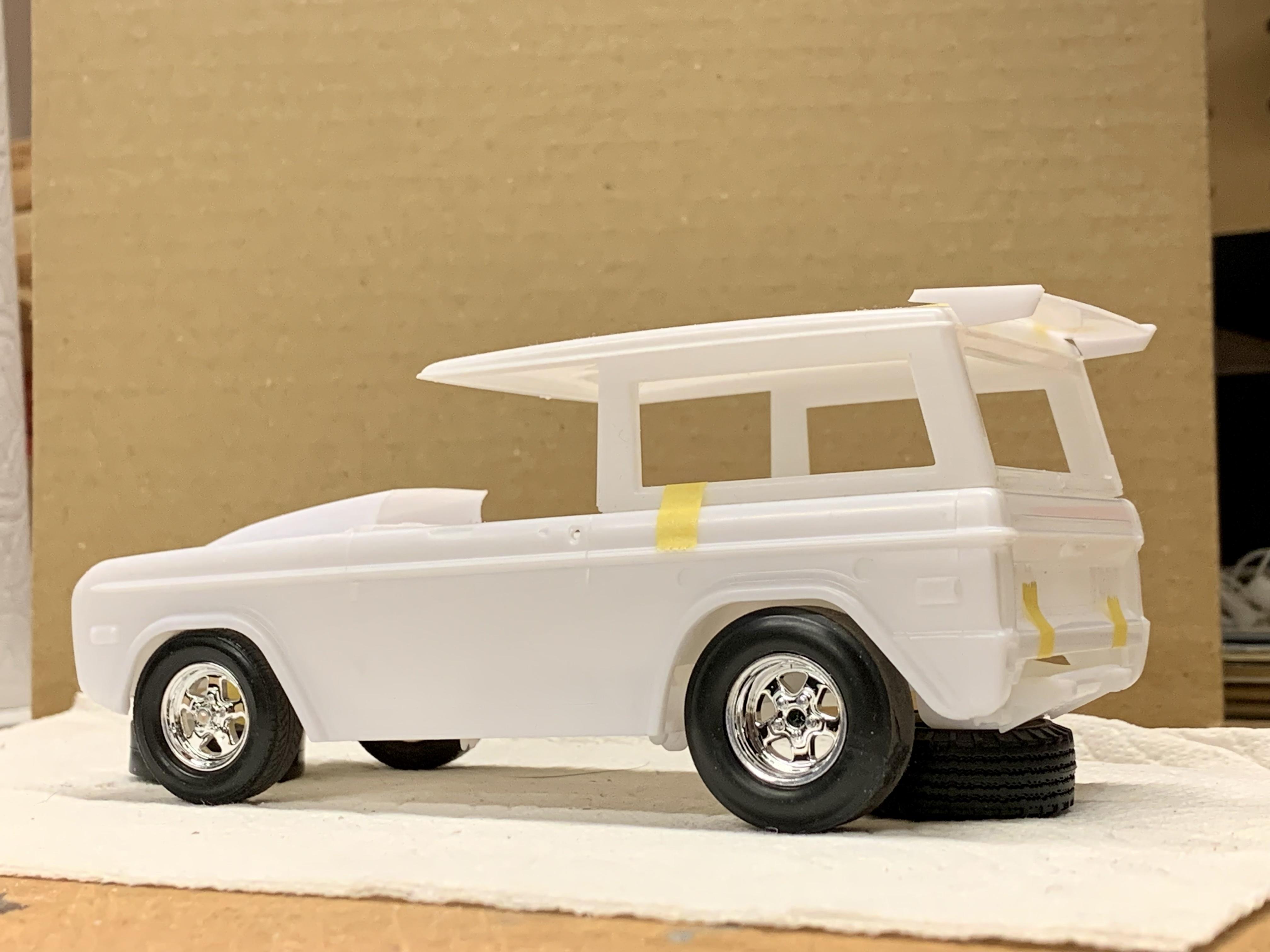

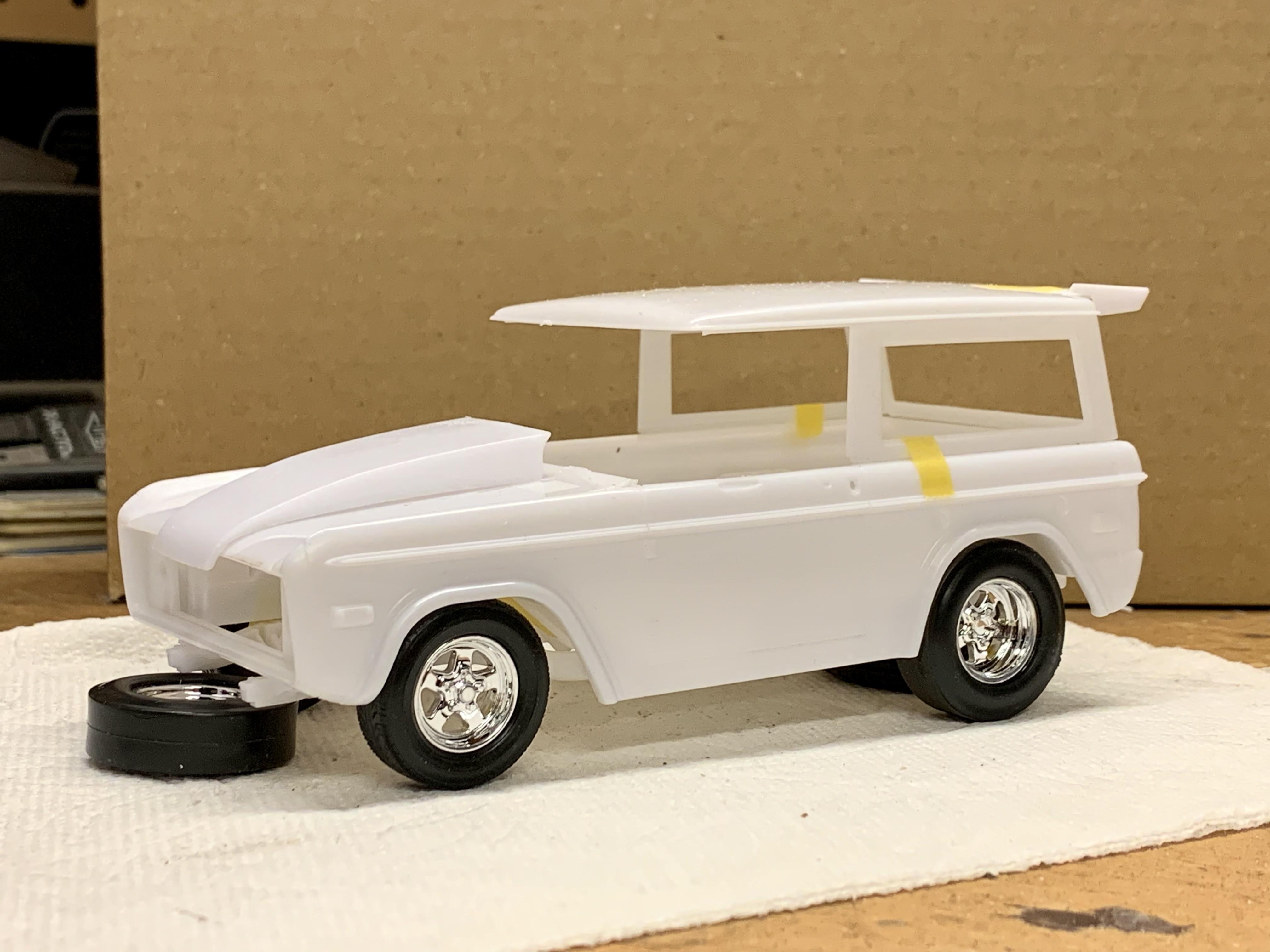

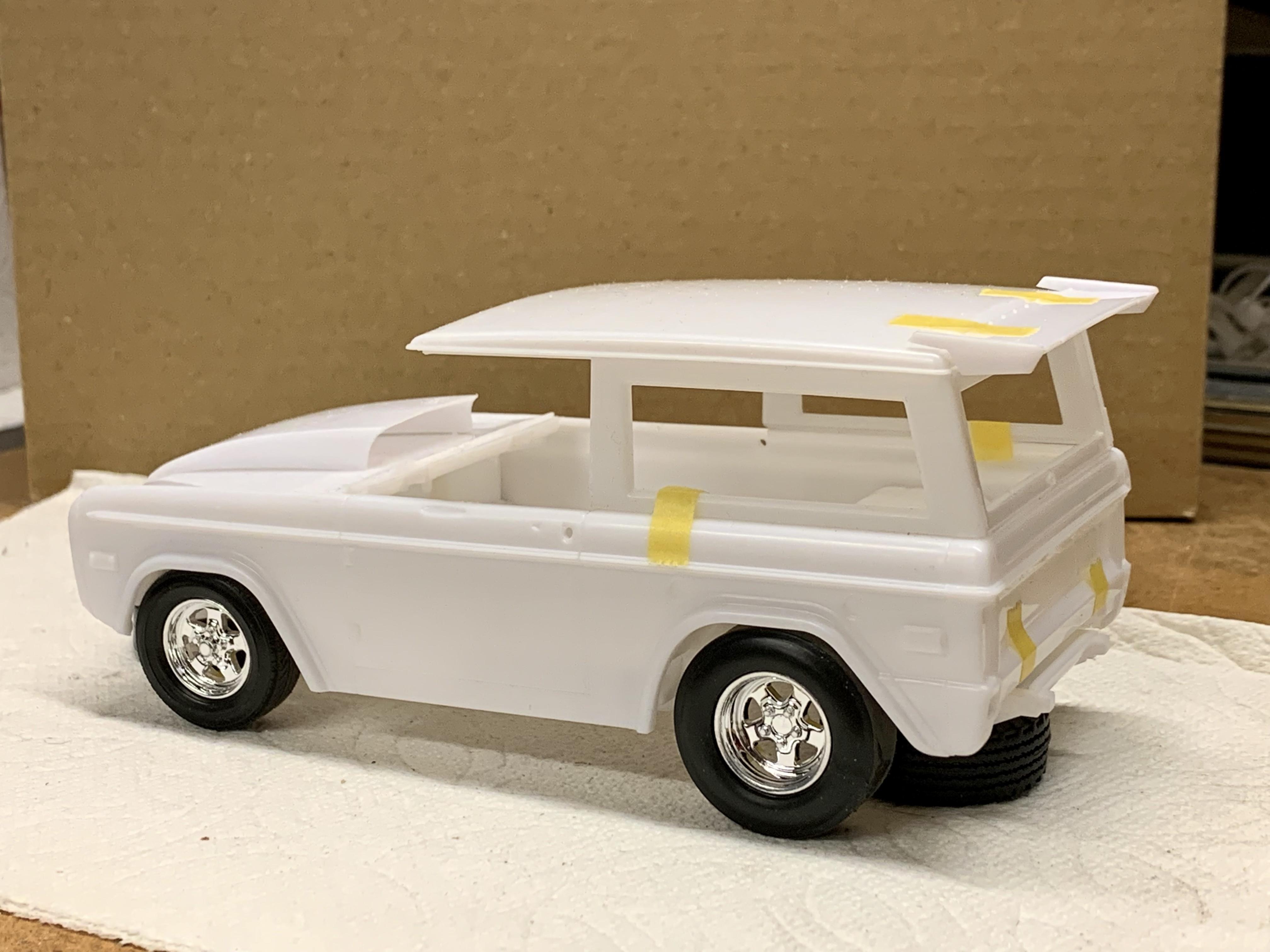

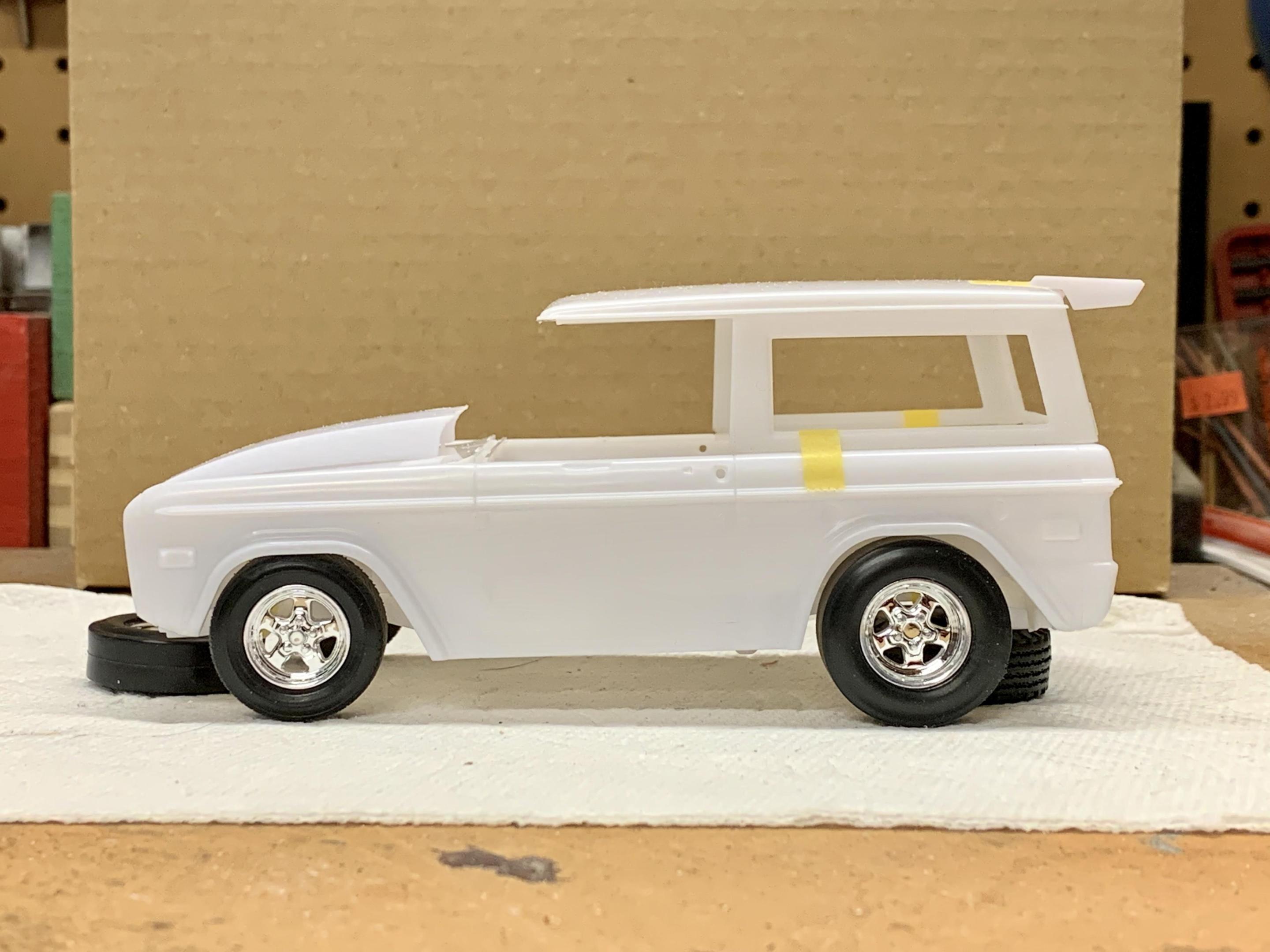

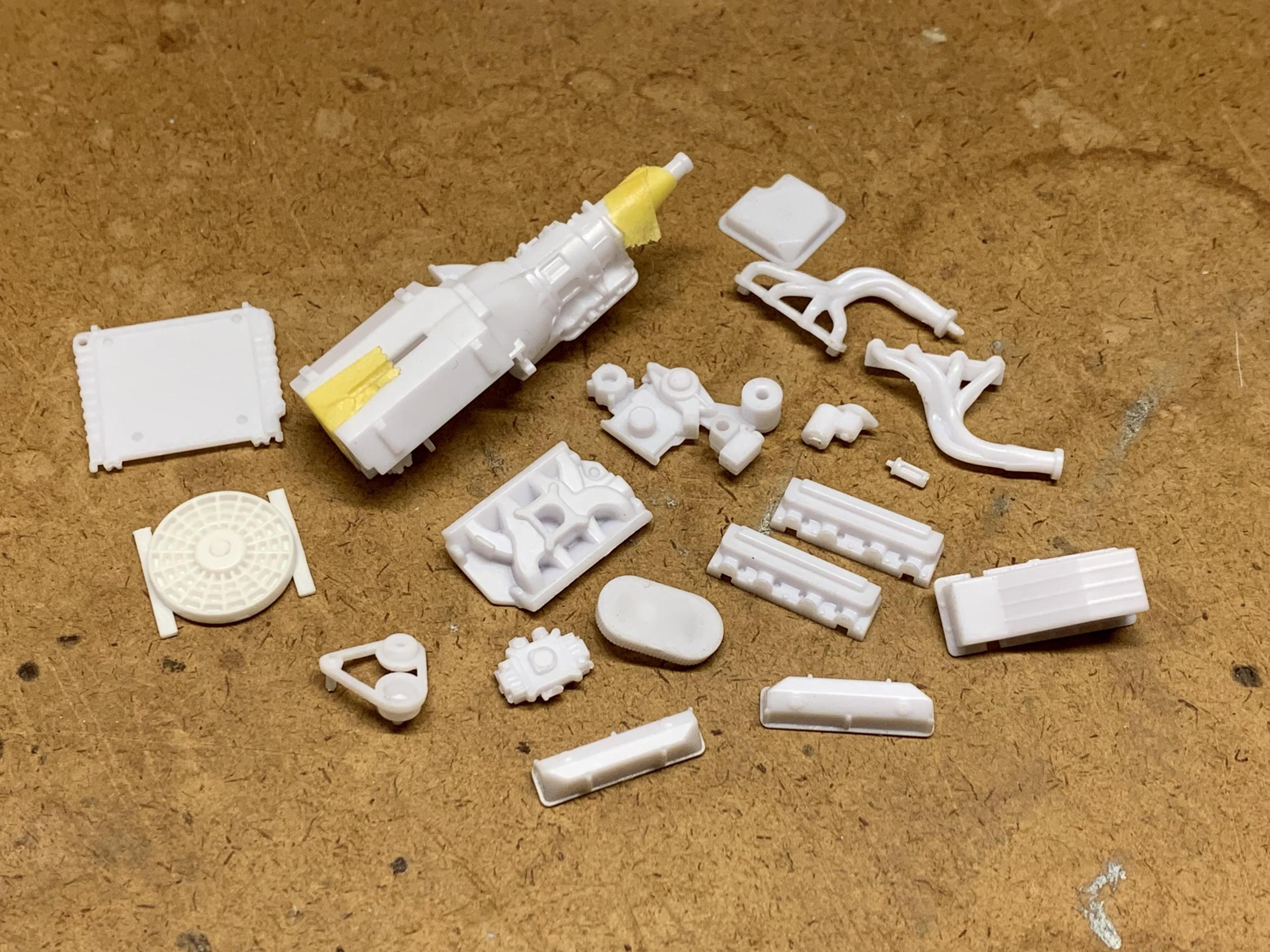

Dennis Lacy Posted November 28, 2022 Posted November 28, 2022 (edited) Starting a thread for this might be a little premature but what the heck. Nearly a year ago I grabbed a Revell First Gen Baja Bronco, Foose FD100 and a ‘90 Mustang LX with a Hobby Lobby gift card I received for my birthday. After getting home and digging through all 3 kits for the first time I started having kit-bashing visions for the Bronco right away but it’s taken a while to get around to it. I figure there’s more than enough 4x4 Broncos out there so why not upset the purists. ? The idea is to build a wicked little truck for the street with a strong drag race influence. Below is the initial mock up using the Weld Pro Star wheels, tires, slicks, wing and cowl hood bulge from the ‘90 Mustang kit. Power will come from the Roush 428 Big Block from the Foose FD100 with the simple belt drive from the Broncos stock small block (luckily the water pump and crank pulley center lines are the same) and I’ll cut all of the molded accessories from the timing cover. The radiator is from the Bronco with the electric fan from Revell’s 1948 Ford Convertible. Front suspension will be the IFS from Revell’s 1941 Willys Pro Street. Rear 9” axle, 4-link and coil-overs from the FD100. The axle will need to be narrowed some. From the ‘90 Mustang is the “aluminum” drag wing, cowl hood bulge (before it got cut out of the hood) and the Kirkey drag seats. That’s all for now. Just getting the main components figured out. Hoping to get started in the near future. Let me know your thoughts! ? Edited November 28, 2022 by Dennis Lacy 6

Dennis Lacy Posted November 29, 2022 Author Posted November 29, 2022 6 hours ago, stavanzer said: Neat! I did not know that the Mustang Scoop was a separate piece. This will be a wonderful Project. Thanks! The “scoop” is not a separate piece. It was cut from the Mustang hood and will be grafted onto the Bronco after more trimming.
stavanzer Posted November 29, 2022 Posted November 29, 2022 23 minutes ago, Dennis Lacy said: Thanks! The “scoop” is not a separate piece. It was cut from the Mustang hood and will be grafted onto the Bronco after more trimming. Ah, I understand now. It looks great. 1
