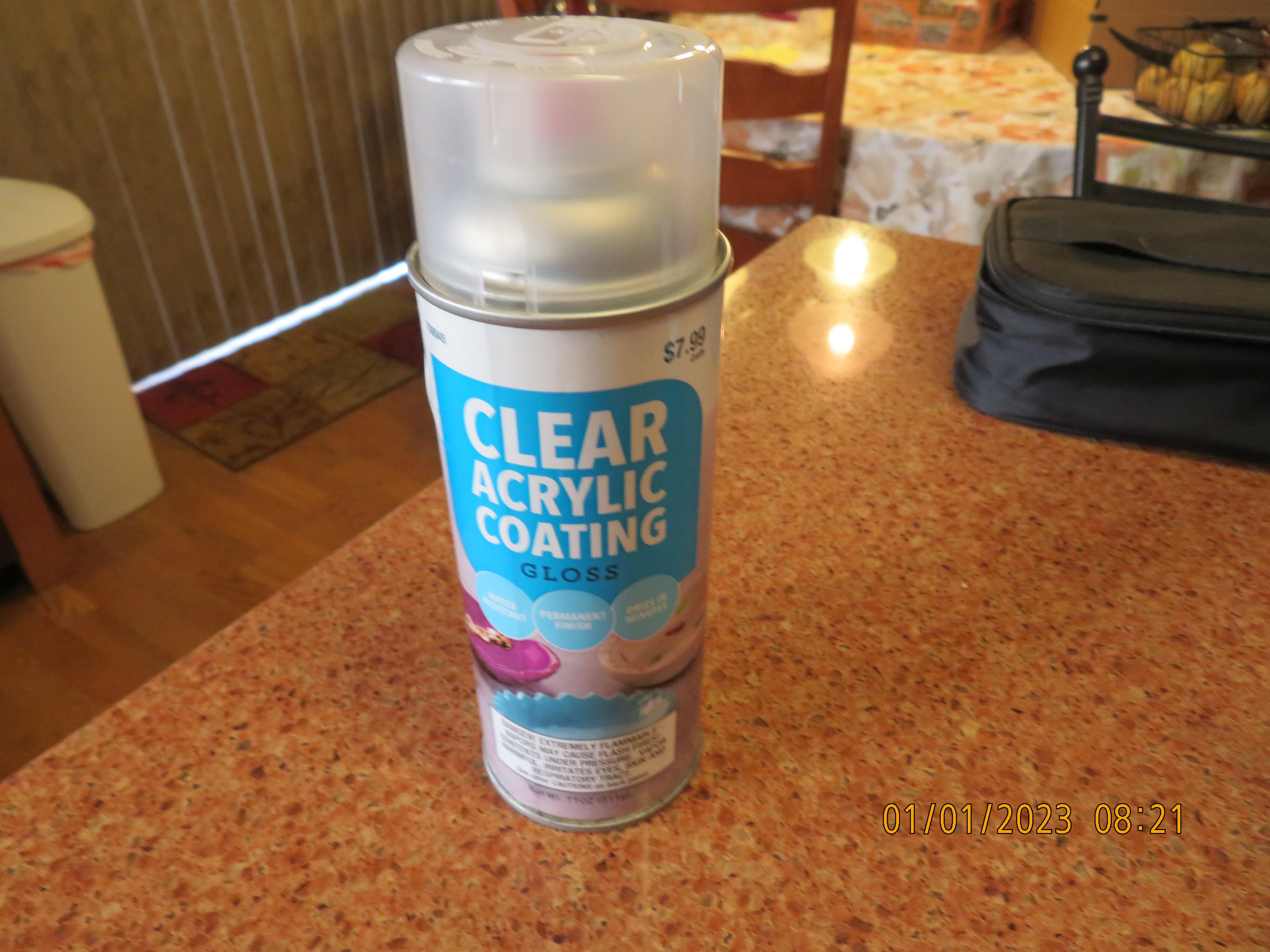

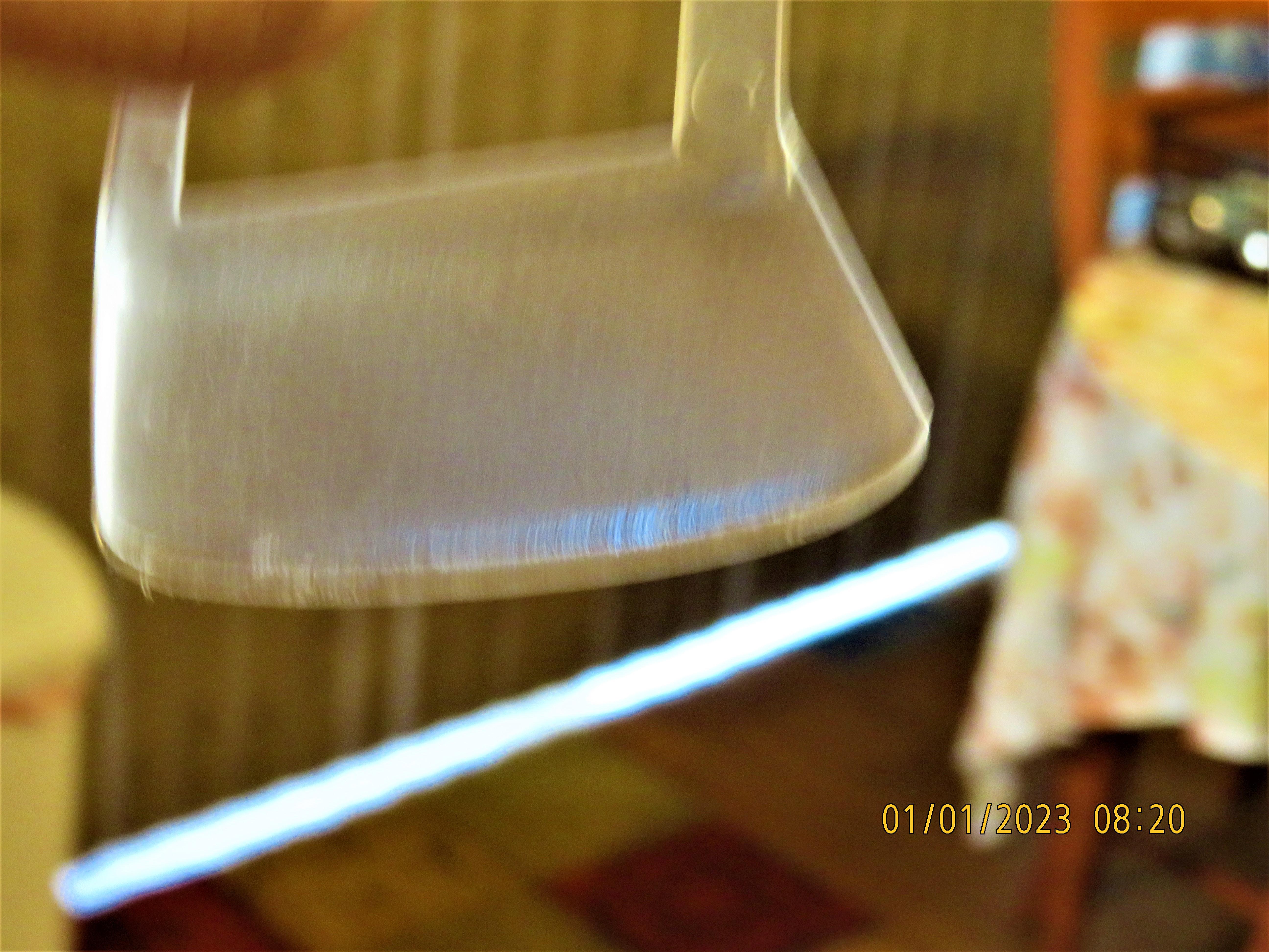

Mike 1017 Posted December 1, 2022 Posted December 1, 2022 I got this can from Hobby Lobby yesterday. I explained that I was going use it on clear plastic and this is what he gave me. Got home did a test spray and this what happened. Check out the back of the can. Mike

Mike 1017 Posted December 1, 2022 Author Posted December 1, 2022 35 minutes ago, StevenGuthmiller said: I don't want this to sound like a personal attack Michael, but I have not been the only one to warn people again and again about buying these cheap paints. I get the fact that they may be more inexpensive or convenient, but in the end, you might have been better off to just flush the money down the toilet and save yourself the aggravation. It's been said before, but here it is again. "You get what you pay for". Or more to the point, "you get a can full of rubbish for a few dollars less". Steve I did explain that I was gonna use it for clear plastic just like the ones that are in the store. When a can or bottle says Acrylic that is what supposed to be inside. Anyway, back to Hobby Lobby for an exchange and maybe some answers. $8.00 a can. Thanks for the comment Mike

StevenGuthmiller Posted December 1, 2022 Posted December 1, 2022 (edited) 47 minutes ago, Mike 1017 said: I did explain that I was gonna use it for clear plastic just like the ones that are in the store. When a can or bottle says Acrylic that is what supposed to be inside. Anyway, back to Hobby Lobby for an exchange and maybe some answers. $8.00 a can. Thanks for the comment Mike Acrylic can be one of those terms that doesn’t explain a whole lot. They run the entire gammit from a water based acrylic craft paint, all of the way to an acrylic lacquer, which is essentially automotive paint. It appears that you have something here that’s closer to the latter. Plastics are not a one size fits all affair either. Styrene plastic is an entirely different animal than some other plastics. Might be safe to use on your lawn furniture, but not necessarily your kit parts. Steve Edited December 1, 2022 by StevenGuthmiller 1

jaymcminn Posted December 1, 2022 Posted December 1, 2022 (edited) Yeah, that's some nasty stuff in there. Honestly, the guy at Hobby Lobby isn't going to be some sort of paint guru and he definitely isn't going to be aware of the tendency of acetone to react badly with polystyrene (I think that's what caused the crazing). At best, he'll have some basic training and a little experience with a few of the products. At least you did the smart thing by sacrificing a test part. Lesson learned, no harm done. "Acrylic" is a catchall term that by no means refers to whether a paint is water-based. The Revell acrylic spray paints are billed as acrylic, and they indeed are, but they're an acrylic lacquer just like Tamiya. Edited December 1, 2022 by jaymcminn
NOBLNG Posted December 1, 2022 Posted December 1, 2022 7 hours ago, Mike 1017 said: I got this can from Hobby Lobby yesterday. I explained that I was going use it on clear plastic and this is what he gave me. Got home did a test spray and this what happened. Check out the back of the can. Mike Thankfully you read the back of the can and did a test spray before using it on a good kit part!?

Mike 1017 Posted December 3, 2022 Author Posted December 3, 2022 On 12/2/2022 at 8:30 AM, showrods said: LOL. All of what you said is SO true Steve. Got back from Hobby Lobby no one and I mean no knew anything about paint. I showed the manager what acrylic is and what is in that can. One would think I was speaking Klingon to her. Got my exchange and bought a bottle Createx clear. Thanks for all the comments. Mike 1
Mike 1017 Posted December 4, 2022 Author Posted December 4, 2022 On 12/1/2022 at 4:44 PM, jaymcminn said: Yeah, that's some nasty stuff in there. Honestly, the guy at Hobby Lobby isn't going to be some sort of paint guru and he definitely isn't going to be aware of the tendency of acetone to react badly with polystyrene (I think that's what caused the crazing). At best, he'll have some basic training and a little experience with a few of the products. At least you did the smart thing by sacrificing a test part. Lesson learned, no harm done. "Acrylic" is a catchall term that by no means refers to whether a paint is water-based. The Revell acrylic spray paints are billed as acrylic, and they indeed are, but they're an acrylic lacquer just like Tamiya. I just read up on Acrylic and you are right. In defense of Hobby Lobby, they must have 100 or even 1000 products. No one could be an expert on everything that they have. Thanks for the info Mike
Mike 1017 Posted December 5, 2022 Author Posted December 5, 2022 On 12/1/2022 at 1:33 PM, StevenGuthmiller said: I guess my first question would have been, why was it necessary to spray clear paint over a clear part in the first place? If the part was scratched or damaged in any way, it might have been a better approach to polish it. If you feel that it is necessary to spray clear coat over it, you could try Testors clear lacquer. I’ve sprayed it over virtually everything with no adverse affects, and while I don’t recall ever feeling the need to spray it over clear parts, (although at some point I may have) I have used Testors lacquer window tint on kit glass before and it worked well. I assume they are one in the same as far as formulation goes. Just be sure to test it on a spare part, (as should always be your practice when working with unfamiliar products) Steve It was a test. I never ever use any new product without trying it out first. That window was in the parts box. Mike
