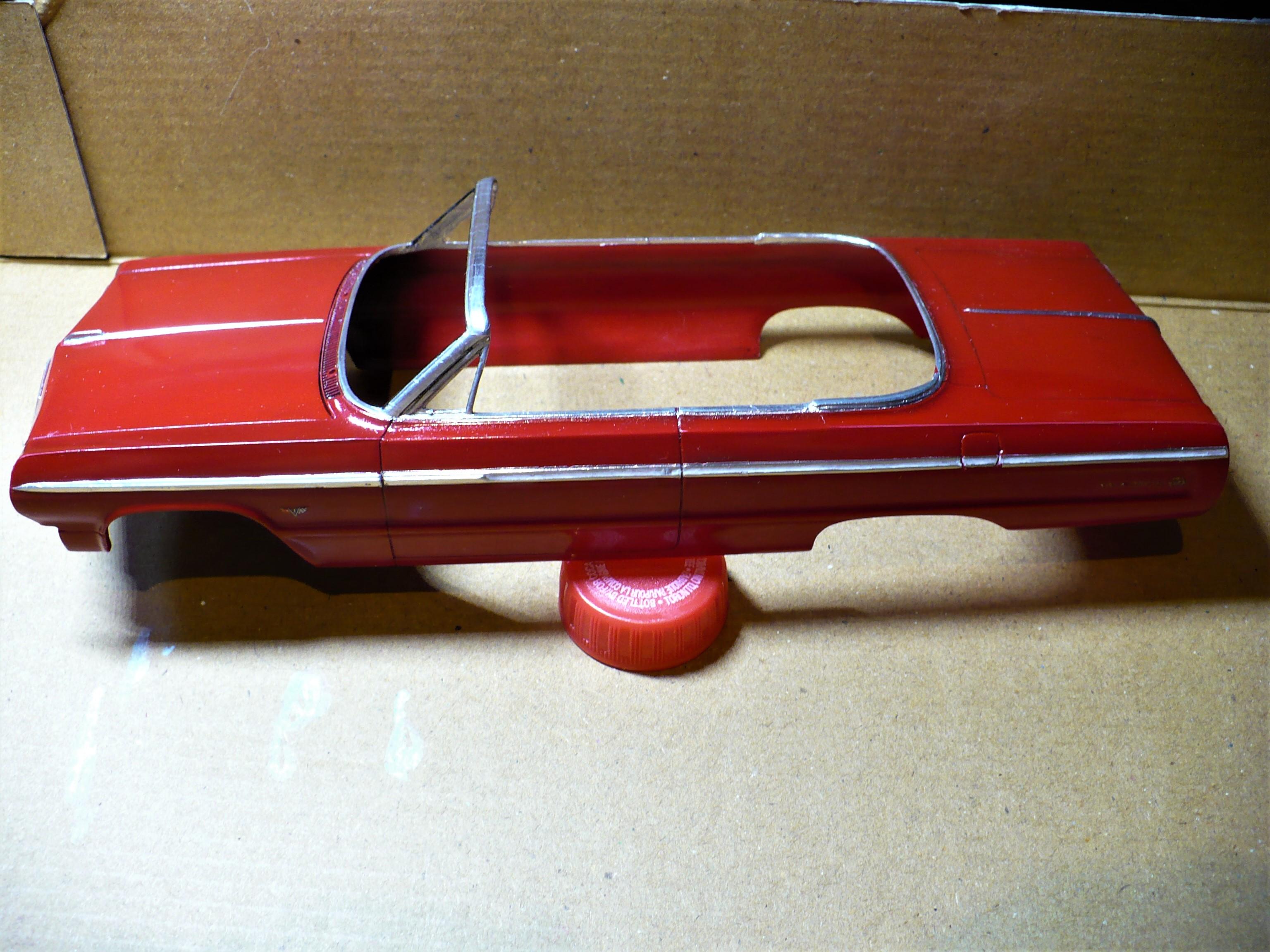

Body painted. It is a different shade of red from the interior but you will have to take my word for it. The adventure in BMF is successful. So far. The elusive to replicate SS reflective patterned side trim white base is done. Will need to figure out how to the a very thing silver was over it to get the right effect.
