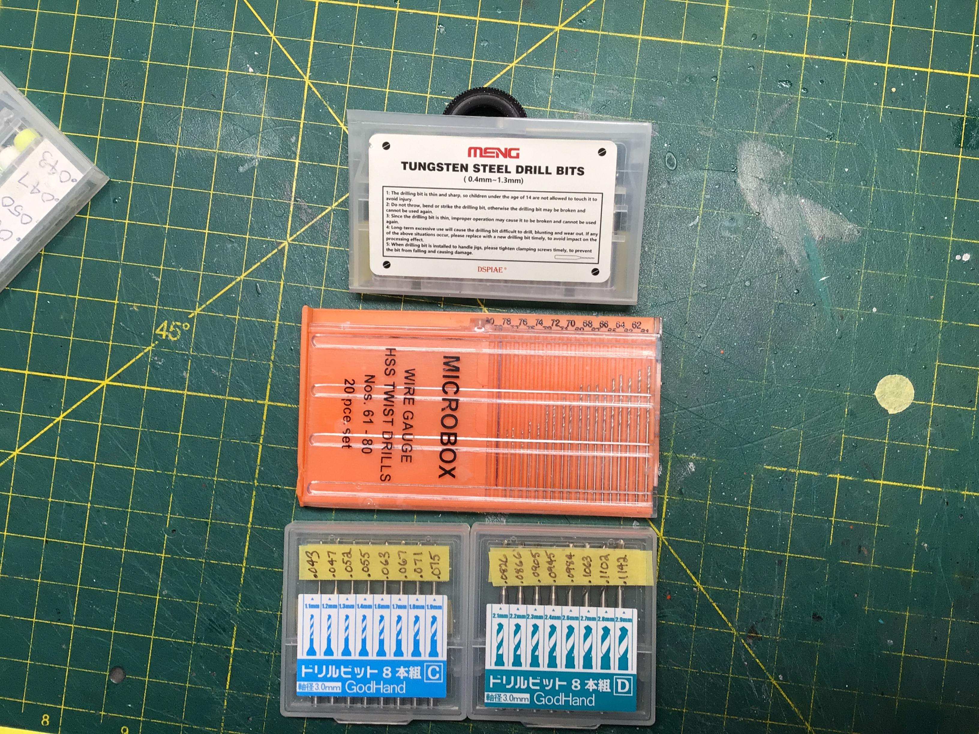

NOBLNG Posted January 4, 2023 Posted January 4, 2023 Yes. The carbide ones are very sharp and brittle. This Meng set is the last set of bits purchased and I’ve broken half of them already.? The best bits I have are the Vallejo ones in the orange case, made in the Czech Republic (I think) and the Godhand ones are very good quality (made in Japan).
peteski Posted January 4, 2023 Posted January 4, 2023 Yes the Tungsten Carbide PC Board drill bits with 1/8" shanks are very handy, and I use them as much as I can. Over the years I acquired a good range and quantity of those bits. I also bought a set of the GodHands bits (0.5-0.9mm, 2.5mmm shank) and I I'm not very impressed. They aren't made very well compared to the PC Board bits. Of course their advantage is that being made from HSS, then are nowhere as brittle.
