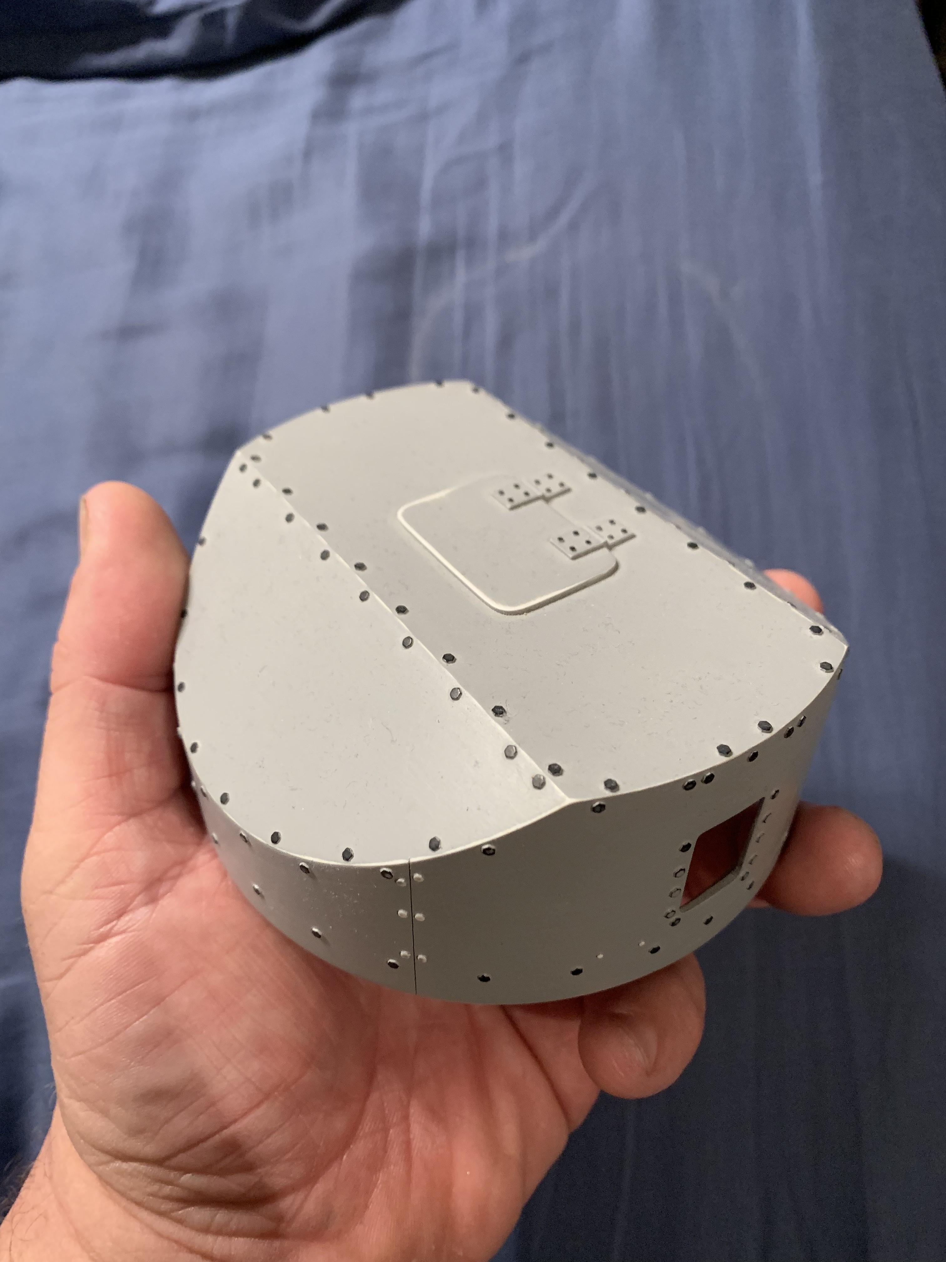

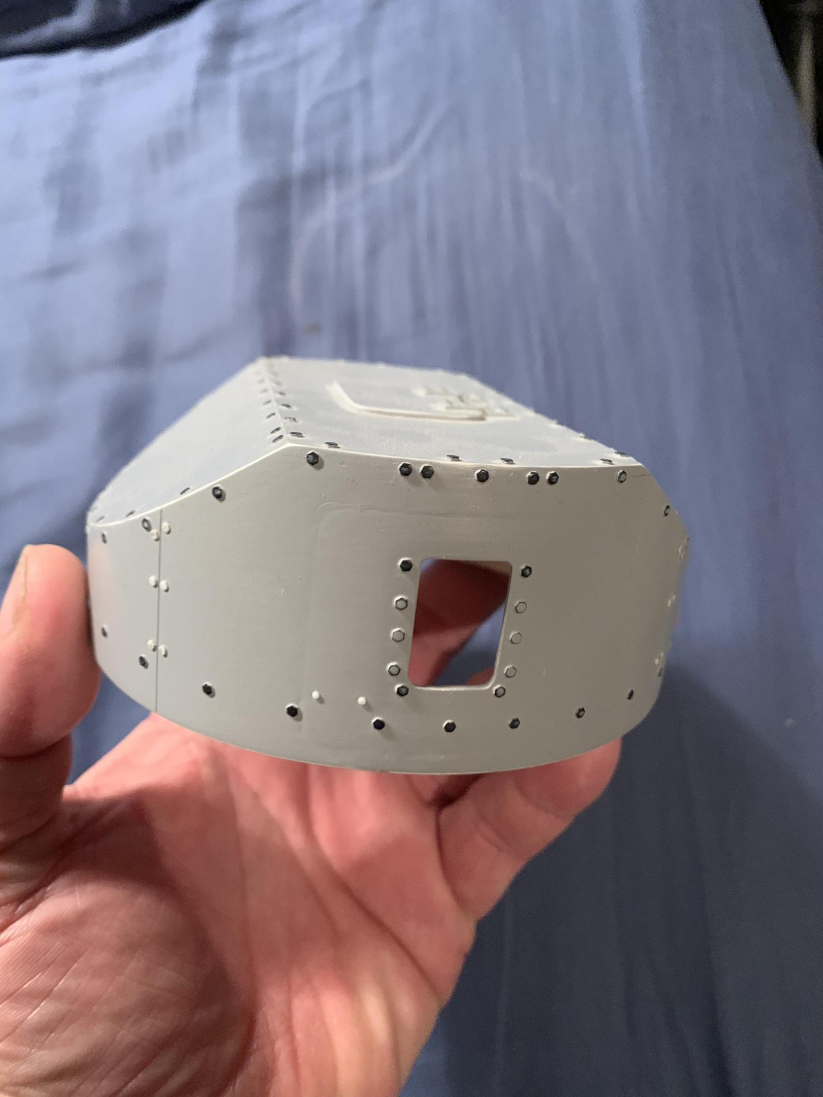

LDO Posted December 18, 2022 Posted December 18, 2022 (edited) I’m trying to make a cylinder by laminating sheet styrene. I need a cement that I can brush on, while giving time to position the next layer of styrene. My first effort (using MEK) has sink marks from too much solvent in a small spot. Can someone make a good recommendation? Pics are a previous effort that worked better, but still has a sink mark. This was wrapped around a PVC pipe coupling that I had sanded and filed smooth. After each layer of plastic, I put a smooth hose clamp around it. My most recent effort was laminated inside a piece of PVC pipe, with a test ball after each layer. A test ball is like a heavy duty cylindrical balloon that can be inflated to block a pipe for testing during construction. (I’m a plumber) Edited December 18, 2022 by LDO Spelling
