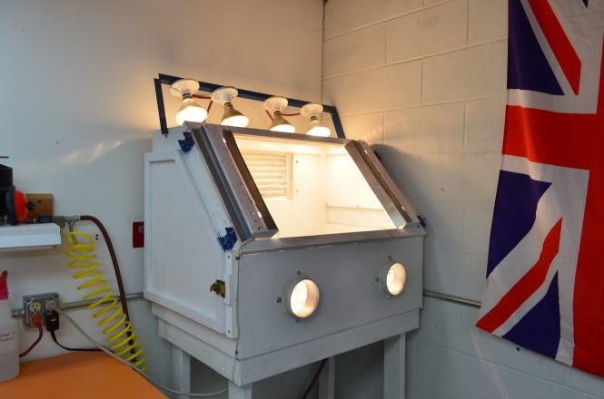

Miatatom Posted December 18, 2022 Posted December 18, 2022 (edited) That's what I thought too, so I built my own. I based it on the ones I used to work with when I was at the Y-12 Nuclear Weapons Plant in Oak Ridge, Tn. That's not me in the picture at the bottom and the boxes we used were like the one I built, with one big window. Edited December 18, 2022 by Miatatom
