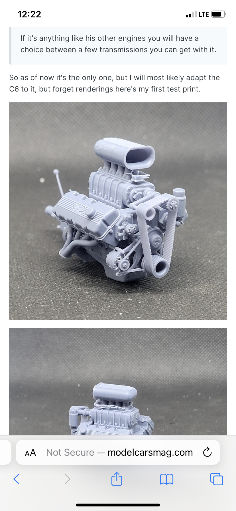

LDO Posted December 22, 2022 Posted December 22, 2022 Texas 3D customs is making one in whatever scale you need. Choose between stack injection and roots blower. I have several of his engines and transmissions in 1/8 scale and I have no reservations saying they are as good as any injection molded parts made. 1

Scott Colmer Posted December 22, 2022 Posted December 22, 2022 Just saw LDO/Lee's post. That 3D version looks dead on to me. 1
Bainford Posted December 22, 2022 Posted December 22, 2022 (edited) A couple other kit Cammers; - JoHan Maverick pro stock. A good looking engine, though with some accuracy issues the anoraks will find fault with, such as the same block being used for the 427 Cammer and the Boss 429, which in 1:1 are two different engine families. The Cammer parts are decent. - MPC flip from Mustang (origin Ohio George Mustang?). Most of the engine is undersized and generic, but the Cammer parts look great, and includes the 'Ford 427' lettering on the cam covers, which many exclude (most cam covers in period did not have this lettering). - AMT '68 Shelby, some kit releases but not all. A decent engine with nice looking Cammer bits. Seems to me there was a thread on the forum a while back listing and comparing kit based Cammers. It would be worth while to dig up that thread. As mentioned above, Texas 3D Customs has just released a gorgeous Cammer, with induction and transmission options. Having purchased some of his stuff, I can say his engines are top notch. Edited December 22, 2022 by Bainford 1

Fat Brian Posted December 22, 2022 Posted December 22, 2022 Don't forget the Moebius cammer from the 65 Comet drag version. That's probably the best overall kit version. That being said, the 3d version above looks like the definitive version if you're buying one now.
