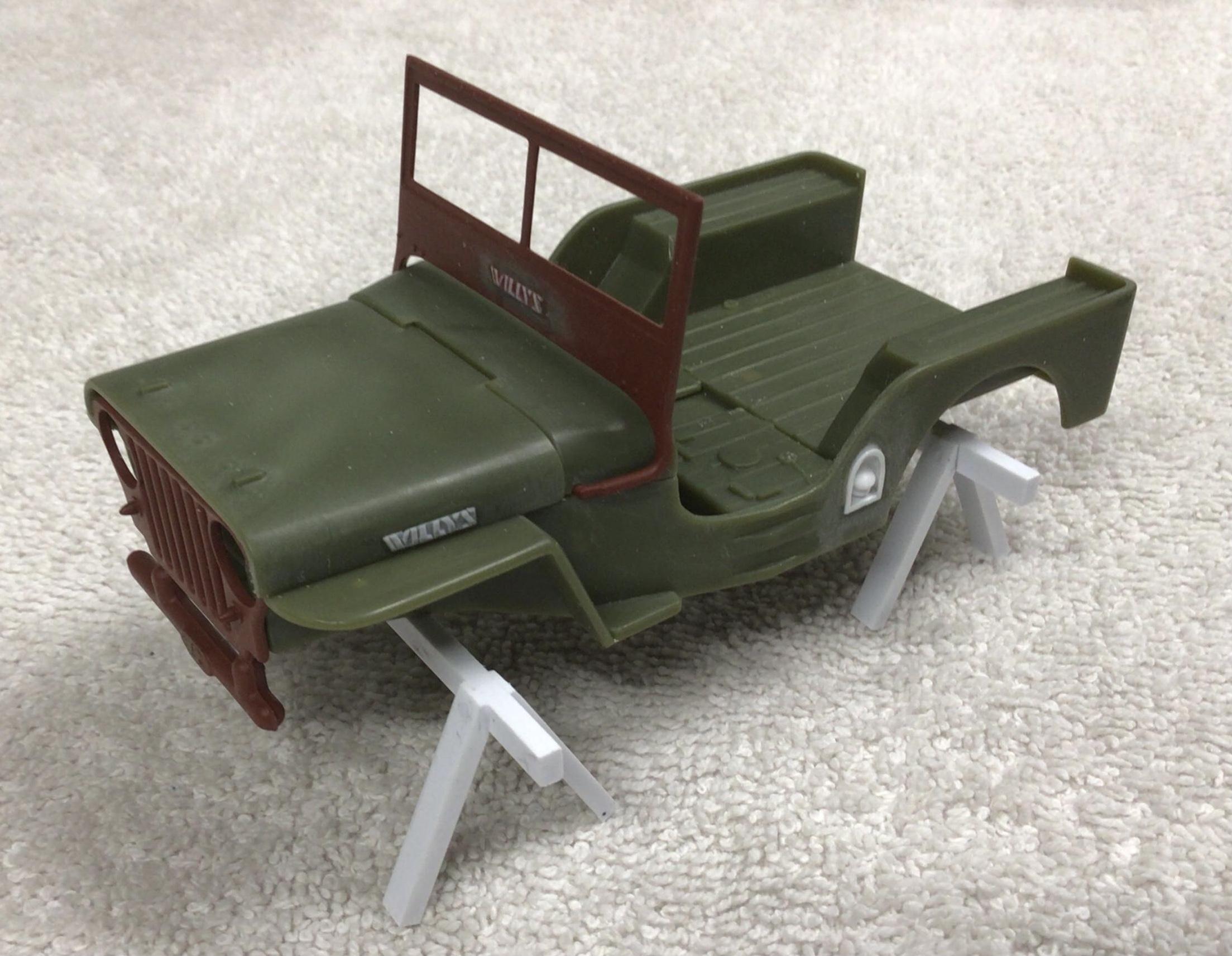

Oldmopars Posted December 25, 2022 Posted December 25, 2022 I know custom 3D parts are possible, I do them. But does anyone do custom PE? I would love to get some 1:16 scale Willys scripts made for my Takom Jeep. I could 3D print them, but there would be several steps to really get what I want. PE seems the better route.

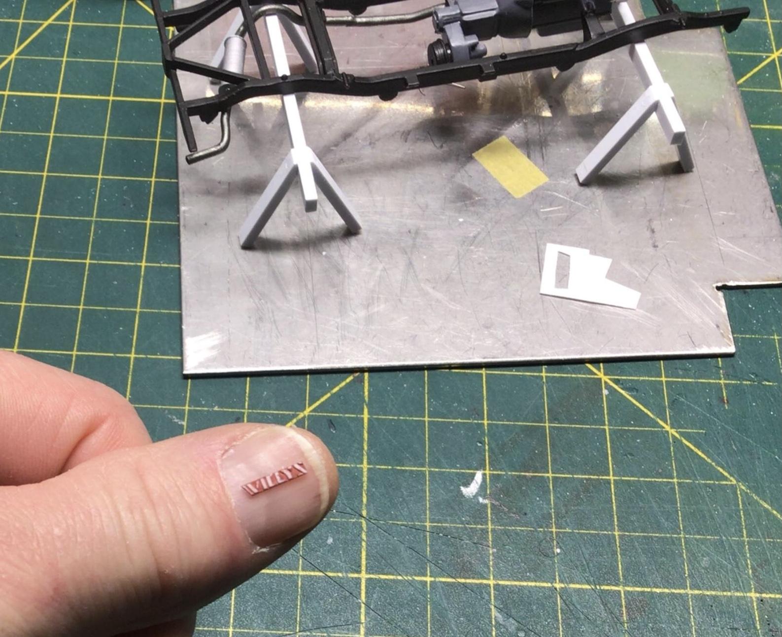

NOBLNG Posted December 25, 2022 Posted December 25, 2022 (edited) I don’t know about the custom photo etching or what all would be involved in printing them…but I just cut mine from .010” styrene. Then I positioned the letters and glued them to another piece of .010” styrene. Then I made a mold an cast four of them. I sanded most of the second.010” layer away before glueing them to the model. Just another option.? Edit: The scripts were stamped into the panels and painted body color also…unless there are variations I am unaware of. Edited December 25, 2022 by NOBLNG 1

Oldmopars Posted December 27, 2022 Author Posted December 27, 2022 Excellent, you seem to be doing the same CJ2A conversion but is 1/25. I may just 3D print some and do as you said sanding off most of the backing. My hands are not good enough anymore for that delicate work. Arthritis and taken its toll. However, I can work magic in Fusion 360. That seems my best route. On 12/24/2022 at 7:57 PM, NOBLNG said: I don’t know about the custom photo etching or what all would be involved in printing them…but I just cut mine from .010” styrene. Then I positioned the letters and glued them to another piece of .010” styrene. Then I made a mold an cast four of them. I sanded most of the second.010” layer away before glueing them to the model. Just another option.? Edit: The scripts were stamped into the panels and painted body color also…unless there are variations I am unaware of.

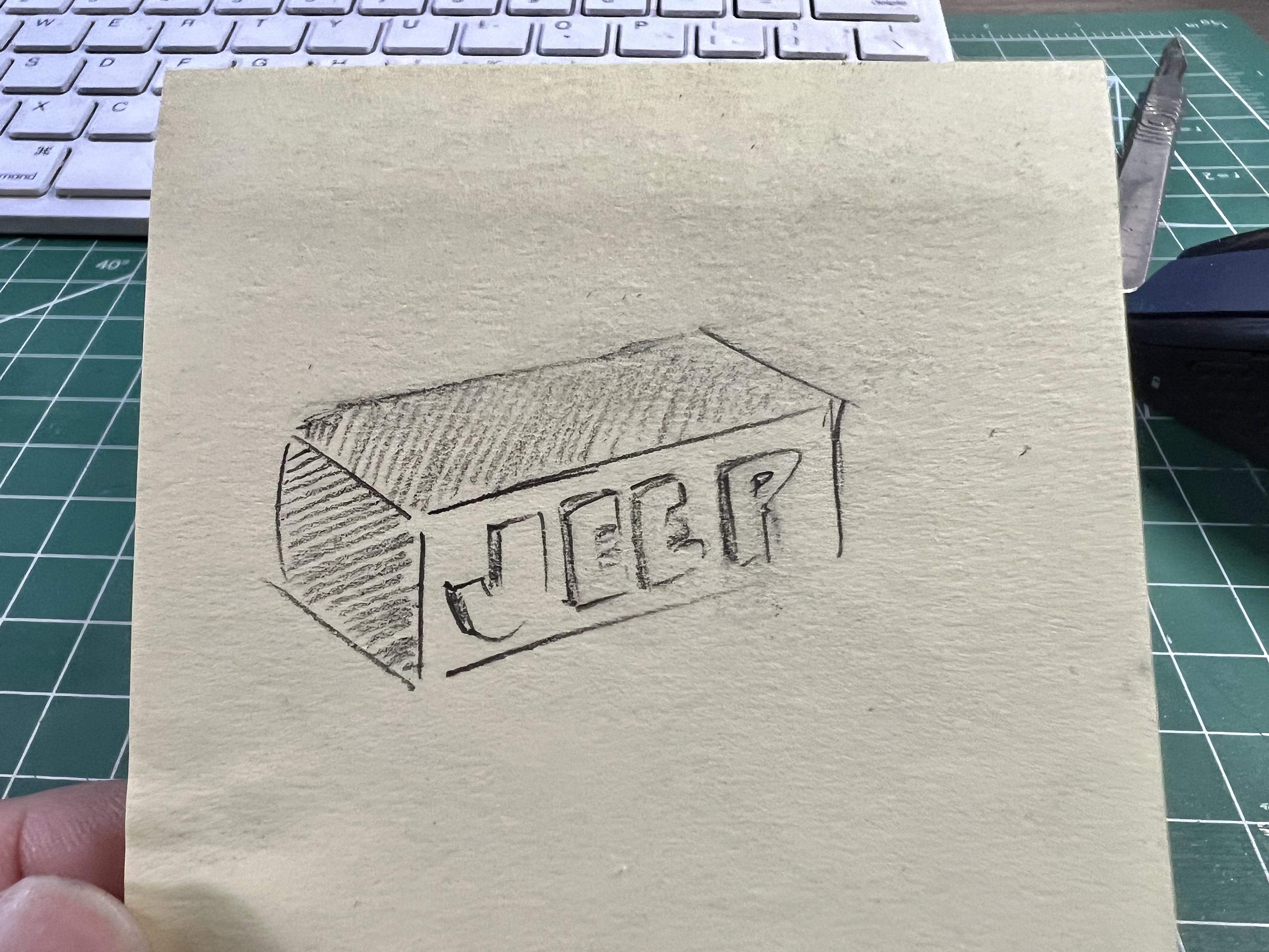

OldNYJim Posted December 27, 2022 Posted December 27, 2022 Hey Scott! I was thinking about your question today, and how we can maybe use 3D printers to create missing scripts and fine detail that would normally be something we’d have photoetched. I wondered about the possibility of making a larger piece that could just plug into a slot or groove cut into the body. Quick sketch to show what I imagined (with exaggerated depth, for clarity…): Printing tiny script in 3D is hard (near impossible, probably), but putting it on a ‘block’ like this, making a slot wherever it needs to be placed on the body and inserting this little panel into the body could be a way around that challenge…and achievable with a 3D printer. The edges of the block can be sanded and bodyworked to get the perfect fit, and then prime and paint as normal
