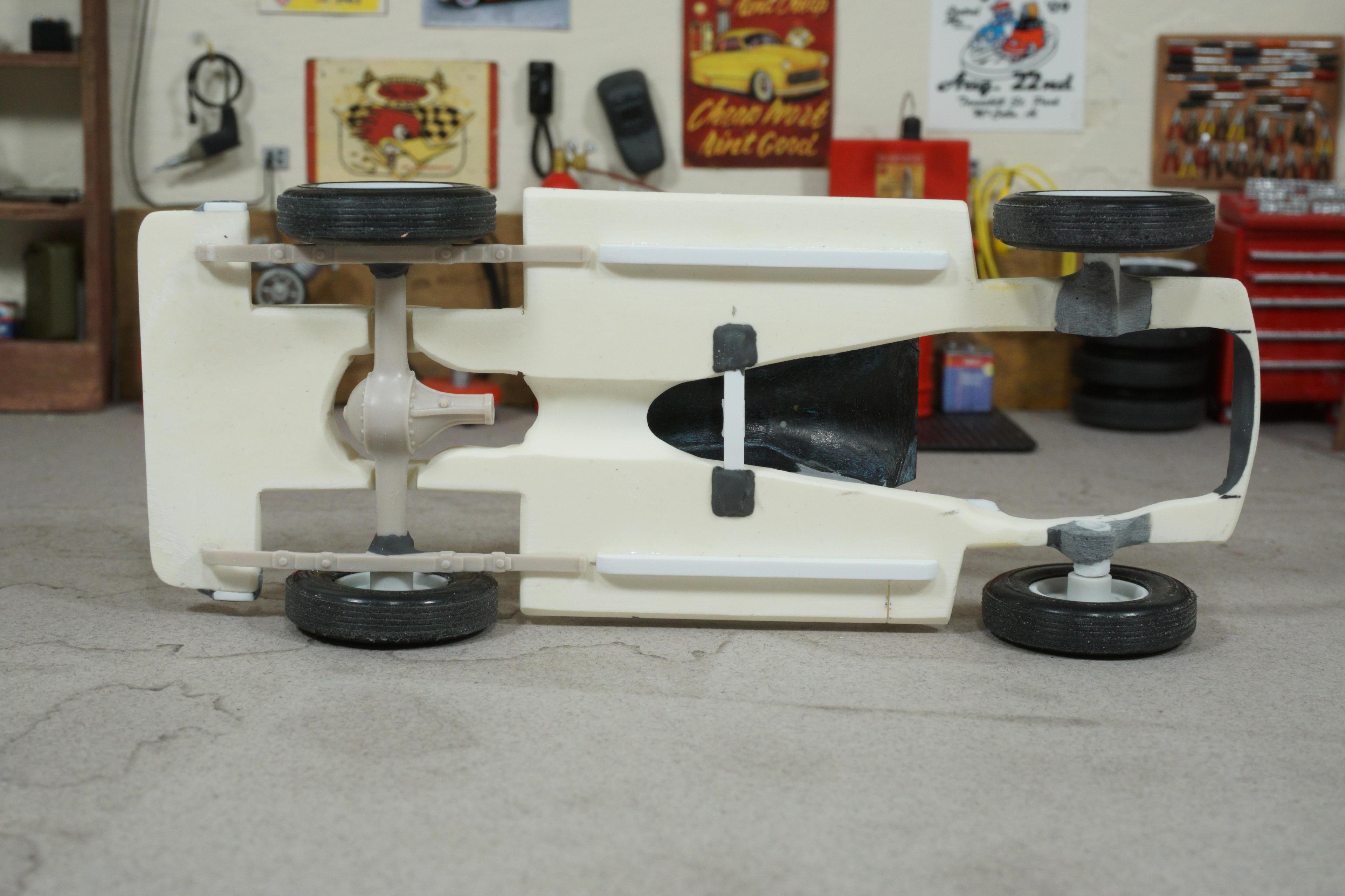

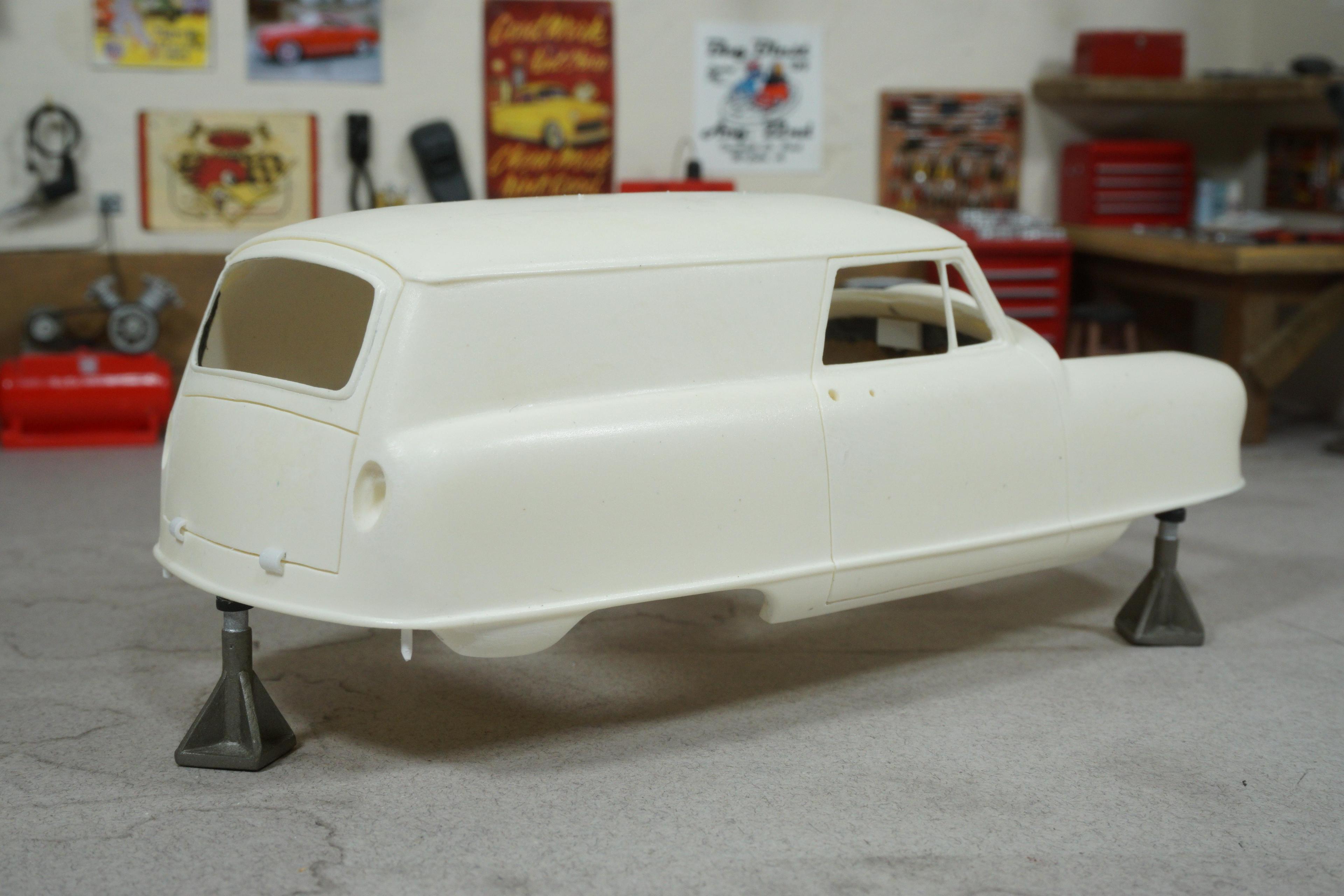

Joe Lange Posted December 31, 2022 Posted December 31, 2022 Happy Holidays to One and All, Bought this resin body from Jimmy Flintstone about a year ago. It came with cast, (pewter?), headlight bowls/rings, and front grill. Also, resin bumpers, hood, and something resembling a chassis. The chassis looked to be a 'bonus' piece because nothing was mentioned in the description, so hey,......better than nothing! Try finding 50's Nash model car parts! I also found a damaged, (dropped), Franklin Mint Nash Metropolitan diecast on Ebay that I grabbed for parts. (Something about spare Nash parts). I'm going to try keeping with a factory 'stock' theme here but, there so few of these beasts, who's going to know? 3

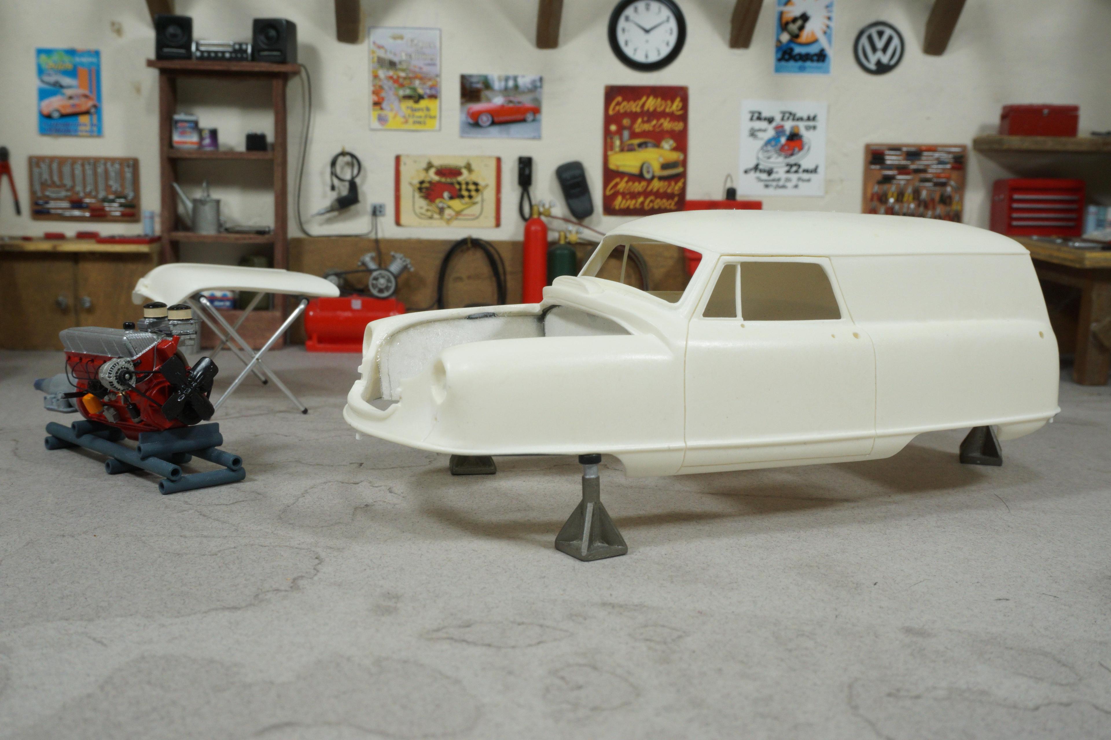

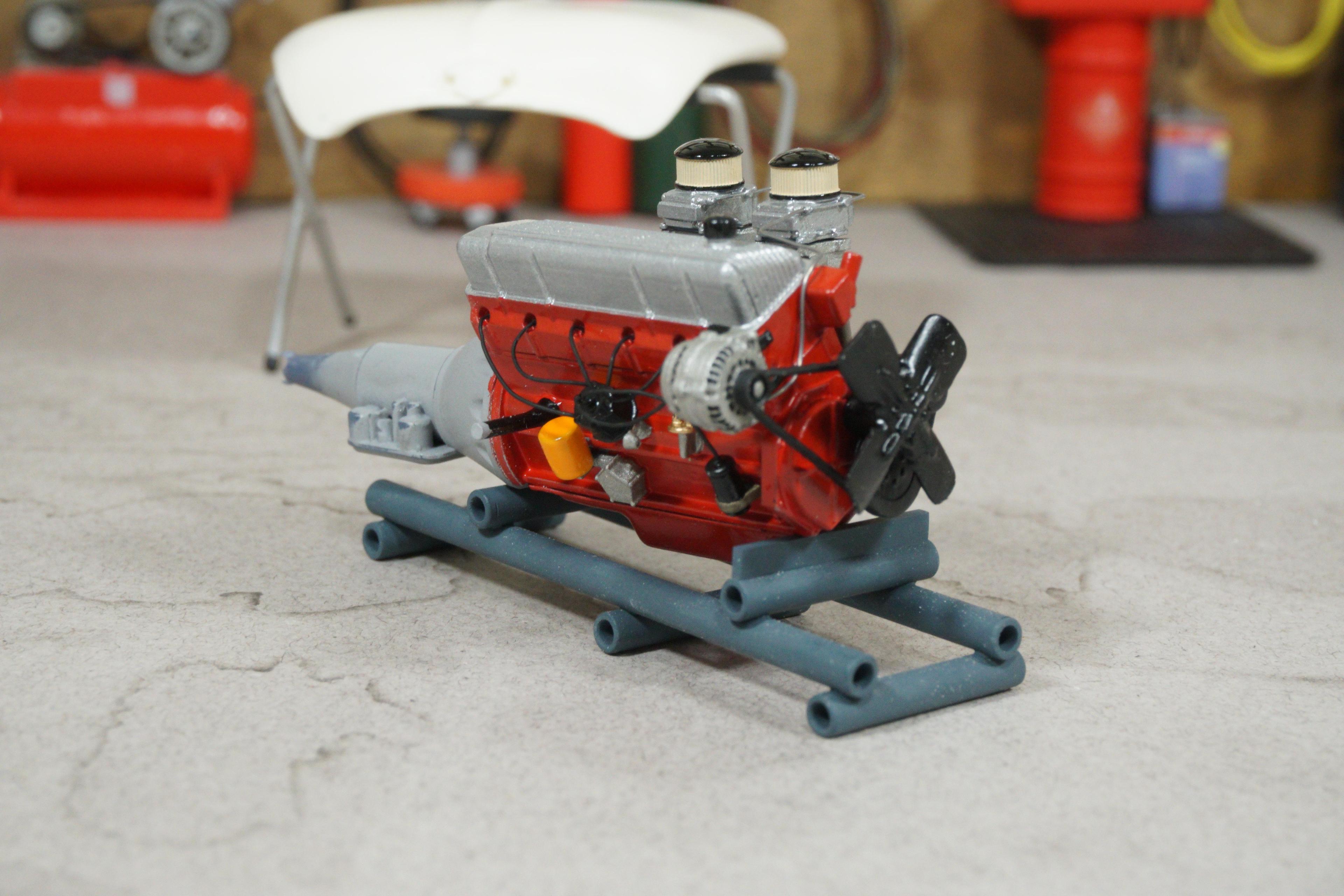

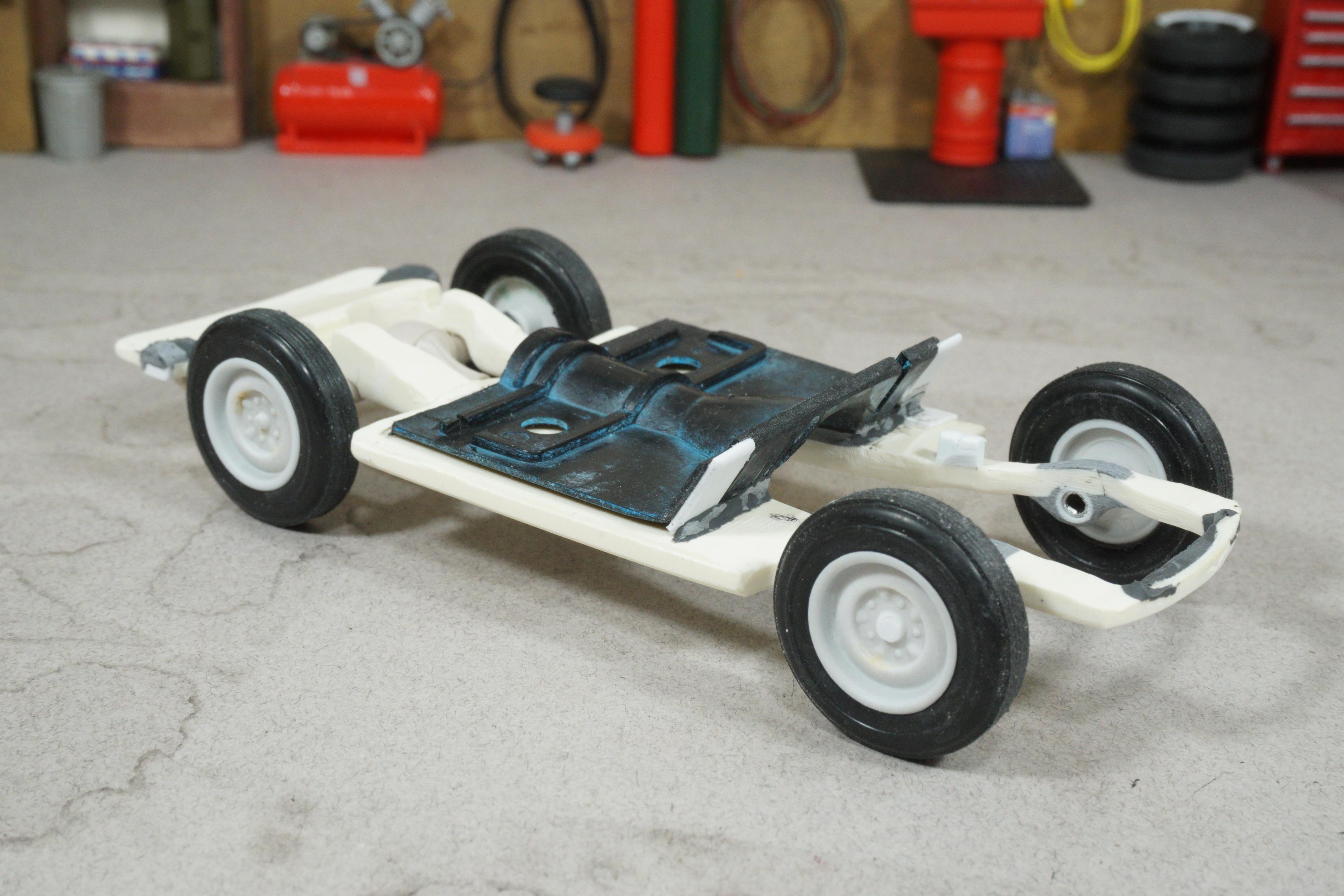

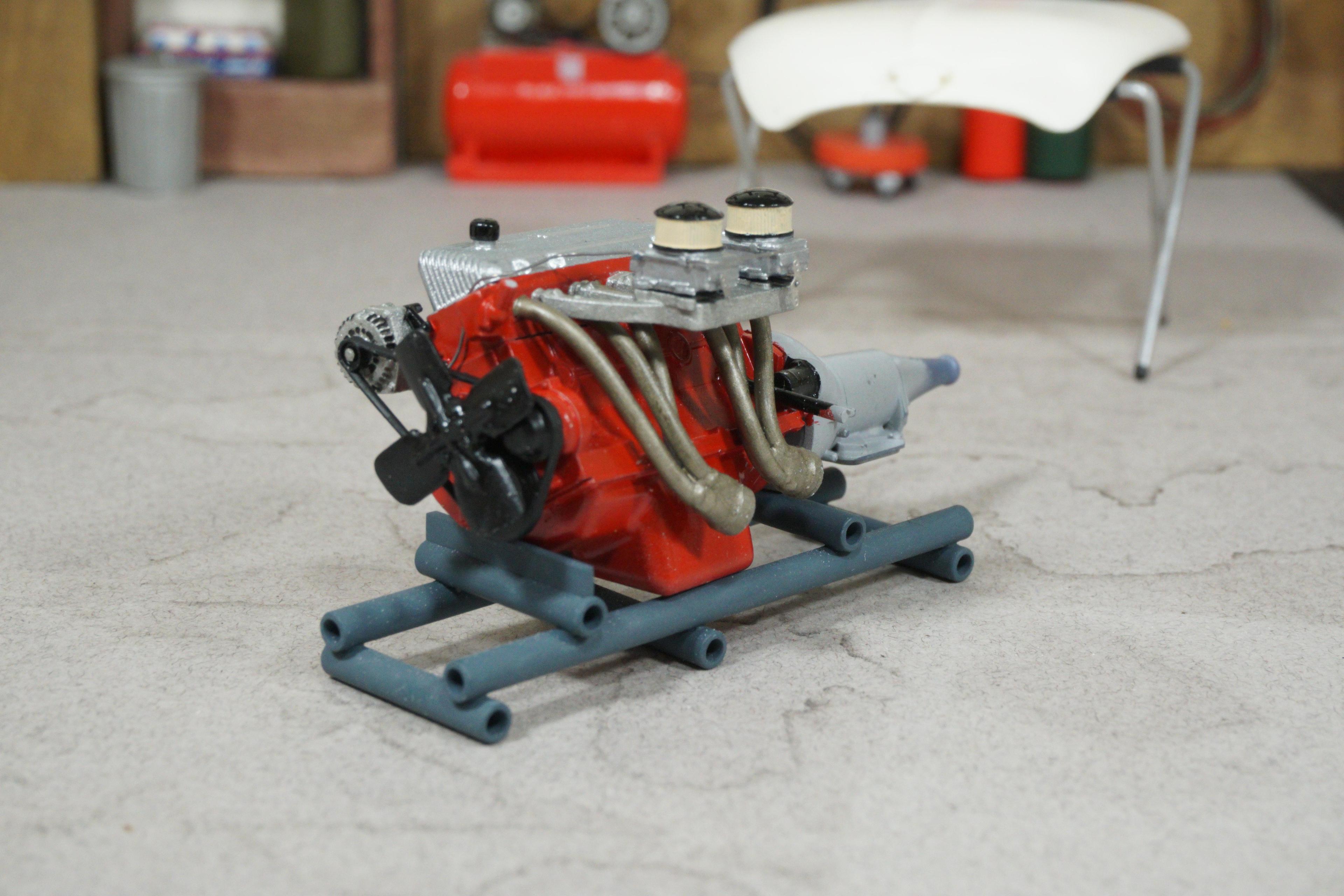

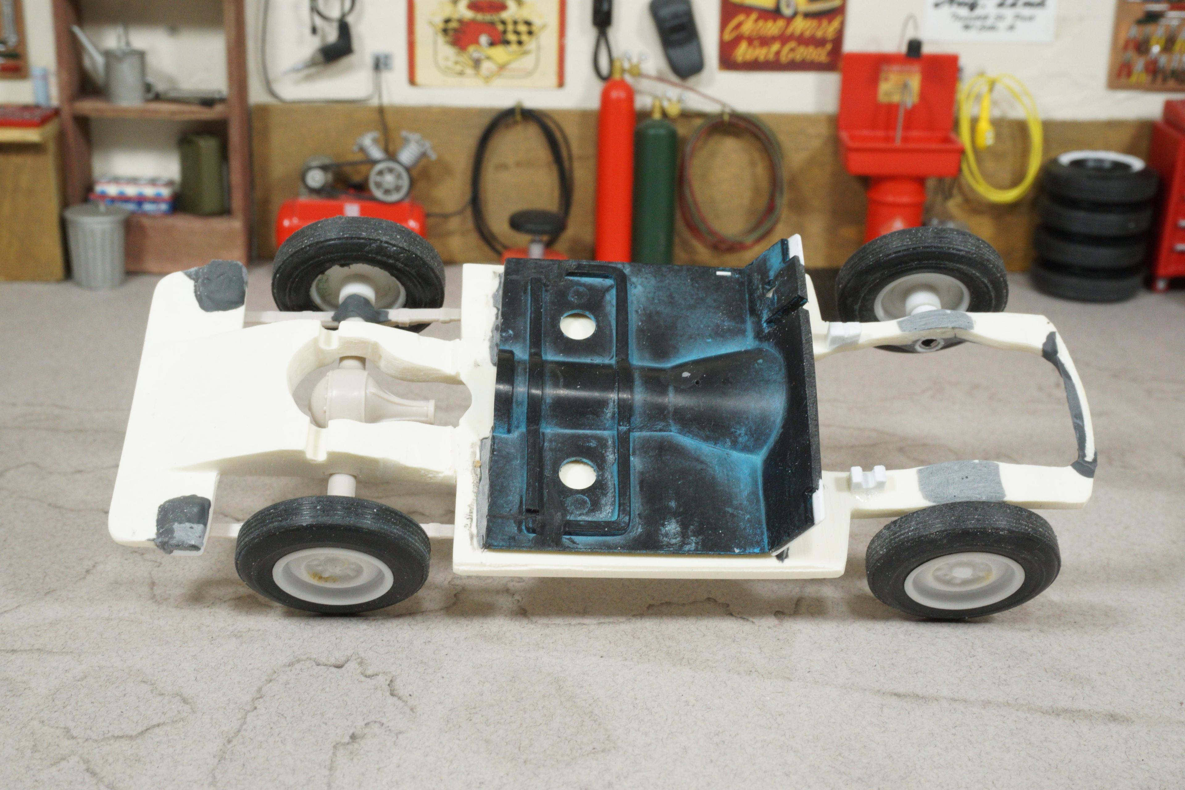

Joe Lange Posted December 31, 2022 Author Posted December 31, 2022 As far as the engine, I decided to go in a different direction. Instead of trying to find a stock 'flathead' six, I purchased a 'slant six' Dodge 225 engine with an Offenhauser ribbed rocker cover, dual carb conversion and headers from 'Texas 3D Customs'. And a little 'Chassis' work. 8 1

espo Posted December 31, 2022 Posted December 31, 2022 Hope there is enough room for the "Leaning Tower of Power" in the engine bay. I think these may have been 4-cylinder engines in the 1:1.

Joe Lange Posted January 1, 2023 Author Posted January 1, 2023 11 hours ago, espo said: Hope there is enough room for the "Leaning Tower of Power" in the engine bay. I think these may have been 4-cylinder engines in the 1:1. Yes Dave, there is barely enough room. Checked all the measurements before I started. Too much scratch building up until now only to find out it won't fit. Actually, the original motor was a 172.6c.i. flathead straight six, putting out a scorching 82hp. Yea,...it was easier to find the 225 Dodge motor in 1/25 scale.

rickcaps55 Posted January 1, 2023 Posted January 1, 2023 I love it can't wait to see this one done. I just ordered two of those slant 6's from Texas 3D now seeing your all painted and detailed i can't wait to get them.

Joe Lange Posted January 1, 2023 Author Posted January 1, 2023 3 hours ago, rickcaps55 said: I love it can't wait to see this one done. I just ordered two of those slant 6's from Texas 3D now seeing your all painted and detailed i can't wait to get them. A 'heads up' about the headers, Rich. If you look closely, I didn't use the headers that came with the engine. The 'exhaust end' would not work for me as mine had to go down and out of the engine compartment. The ones with the 'kit' look like a hot rod/dragster arrangement. I used 1.60mm, 1/16 diameter wire solder, drilled out the head, and super glued in the wire solder. Let everything dry and tight and gently bent 3 of the 'tubes' so they would fit through the chassis. Did the same for the next 3. Cut a small ring of 3/16 Evergreen Styrene tubing and glued the end of the 3 wires in the 3/16 ring. Then used some 'JB Weld', (Great Stuff!), and filled all the seams between the wires and the ring to simulate the welding. Oh yea, I also sanded down the 'finned' air cleaner covers and put a dab of 'JB Weld' on the top it to look like simple domed covers. (Did I mention that 'JB Weld' stuff was great?) Good luck with yours!

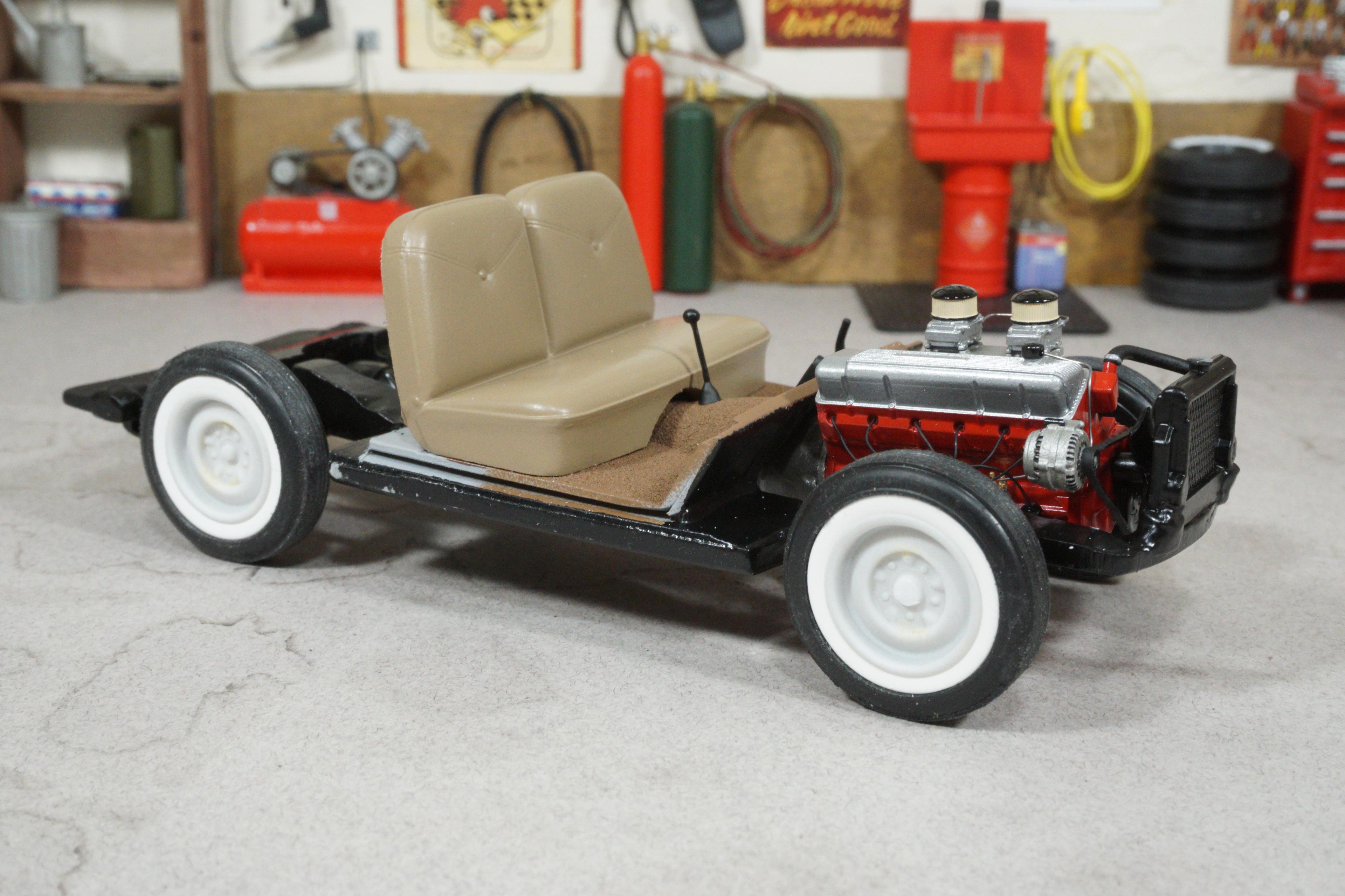

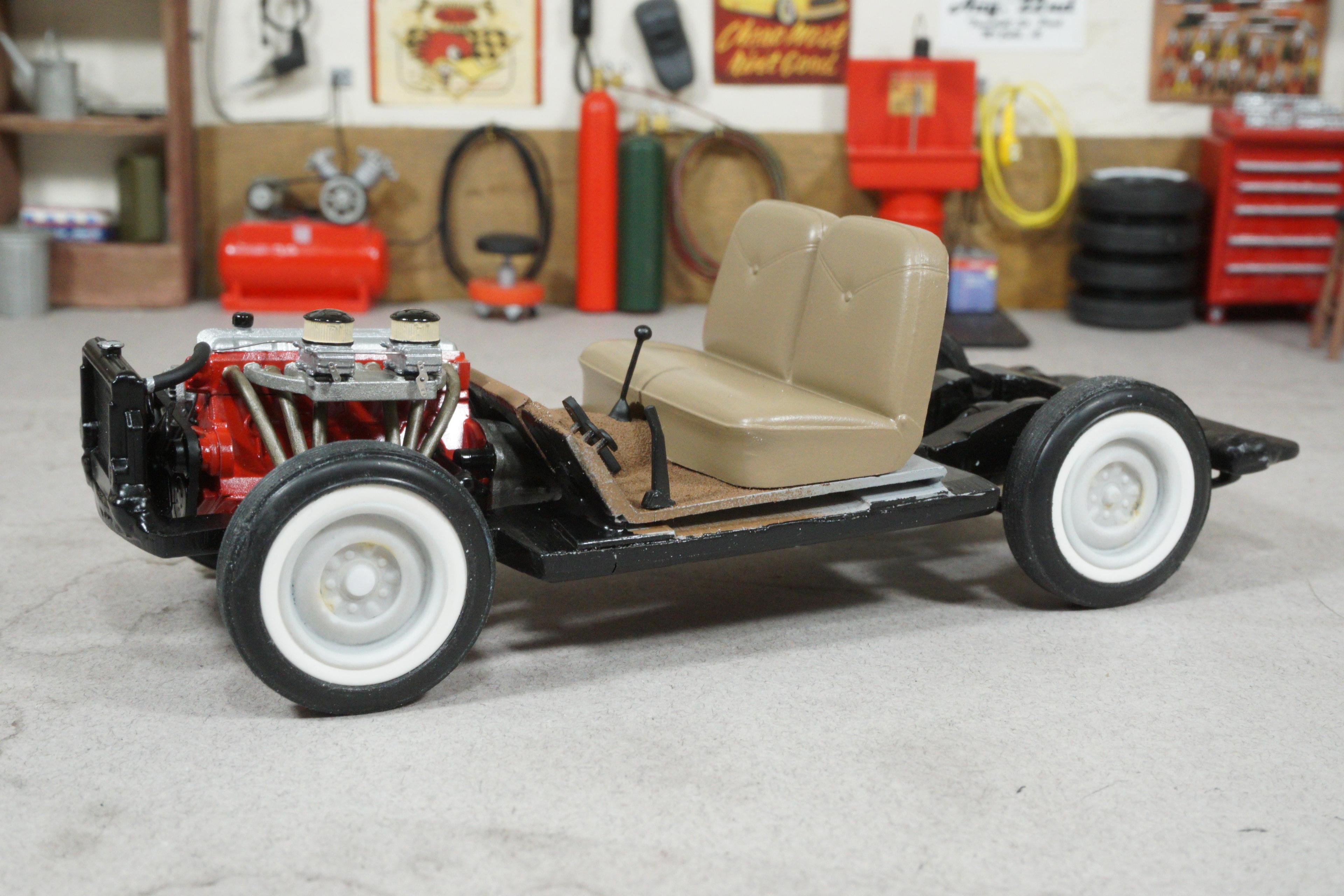

Joe Lange Posted January 3, 2023 Author Posted January 3, 2023 Closer to completion! Engine in chassis, seat and some interior pieces in. Body work, hardware, and paint are next. 2
customline Posted January 3, 2023 Posted January 3, 2023 The engine looks great, Joe. The alternator looks dead-on real. Do you have a particular name/brand/company in mind for the sides? 1
charlie8575 Posted January 3, 2023 Posted January 3, 2023 That hopped-up Slant is cool. Very interesting project. Charlie Larkin 1
Joe Lange Posted January 3, 2023 Author Posted January 3, 2023 7 hours ago, customline said: The engine looks great, Joe. The alternator looks dead-on real. Do you have a particular name/brand/company in mind for the sides? Texas 3D Customs did some really nice detailing. It took very little 'clean-up' work before priming and painting. The carbs are very detailed also. I intend to add some wiring to the alternator. Still thinking about name/brand/company for the sides. Probably go with something 'vintage' from my hometown. Have a lot of fond memories of growing up on Long Island in the 60's. Thanks Jim !

rickcaps55 Posted January 3, 2023 Posted January 3, 2023 9 hours ago, Joe Lange said: Closer to completion! Engine in chassis, seat and some interior pieces in. Body work, hardware, and paint are next. Ho that looks great all mounted in the frame nice.
