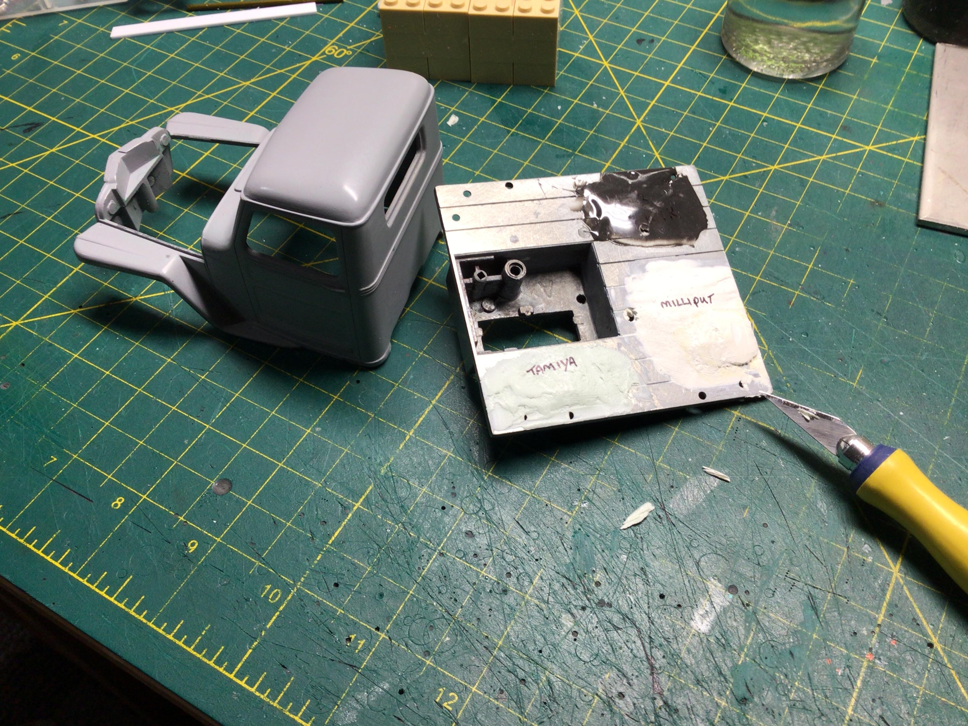

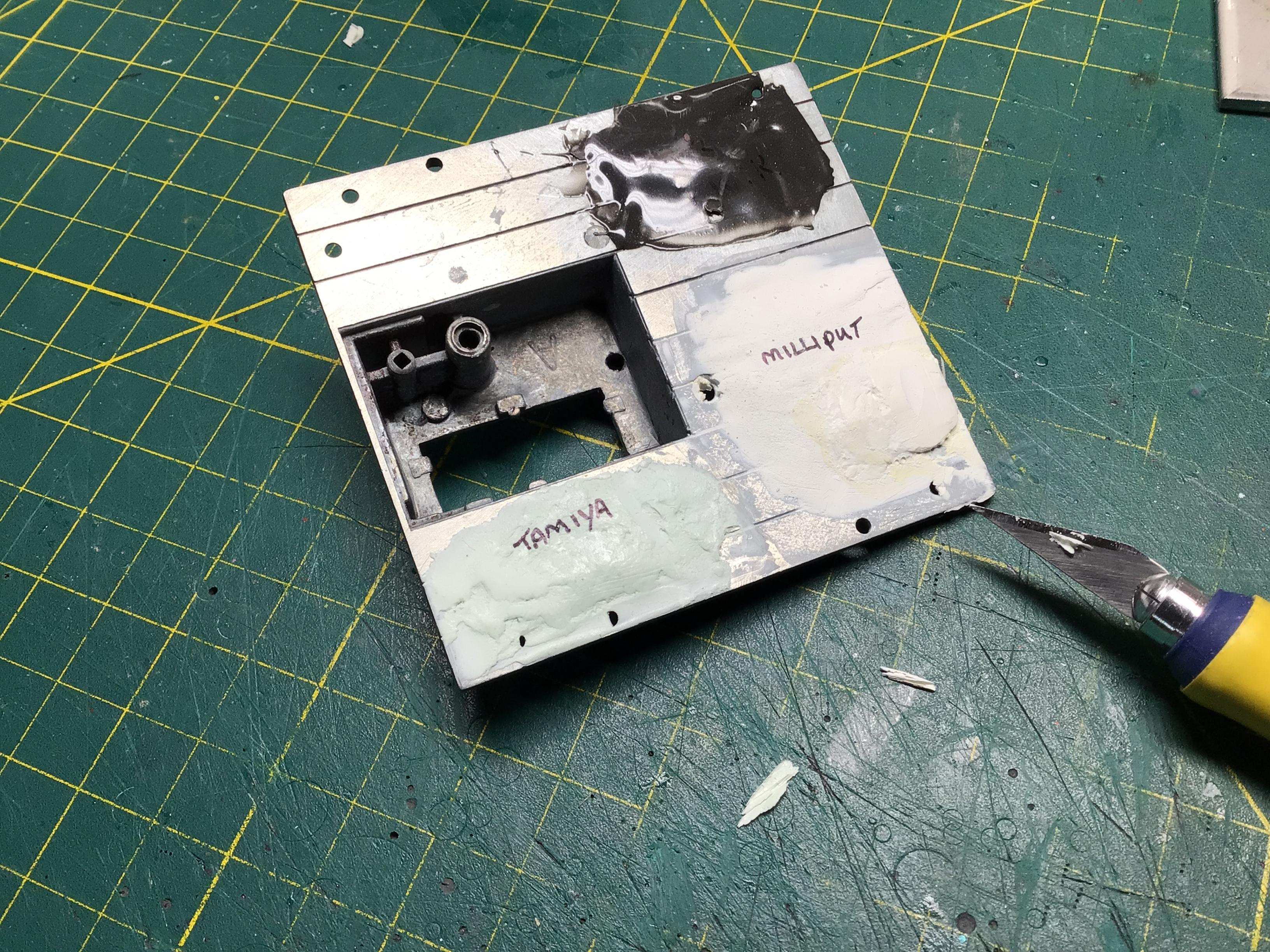

NOBLNG Posted January 1, 2023 Posted January 1, 2023 (edited) It is basically the same as the Milliput fine. They both get rock hard when fully cured. I used Milliput on this roof. From my thread on them: “The Milliput is rock hard and sticks well. The Tamiya is still a little soft (I can dent it with my fingernail) but seems to adhere as well or better than the Milliput.” That was after 2 days if I recall and the Tamiya had soon hardened up as well. They both file and sand nicely. They could possibly be carved with a hobby knife. Edited January 2, 2023 by NOBLNG

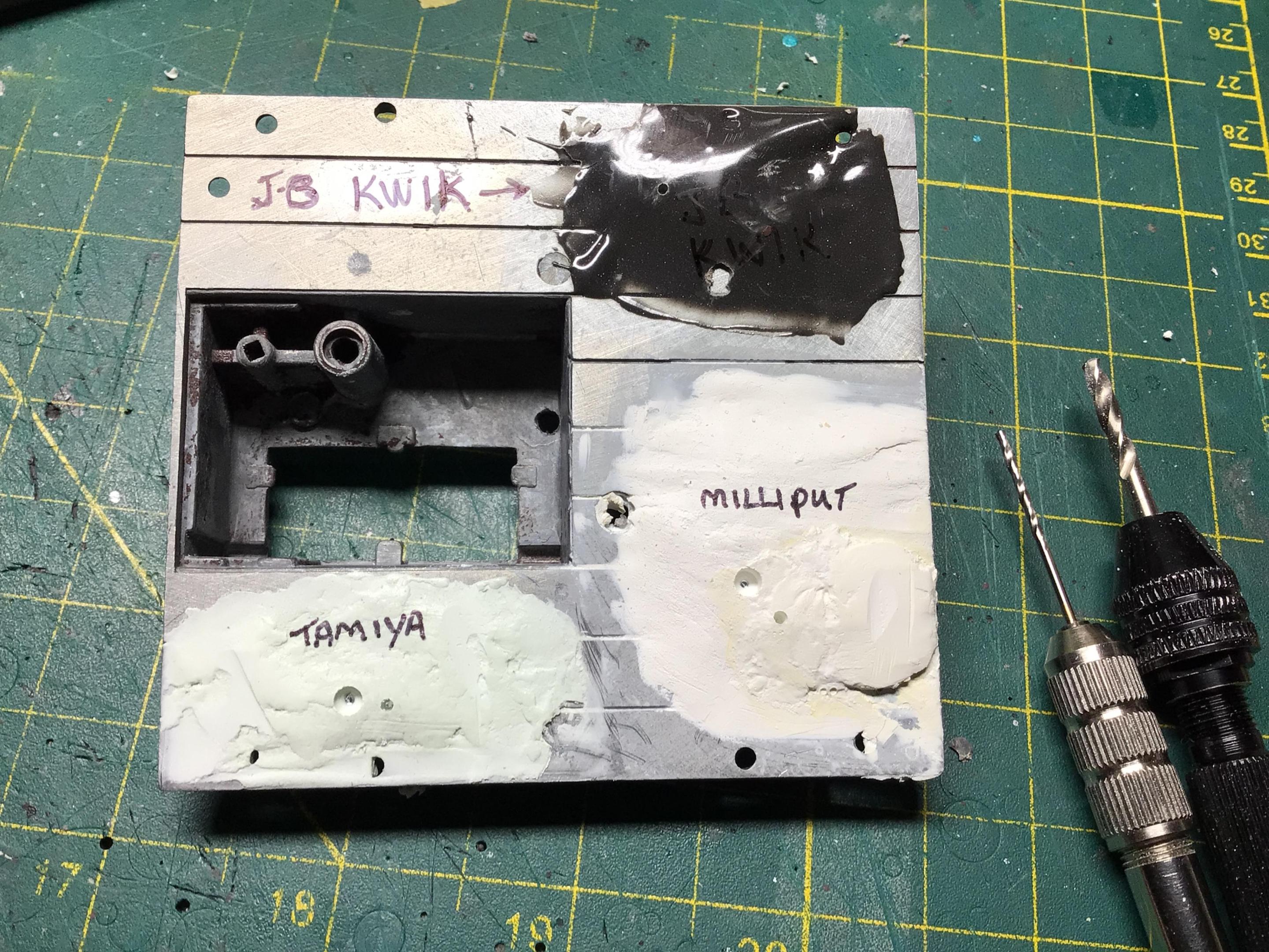

NOBLNG Posted January 1, 2023 Posted January 1, 2023 (edited) I don’t know about thinning the Tamiya stuff? The Milliput can be made softer with a touch of water. I would wear vinyl or nitrile gloves rather than bare fingers for mixing it. It can be easily sculpted while soft and sanded or filed or drilled when hardened. Since it cures by chemical reaction rather than solvent evaporation, it has little or no shrinkage. The Tamiya does seem to be a tad harder now than the Milliput. The JB Kwik in the picture has never gotten hardened. Edited January 2, 2023 by NOBLNG
