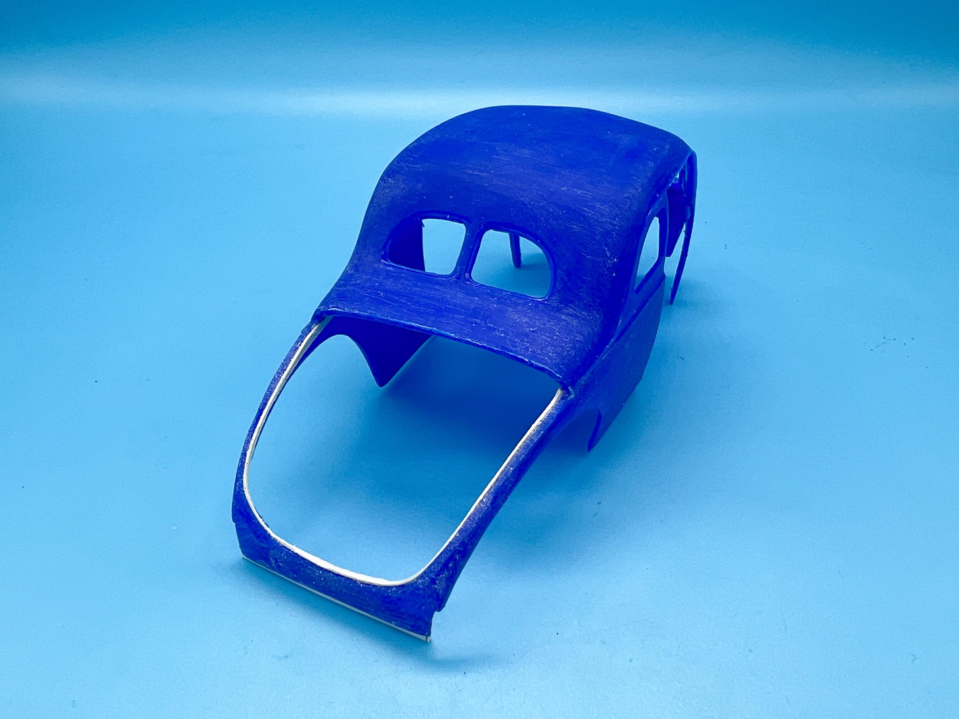

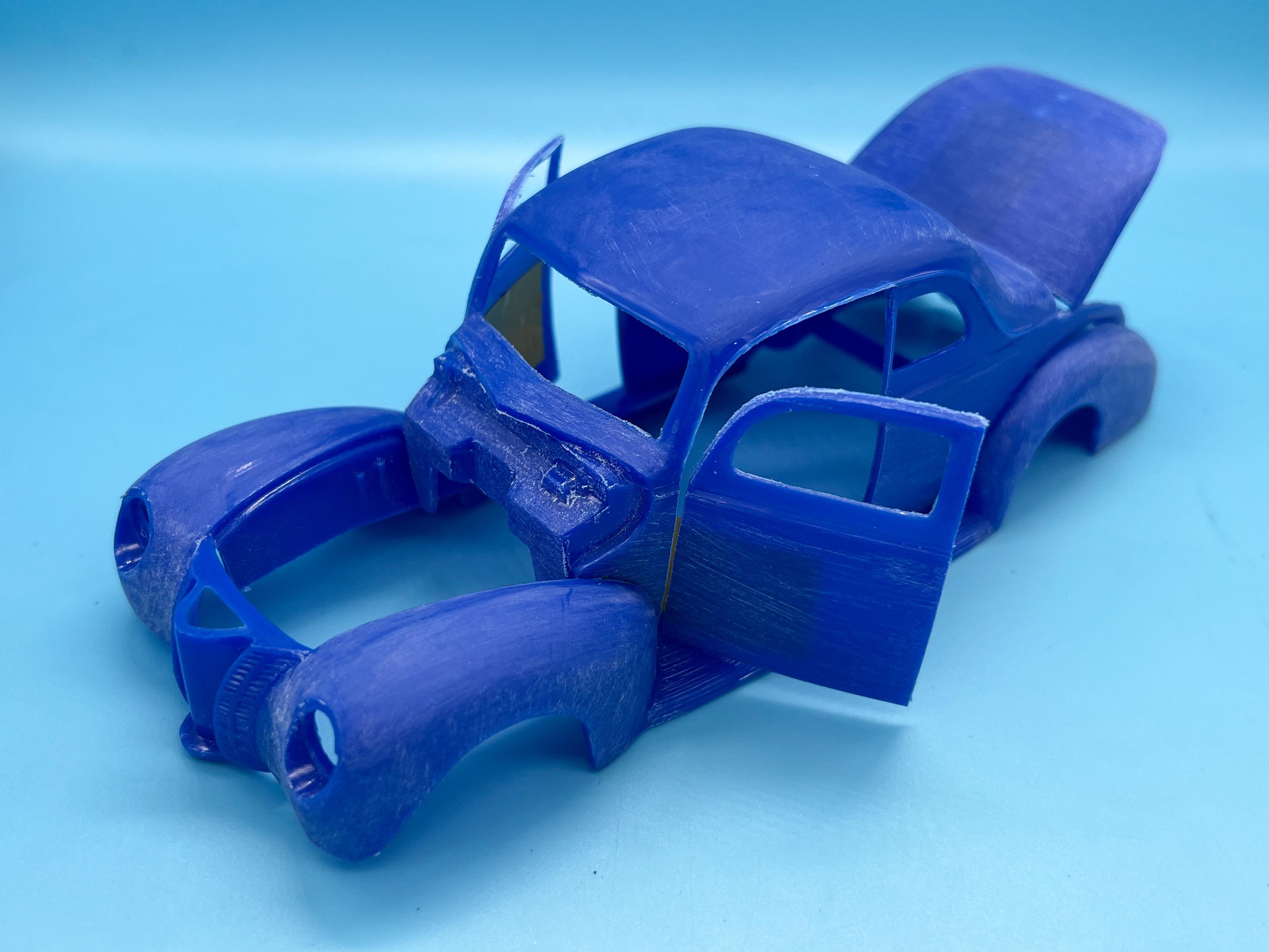

I picked up this Lindberg 40 Ford at a show last year year for $5…and it was probably not that good of a deal even at that price.  But I never build one of these, and I wanted to practice some new skills so I guess here goes nothing…
Spent an hour or so fixing the basics on the body - mold lines and flash and whatnot:

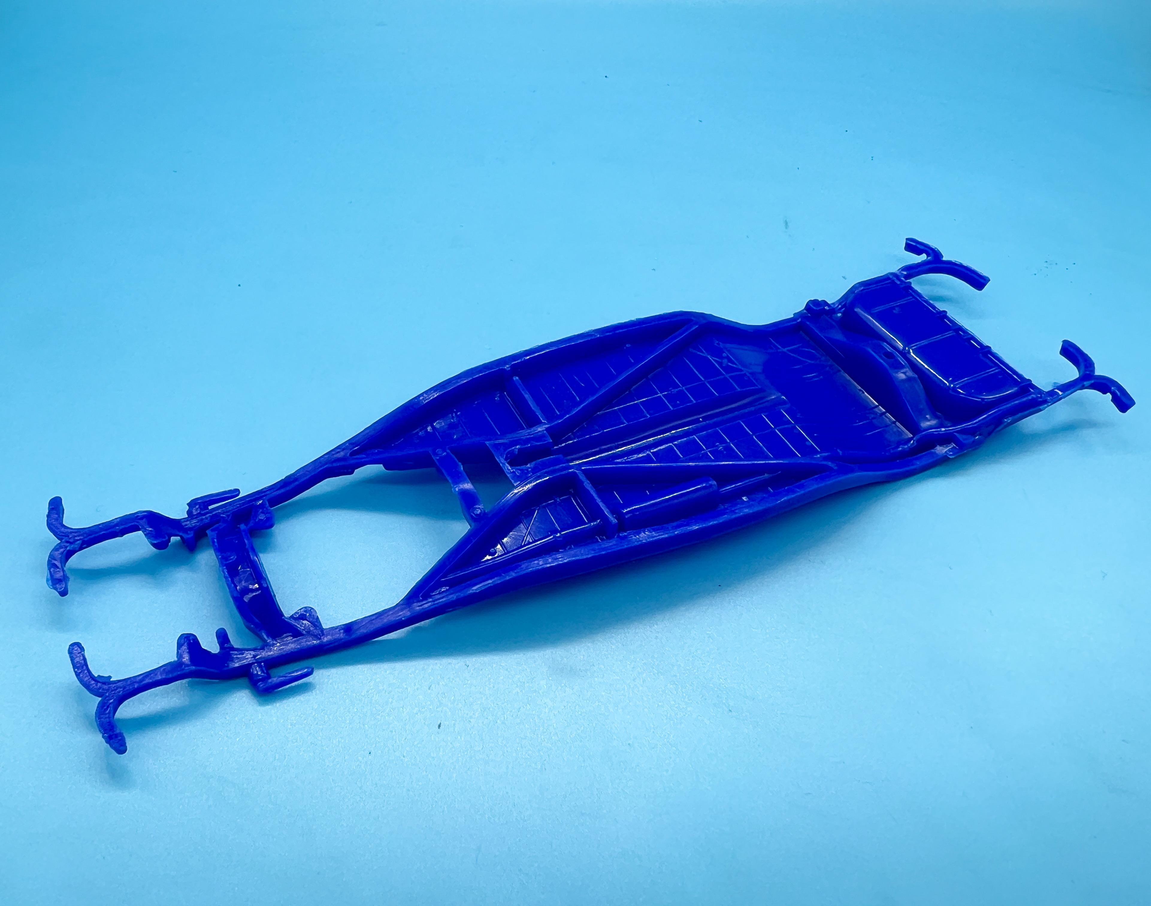

As you can see, the frame has a molded-in exhaust which I’ll be ‘fixing’ and I’ll be using some variation on a Flathead but probably not the kit engine.
That interior tub is probably ok-ish if you paint it a dark color, seeing as it’ll be hard to see unless you opened the doors, so obviously I’m going to make myself a bunch of work and open the doors and go with a white interior instead ?

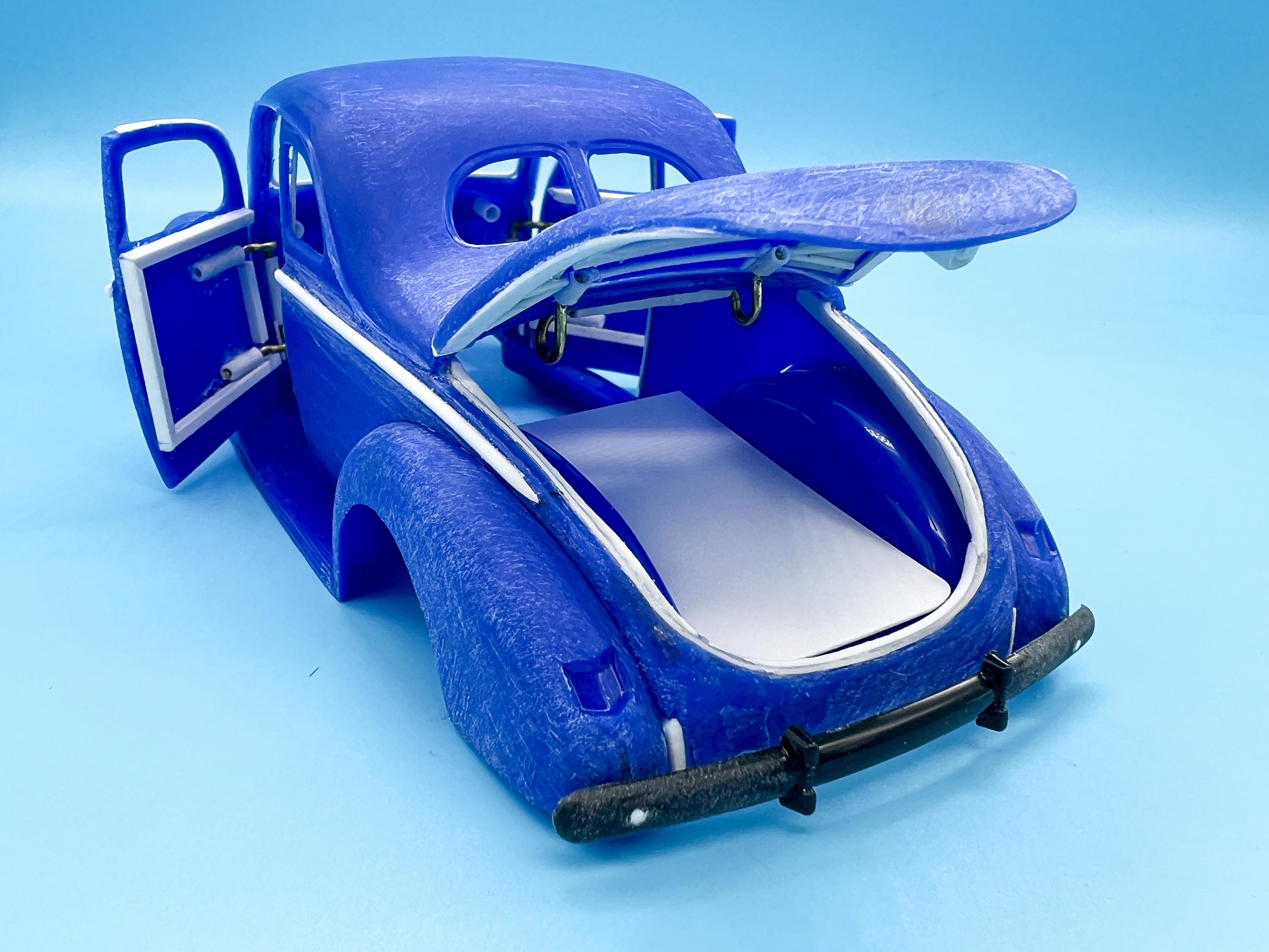

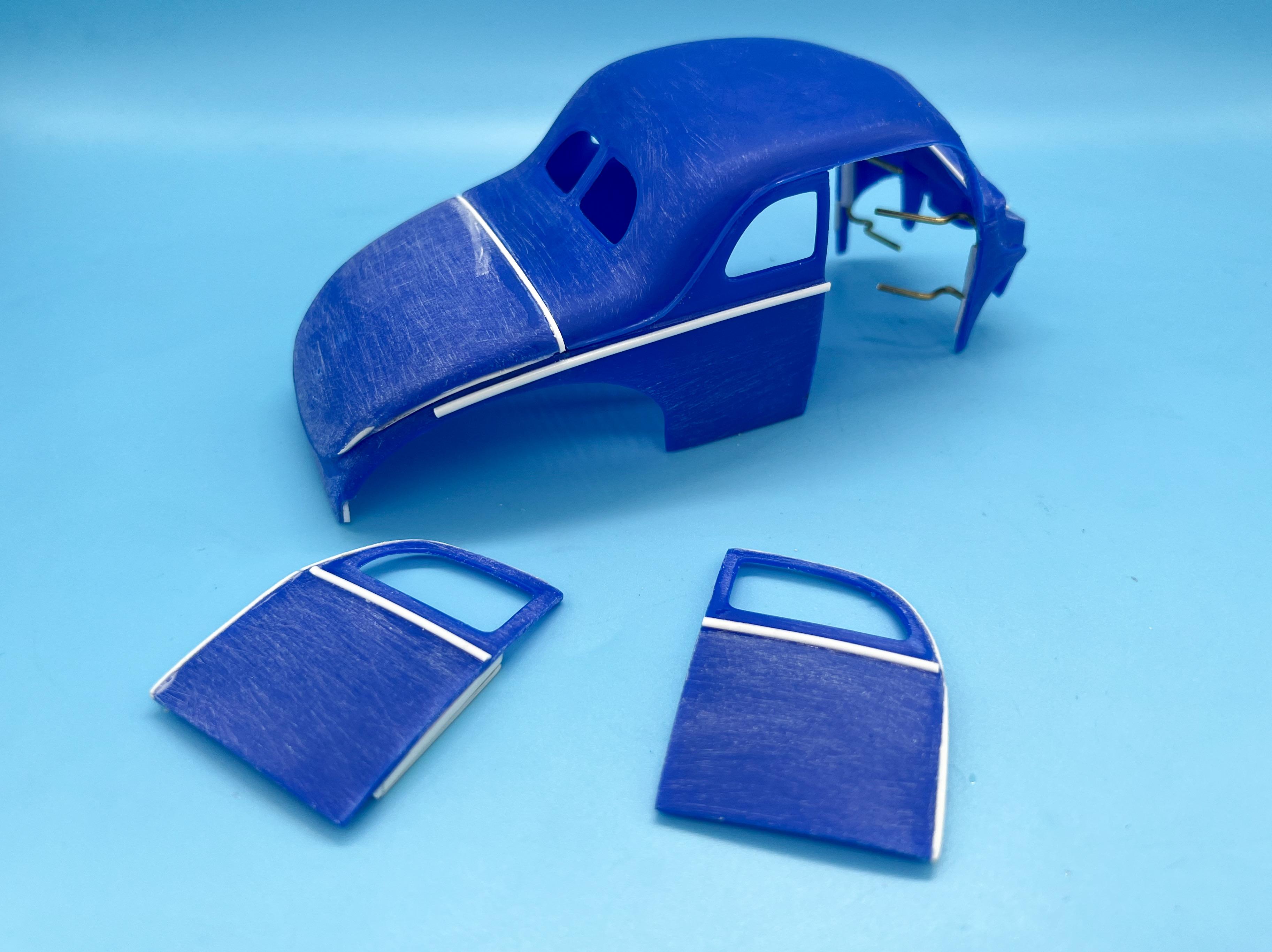

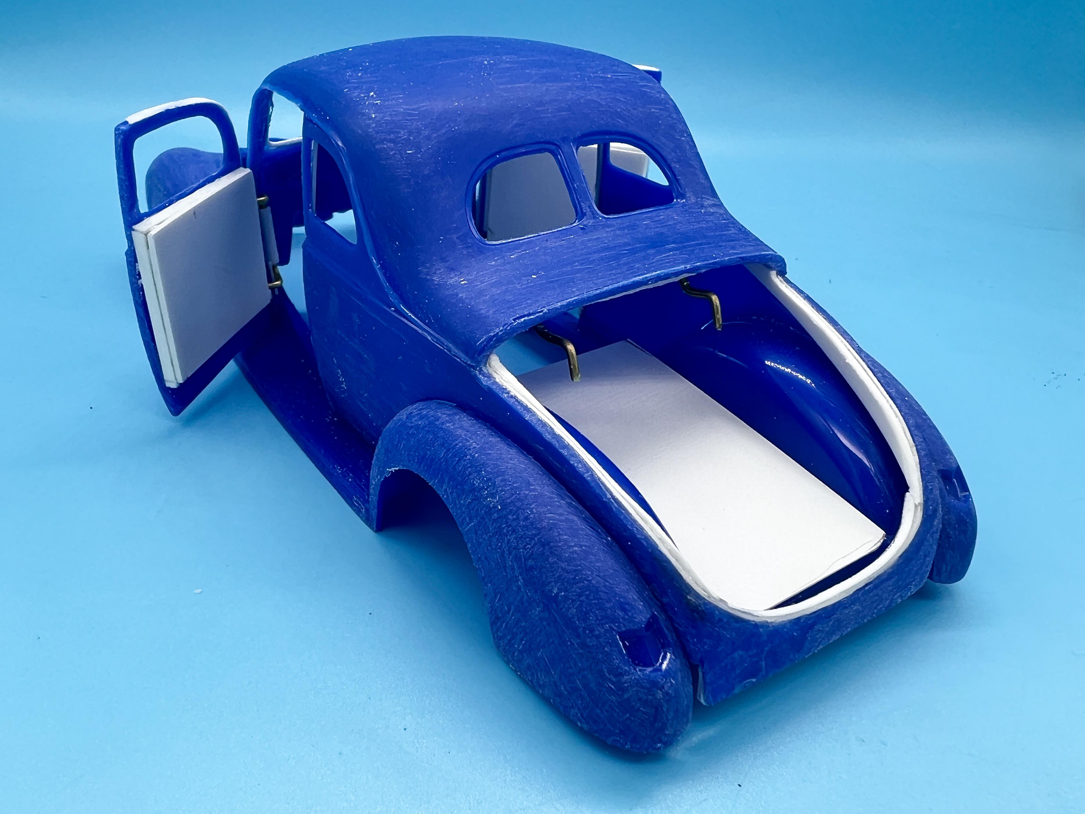

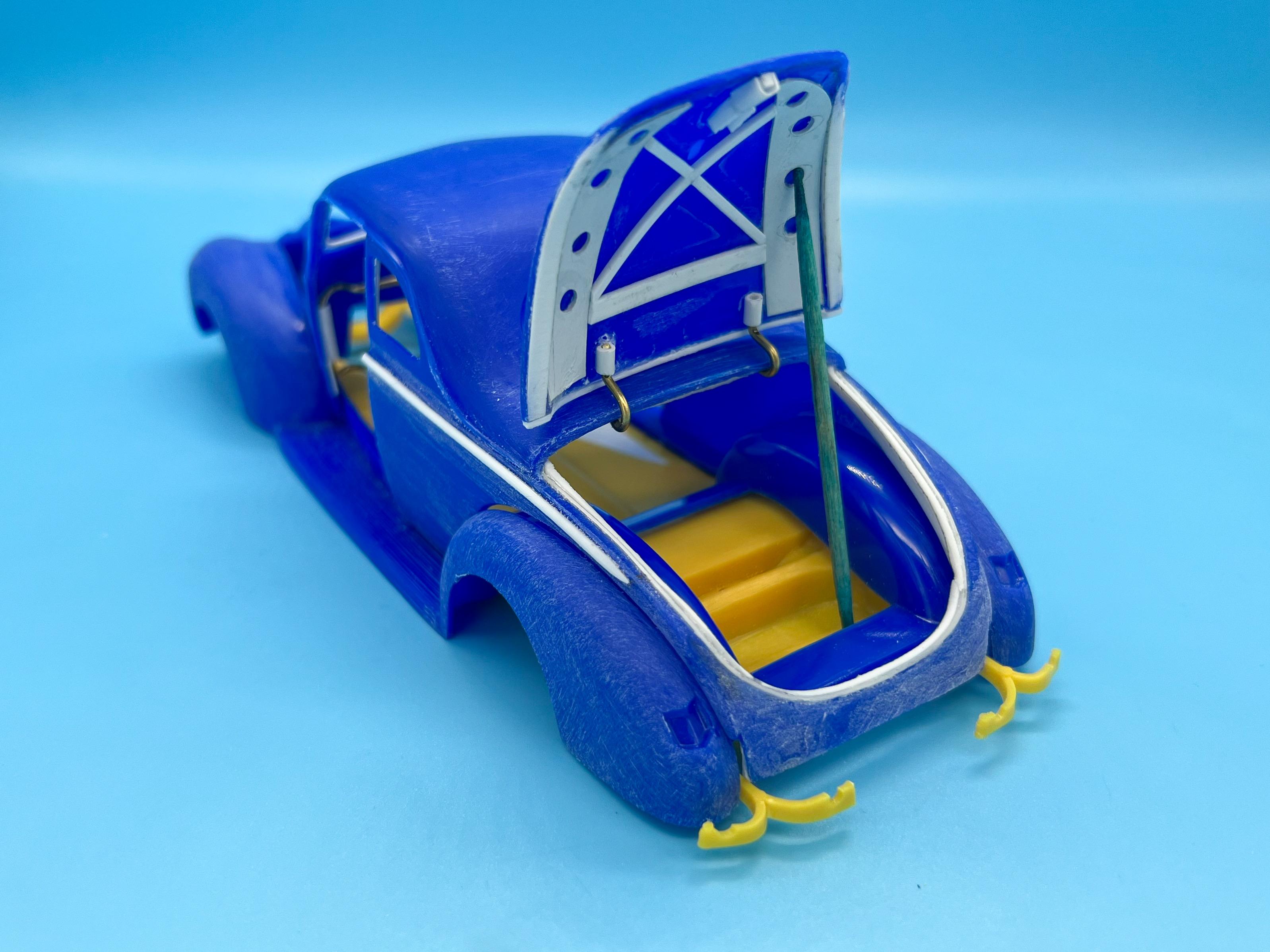

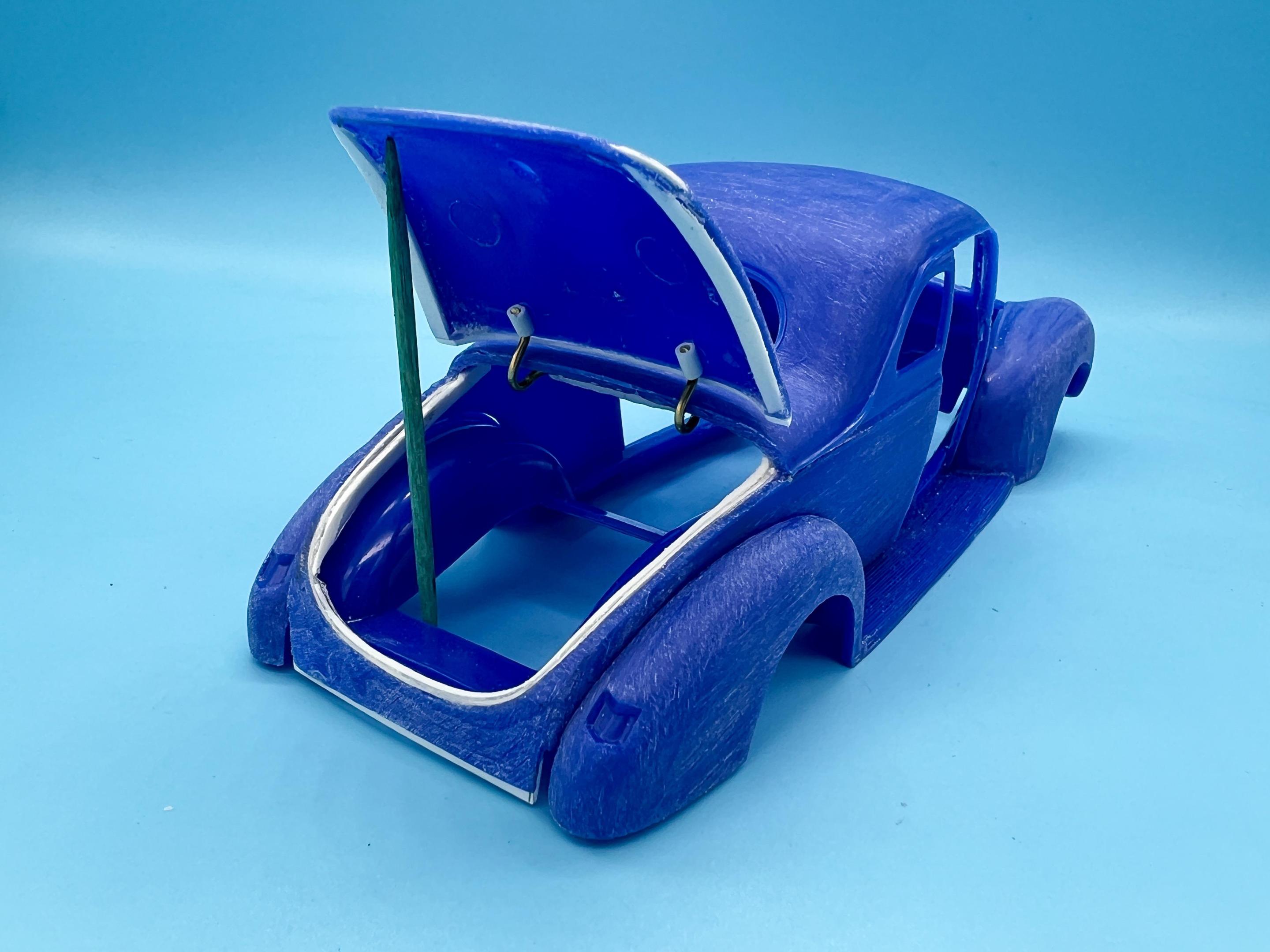

Actually, first, I opened the trunk, which was somewhat tricky cos there wasn’t much of a line to scribe and it kinda disappears at the bottom edge.  Once I got it open, I added some material to the opening AND the trunk lid so I had some meat to work with in getting the fit decent:
A bunch of sanding and hinge-making later…not finished but a decent start…

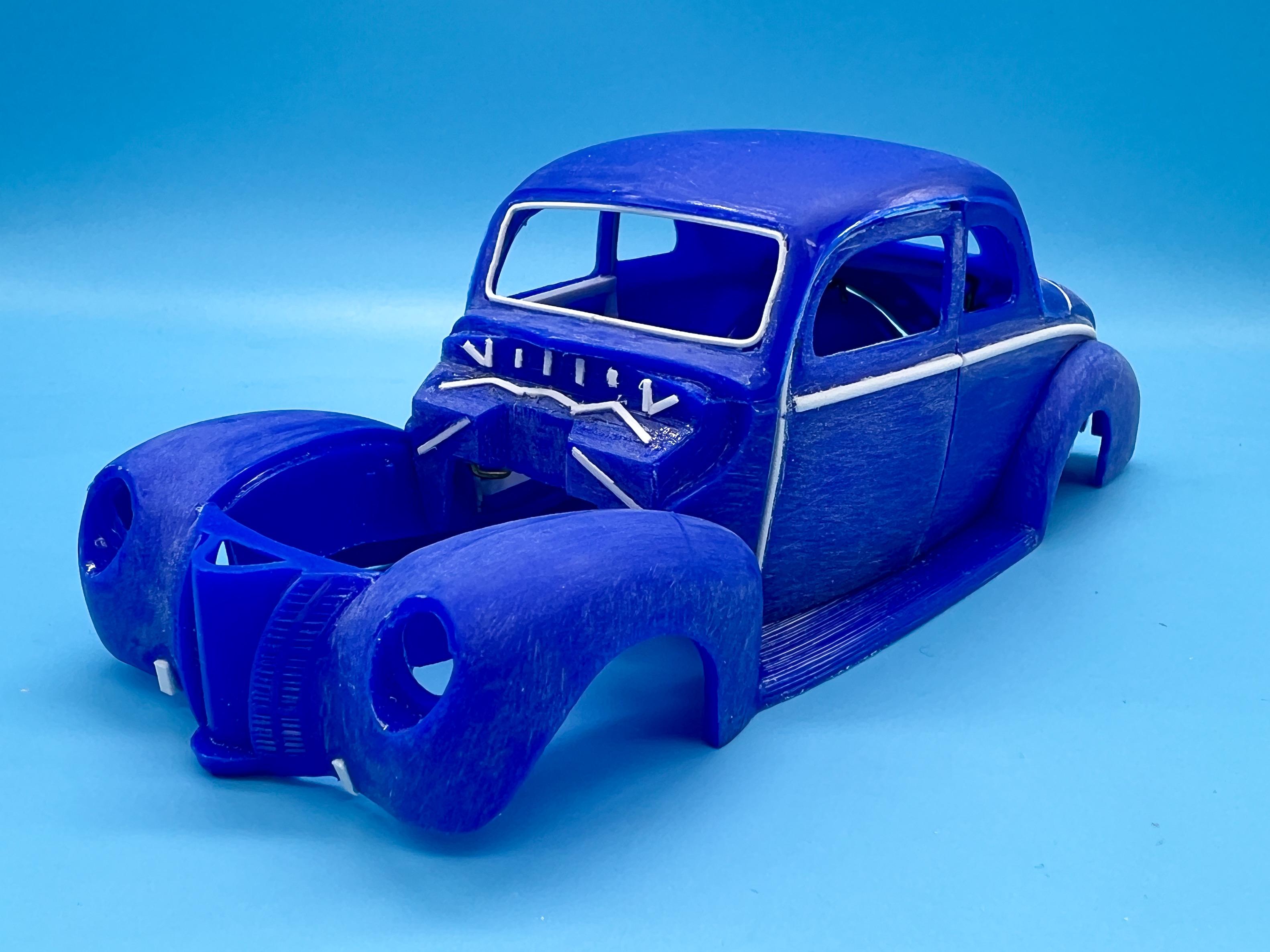

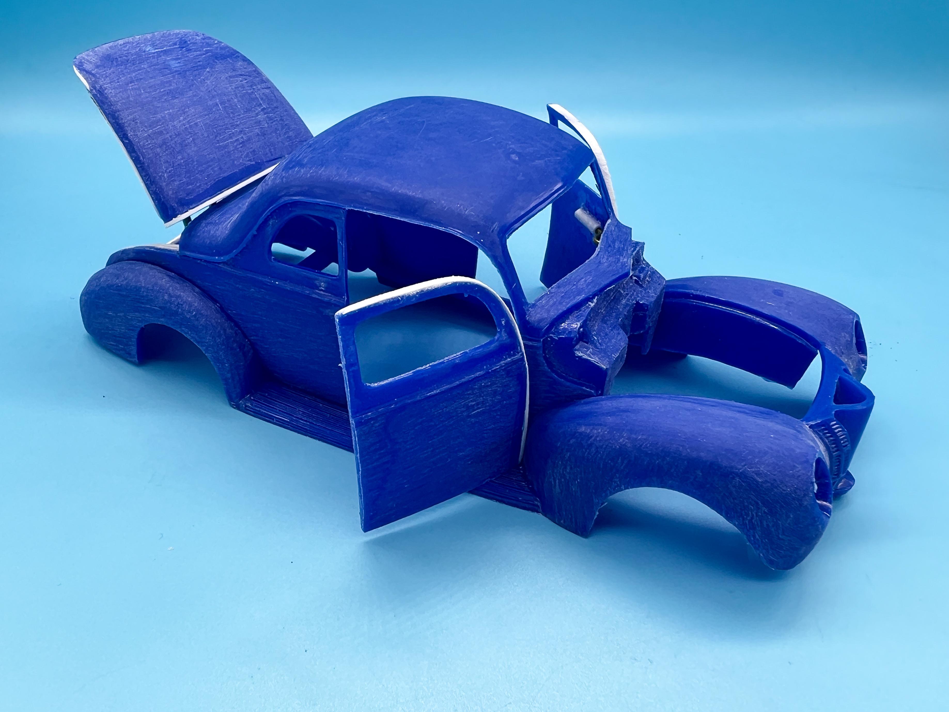

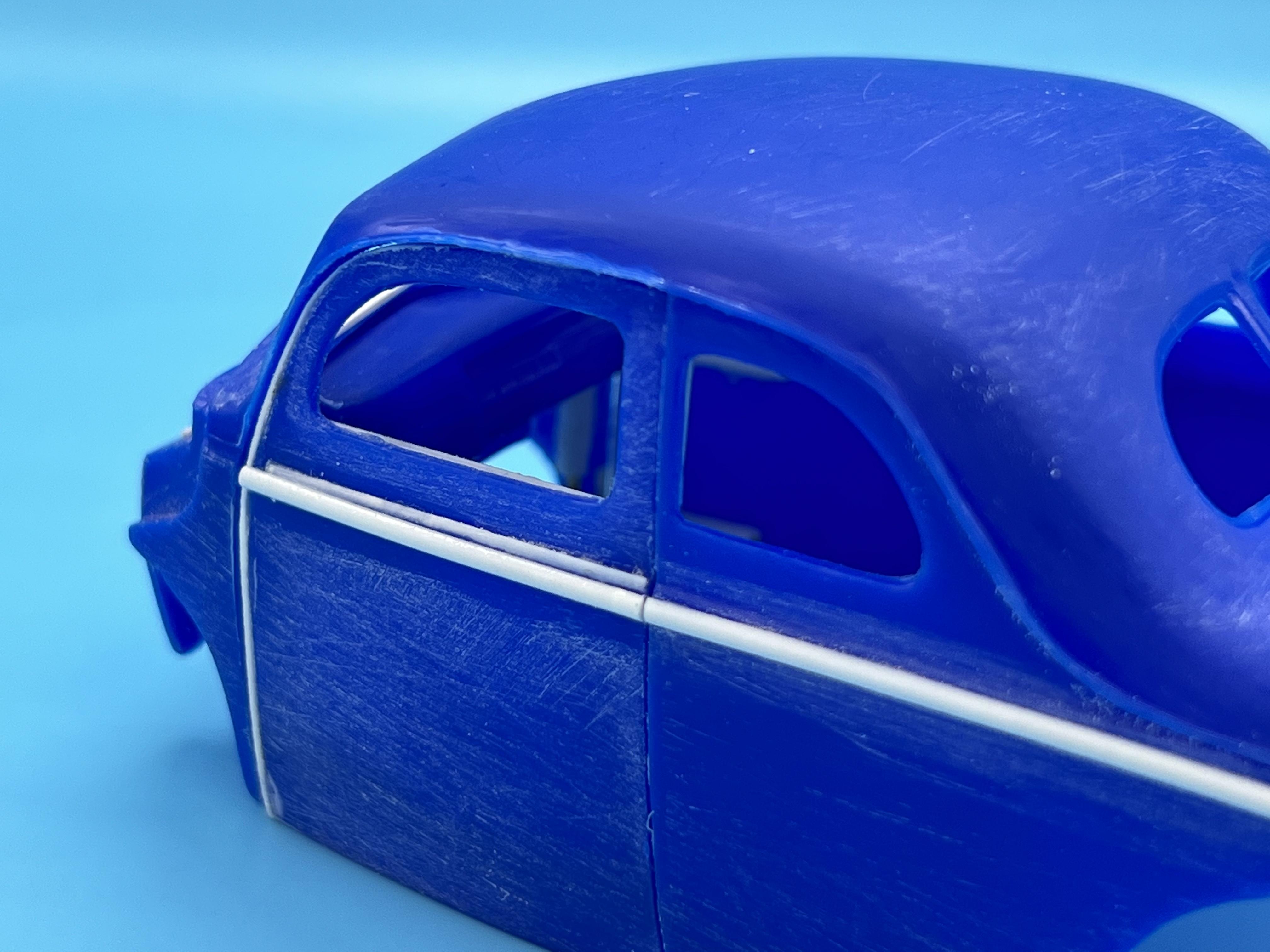

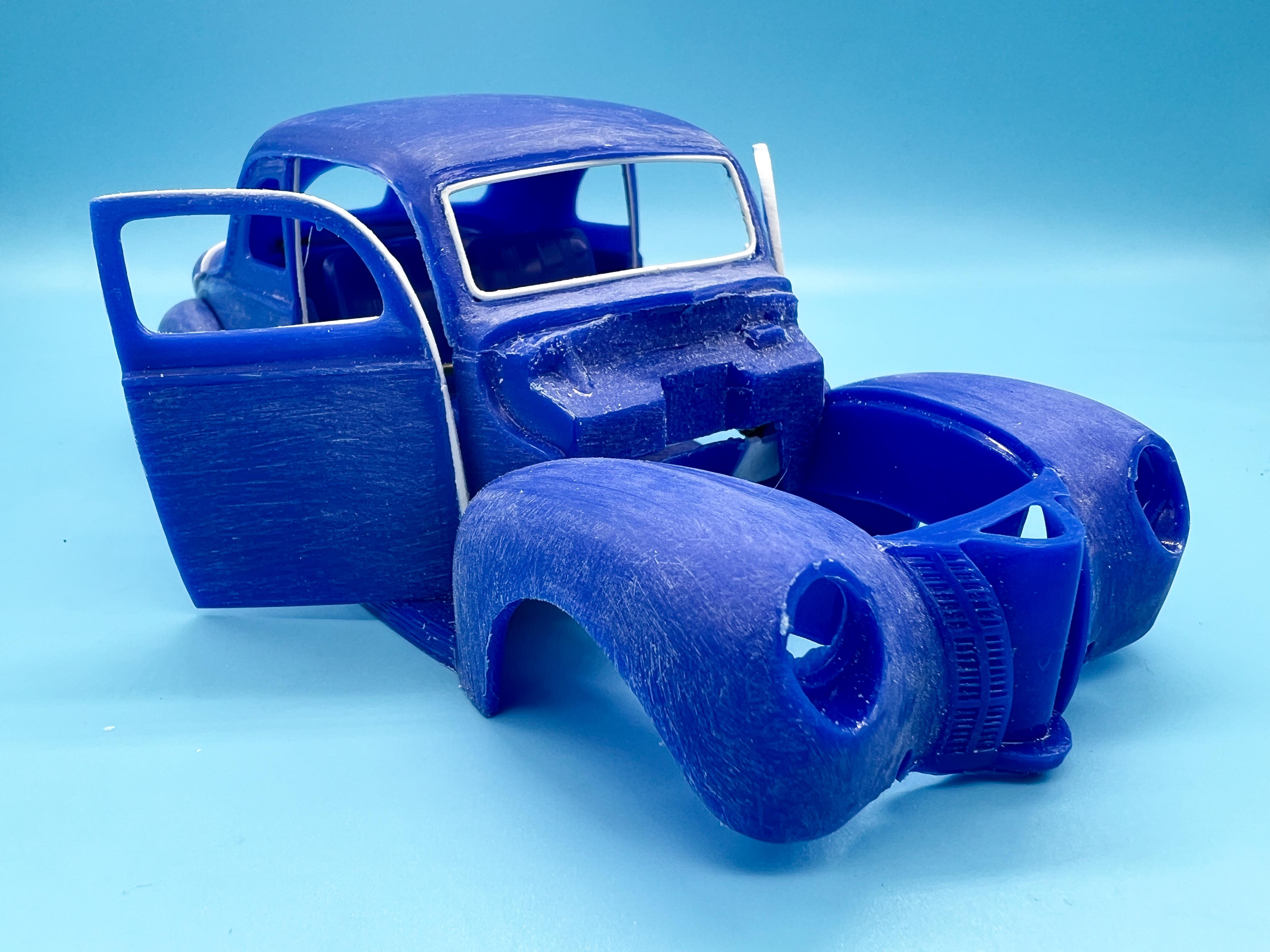

Then, same deal with the doors…add some material back in to account for the kerf of the saw and the material I lost…
Because the back of the doors is a straight edge I could save a little work by using that straight edge as-is and just work the top of the doors and the front edge - got them fairly close to a nice fit.
The hinges are a little beefier than I really needed - but I haven’t done many of these and I weighed up having some extra strength to them versus being able to hide them a little better…hopefully they’ll be hidden pretty well by the time I’m done with the doorcards anyway:
And that’s about where I got for my 6 hours of bench-time today…it’s a start!
More soon, soon as I’ve done more!
  • Like 5
Man...that is looking purdy sharp Jim.  I like how you made those hinges.  What size wire did you use?
I meant to measure it or find the packet when I was in the shop today but I forgot…but it’s about paperclip wire thickness, to give you an idea… ?

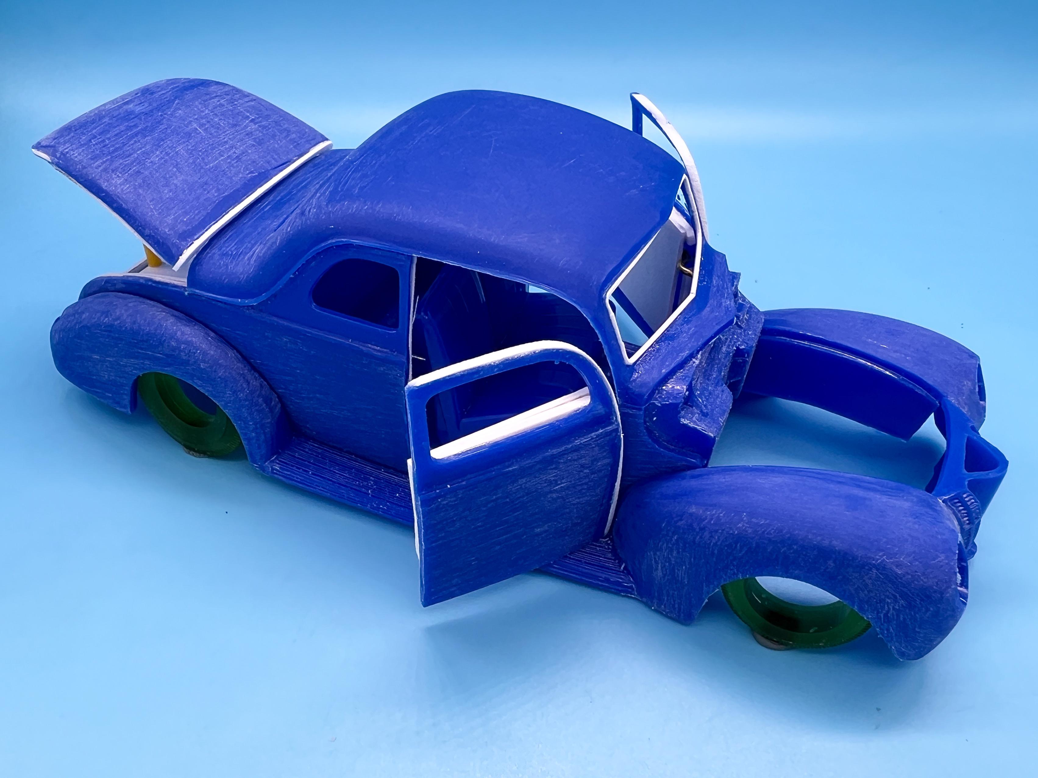

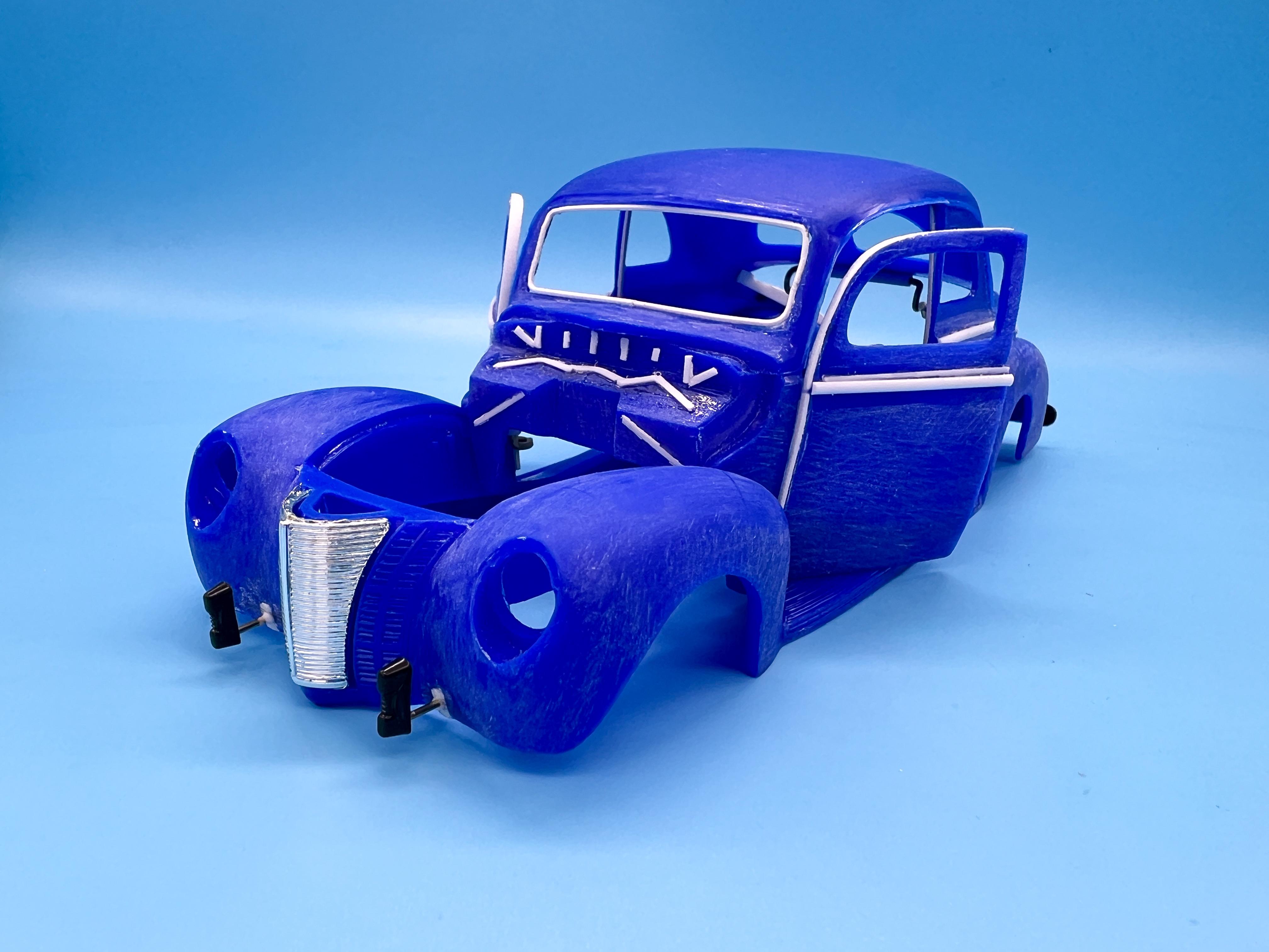

First job today was rough-out a floor for the trunk and some doorcards.  Not terribly difficult work, but I wanted to get some styrene cut to make sure I wasn’t going to have any fit issues what with the opening doors…
I’m going to use some thinner material for the door-cards, but I know now everything fits how it should and the doors open and close ok…
Next job was replacing the trim (actually, rubber) around the windshield…I removed the molded-in wipers and it was easier to remove this line altogether and recreate it rather than try fix it:

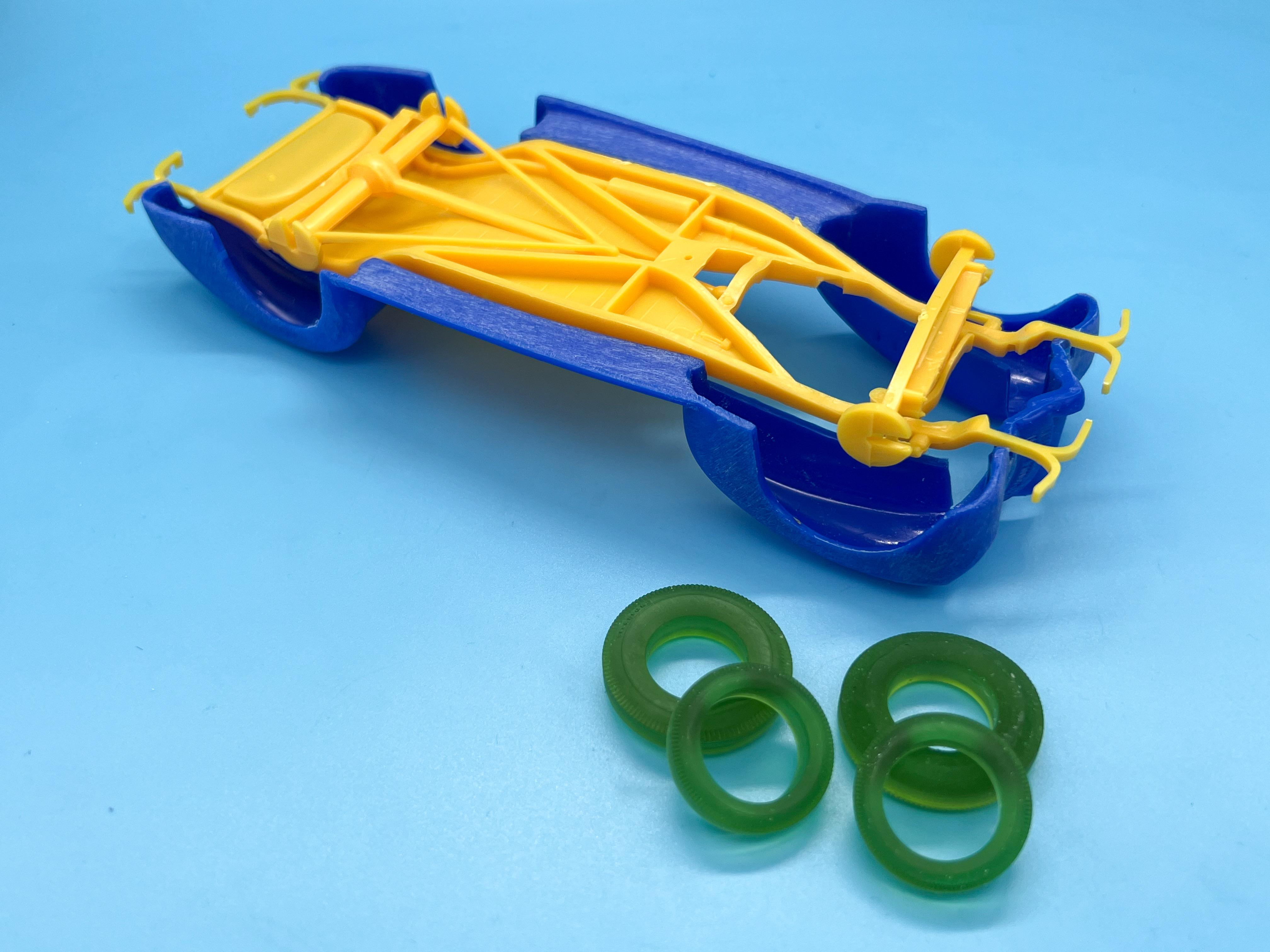

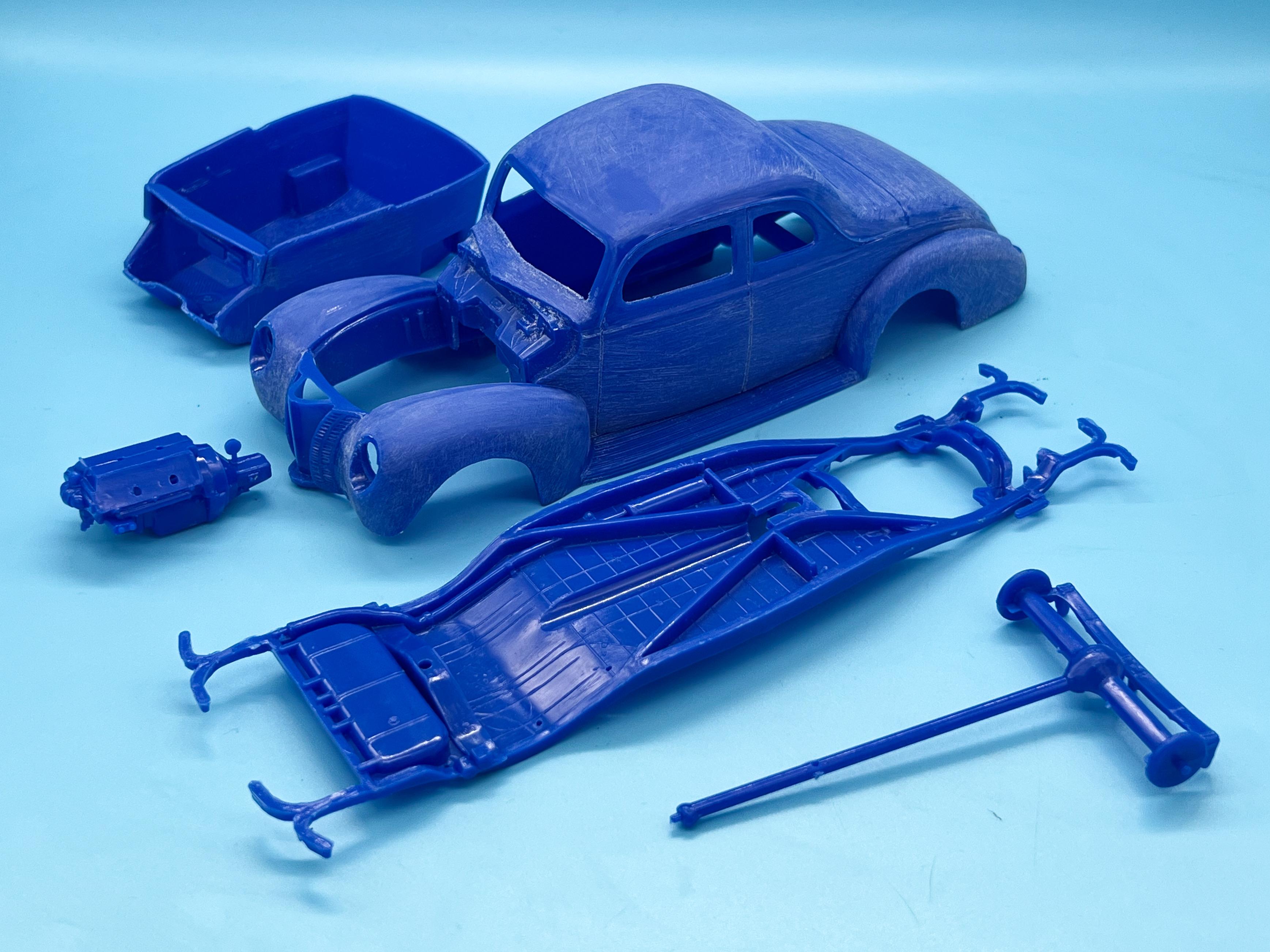

I was going to make a start on the frame, and decided to pull out an AMT 40 Ford kit to compare.  They’re REALLY close to being identical, but not quite.  Most noticeable detail was the engine mounts and the notch for the driveshaft being different between the two.  Oh, and the AMT is WAY crisper and nicer (relatively…).  Looks like I‘ll be using the bright yellow frame (this build sure is colorful so far…)
I’d like to improve on those axles - the front one seems particularly oversized and blocky but I didn’t research 40 Ford front axles yet so maybe I’m too used to seeing 32 and Model A axles…it’s back to the library for me!

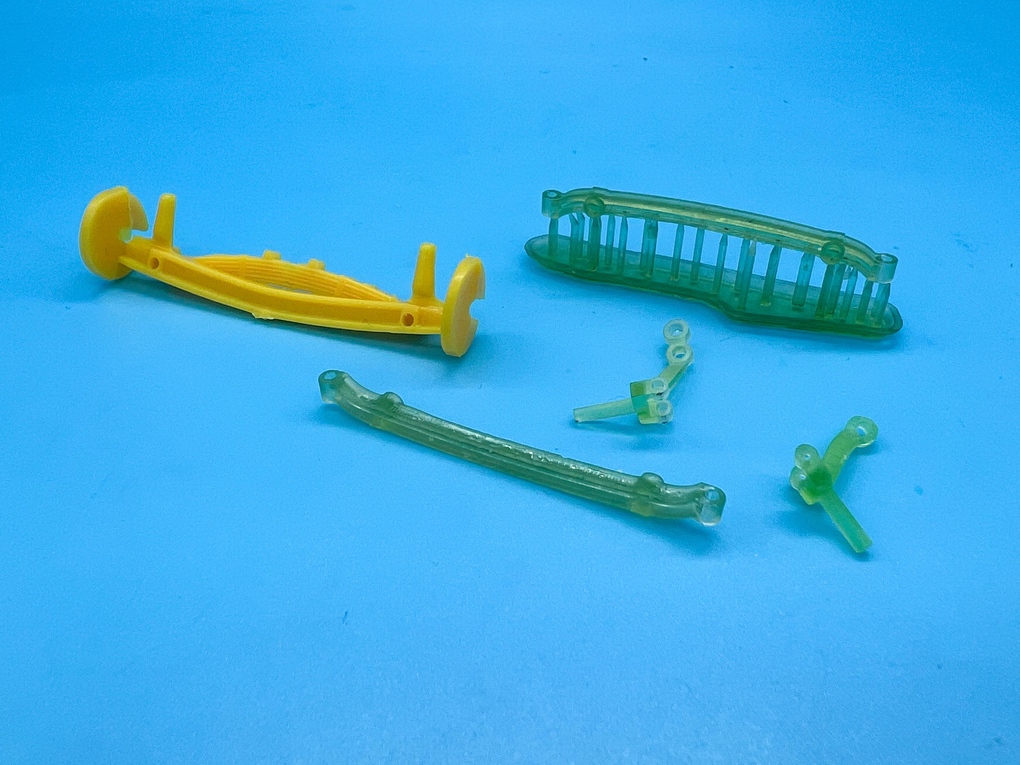

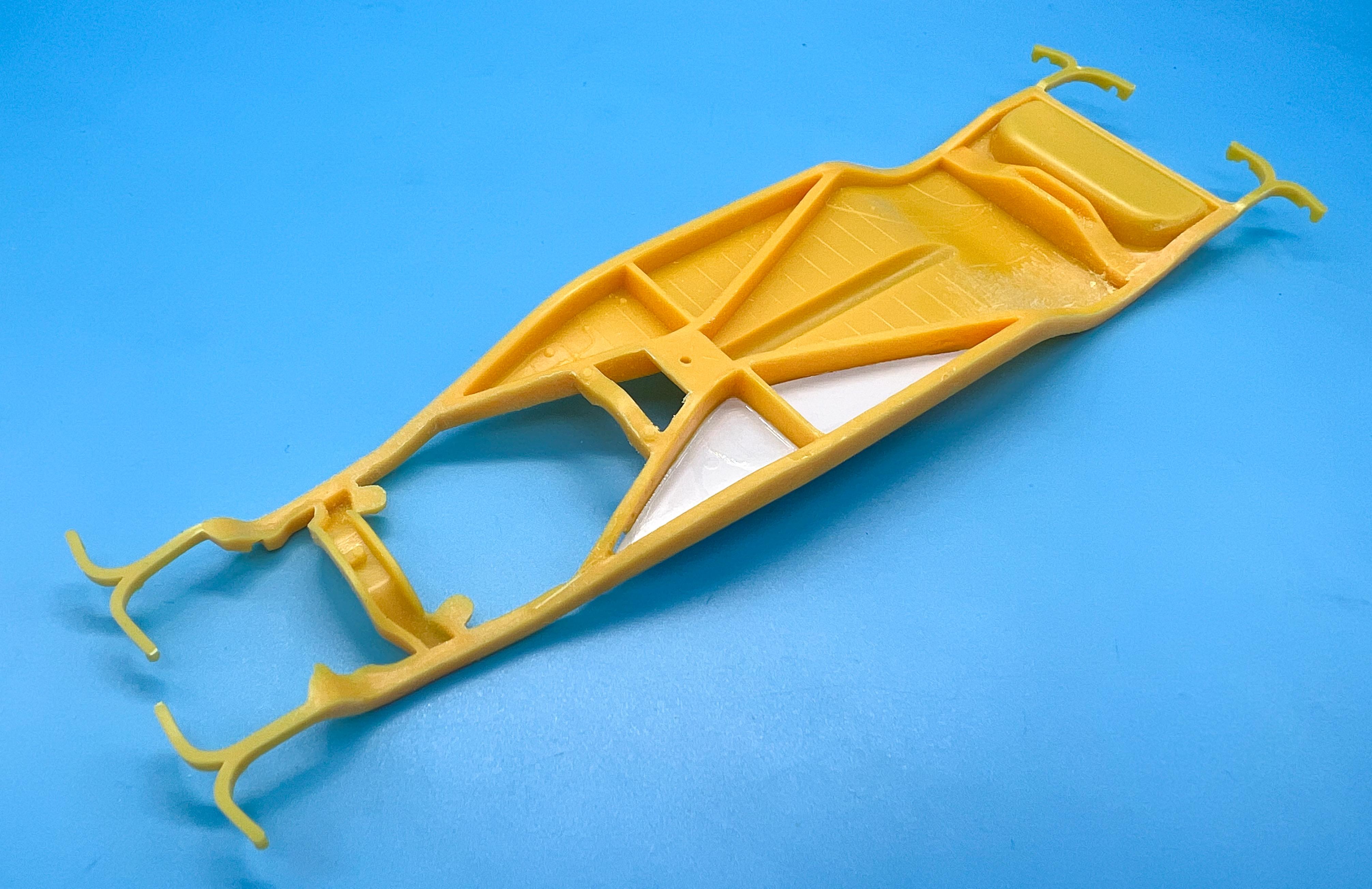

Tiny bit of progress, seeing as I’m replying anyway…started cleaning up that frame.  Removed the exhaust and started patching up the couple of floorboards I had to remove in the process.  Tomorrow I’ll go through and scrub the detail off the remaining floorboards so I can detail it back up and have it look consistent…

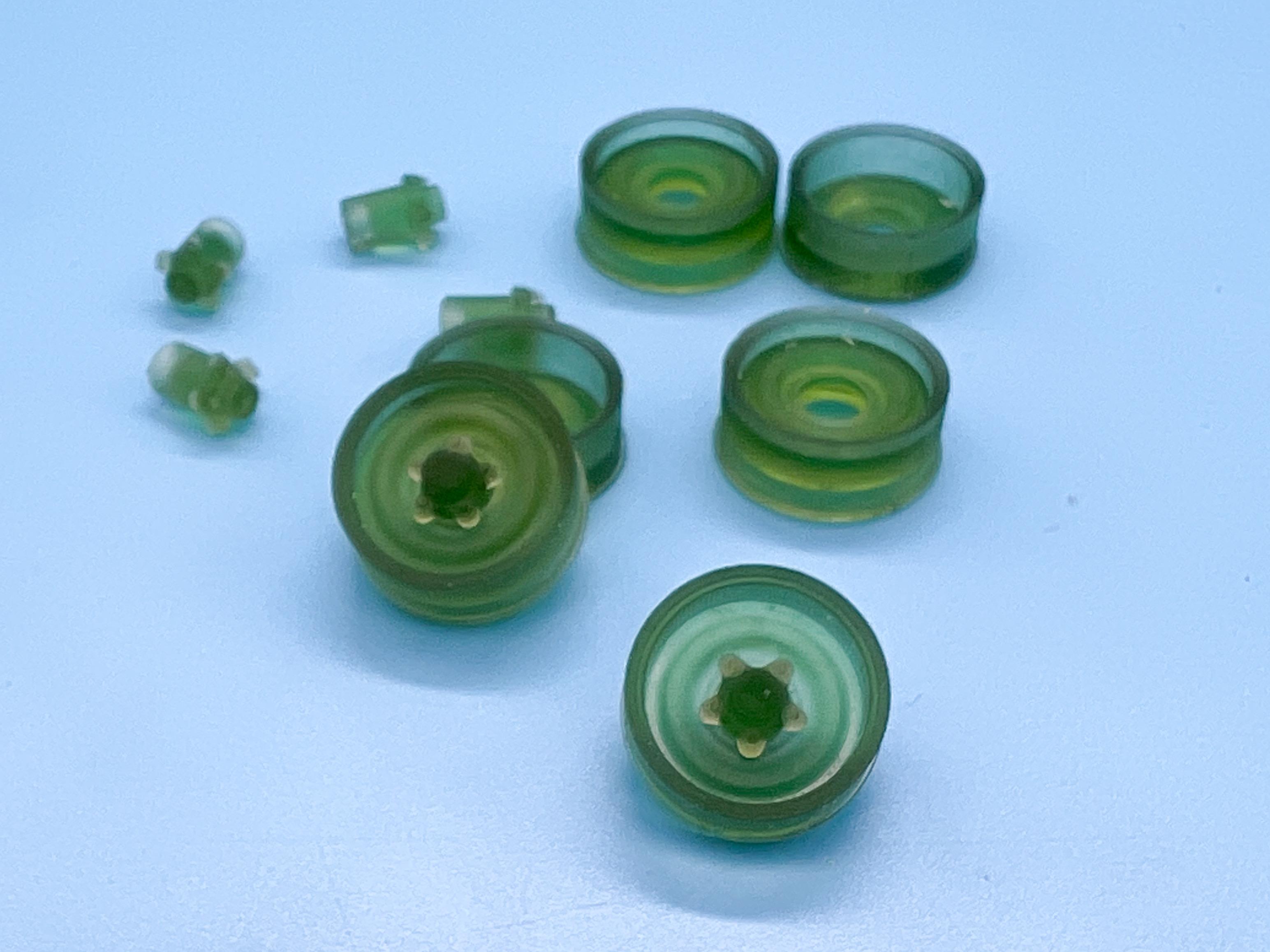

On my lunchbreak today I found plans for a 1:1 40 front axle and used them to draw one up and made a file I could 3D print…it’s not perfect and I had to make some concessions to make sure it would have a chance of not bowing over time, but it’s a big improvement on the kit piece anyway…
And finally, I did some hunting on Cults for the wheels I had in mind for this build.  Went to buy the file, and discovered I bought it last year and forgot.  Thanks past-Jim!  I had to lighten the contrast in these pics so the detail would show properly - I’ll take some more pics when I’ve shot a little primer on them:

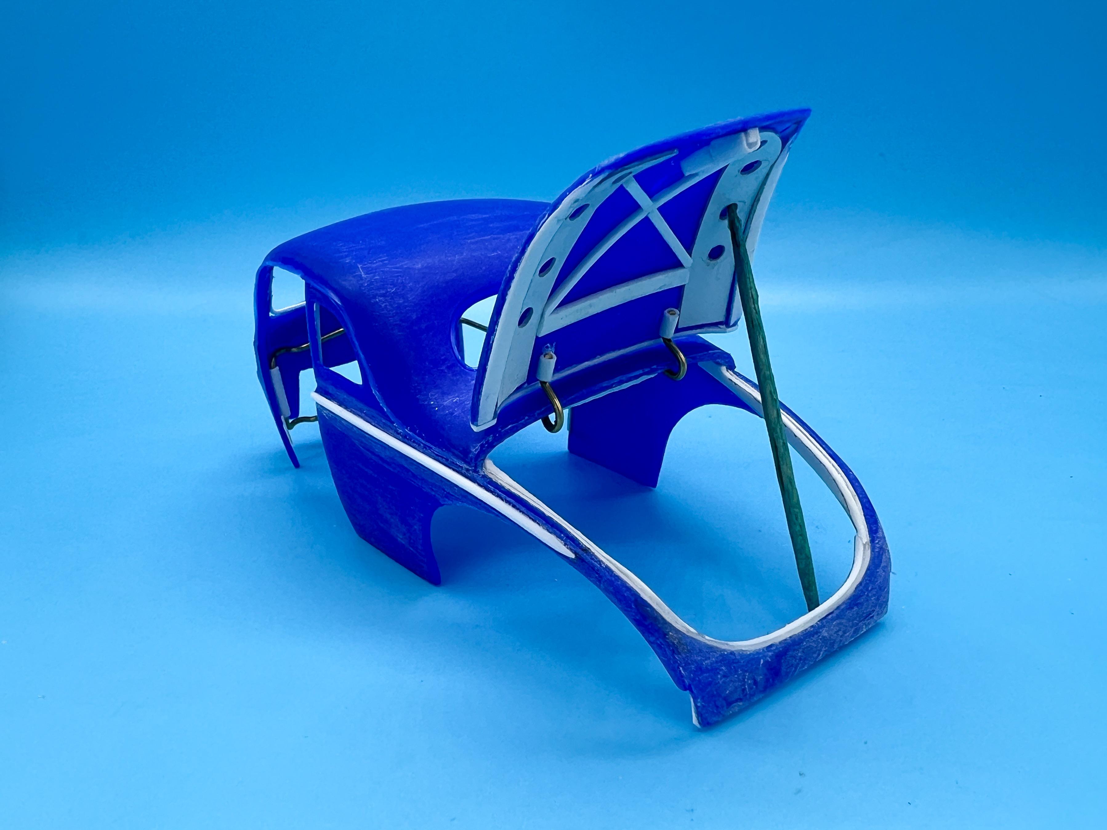

And whilst the glue was setting on those bits and pieces, I started adding some inner trunk-lid detail.  I don’t intend to ever display this build with the trunk open as far as it is in these pics, so most of this won’t be super visible, but I wanted SOMETHING in there:
This weekend’s projects will be getting that body in primer, hopefully, and then doing a little kitbashing of the kit engine and this 3D printed one…spoiler alert - I’m not using MUCH of the kit engine…

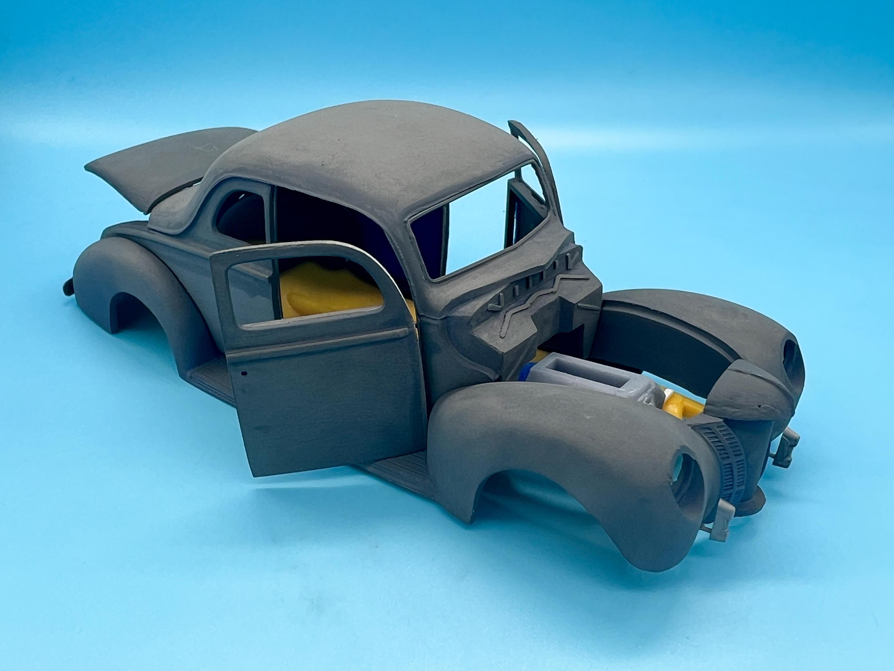

First project was figuring out how to attach the dash to everything else.  It USED to attach to the interior tub, until I stupidly opened the doors and made that impossible ?.  I ended up gluing some tapered plastic pins to the back of the dash, and some receivers inside the body - perfect push-fit every time!
Everything clears…
And the doors still close properly!

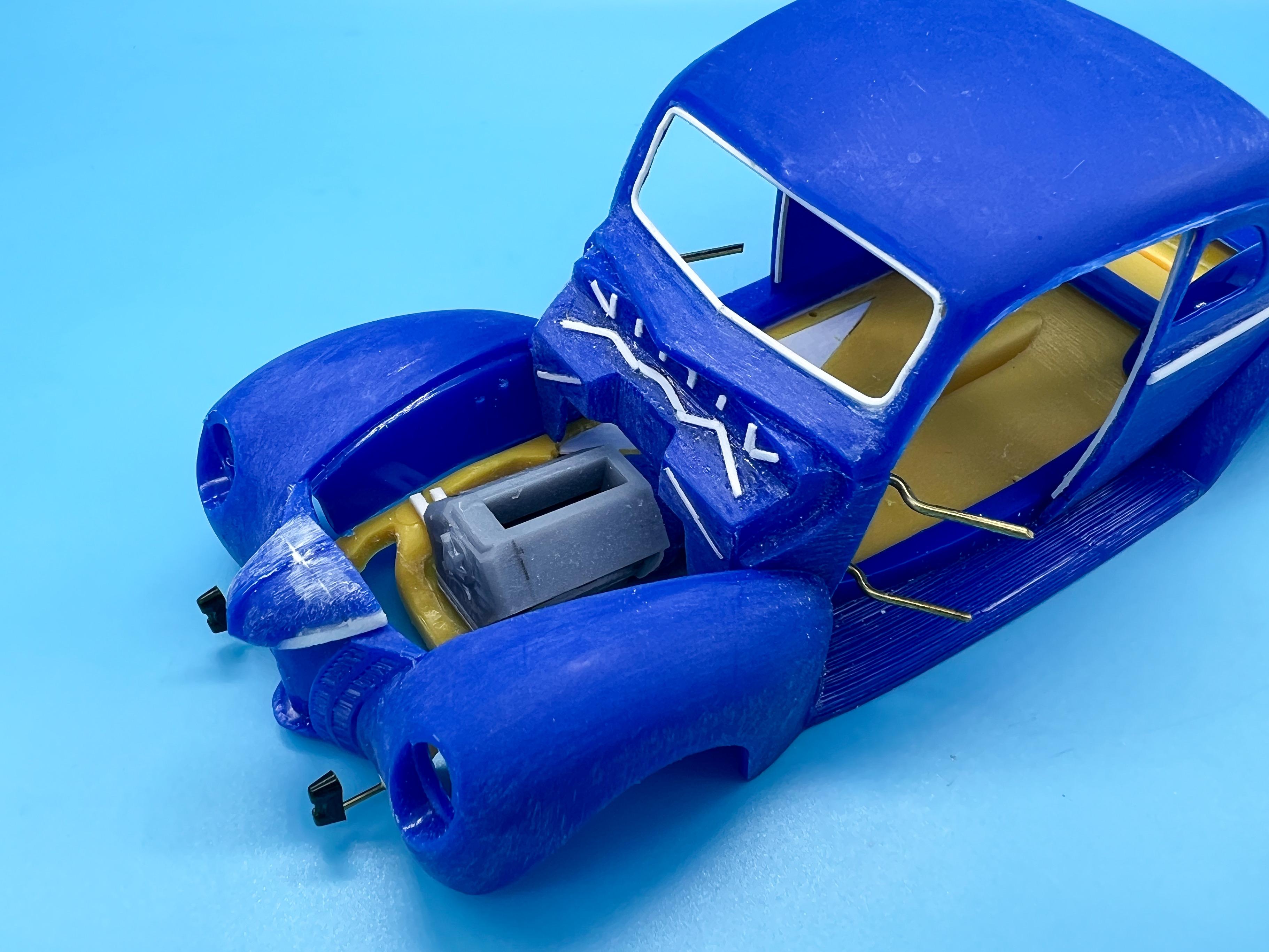

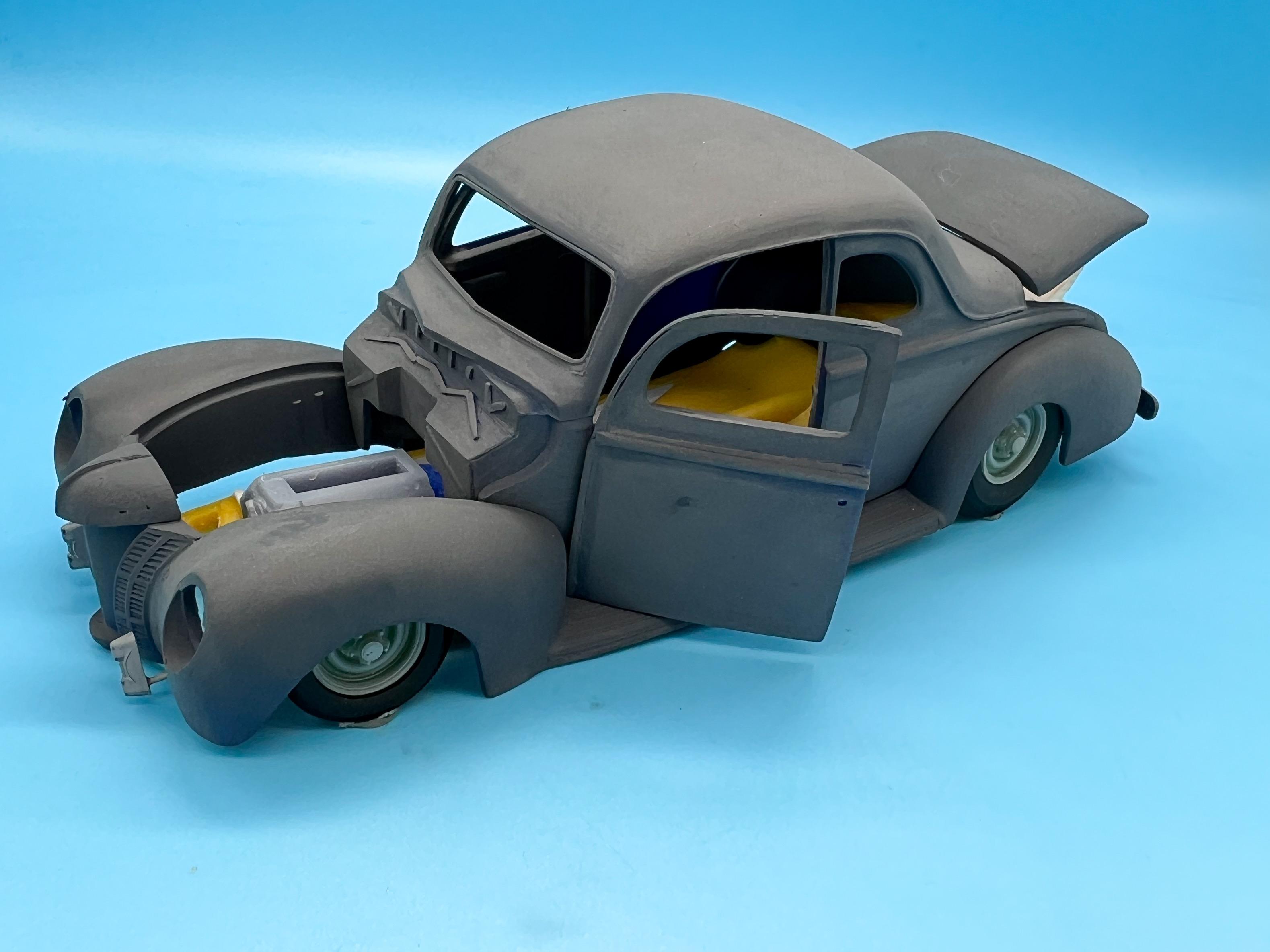

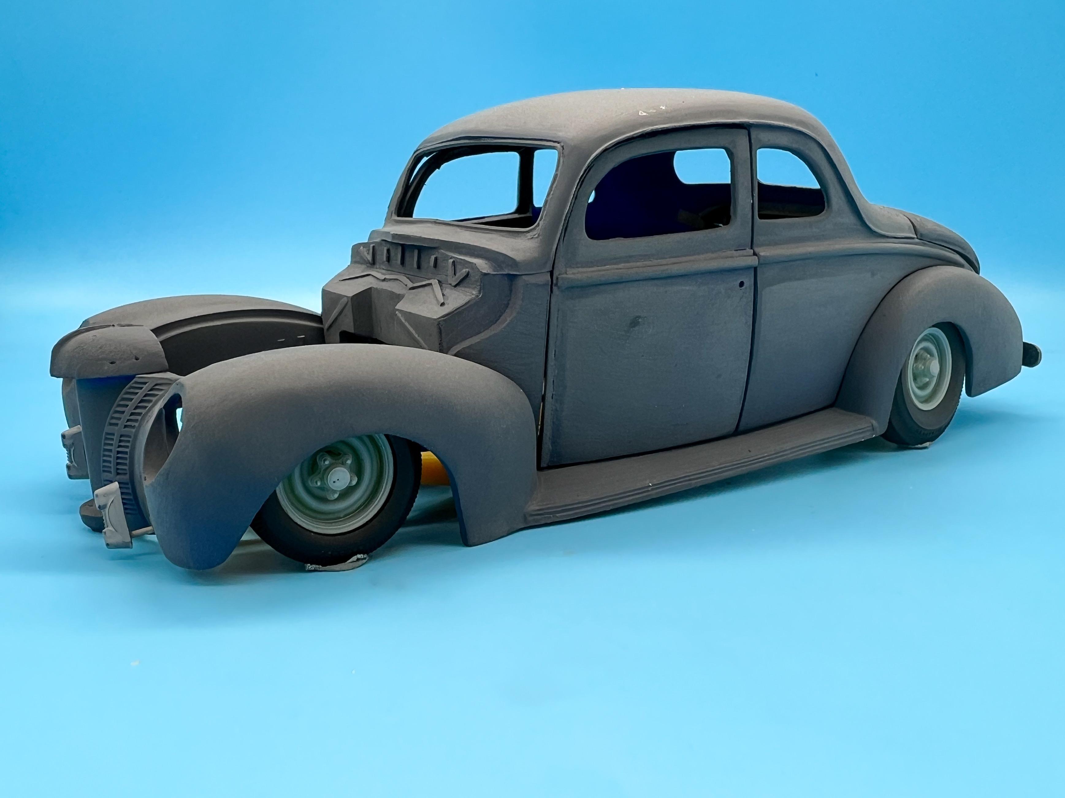

Today’s progress…first up, I wanted to fill that hole that’s revealed by not running a hood (so I used a piece of the hood…)

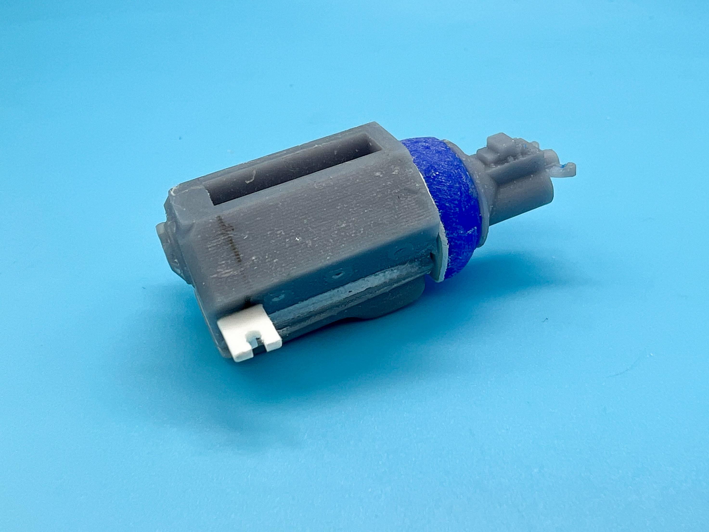

Next job before I could get to priming was a test fit of the 3D printed Flathead I’m using - I don’t want any surprises or to be cutting up the firewall after paint…I used the bellhousing from the kit engine to mate the Flathead and the toploader trans together:
(Those motor mounts will be skimmed down some once the glue is good and dry…)
Test fit in the frame - it fits!

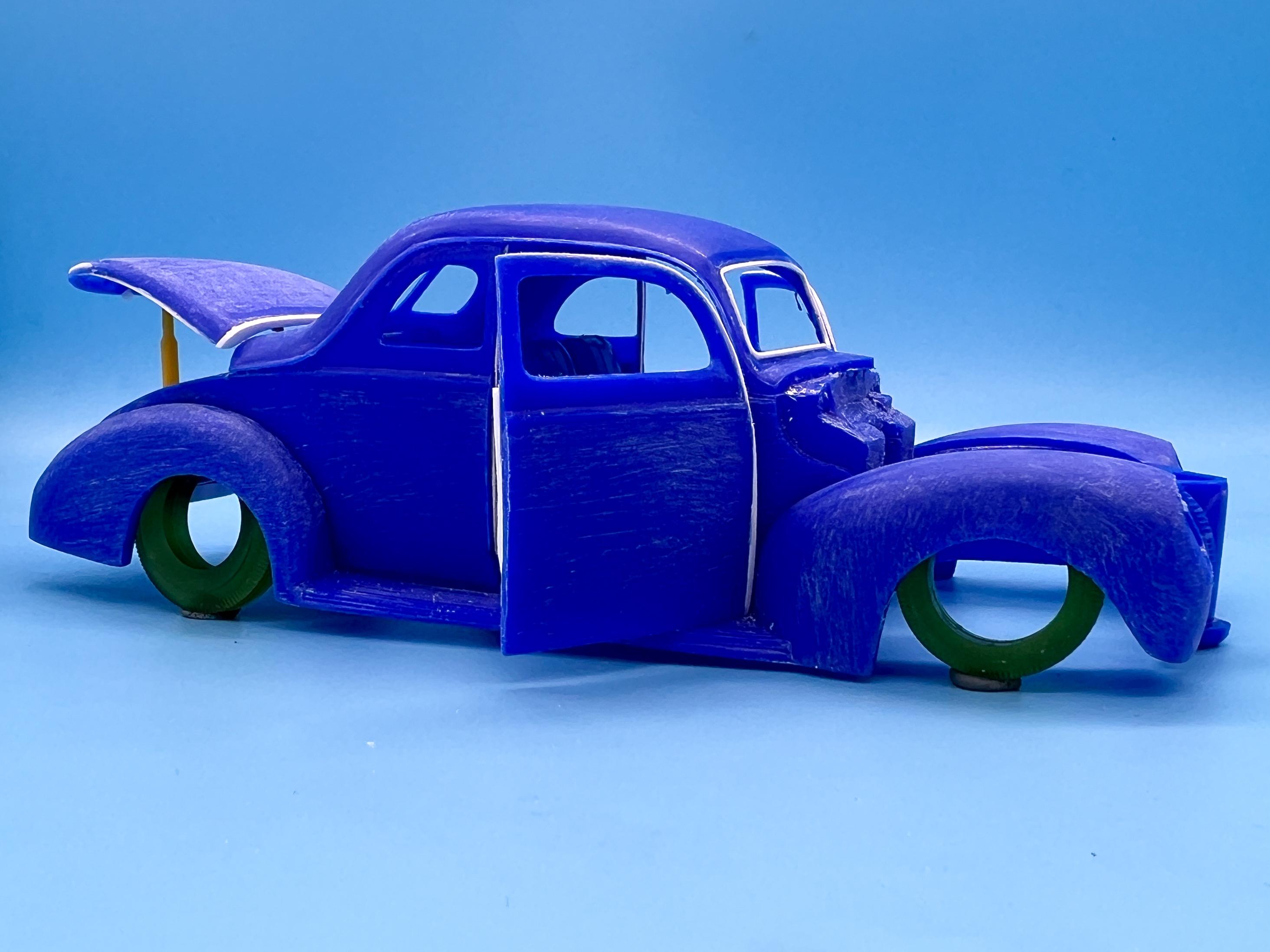

And, the moment I’ve been waiting for…first coat of primer to hide that fugly blue color:
And a mock-up with those 3D printed wheels and tires:
Considering how much I had to sand on this body to get it straight and how much I’ve hacked it up, that’s not a bad start!  But now the REAL bodywork begins…

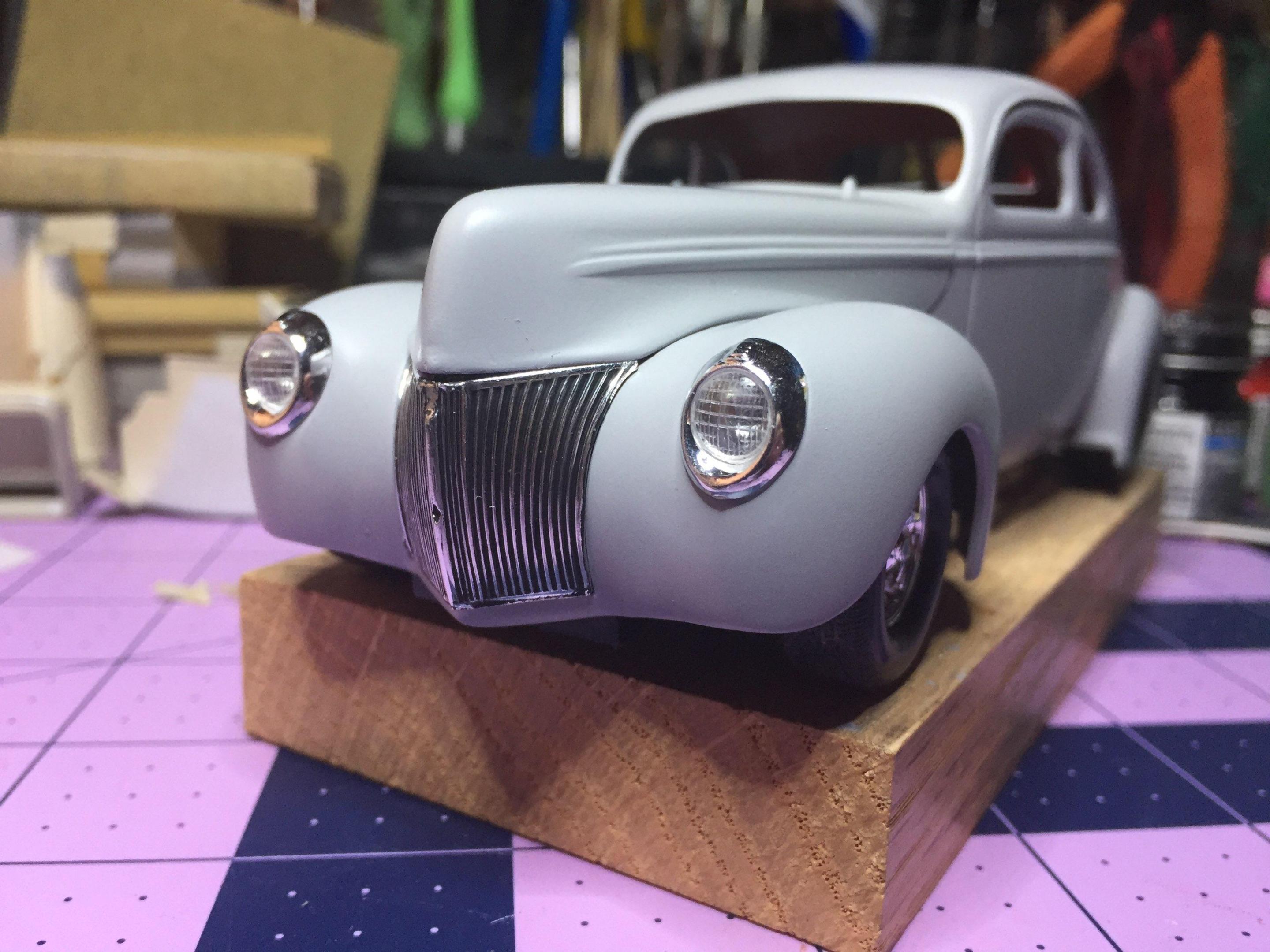

It looks much better in gray, Jim. Thank you ?. Seriously, I like the hoodless idea (that's bonnetless for you Brits) because it makes a bold statement.  You don't see it much on a fat-fender car but the hoodlums in my town were prone to that sort of thing ?. Quit staring!
  • Like 1
2 minutes ago, customline said:
Quit staring!
Can’t make me ?
That car, in that color, isn’t too far off what I pictured this build looking like from the start!  40s look great in blue and white!
It’s reassuring to see from the pic you posted that even in 1:1 getting that chrome trim nicely aligned on the doors can be tough…
