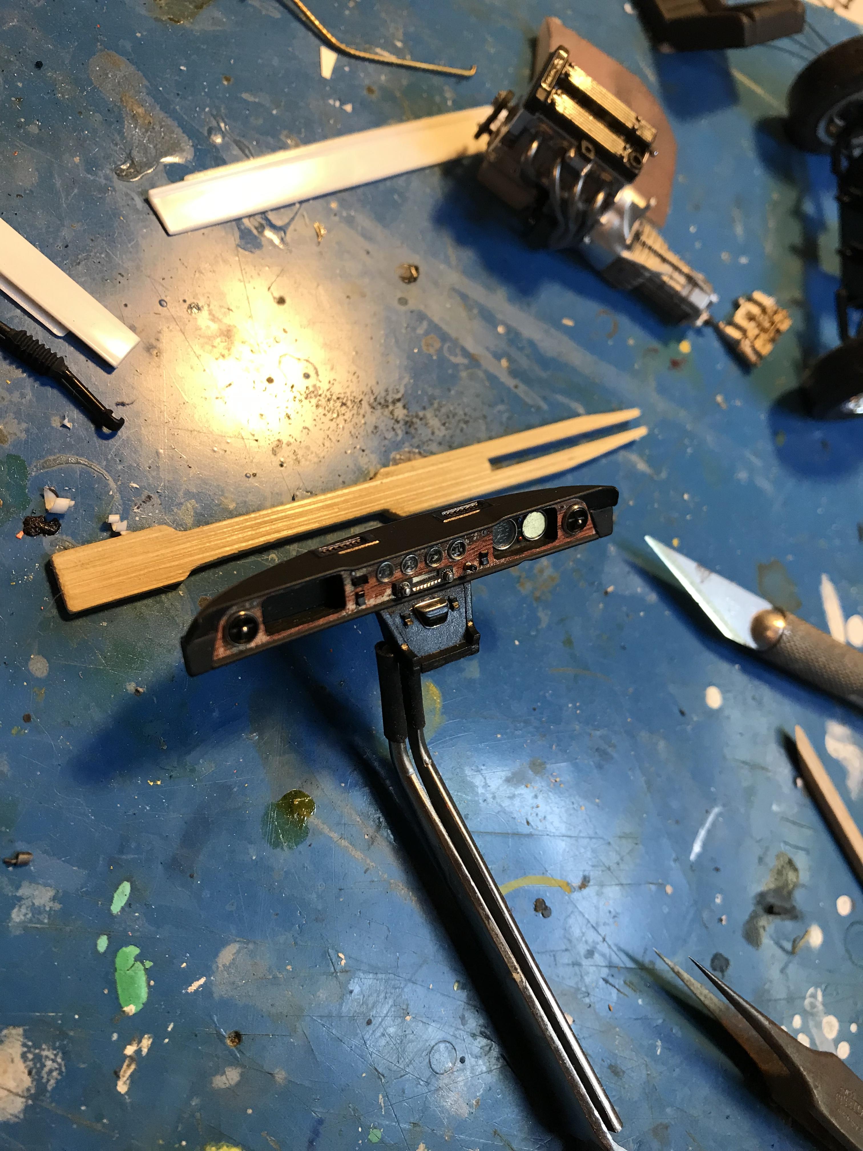

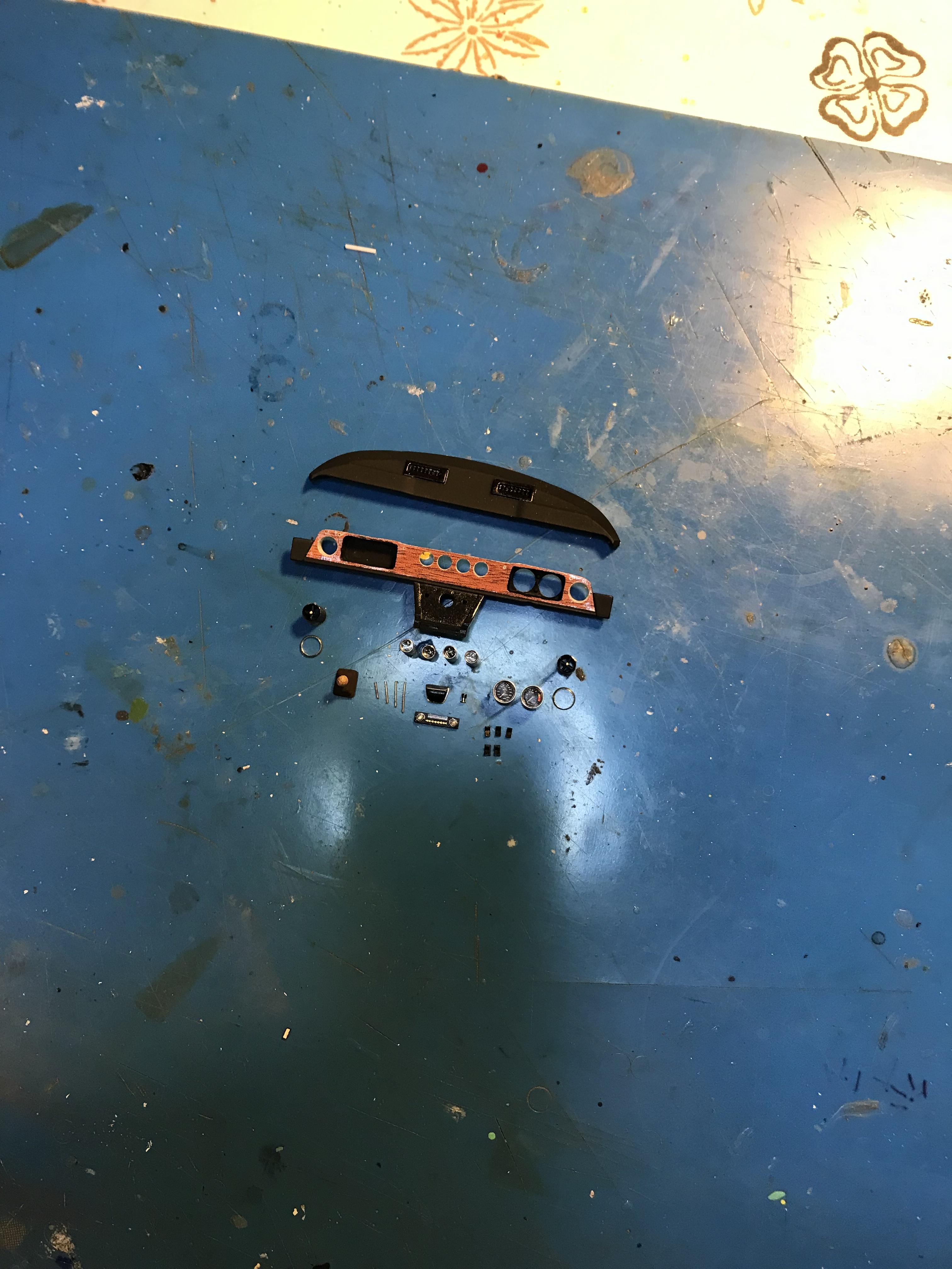

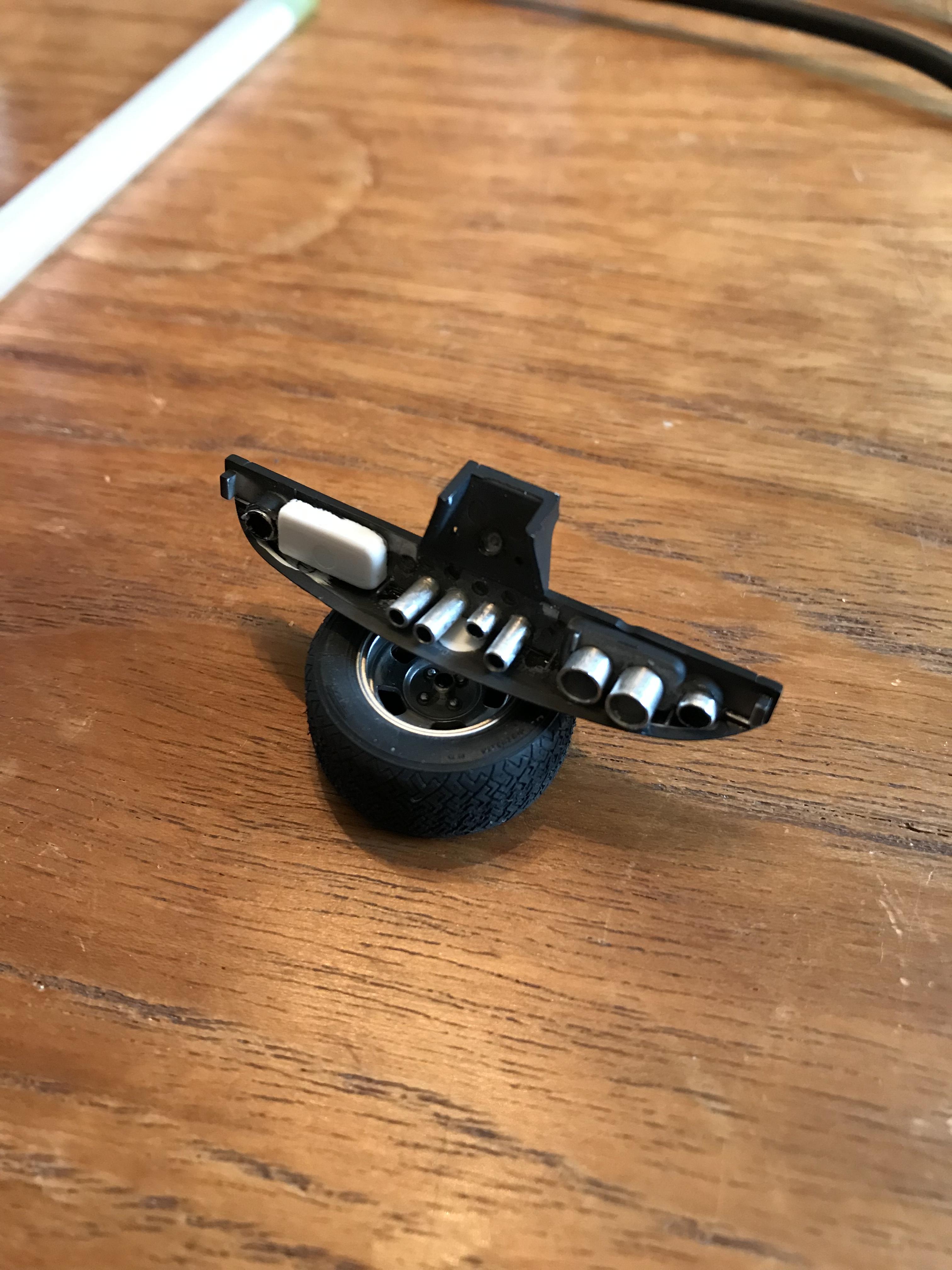

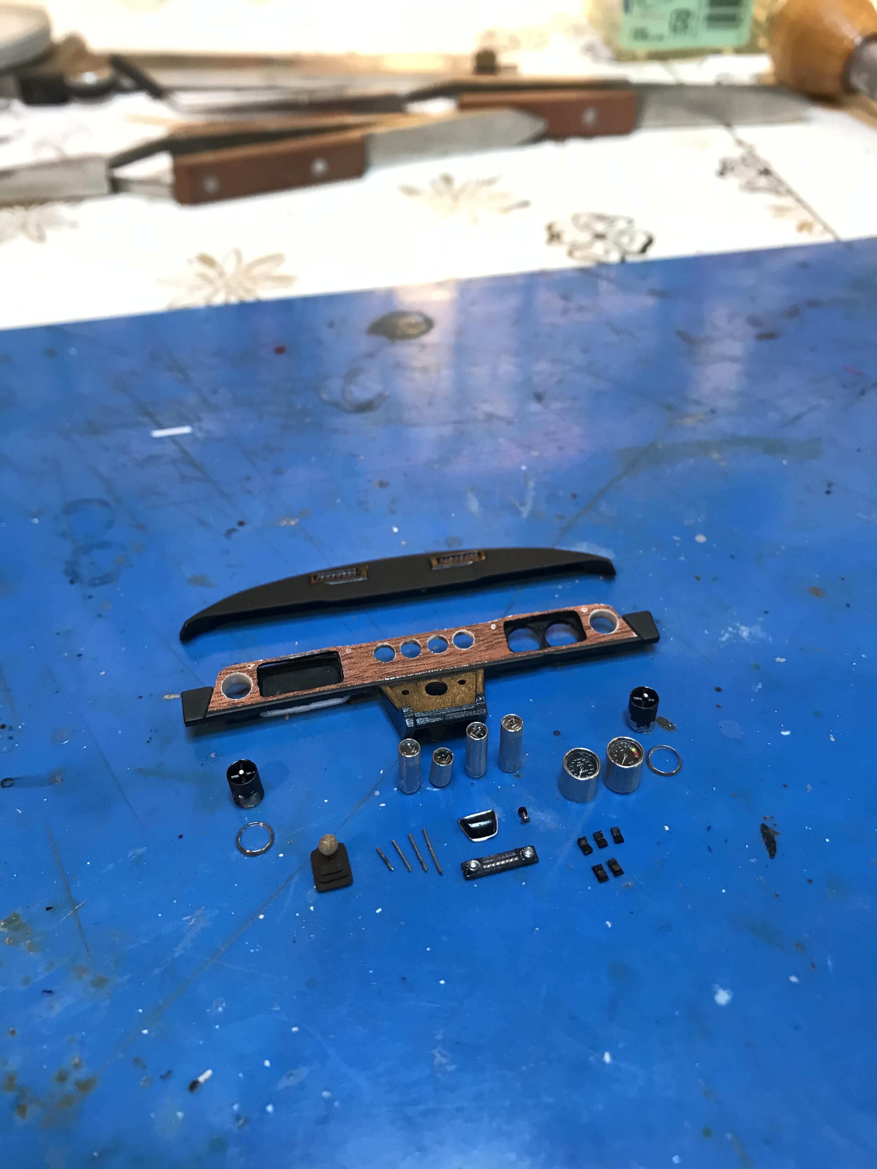

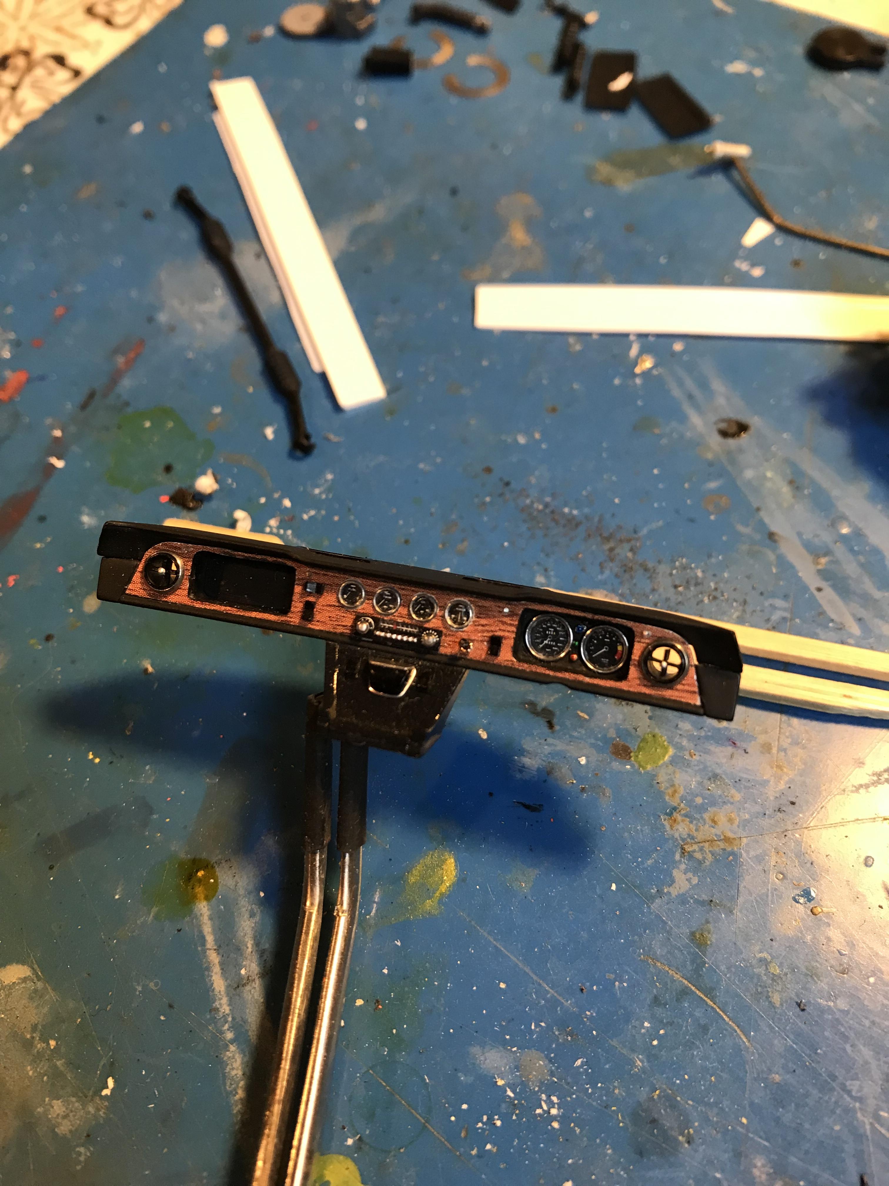

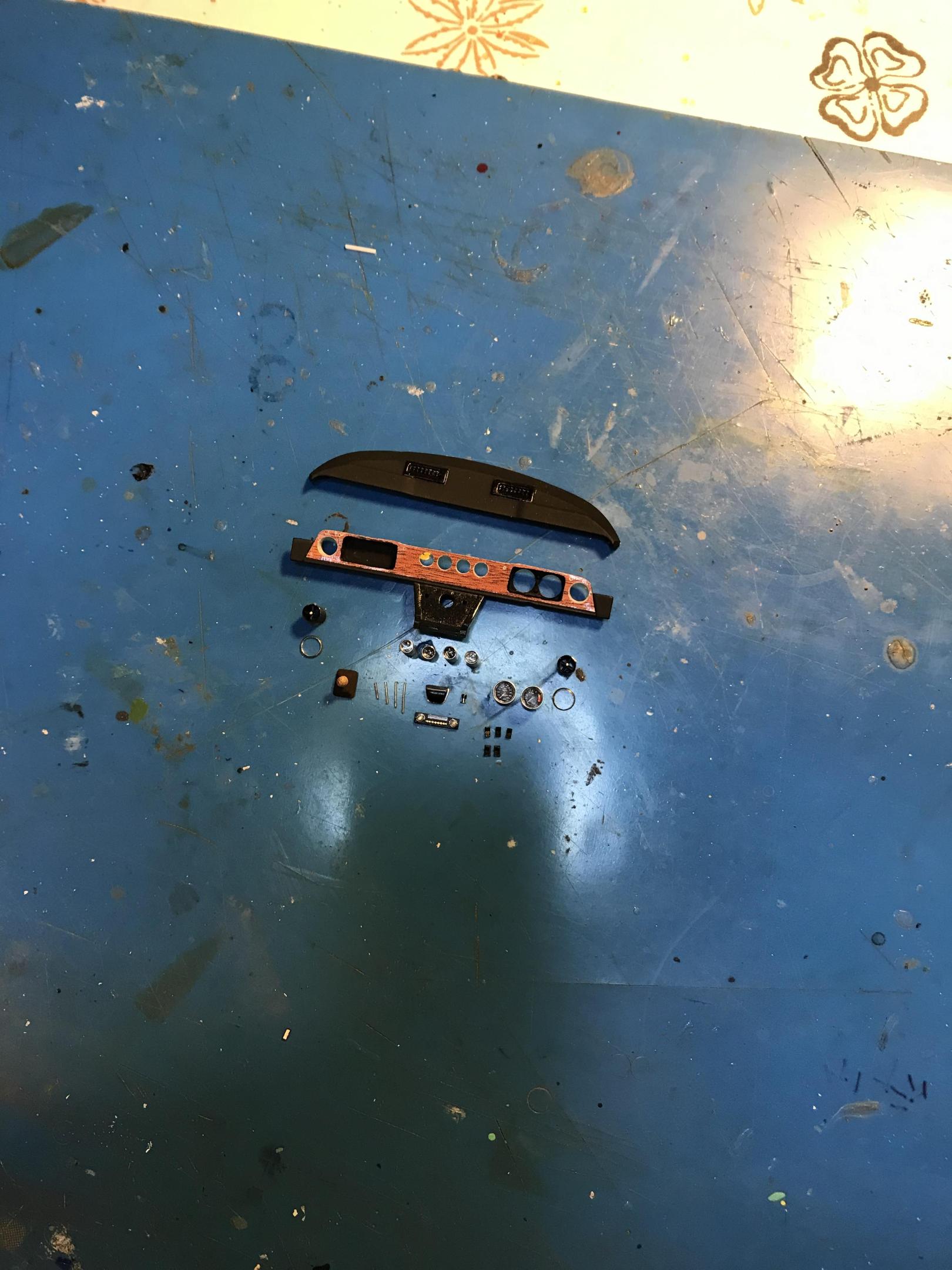

Bainford Posted January 3, 2023 Posted January 3, 2023 Another example of dash detailing. Basically everything on the dashboard is scratch built. This is the dash from my current Lotus Europa project. When it comes to scratch building dash components, old sports car are more straightforward than the complex dashboard on large American cars, such as Steve’s shown above. 4

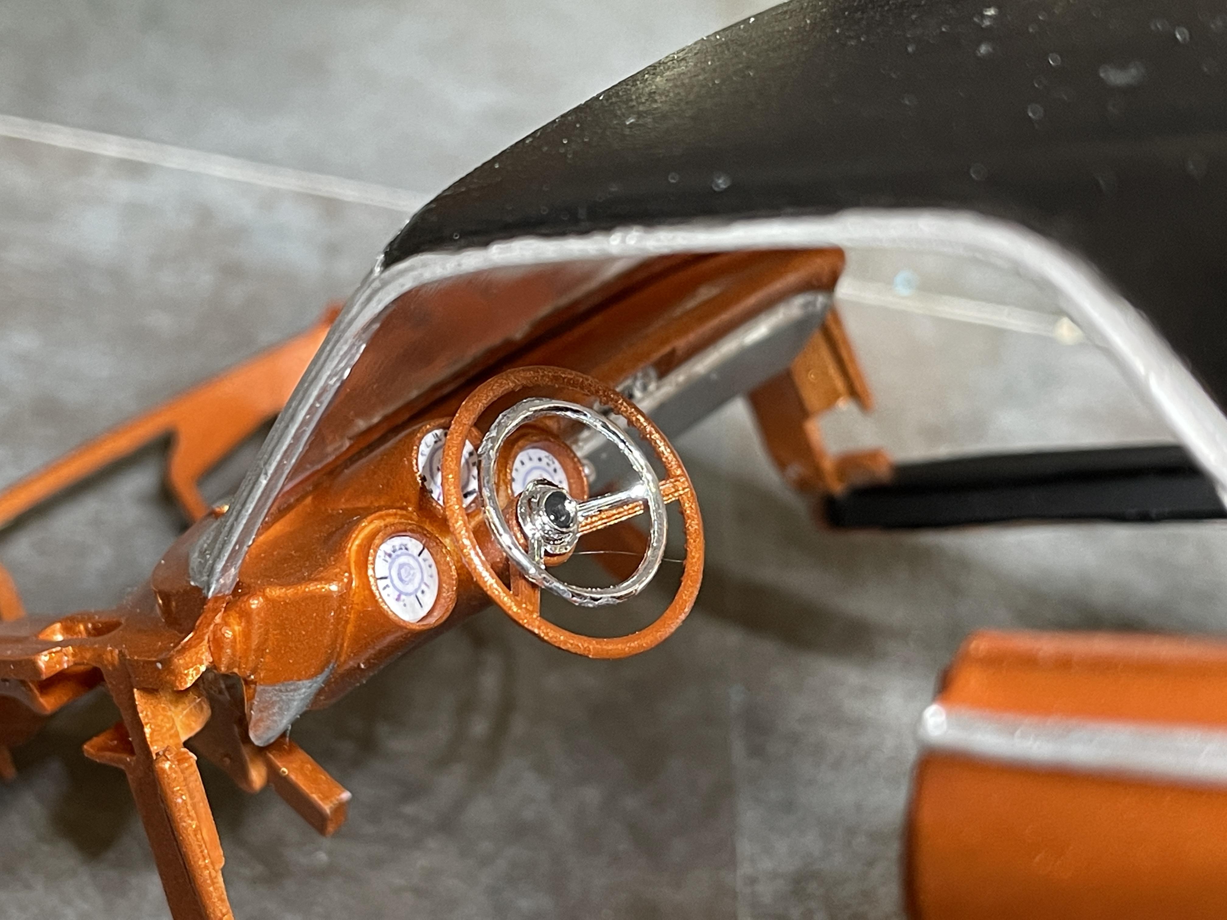

bh1701 Posted January 6, 2023 Posted January 6, 2023 On eBay, look for "BestModelCarParts". He sells printed sheets with gauges, speedometers, and radio faces for quite a few model kits. I have bought several and have been pleased with them. I will also look on the internet for photos of dashboards. If I can find a good shot of a gauge I need, I will bring it into Photoshop to erase everything but the actual gauge, and then will do any tweaking of the image that is needed. Another good source for photos of gauges is to look on eBay for one that someone is selling. Their photos will often work, too. For both methods, I will put double-sided scotch tape behind the paper and will attach that to very thin sheet plastic. Then, I cut the gauge out and secure it to the dash with glue. I bought a leather hole punch tool that works well to punch the round ones out. The really small round gauges may need to be hand cut with a small scissors (Like a fingernail scissors). I will put a small dab of glue on the dash where the gauge needs to go and then attach the gauge. In the photos I included, the Corvette dash and Cougar dash have gauges from BestModelCarParts. (The Blue and the Green interiors) The Turbine Car has gauges from internet photos that were tweaked in Photoshop a bit. (The dash hanging below the windshield) Hope this helps! Bart
