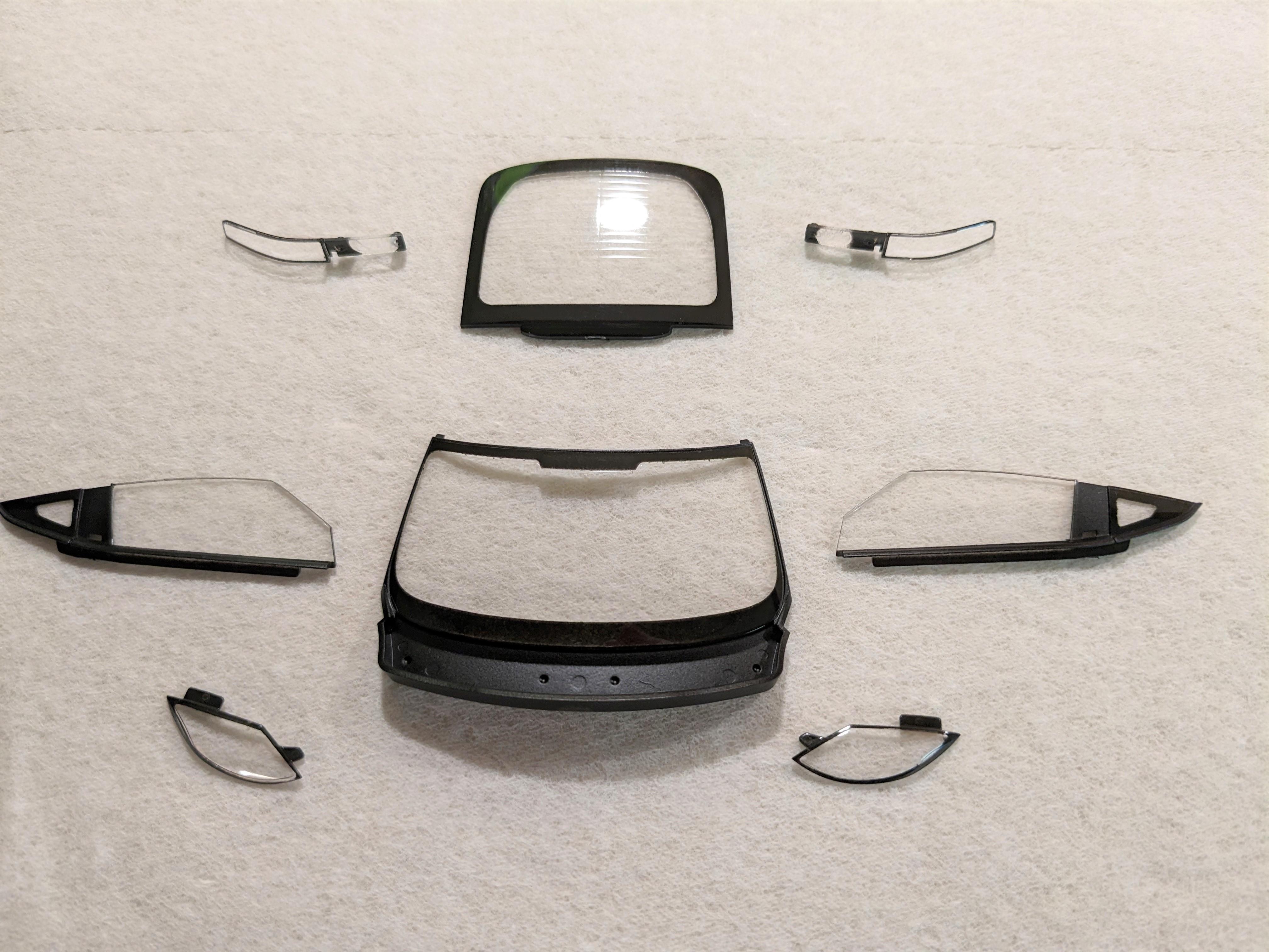

Next, the window and lighting glass assemblies. These feature pre-cut masks for both interior and exterior.

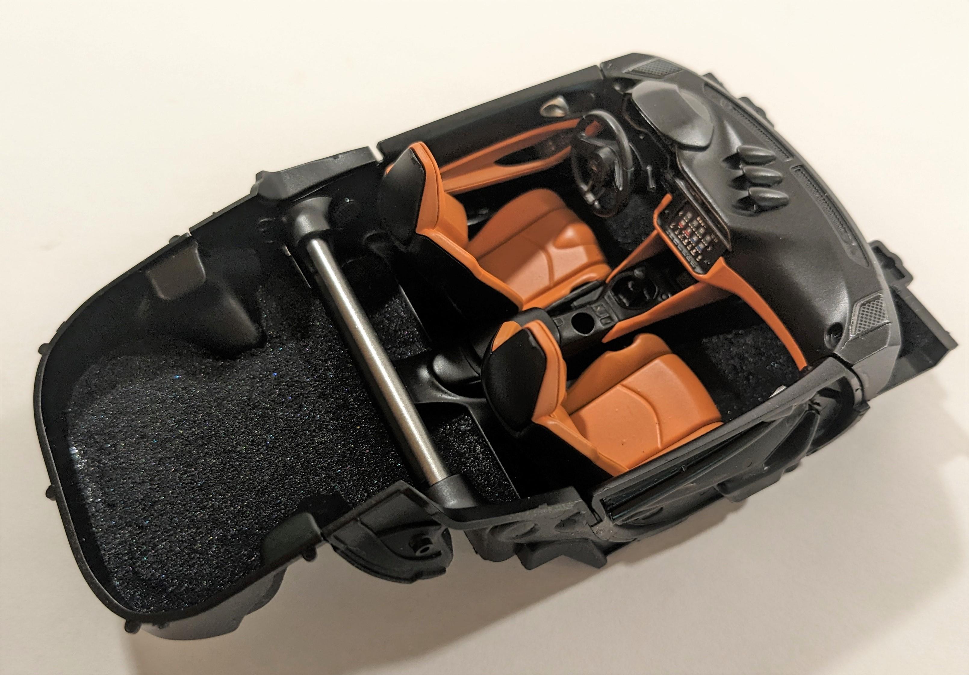

The interior is designed with separate elements to eliminate as much masking as possible on the two-tone seats and door panels. I used embossing powder for the interior carpet...otherwise the entire model is 100% box-stock. The terracotta color is a matte brown from Revell's new line of acrylics. These paints thin beautifully for airbrushing with Vallejo acrylic thinner medium.

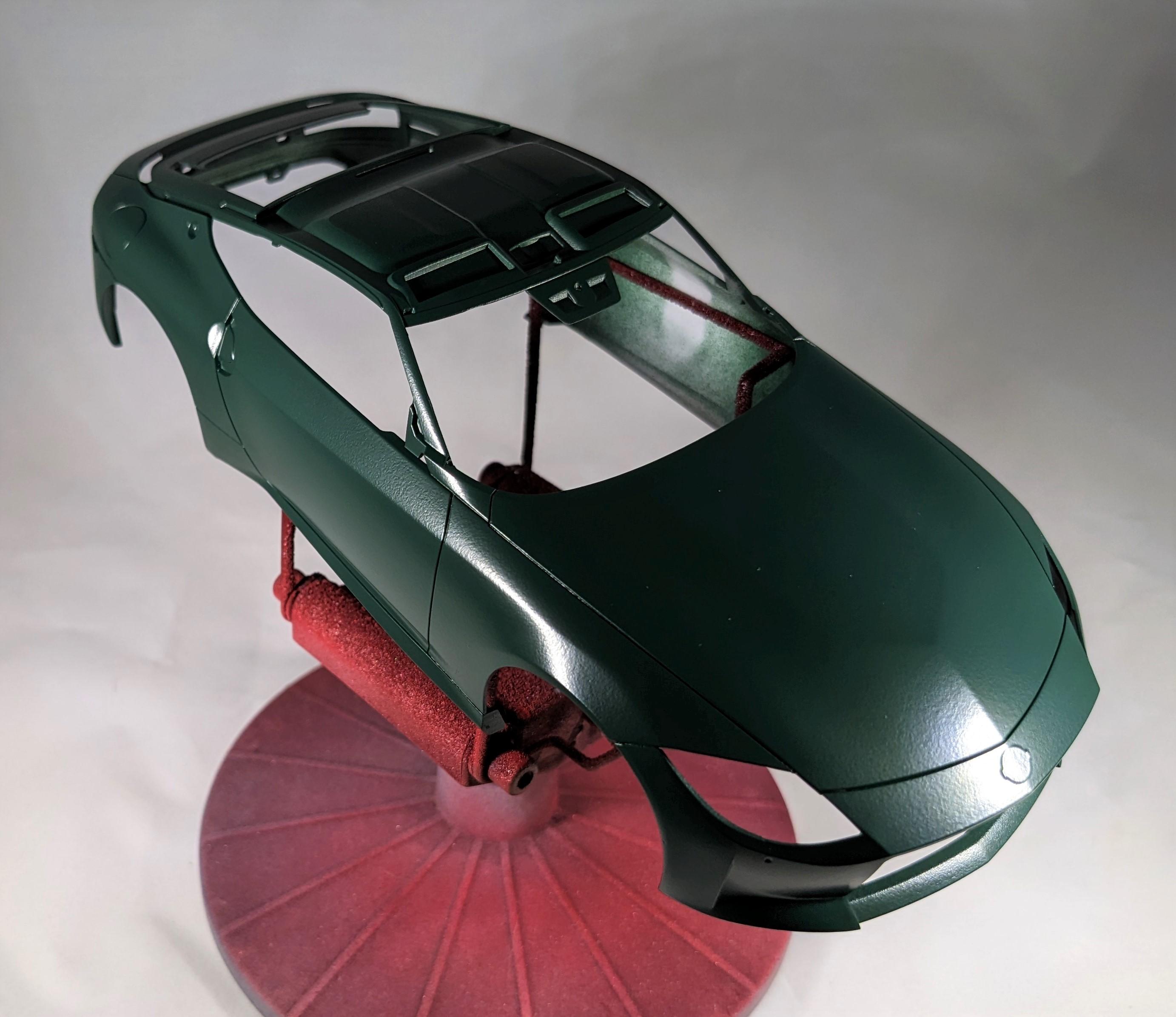

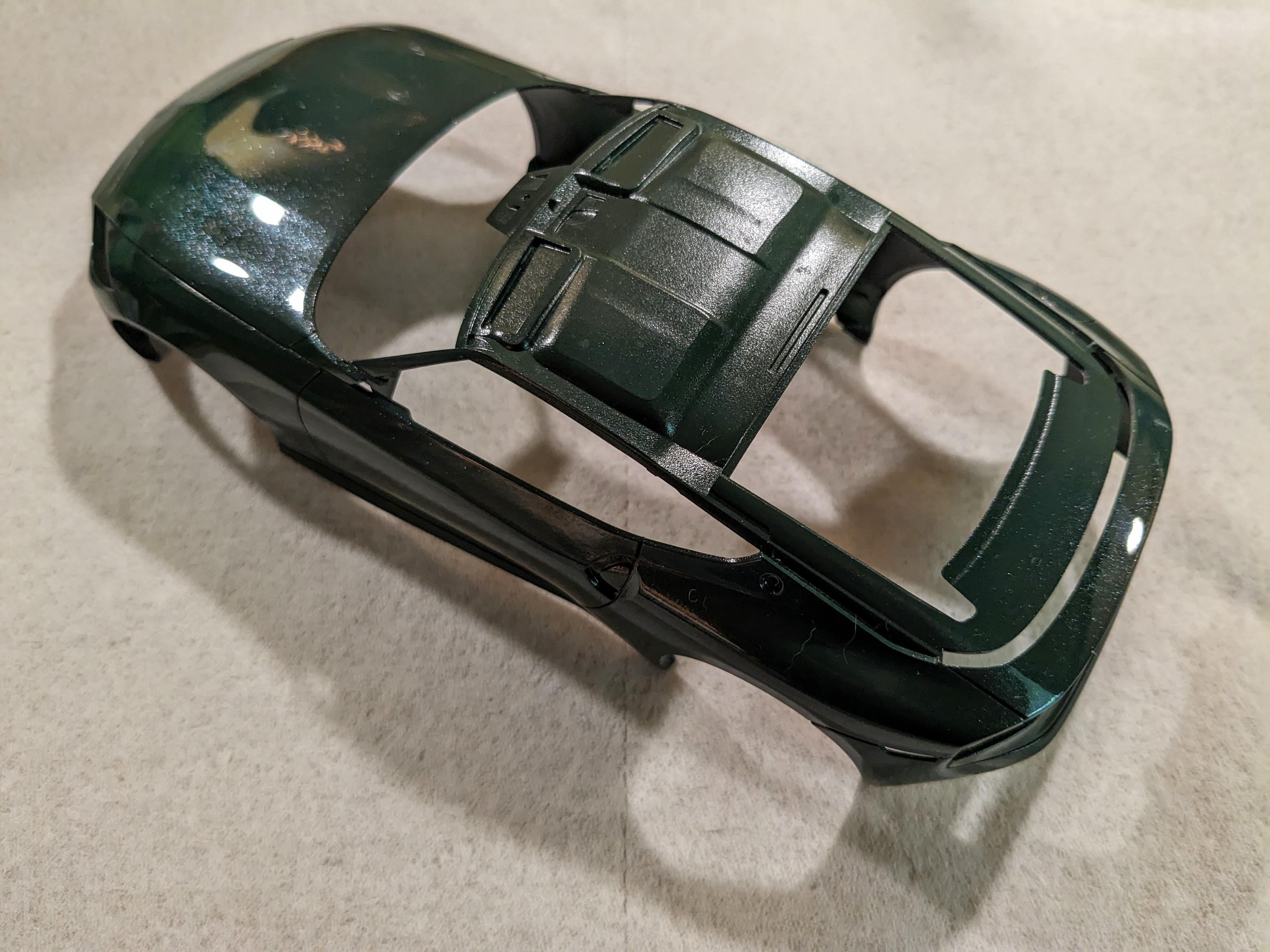

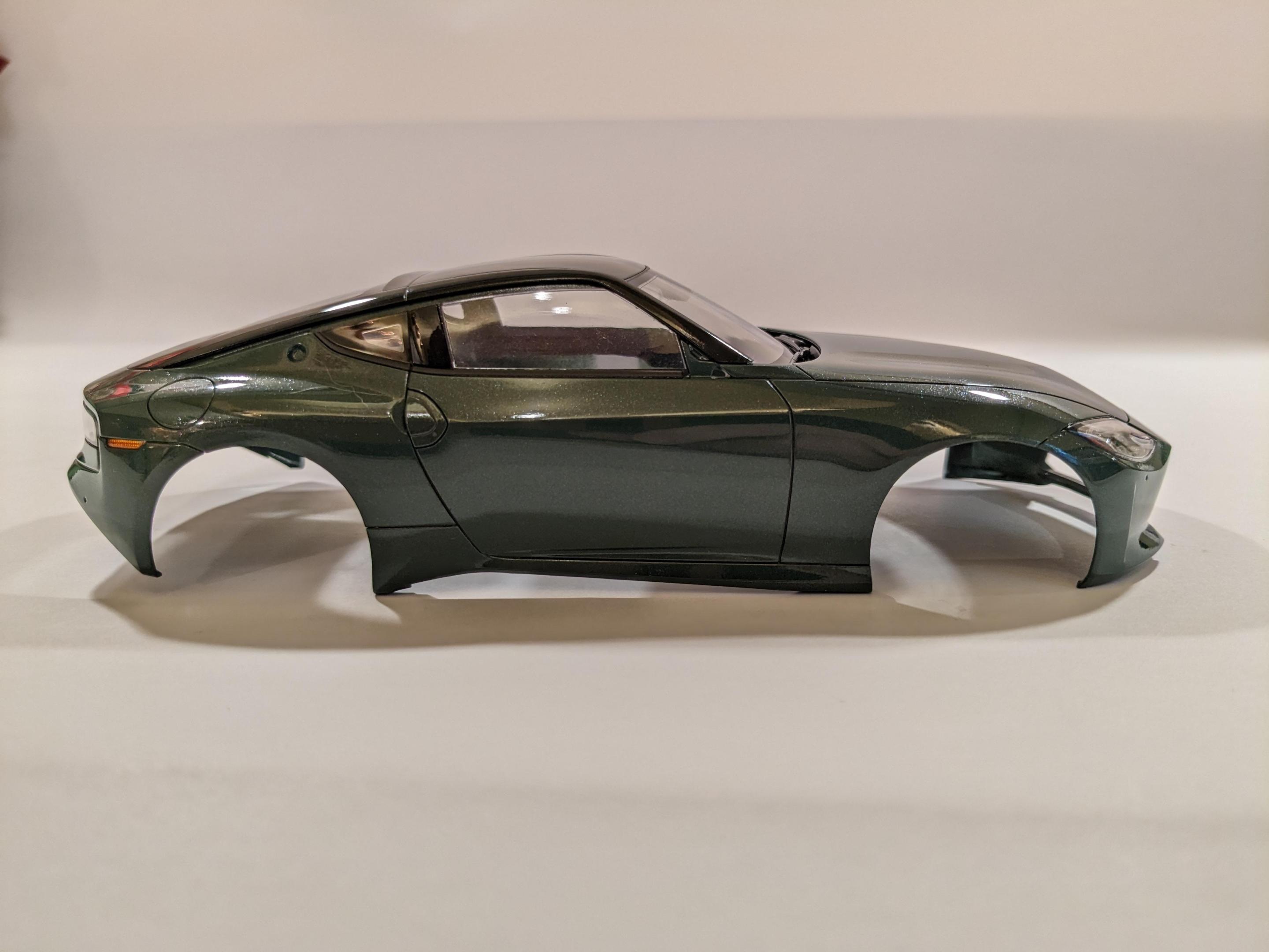

The body was painted in Tamiya AS-21 IJN Dark Green 2. This green has a very slight blue undertone to it. I followed that up with three coats of Tamiya Pearl Clear and three coats of TS13 clear. Base coat...
After pearl, clear and polishing. Phone pic makes the pearl look a lot heavier than it actually is.PXL_20221230_145803590.thumb.jpg.4898a129270c063851e3114bac5e4d3e.jpg

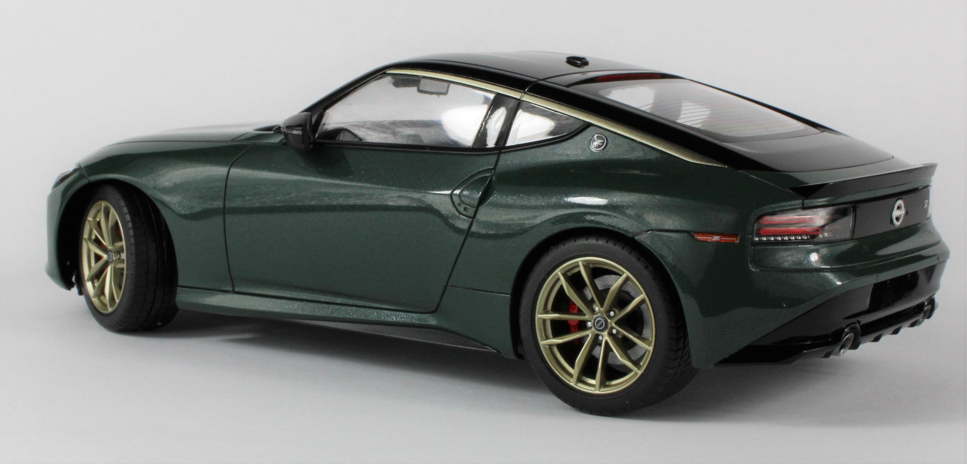

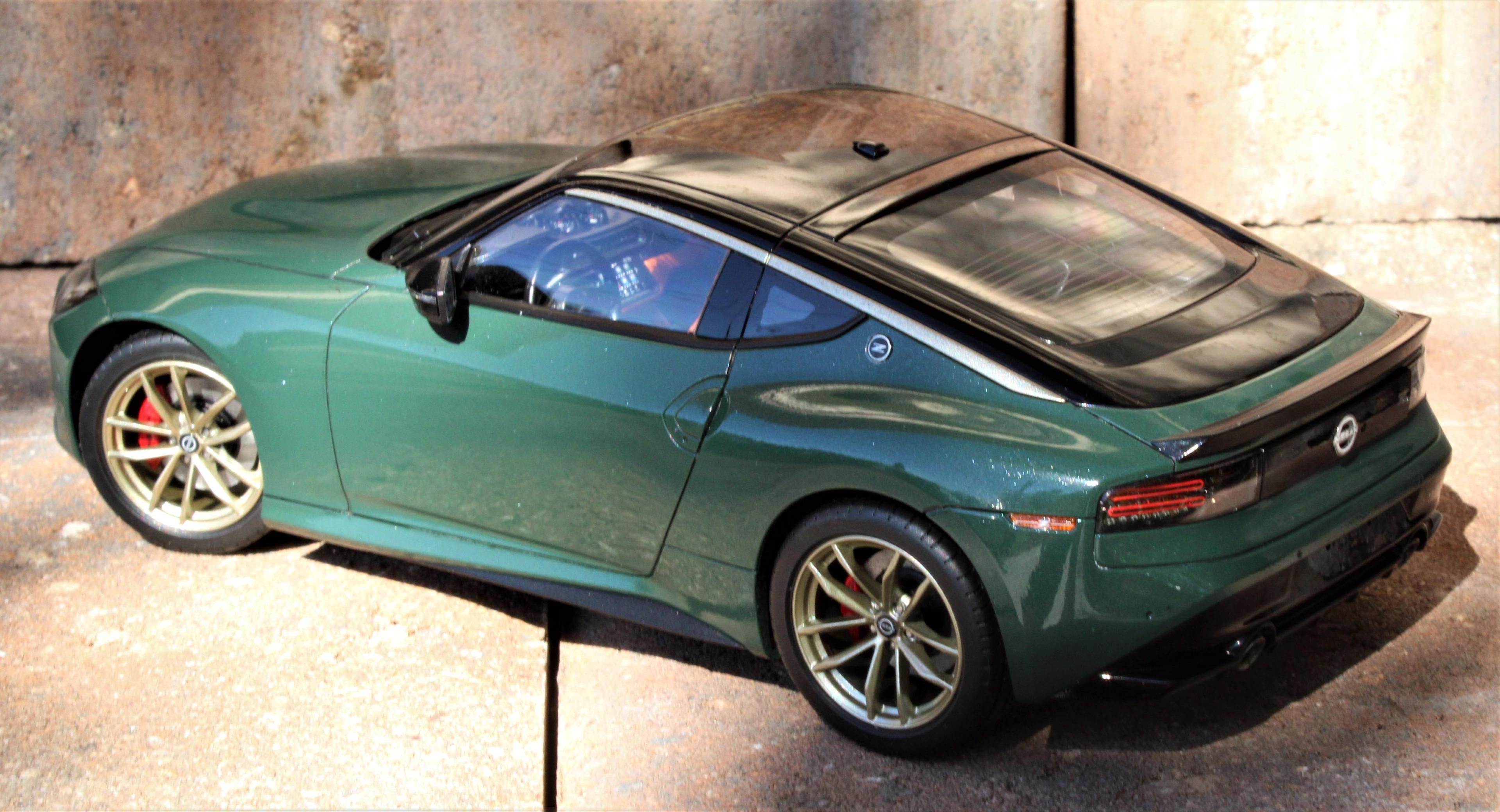

Tamiya molds the roof separate from the rest of the body to make it easier to replicate the two-tone color scheme of most Z's. The roof was painted in TS14, cleared, polished and installed. Exterior glass sandwiches in between the interior and exterior roof pieces with big mounting tabs.

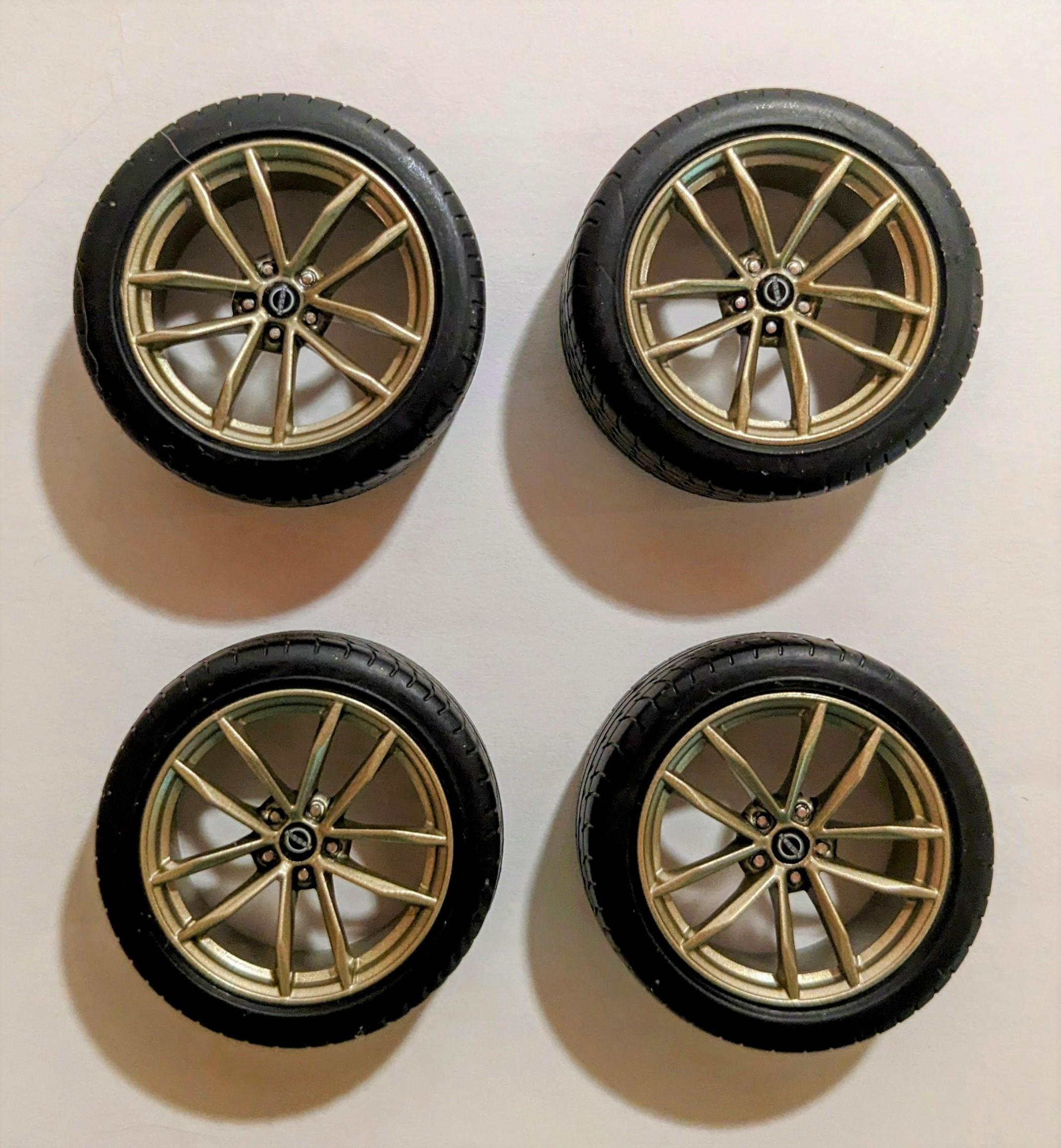

Wheels were painted in a mix of Vallejo Metal Color paints to create a sort of "champagne gold" color. I painted the trim above the side windows (another separate piece) the same color. I picked out the lug nuts in Molotow chrome and added a light wash to the hub area to make them pop. Ordinarily I'd add valve stems but I really wanted to stick to box stock. I'm a little surprised that Tamiya didn't mold valve stems in!

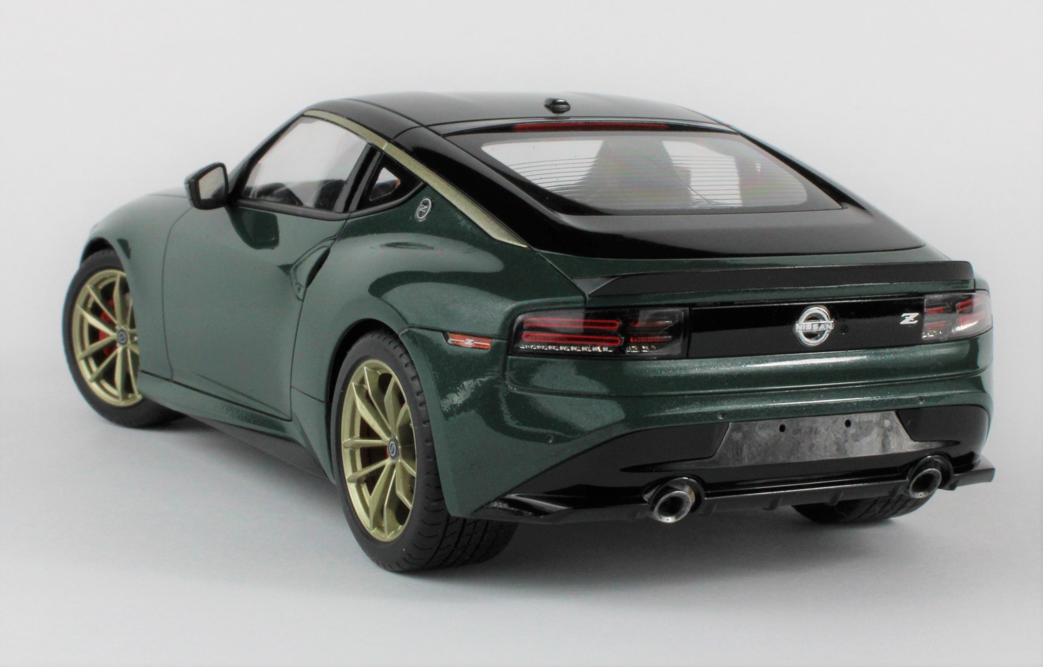

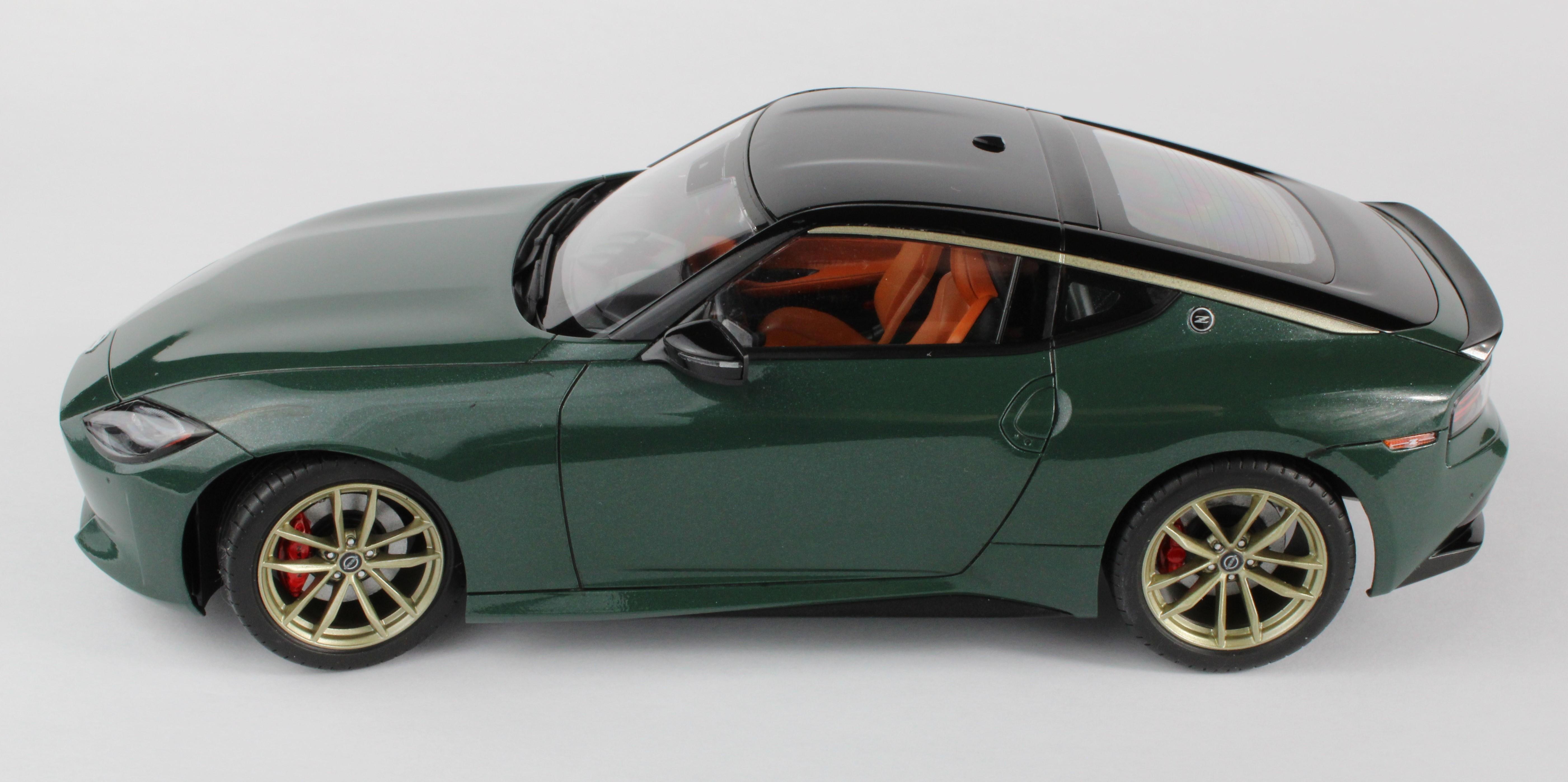

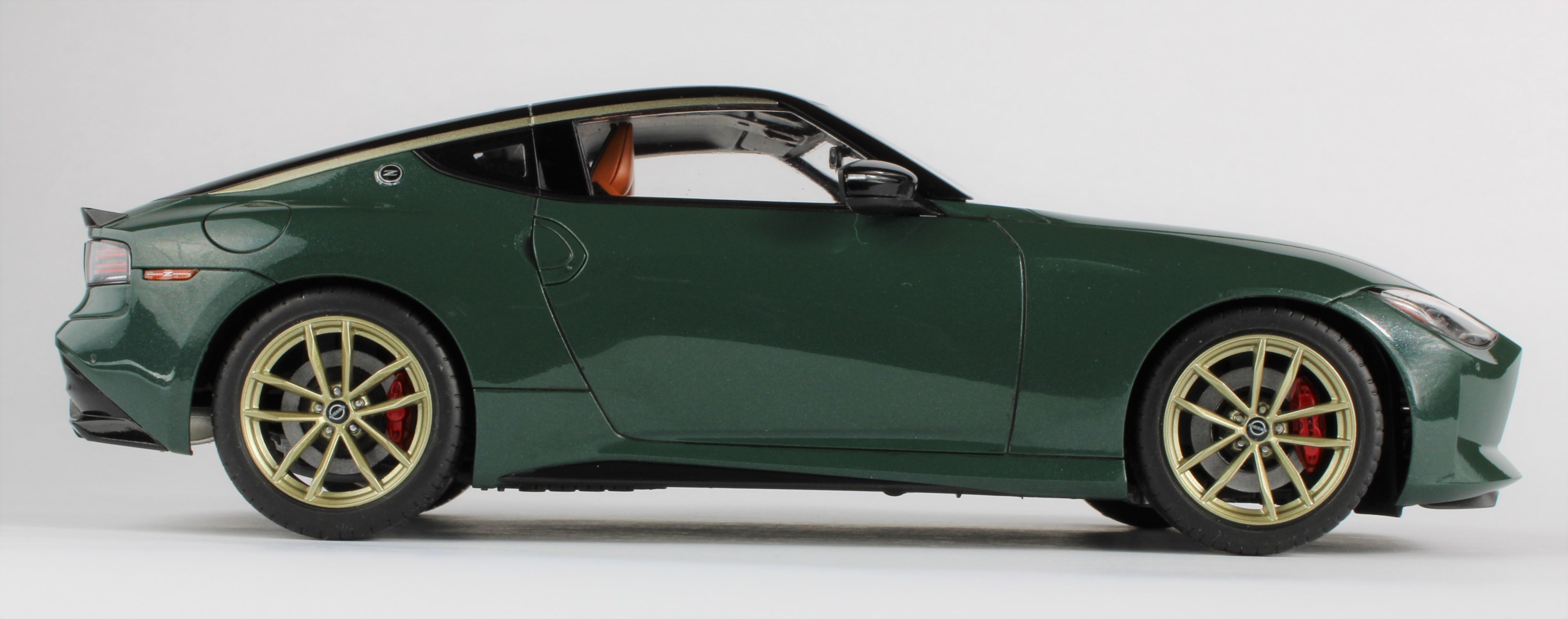

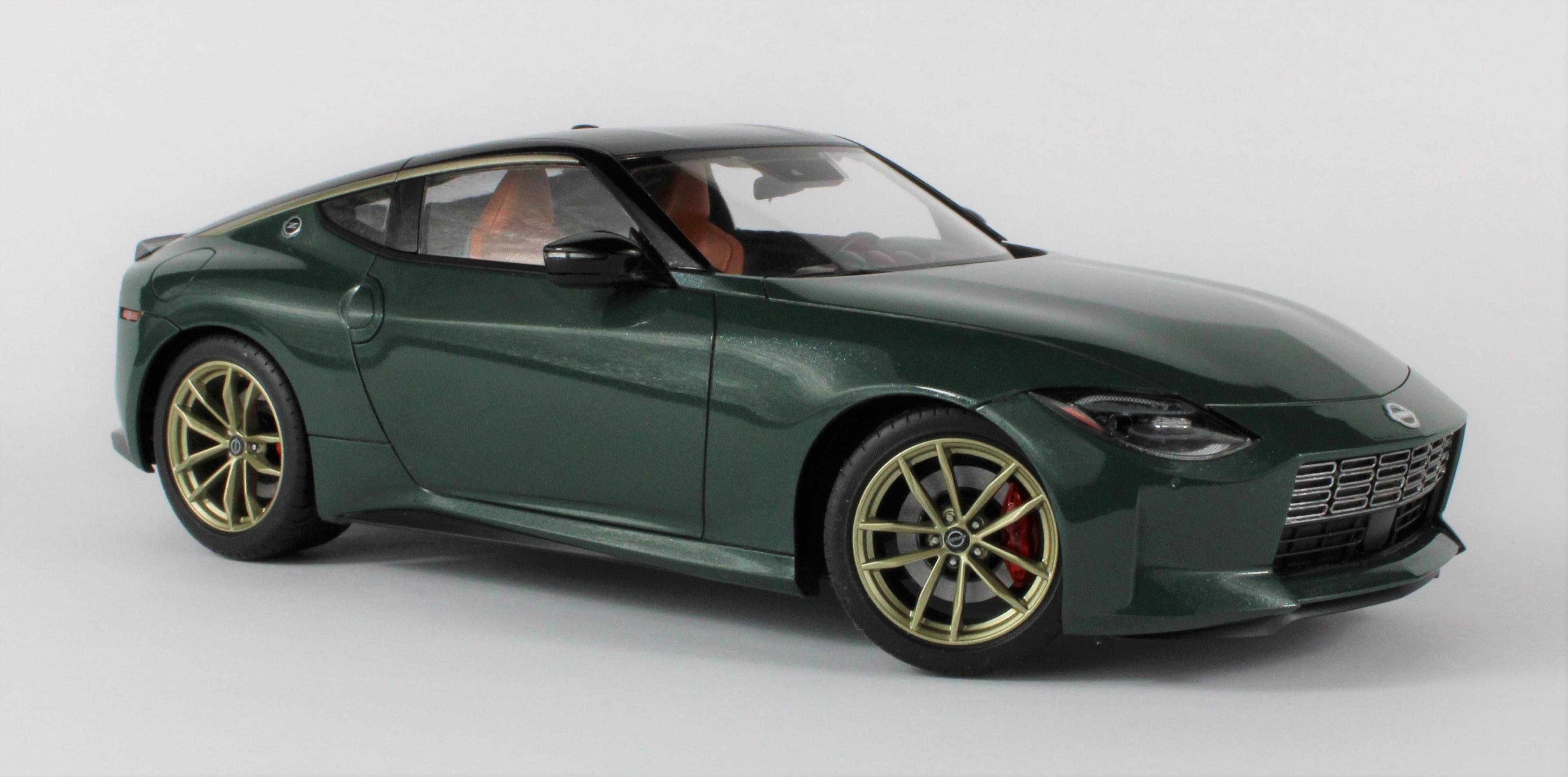

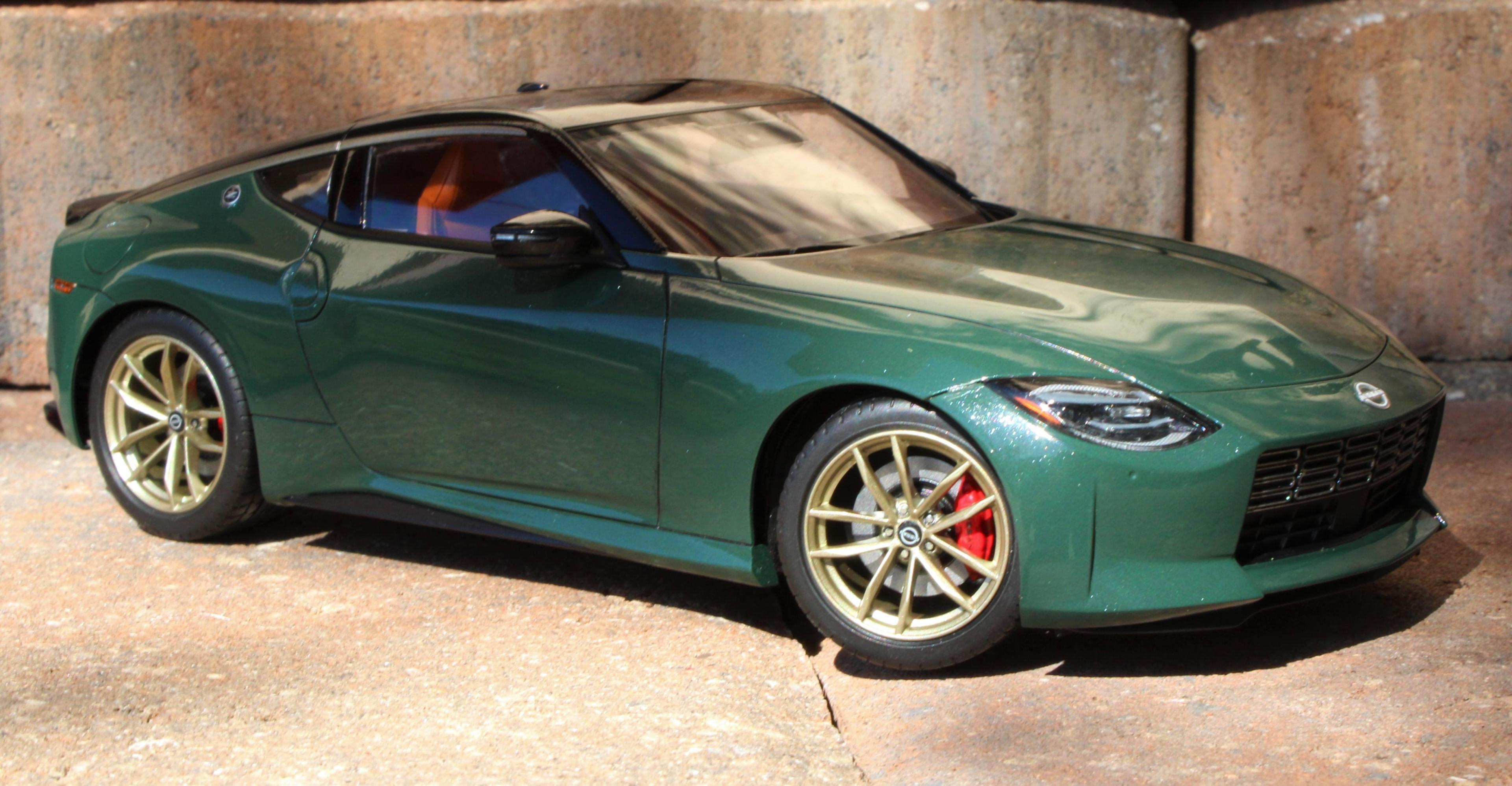

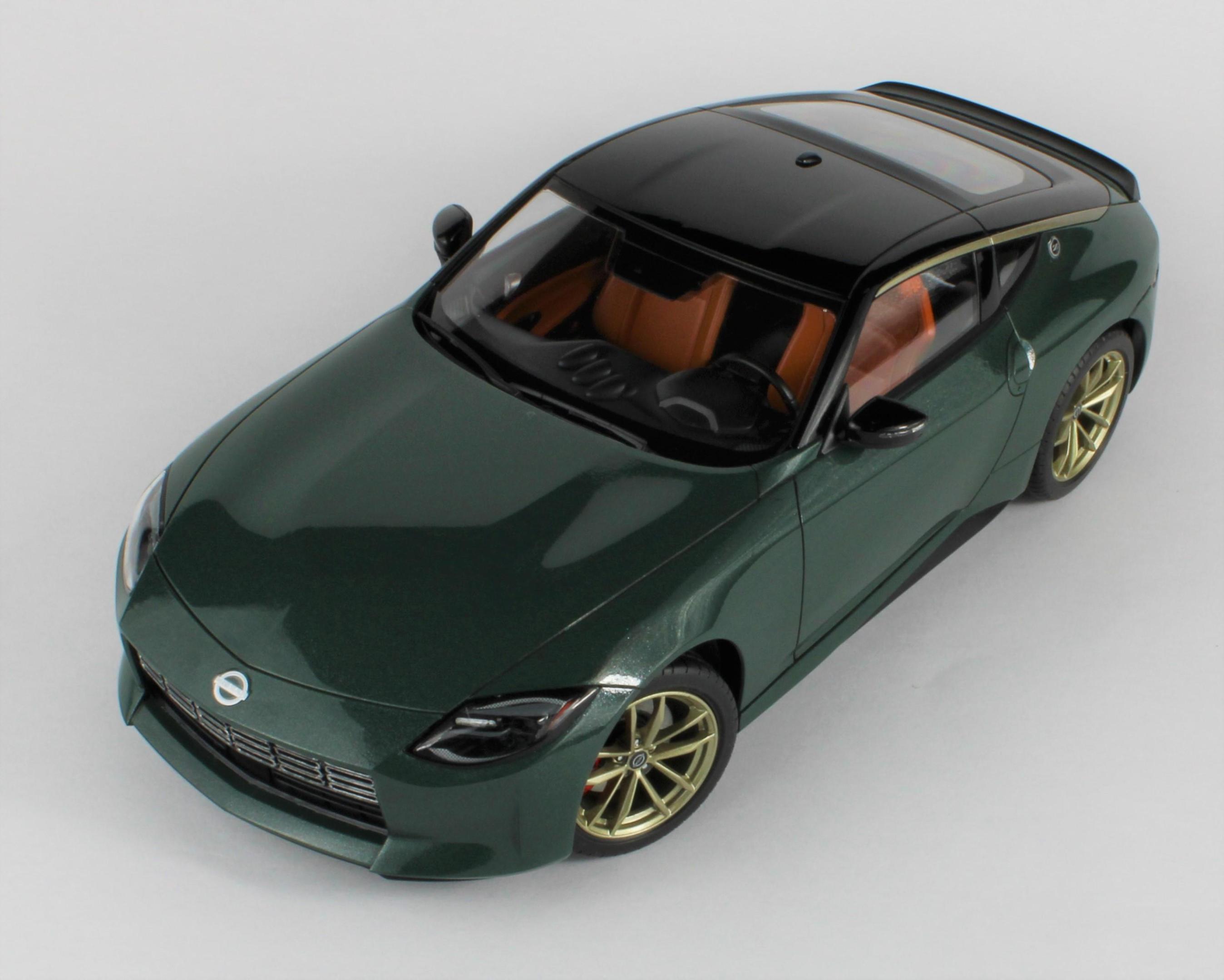

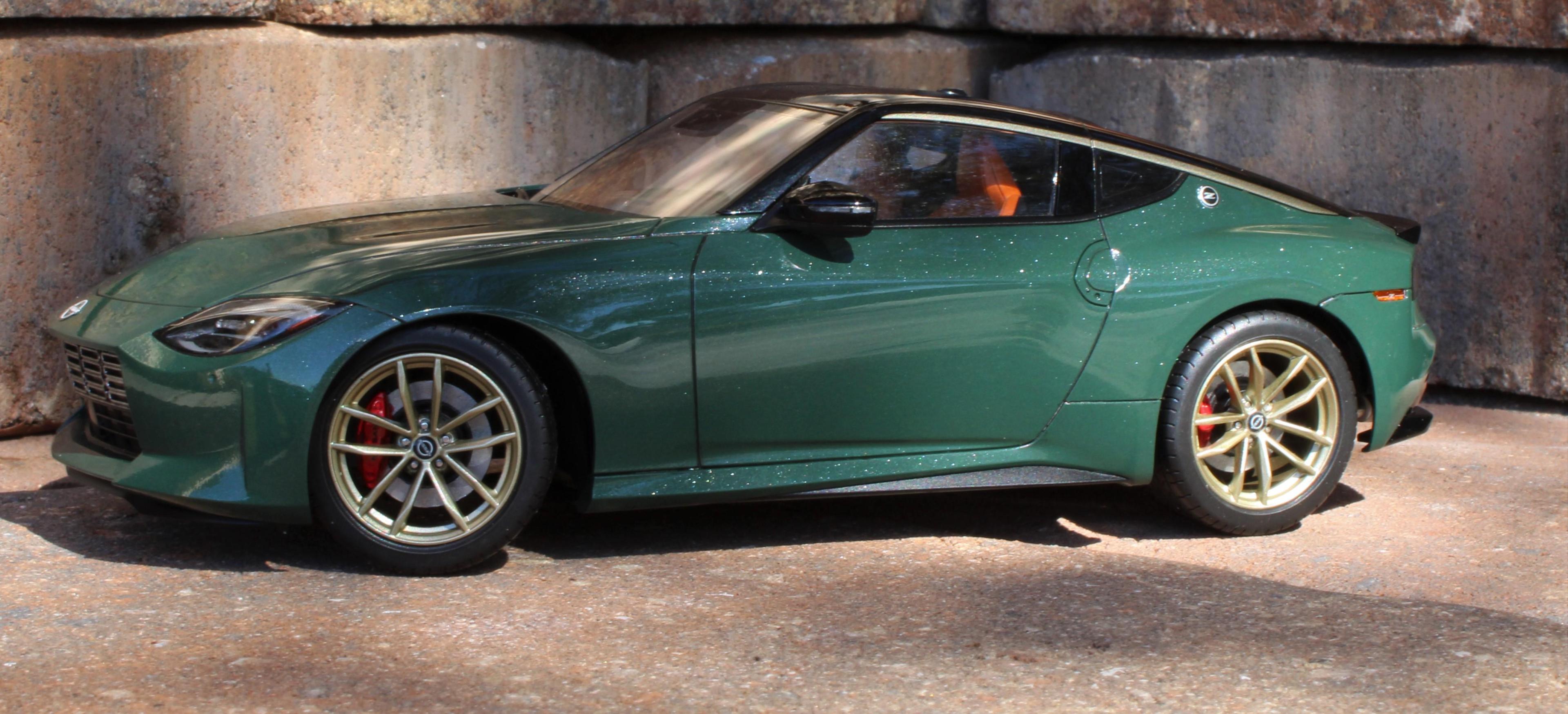

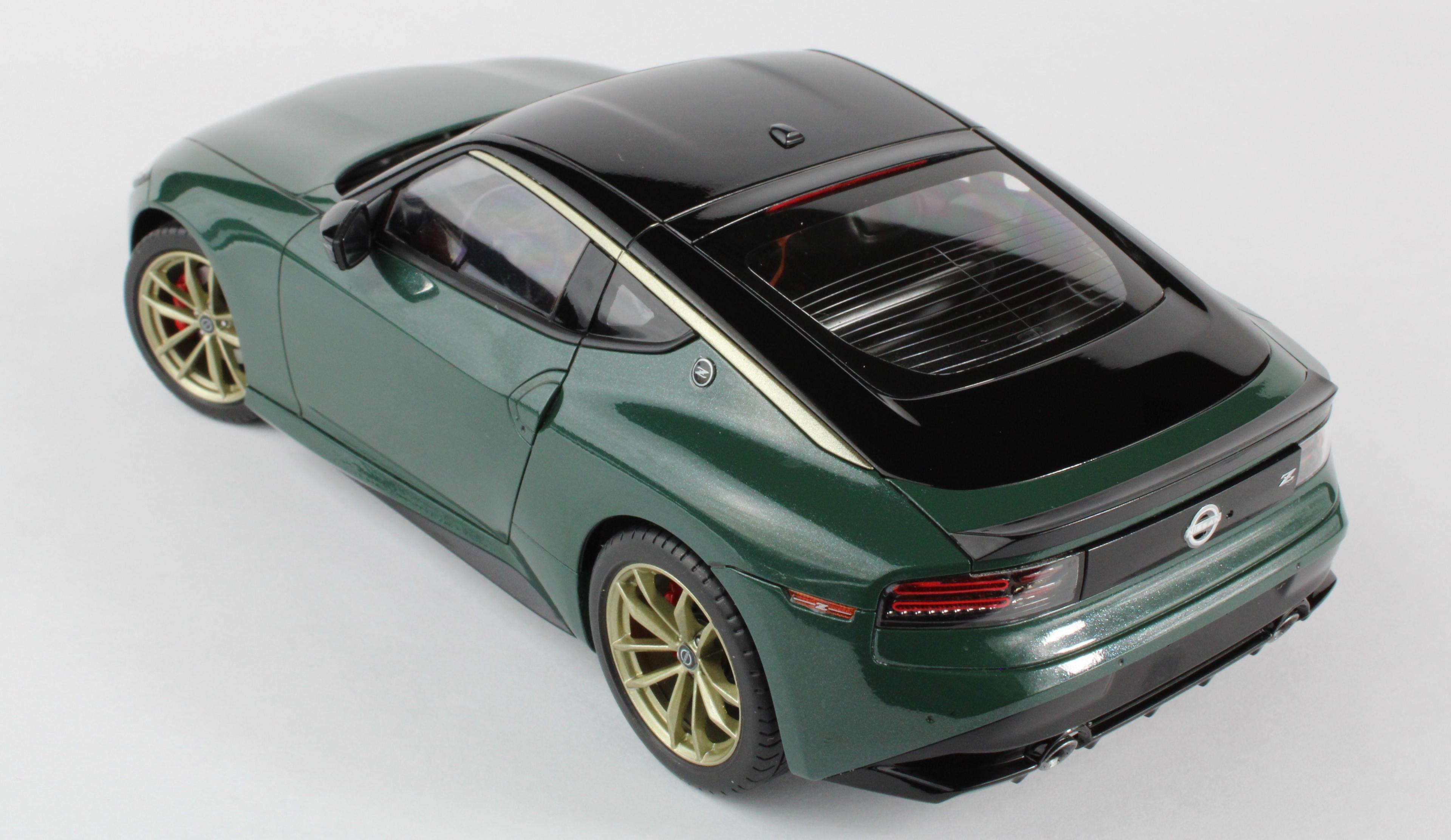

And the finished model!
IMG_0421.thumb.JPG.b1423a7cac25f3a182f3c825d178f6e1.JPGIMG_0422.thumb.JPG.a86d5143ec895911d08c161809f54b1f.JPGIMG_0414.thumb.JPG.03f076849eaefce003633f1004a61316.JPGIMG_0435.thumb.JPG.7c792ef6a20019f784316f99c55a81fc.JPGIMG_0417.thumb.JPG.b17b9249616dc5e2a484905654cf914f.JPGIMG_0420.JPG.306f9fdf9212d77bda10c0711ae5fad6.JPG
Overall, this was a really impressive kit and a great way to break out of a slump. I had a lot of fun with this build. As always, questions and comments are welcome!

That looks fantastic. Really nice colour combo, and beautifully executed overall and detail painting. I want one -- both the kit and the real thing! I bet that colour combo would really pop in the sunshine, too...
best,
M.
Beautiful looking paint finish and contrasting interior. You can tell you spent a lot of time and energy detailing this build.
Well done. Good looking model and car. This has got to be the best looking Z since the original. Great to see your model as I have still not seen a 1/1.

Well, it is the Sunshine State...
Looks great! Lucky you...here in northern England in January my photo-booth is WAY brighter than the dreary skies, all day long...
