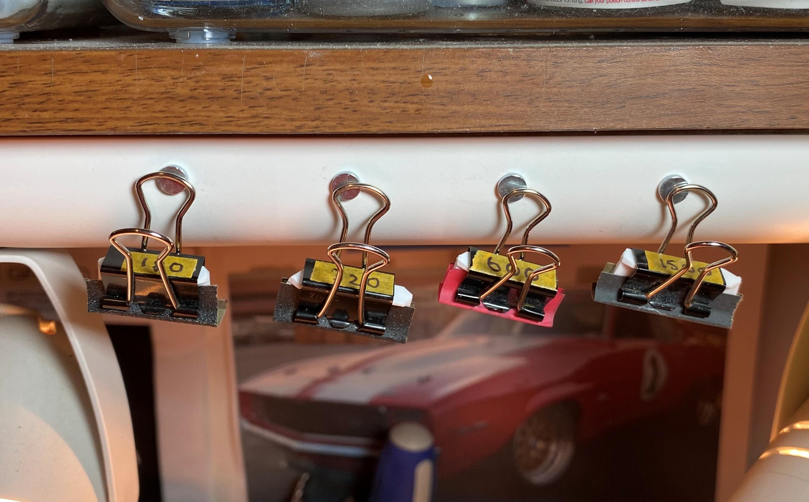

Bills72sj Posted January 8, 2023 Posted January 8, 2023 I was looking for a way to sand some ridges out of the paint on my 67 Shelby with painted stripes. Folded sandpaper is awkward to hold and sand with fine control. What I needed was a 1:25 scale "long board" sanding block. I figured out how to accomplish all these criteria in one fell swoop. 1" long chunks of Plastruct 7/16" I-beam. Various grades of sandpaper cut into 1" squares. Office supply binder clamps (small size) Simply assemble and sand away. They provide very precise control of what you are sanding. The binder clamps hold the sandpaper securely for you. The size fits very comfortably in your hand. It does not "unravel" when you let go of it. If you mark the clamps like I did, you know what grit you are grabbing. I added mini magnets on my light fixture to always have them at the ready. Using just 1" squares at a time will let your sandpaper go a long way. 6 2

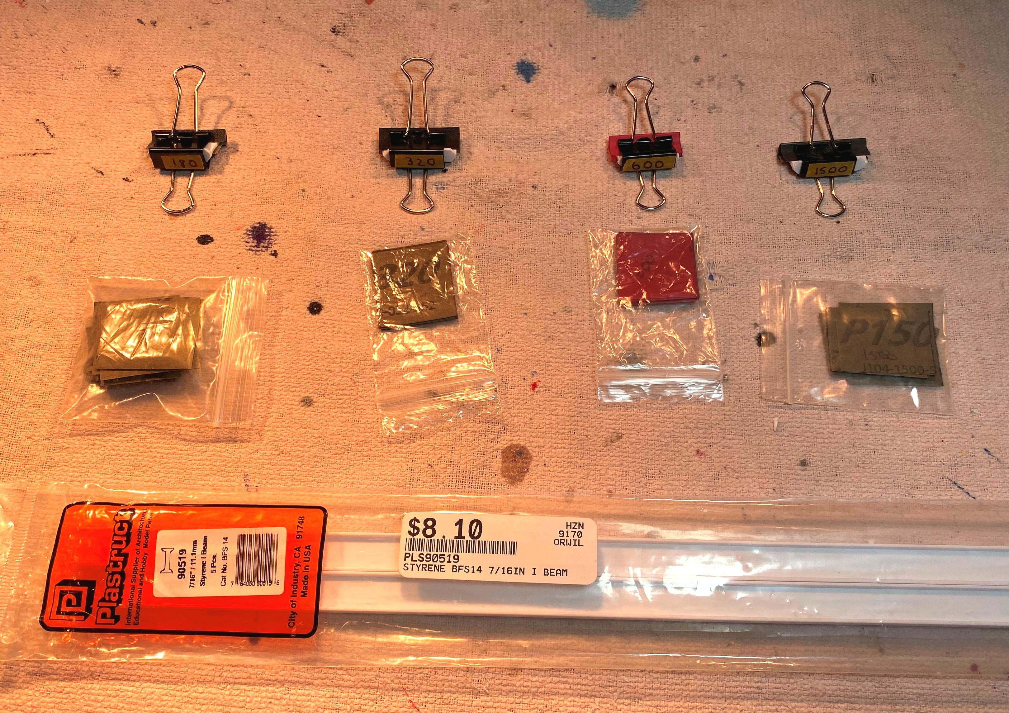

Bills72sj Posted January 8, 2023 Author Posted January 8, 2023 Thanks guys. Here is a pic of them on my bench. 1
