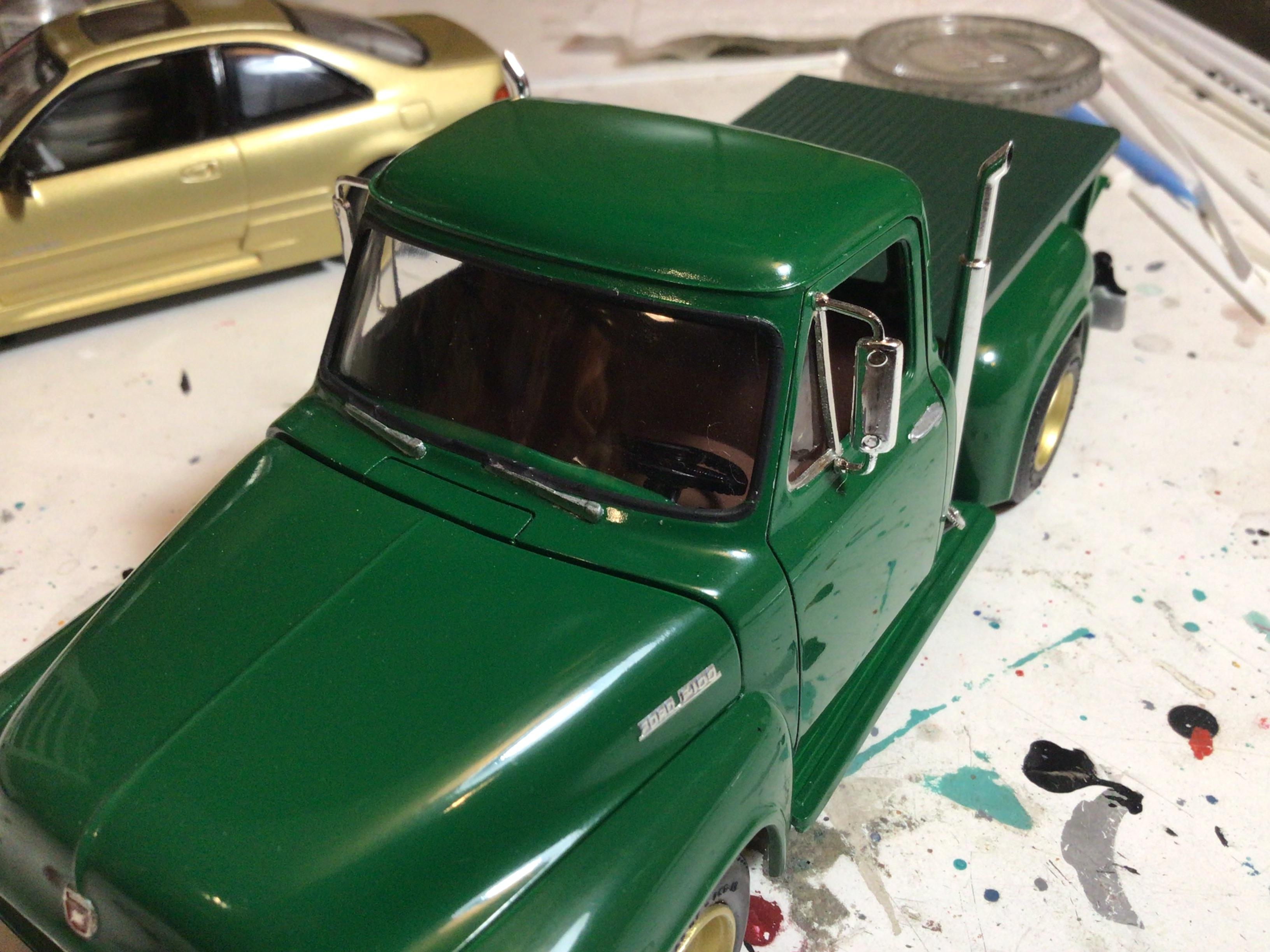

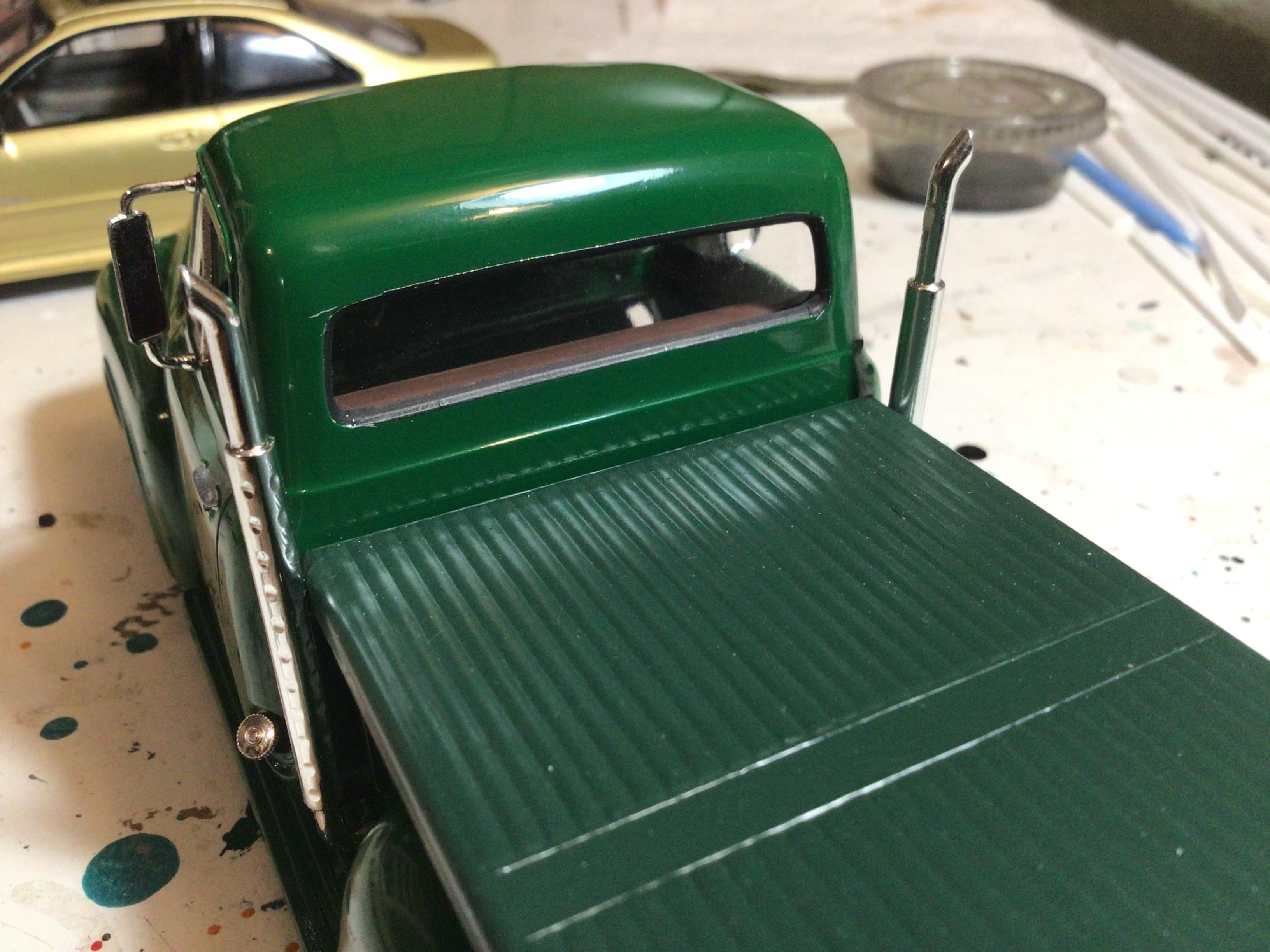

Steve H Posted January 15, 2023 Posted January 15, 2023 I tried it once with mediocre results. I wanted all the chrome to be “smoked”. I sprayed a small section of foil in smoke, then applied VERY carefully, still there was cracking etc. I was happy enough with the result, as this is just a curb side, but likely won’t try again. 1
