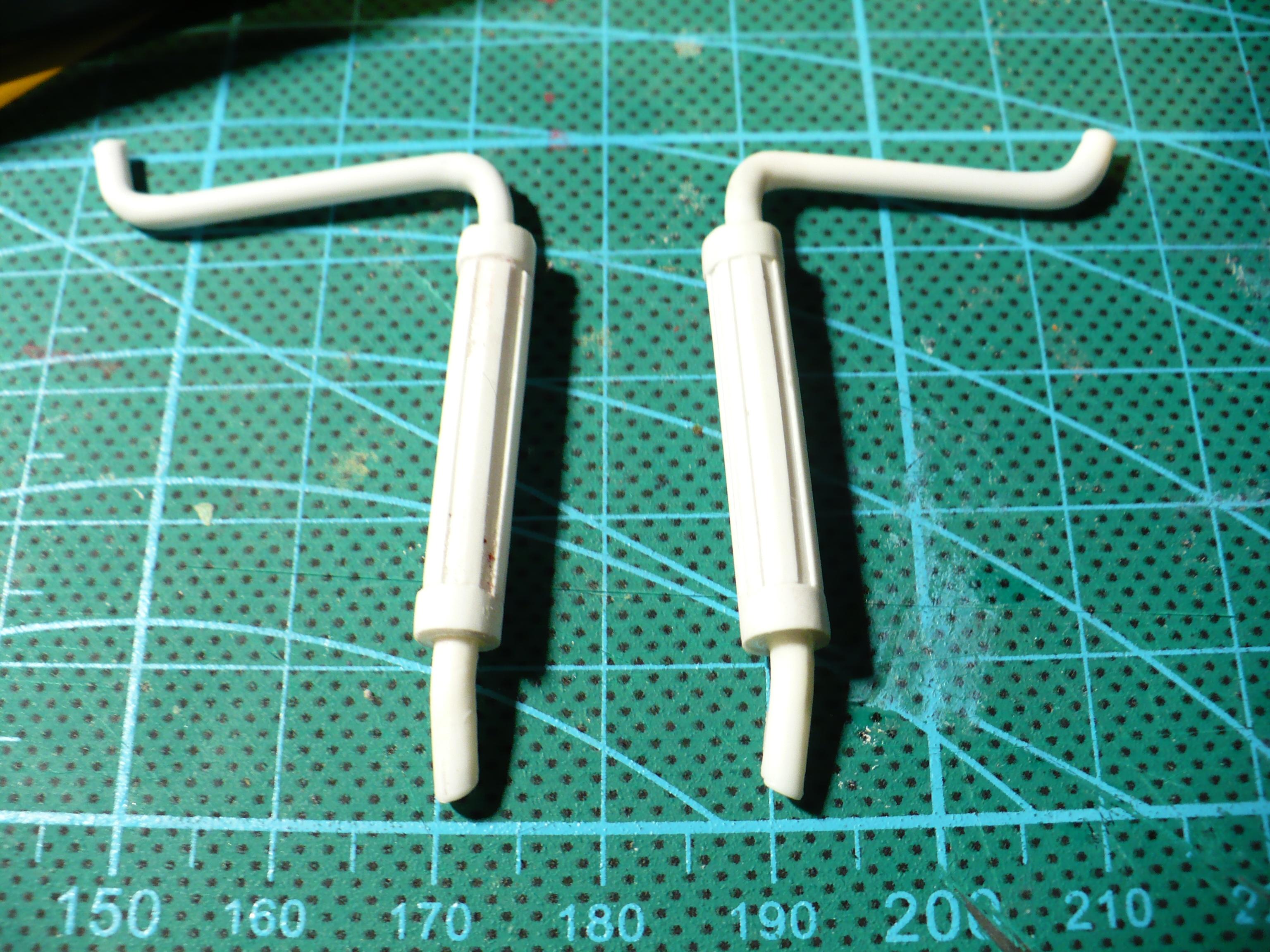

Well after a brief intermission it is back to work on this.
Nice pair of late 60s/early 70s, cheap, made in Japan (when made in Japan still meant cheap) resonated side pipes and the whole three scale feet of exhaust pipe that hooks directly to the headers. No mufflers were harmed in the manufacturing of the exhaust system on the real thing nor model.
  • Like 1
