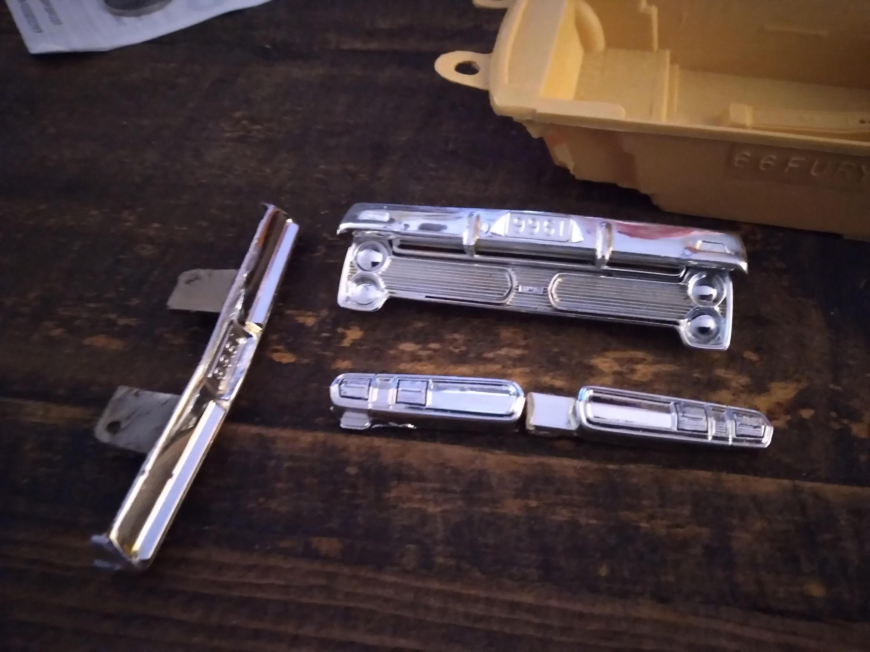

Scott8950 Posted January 18, 2023 Posted January 18, 2023 Needing advice on casting some 66 fury bumpers and grill. This will be my first time attempting this and any advice is greatly appreciated.

Scott8950 Posted January 18, 2023 Author Posted January 18, 2023 16 minutes ago, Chariots of Fire said: You need mold making materials, mold release and casting resin to start. If you can post a photo of what you want to cast perhaps I can offer some suggestions. A two-part mold may be in order. These are the parts I need to cast.
Chariots of Fire Posted January 18, 2023 Posted January 18, 2023 Definitely two part molds will be needed, especially for the part on the left and the combination grill bumper assembly at the top. You would need to plug the opening between the grill and bumper with some soft clay or tape the back with some masking tape to keep the mold separated in two parts. If the part in the lower right is straight and flat on the back side you could glue it to a piece of plastic sheet stock, build the mold box around it and then pour the mold material on top of it directly. If you need to keep it as a usable piece use white glue so that you can remove it from the plastic after the mold is made. You've got some work to do, I'm afraid, but hope this helps.
Rick L Posted January 18, 2023 Posted January 18, 2023 18 minutes ago, Chariots of Fire said: Definitely two part molds will be needed, especially for the part on the left and the combination grill bumper assembly at the top. You would need to plug the opening between the grill and bumper with some soft clay or tape the back with some masking tape to keep the mold separated in two parts. If the part in the lower right is straight and flat on the back side you could glue it to a piece of plastic sheet stock, build the mold box around it and then pour the mold material on top of it directly. If you need to keep it as a usable piece use white glue so that you can remove it from the plastic after the mold is made. You've got some work to do, I'm afraid, but hope this helps. Be forewarned that clays with sulfur and masking tape will inhibit silicon mold rubber. A tutorial from Smooth-On will help you along the way.
peteski Posted January 18, 2023 Posted January 18, 2023 (edited) I have cast many small parts in open 1-piece molds (using Alumilite first, then Smooth-On resins and RTV). I have not yet advanced to 2-part molds. Jumping straight into 2-part mold territory seems a bit daunting on a first try. Good luck! The grille and taillights could likely be cast in a simple mold (but will require some trimming afterwards). As for the bumper, I can also see a possibility of making it into a single part molds if a stub (which would have to be removed afterwards) is built up around the bumper mounts. Well, on a second look, because the bumper ends curve "up", single part mold will likely not work, unless it is sliced open for removing the cast part. Edited January 18, 2023 by peteski

Mark Posted January 19, 2023 Posted January 19, 2023 Don't count on that nice chrome staying that way during the mold making process. Because it gets wrecked anyway, I strip the plating off before starting, so the castings will be as clean and crisply detailed as the original part. Starting out, use products from one supplier to ensure that everything you use works together. As stated by others already, certain mold materials will not cure if they come into contact with certain types of clay that is used in the mold making process. Certain resins don't cure when used with the "wrong" mold materials. Get everything from one company to avoid problems like that. The learning curve can be steep enough without having to diagnose problems that arise due to incompatible materials, not to mention time and money wasted.
