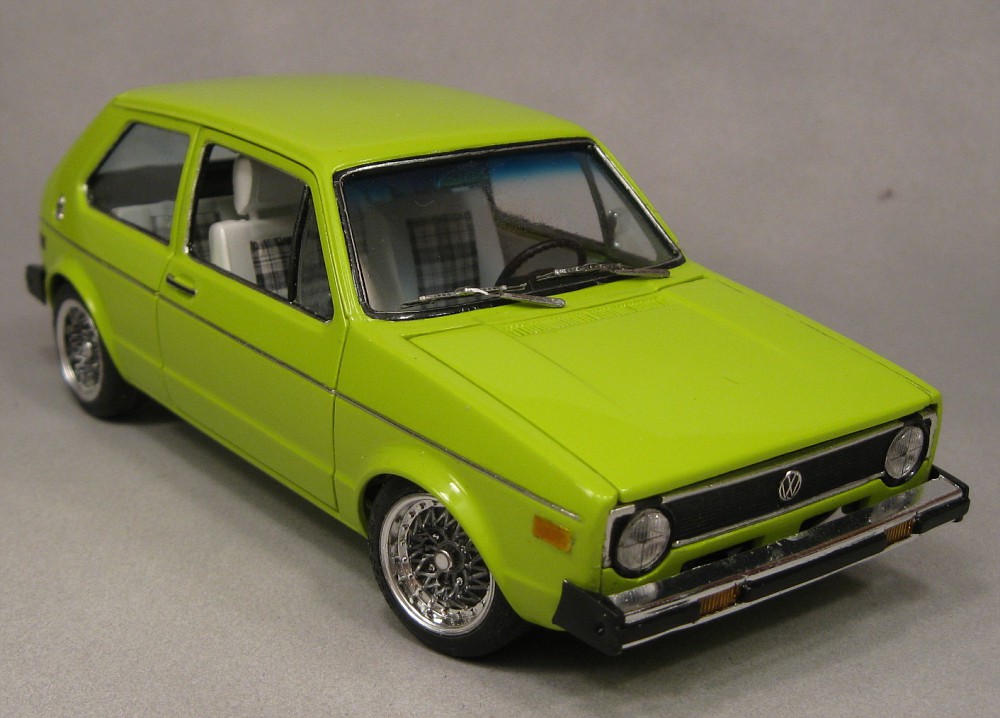

Can-Con Posted January 23, 2023 Posted January 23, 2023 (edited) 13 hours ago, jdcar32 said: the photo etch stuff is too 1 dimensional. It depends on what photoetch ones you get. If you get the simple ones, yes they look flat. Get a good set that's multi piece that you have to bend up they look pretty good. These ones from Model Car Garage look pretty good if you use them the way they were intended. Edited January 23, 2023 by Can-Con 2 2
Can-Con Posted January 23, 2023 Posted January 23, 2023 A set like this works even better but are harder to work with too. IIRC, these are the ones I used on the models above. 1

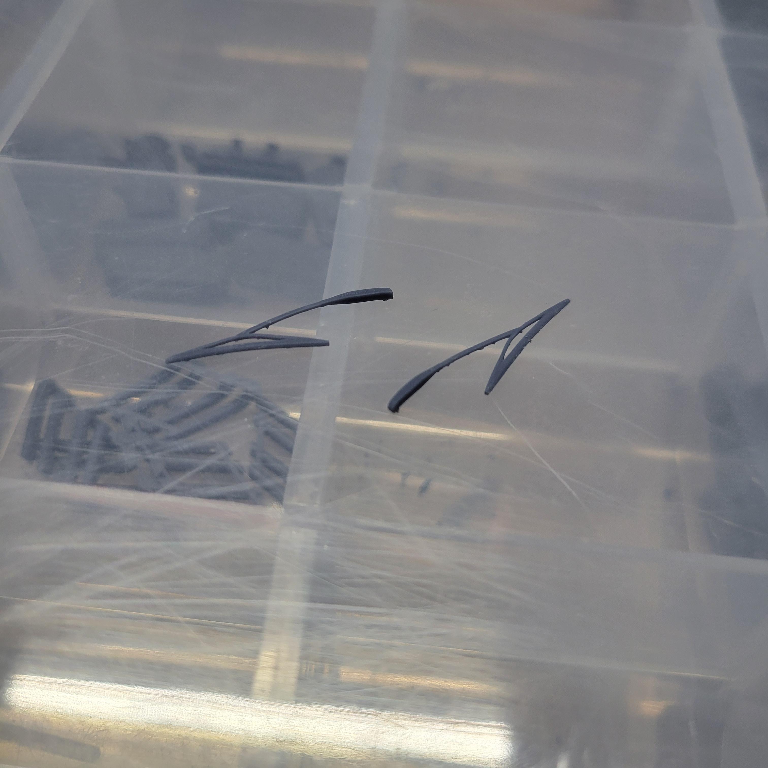

Texas_3D_Customs Posted January 28, 2023 Posted January 28, 2023 (edited) On 1/23/2023 at 11:51 AM, Oldmopars said: While this is not an impossible task, the issue is that they are such a small part, that you would print 10 and maybe get 5 that didn’t break. Then because they are so small, and difficult to to deal with, a printer would have to charge more than anyone would want to pay for them. There is a resin that is “tougher “, but it costs 2x as much as the normal resin. It is more flexible and would work better for these small parts, but again, the cost issue. On your own, no big deal. You throw 20 on the build plate and do your best to save as many as you can. Another issue is that there are many different sizes of wipers, small cars, big cars, 1/24, 1/25 scale, trucks, etc. They would have to offer several sizes. I think most would agree, it is not a product that they can sell and not lose money on. Challenge accepted, I bet I can get 10 for 10 Edited January 28, 2023 by Texas_3D_Customs

Oldmopars Posted January 28, 2023 Posted January 28, 2023 (edited) 2 hours ago, Texas_3D_Customs said: Challenge accepted, I bet I can get 10 for 10 I have no doubt you can find a way to print them. Like I said, not impossible. But, what would you have to charge to make it worth your time? Add shipping, materials, etc. Just seems like it would be hard to set a price people would pay, and pay for your time. I can draw it, but is it worth it? Edited January 28, 2023 by Oldmopars
Calb56 Posted February 3, 2023 Posted February 3, 2023 1 hour ago, Texas_3D_Customs said: Just saying Wow.
Oldriginal86 Posted February 3, 2023 Posted February 3, 2023 I didn’t see the wipers on your website. Are these going to be offered or was this a test?
Texas_3D_Customs Posted February 6, 2023 Posted February 6, 2023 On 2/3/2023 at 5:53 PM, Oldriginal86 said: I didn’t see the wipers on your website. Are these going to be offered or was this a test? These were the wipers from the Ford W Semi
