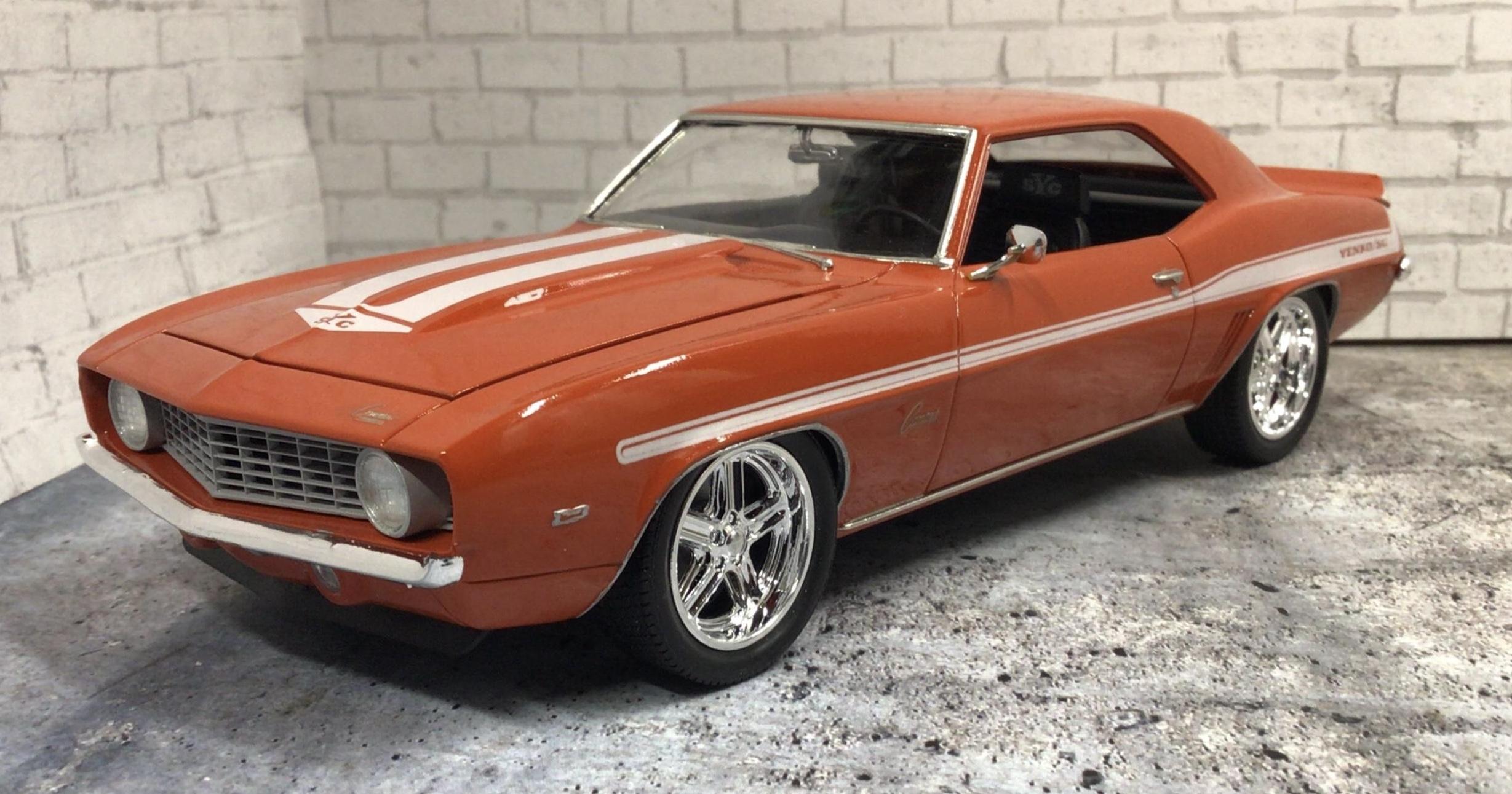

NOBLNG Posted January 25, 2023 Posted January 25, 2023 (edited) This is Duplicolor engine enamel. Decanted, thinned slightly with LT and airbrushed. I think it would be too thick straight from the can. Best advice is to do a test first. Edited January 25, 2023 by NOBLNG 1
