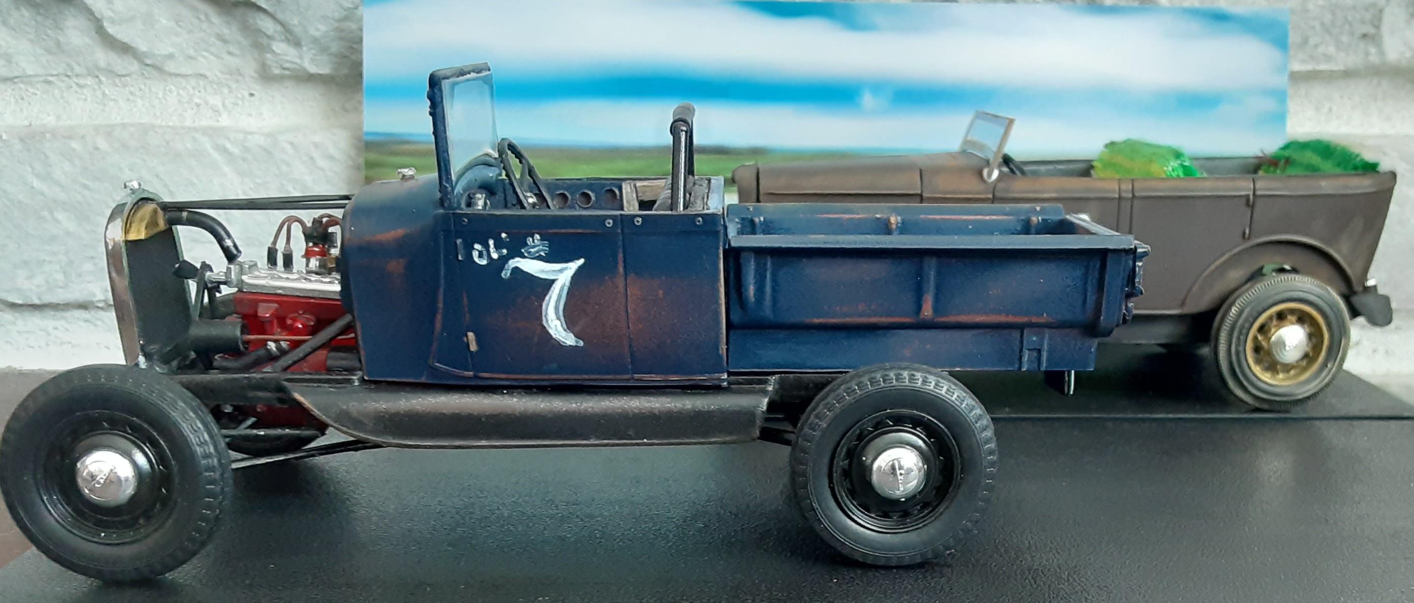

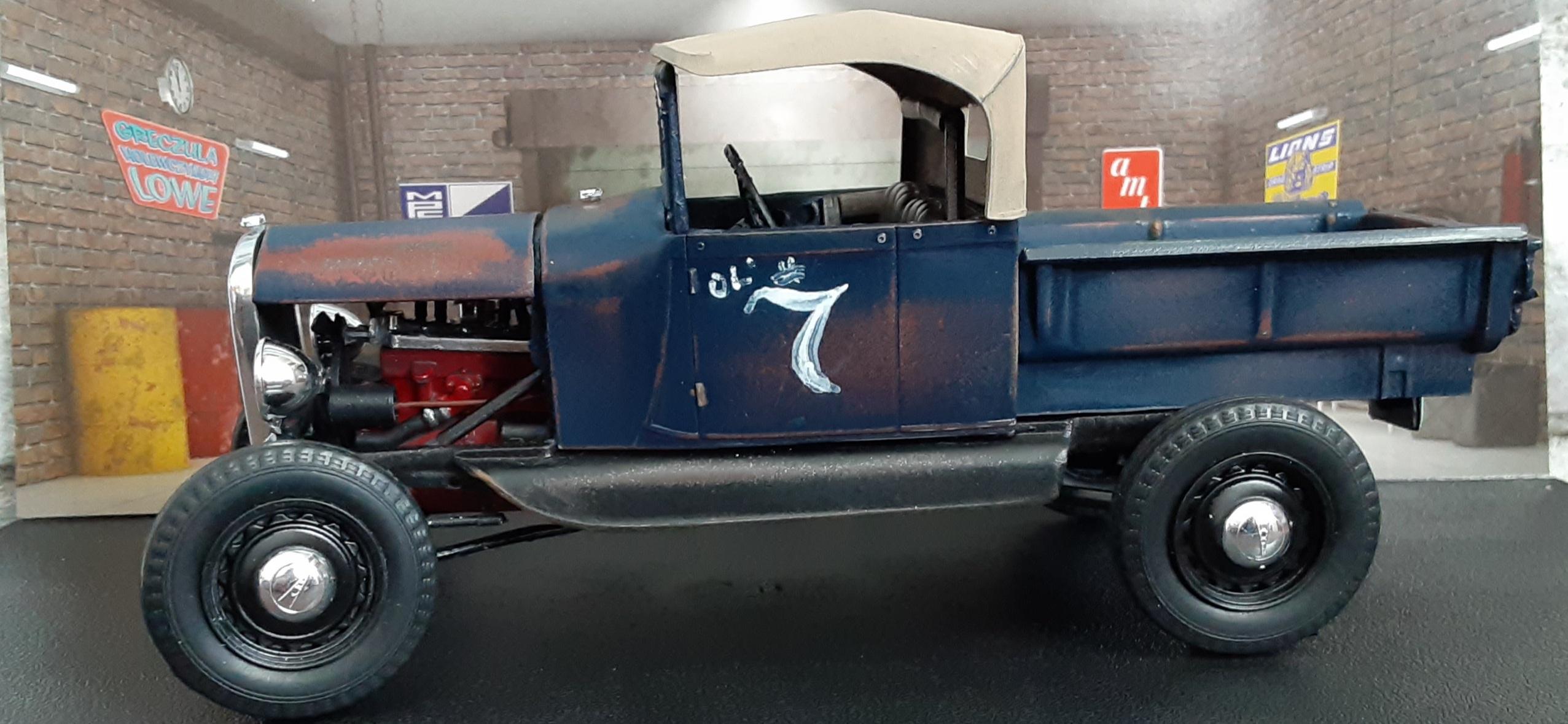

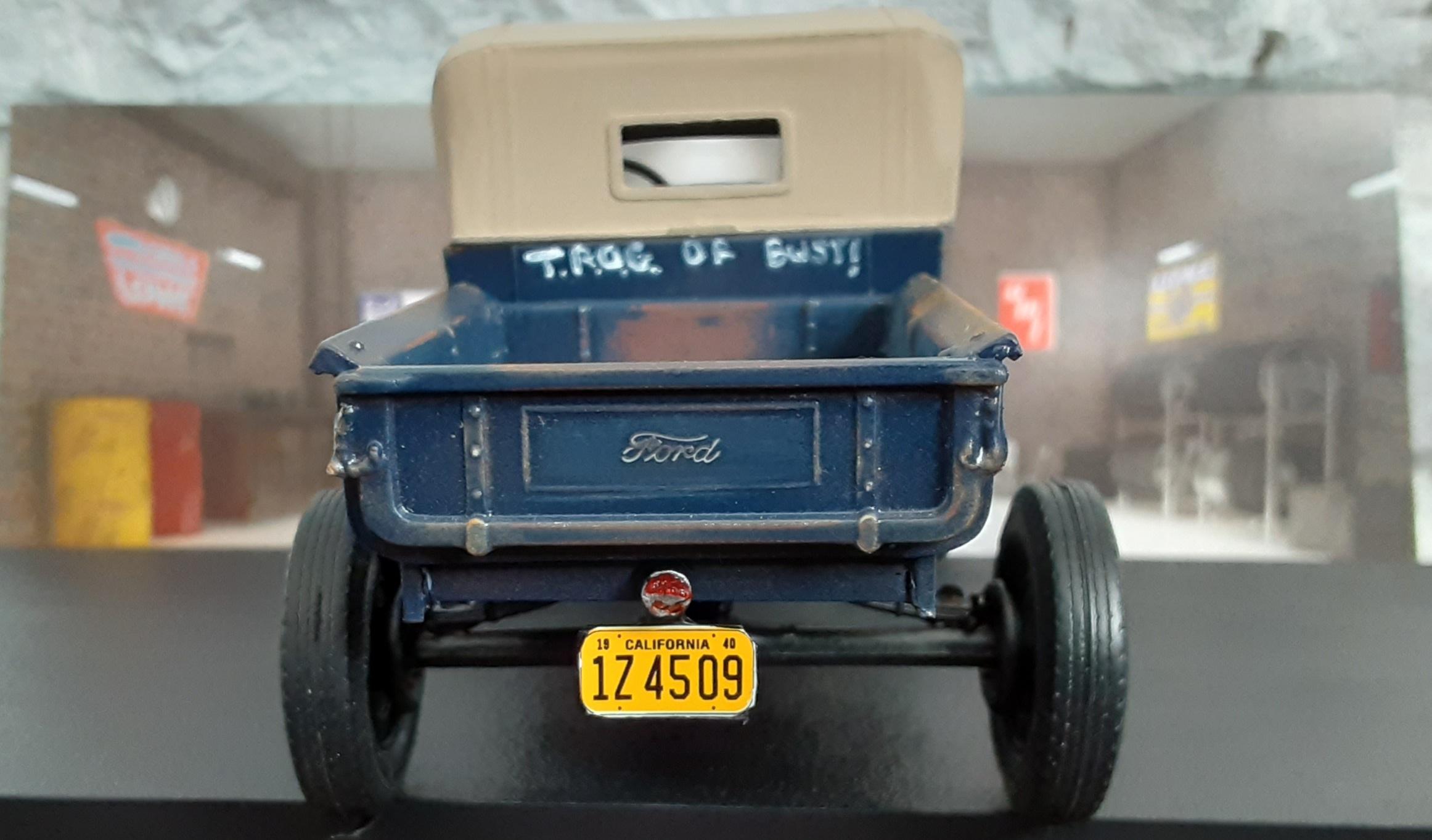

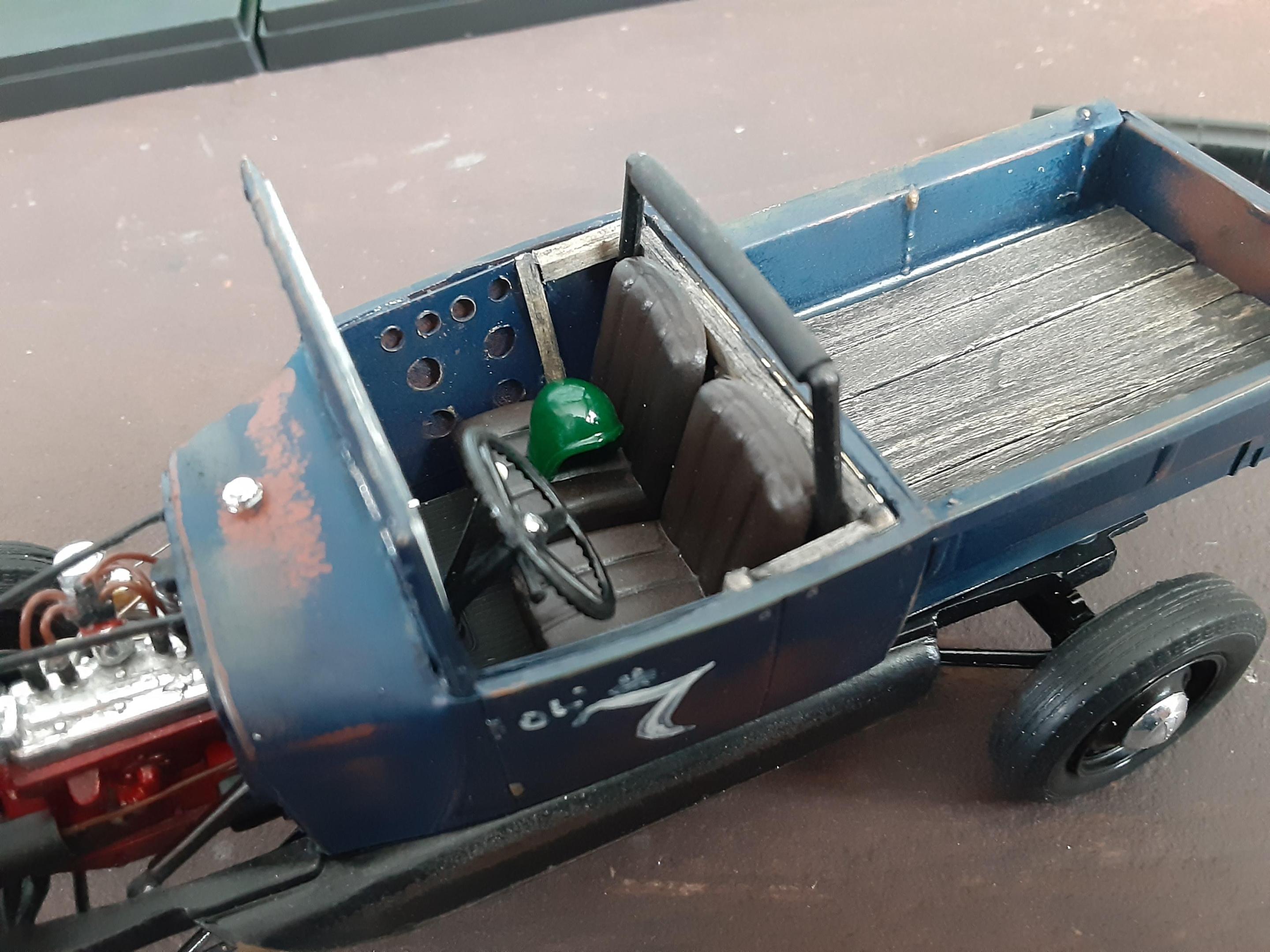

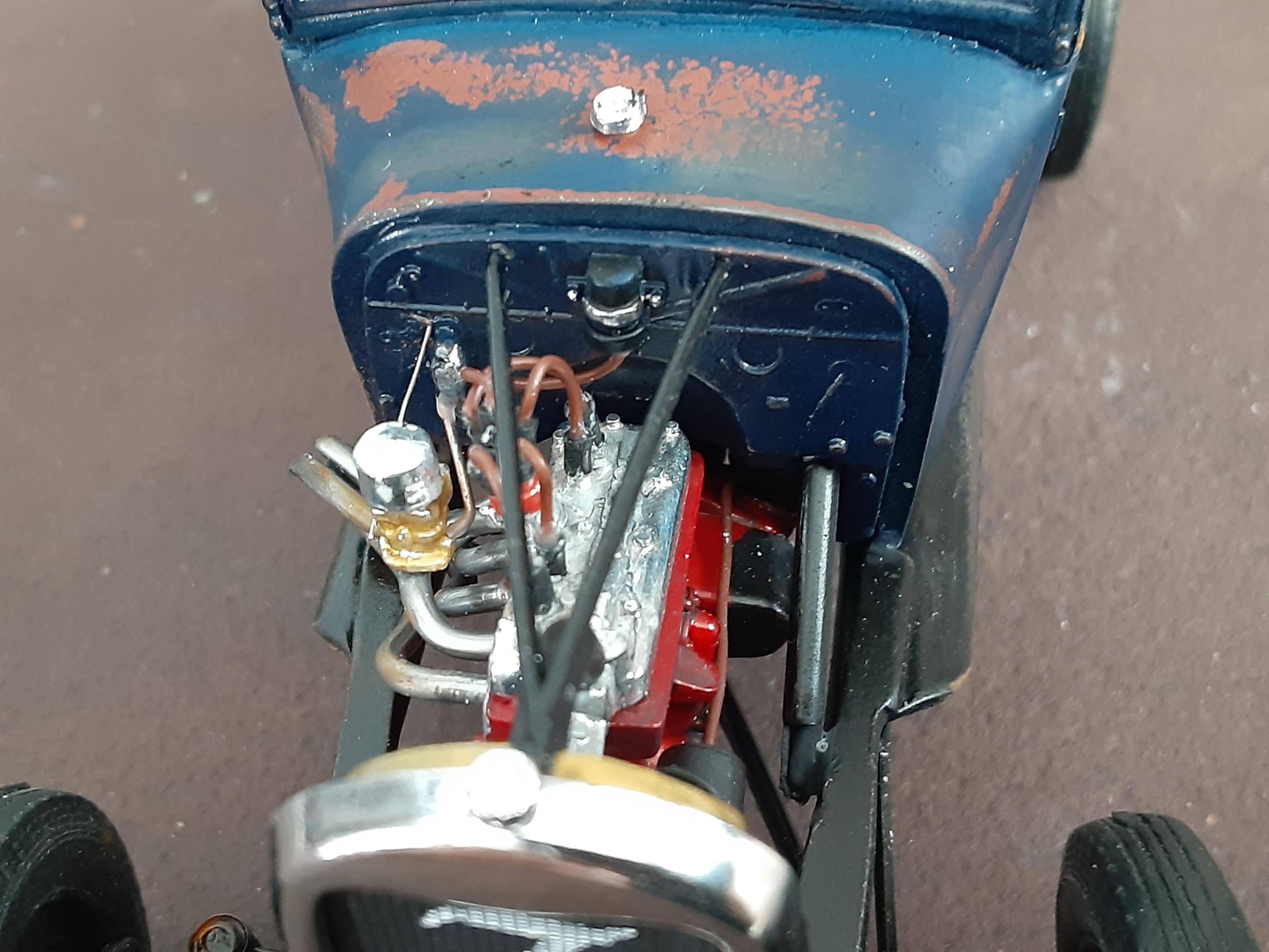

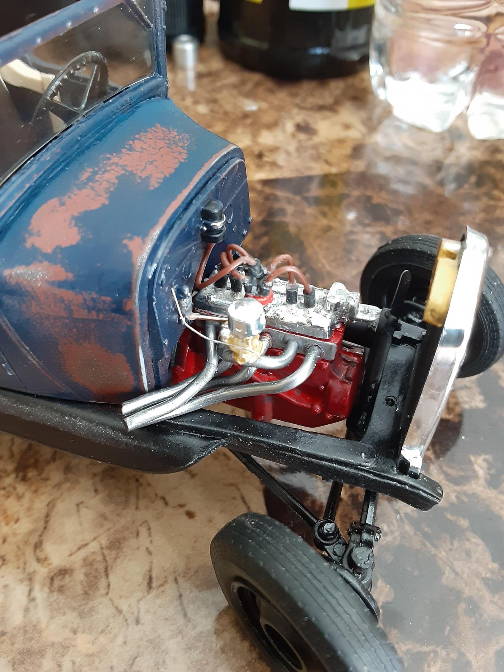

53gmc Posted January 26, 2023 Posted January 26, 2023 Finally wrapped this one up. Started with the amt '29 ford kit, i built it to t.r.o.g specs. Using the kits 4 cylinder, i made my own header and intake, used the head and carb from a different kit, and added wiring/ fuel line/ throttle cable. In the interior, i made door panels, wood framing, and seats from a 32 ford phaeton. The roll bar is one i shortened and narrowed, the padding is made from electric shrink wrap. The exterior i cut the fenders, hood sides, and bed floor out. Added real wood to the bed. The paint i started with brown, then dark metallic, red primer, and finally navy blue. I wet sanded through the layers to get the patina look. T.r.o.g rules state no wood spokes or stock model "A" wire wheels, so i used artillery wheels from a '37 ford pickup. Finally the rules state no headlights while racing, so i made them and the top removable. 5

ModWrench Posted February 4, 2023 Posted February 4, 2023 Like this one, especially the artillery wheels and the door cards! 1
stavanzer Posted February 7, 2023 Posted February 7, 2023 Awesome Build! You really nailed the look. Did you hand paint the Door Numbers? They look real. 1

53gmc Posted February 18, 2023 Author Posted February 18, 2023 On 2/7/2023 at 9:44 AM, stavanzer said: Awesome Build! You really nailed the look. Did you hand paint the Door Numbers? They look real. Thanks i did a ton of research on this one! I did, luckily it was water based since it took me a few tries lol
alan barton Posted February 27, 2023 Posted February 27, 2023 I've developed quite a soft spot for this type of racer. The effect you achieved on your woodwork is amazing! Cheers Alan 1
