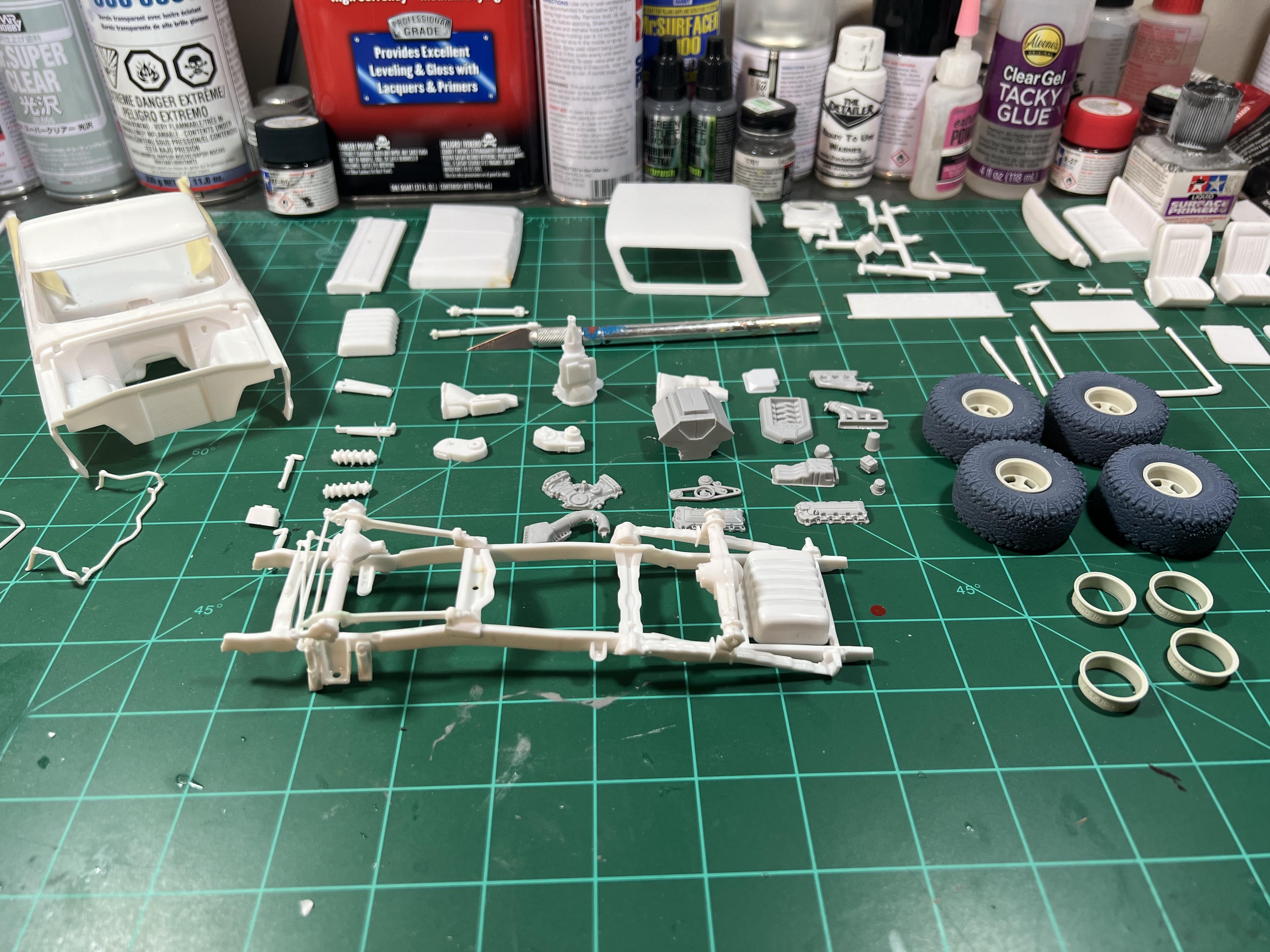

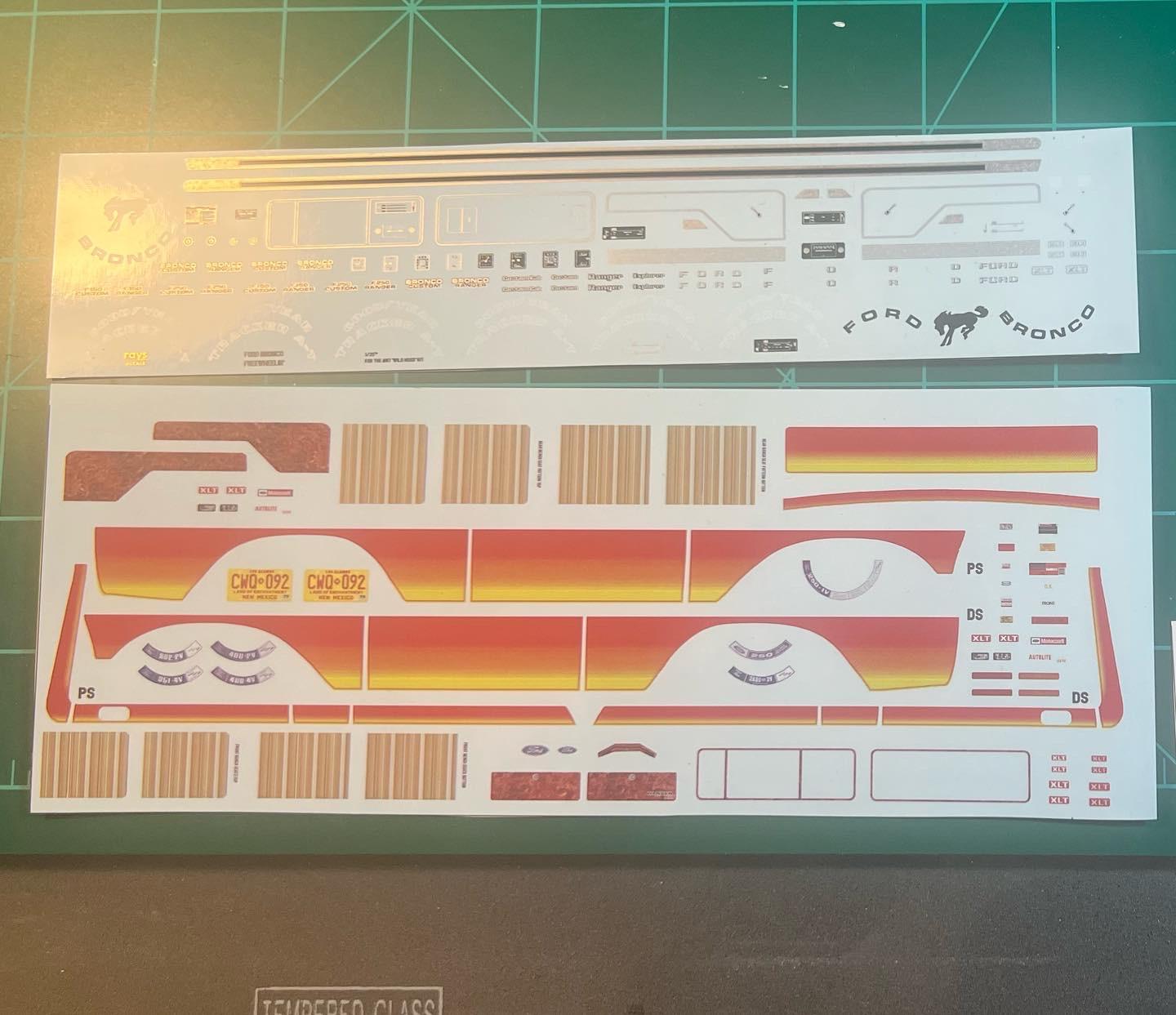

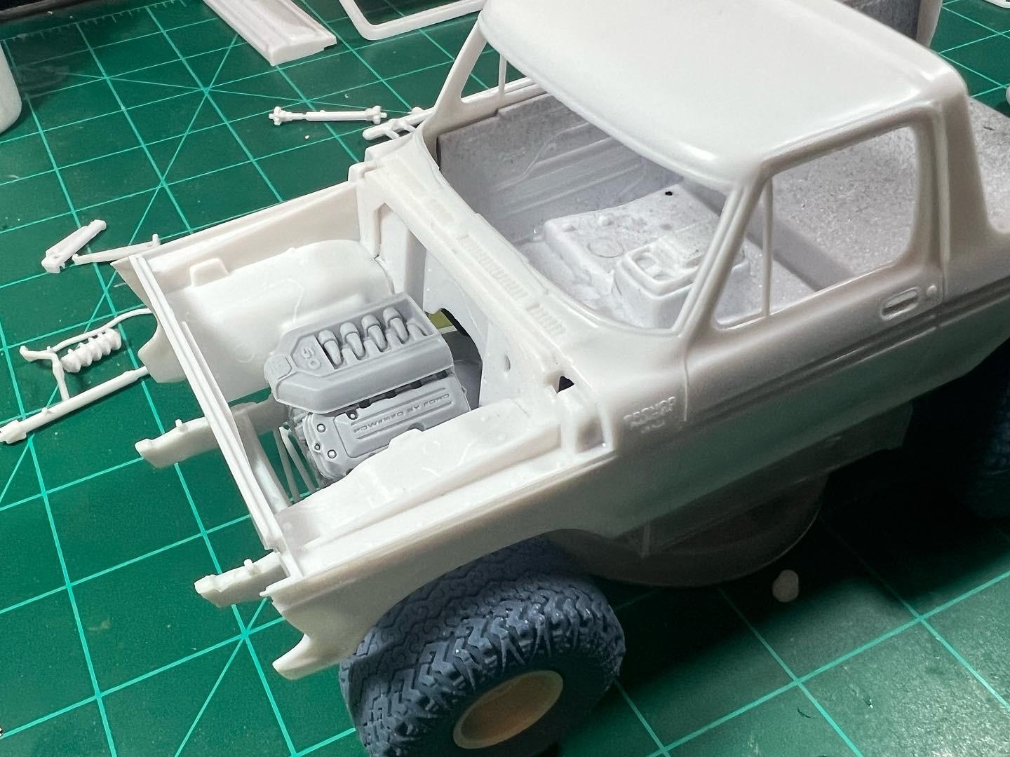

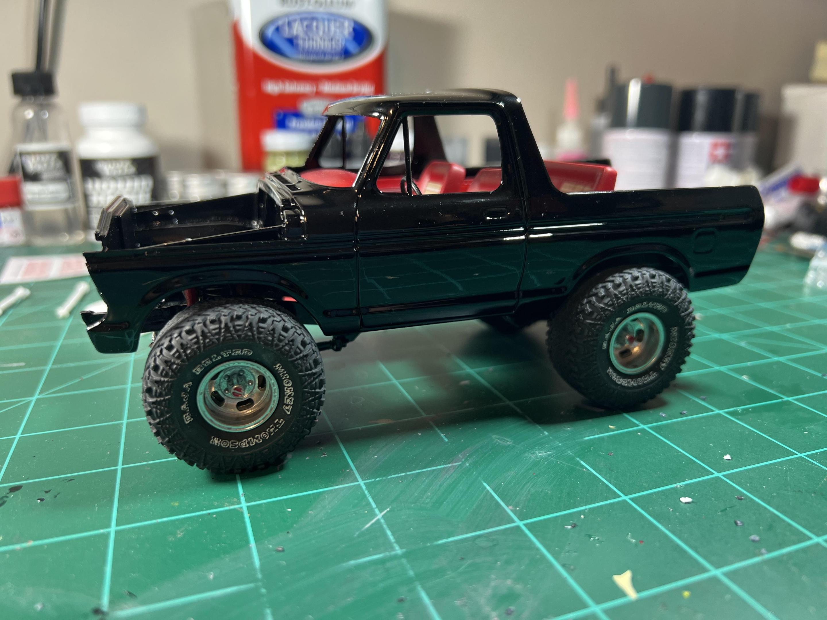

catpack68 Posted January 27, 2023 Posted January 27, 2023 (edited) I was posting this in the what have you done today thread in the general section of the forum,but I thought i should post it up here.It’s the AMT Wild Hoss Bronco kit. I modified the kit suspension to sit higher so I could use the big Fireball resin M/T tires. I wanted to use the Fireball resin five 15X12 slot wheels for a classic look.The resin Coyote 5.0 is from JPS custom wheels/tires.The bronco freewheelin’ decals are from Rays Kits. Edited January 27, 2023 by catpack68 4

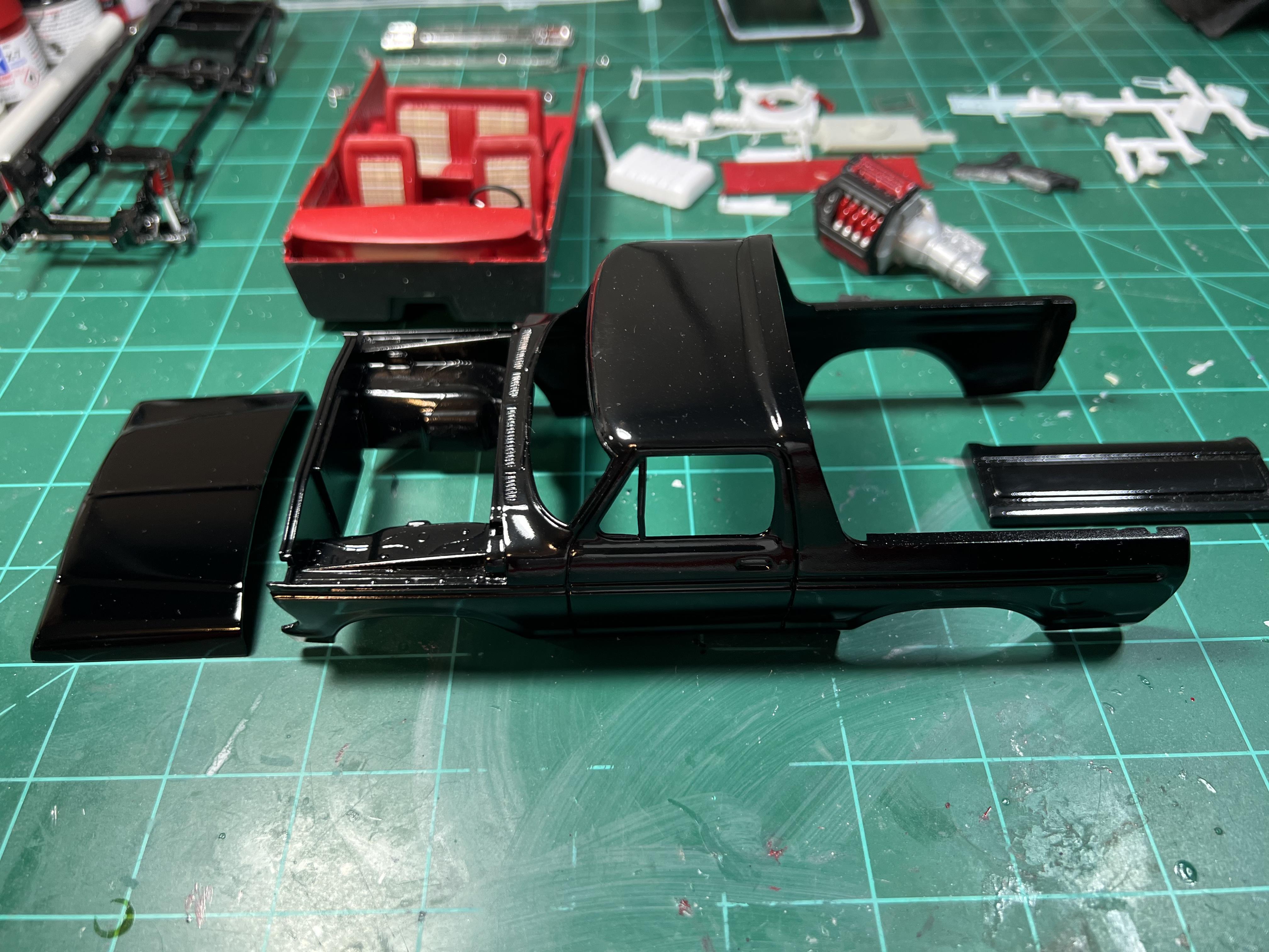

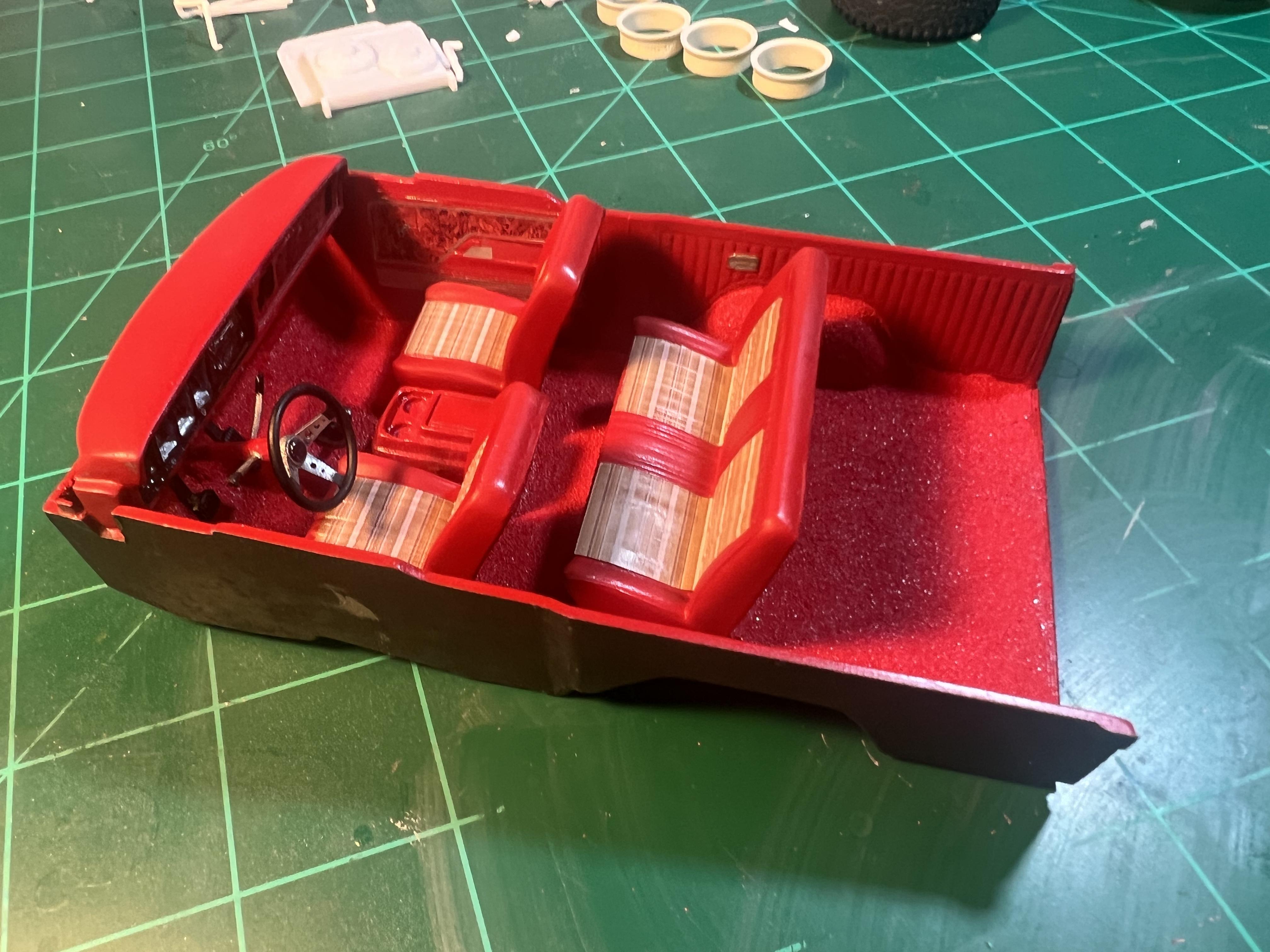

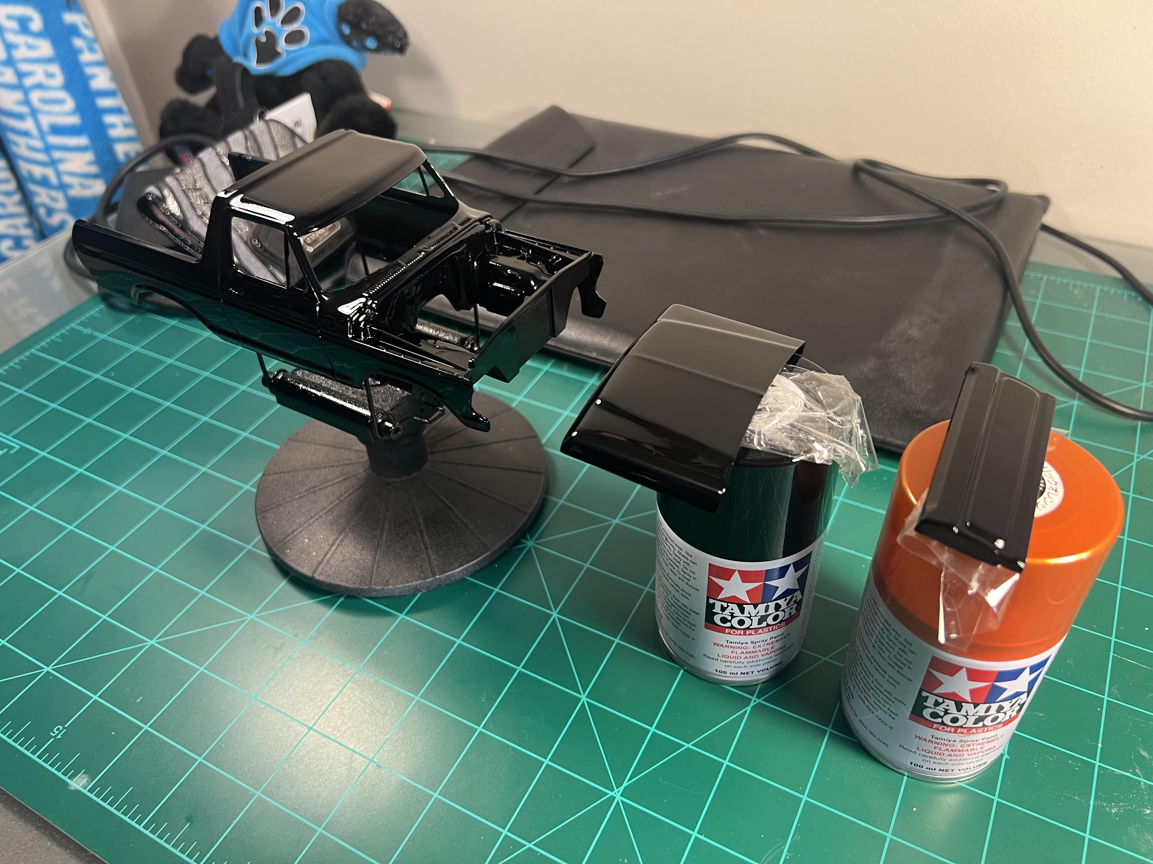

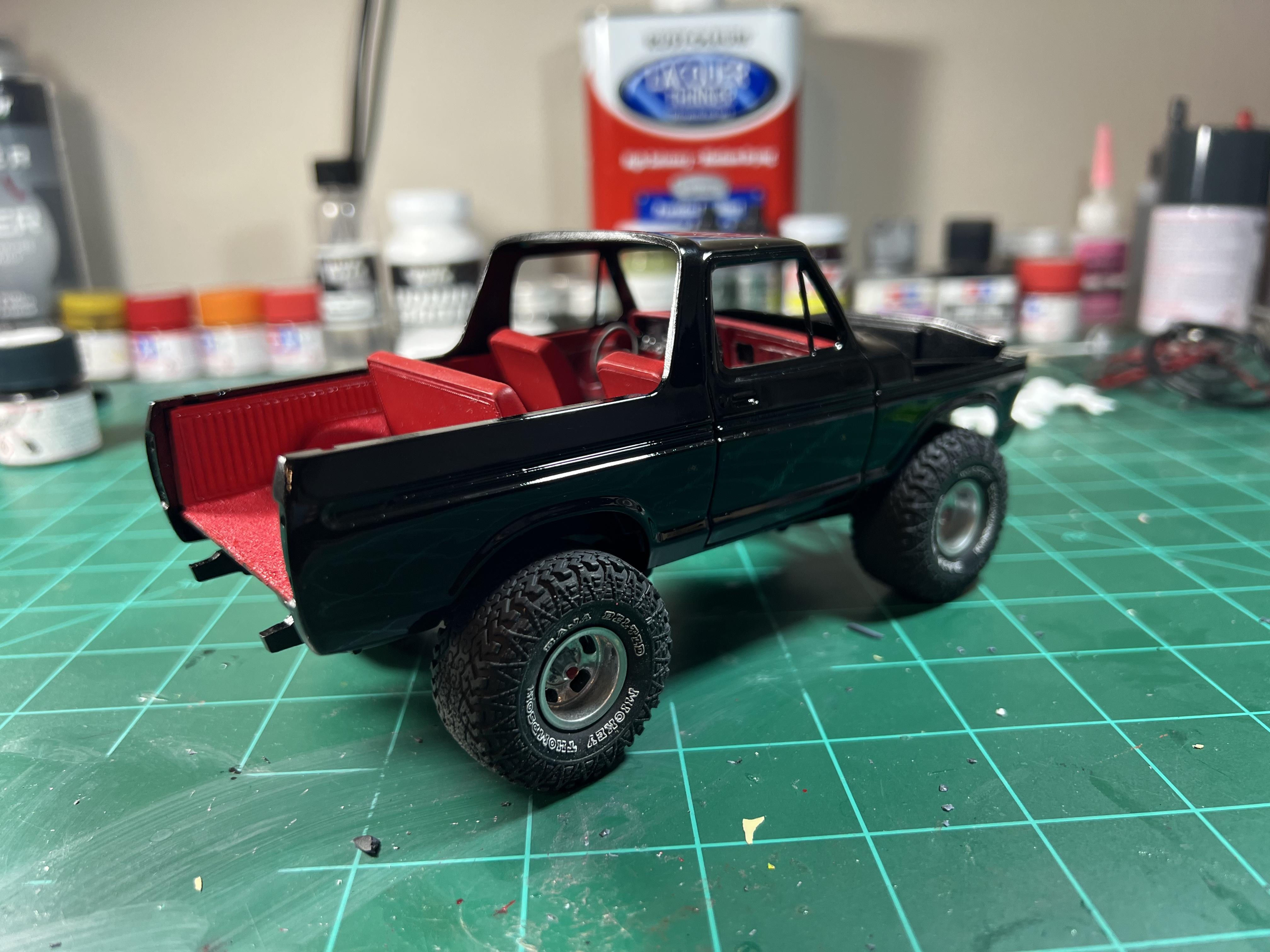

catpack68 Posted January 27, 2023 Author Posted January 27, 2023 (edited) I got the body painted Tamiya TS-14 Black and the clear is 2 part automotive urethane. The interior is Tamiya Red with Mr Hobby matte clear. The interior decals are from the Rays decal sheet Edited January 27, 2023 by catpack68 6

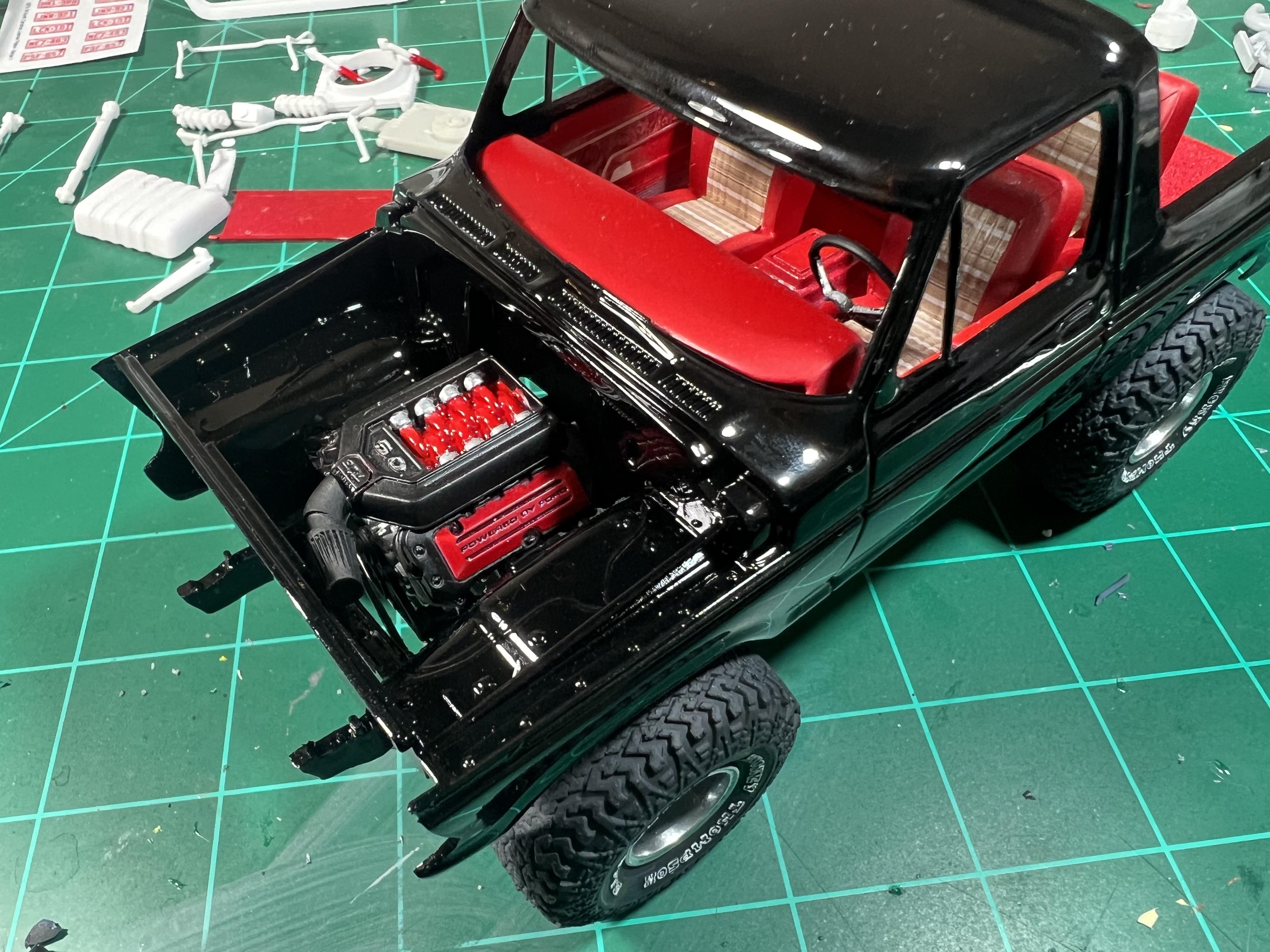

catpack68 Posted January 27, 2023 Author Posted January 27, 2023 (edited) I have it sitting on four wheels now,and i just finished up the engine. Still a little ways to go but getting there.More updates soon. Edited January 27, 2023 by catpack68 8

SpikeSchumacher Posted January 27, 2023 Posted January 27, 2023 That's looking really good Scott! I like the interior and the way you painted the engine ? Not to mention how good the black looks. Always a tough color to work with... 1
dino246gt Posted January 27, 2023 Posted January 27, 2023 Wow, what a beauty! Looks so good, I love it! 1
Dave72 Posted January 28, 2023 Posted January 28, 2023 That is a cool Bronco! Very nicely done so far! 1

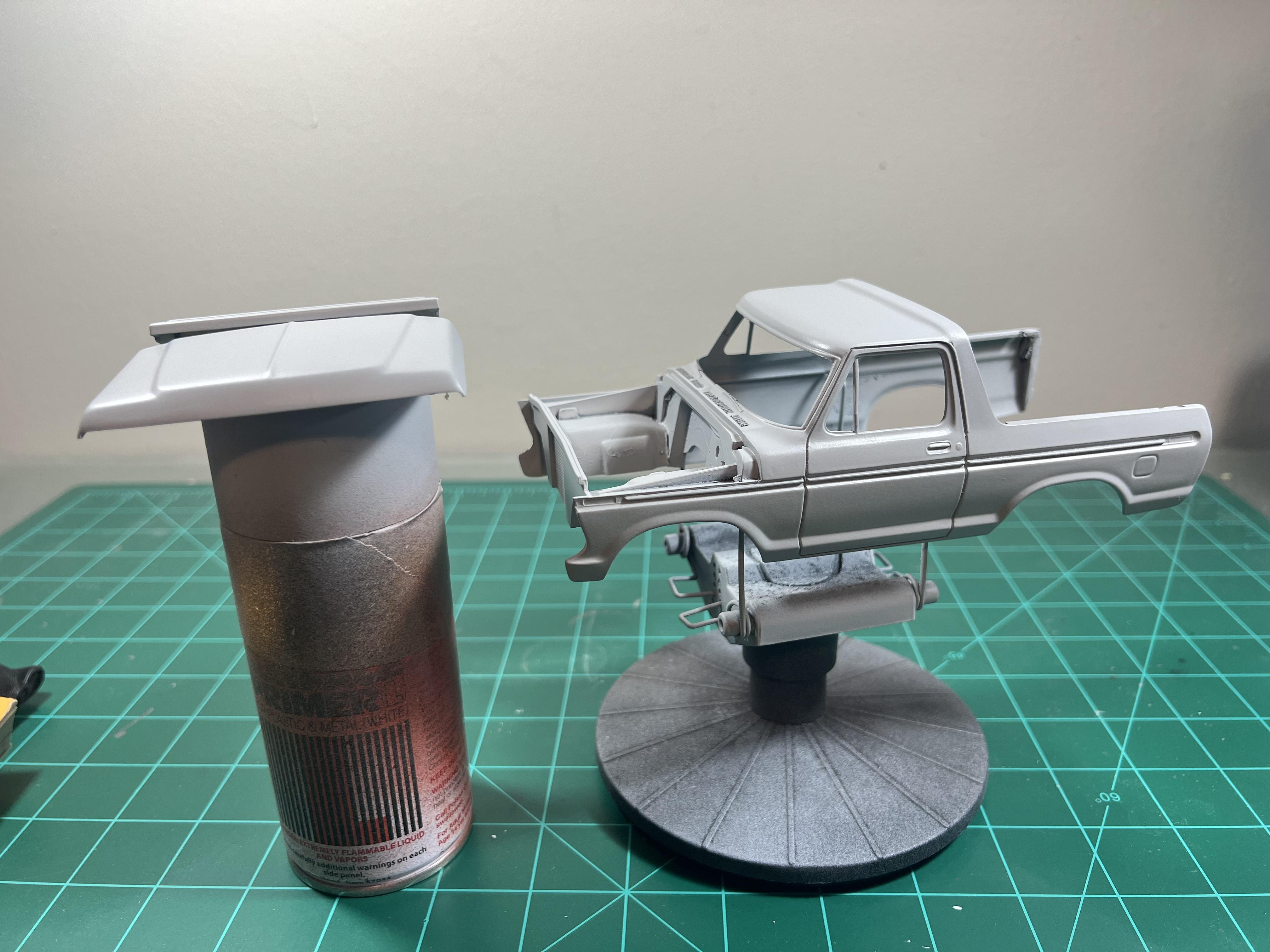

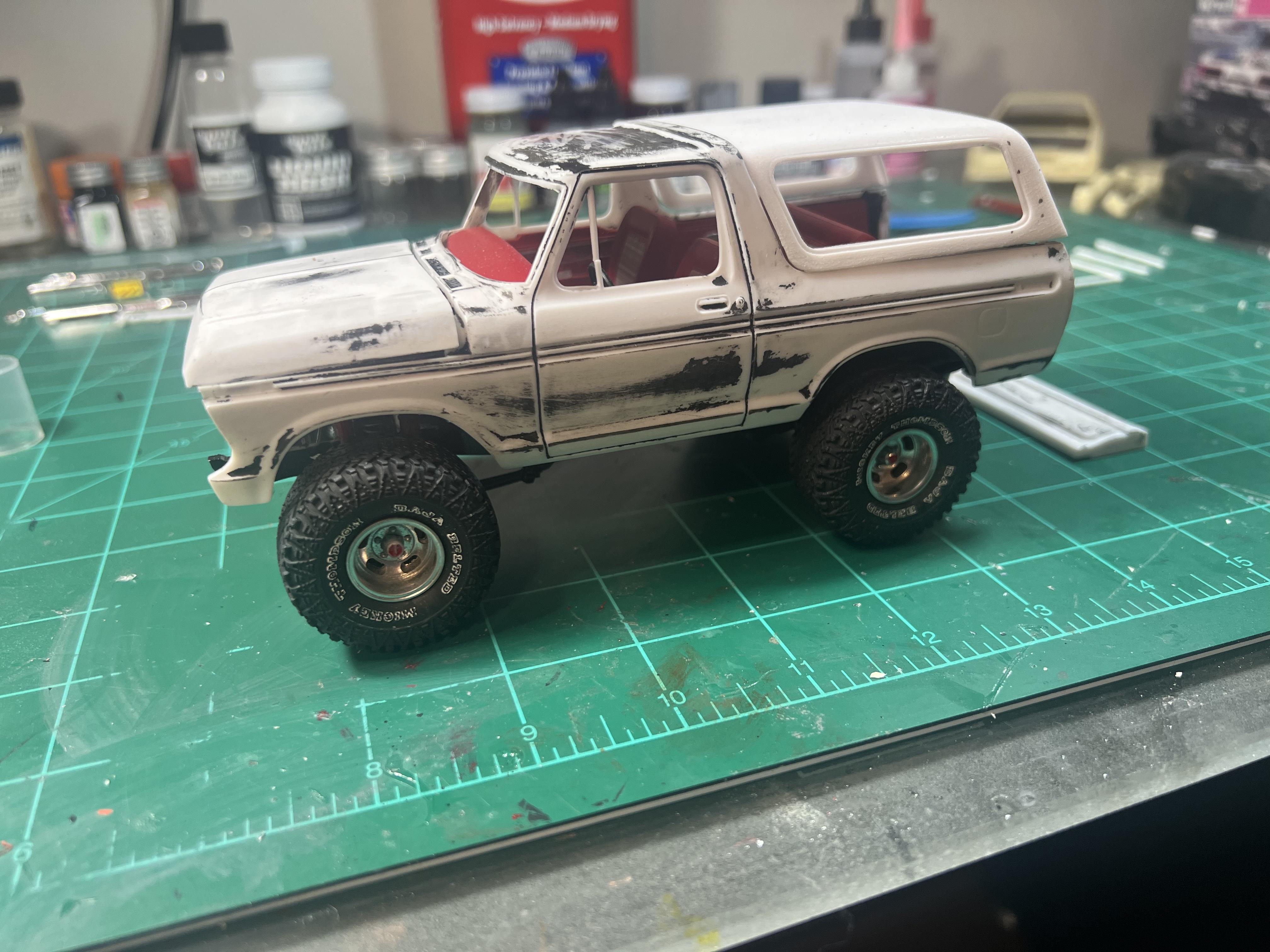

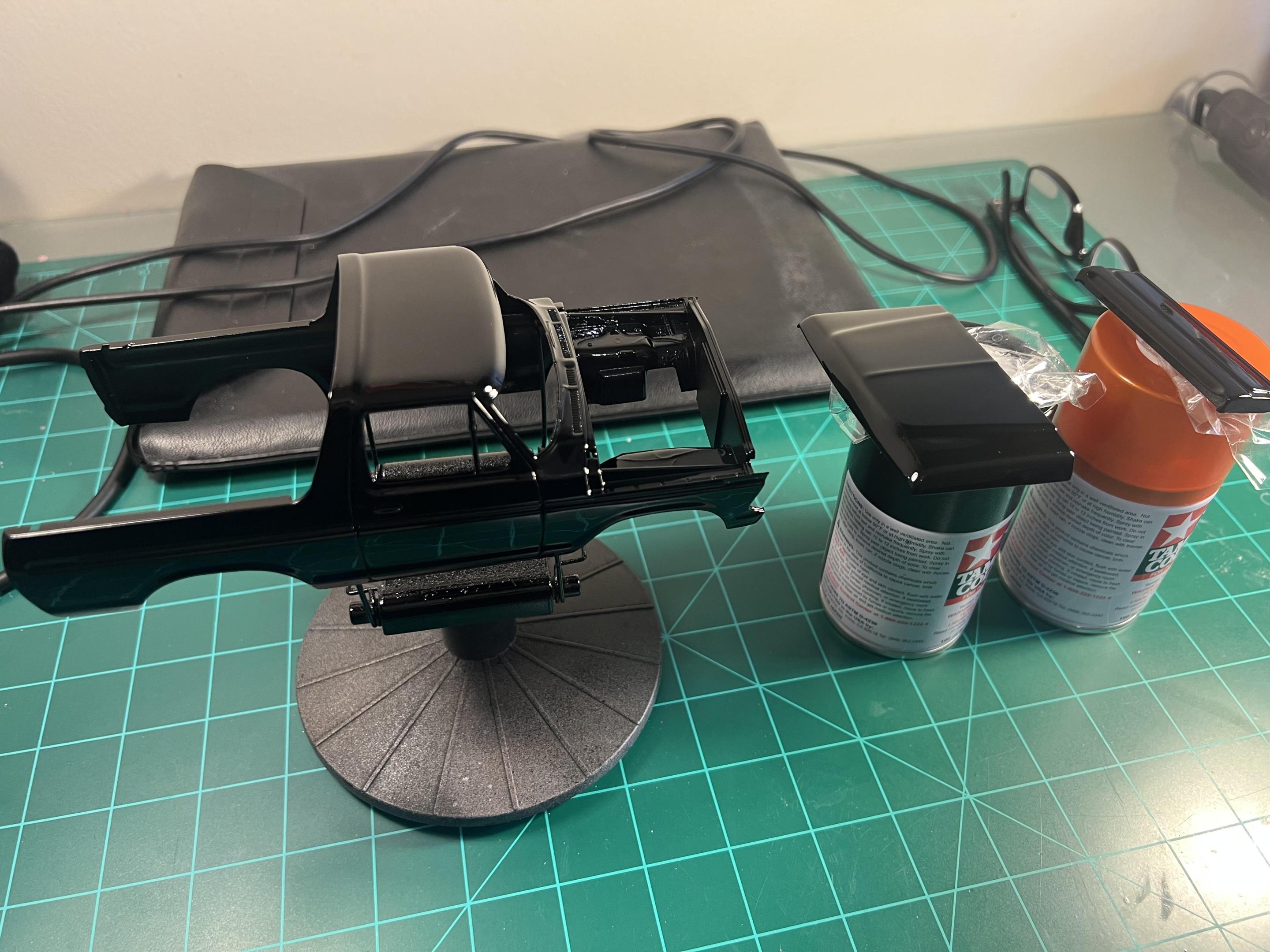

catpack68 Posted February 7, 2023 Author Posted February 7, 2023 (edited) I had to strip the body of my Bronco project after burning through the paint polishing it out? Gonna get the body for primer and hopefully get it painted this weekend. Edited February 7, 2023 by catpack68 2

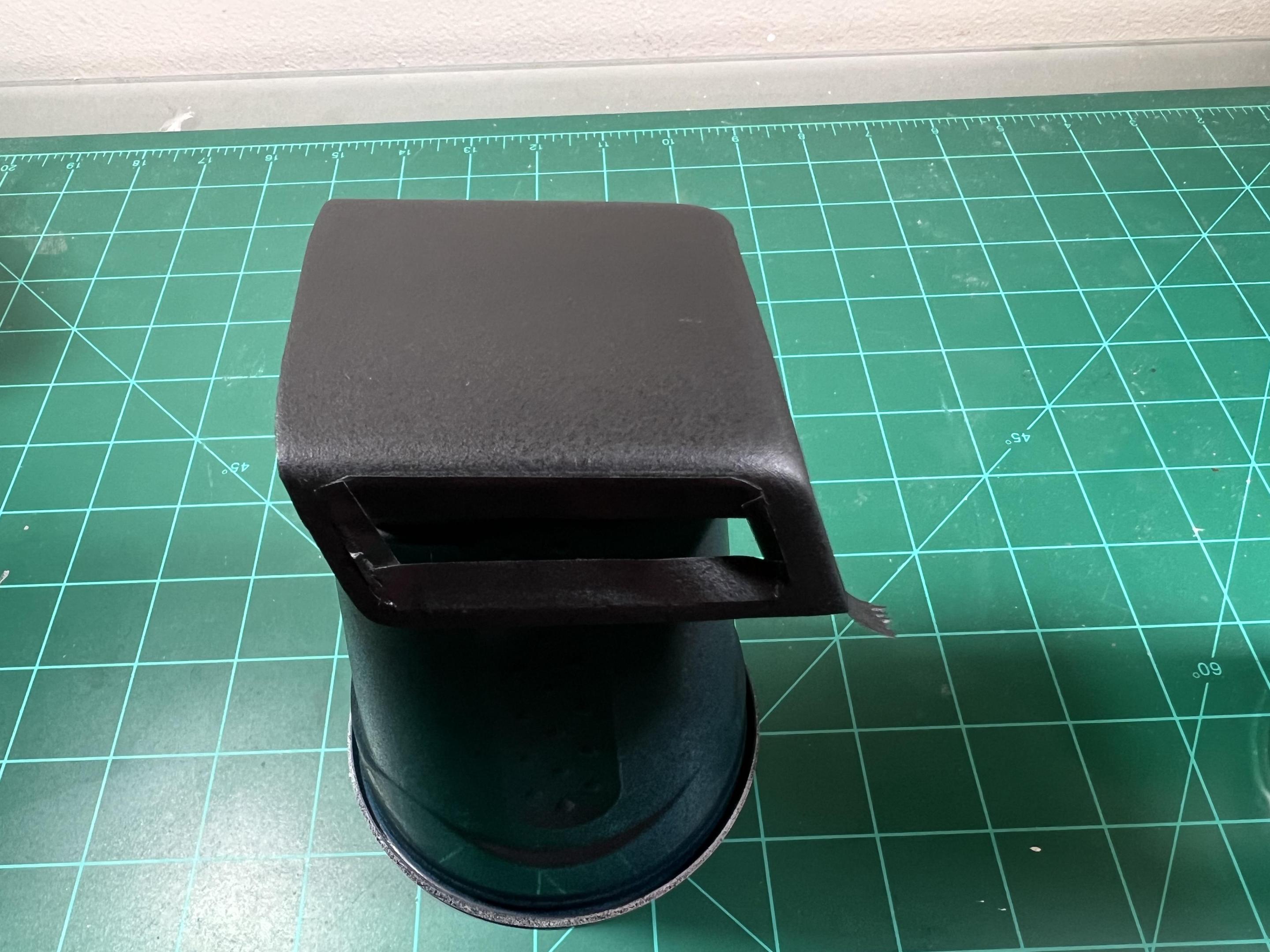

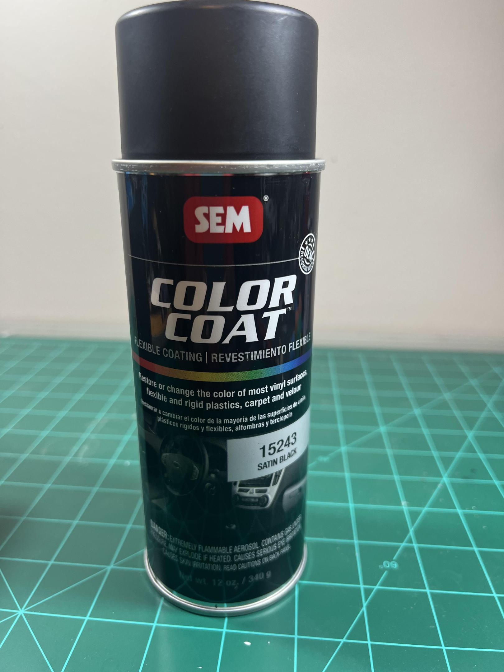

catpack68 Posted February 10, 2023 Author Posted February 10, 2023 (edited) I got the bronco primed again. I also got the top painted using the same method Yellowsportwagon did on a 66 GTO Restomod he built to do a vinyl top. it definitely gave me the look I was going for.Thanks Tim!? Here’s a link to the build Tim did explaining the process he did? Edited February 10, 2023 by catpack68 3
Tcoat Posted February 10, 2023 Posted February 10, 2023 27 minutes ago, catpack68 said: I got the bronco primed again. I also got the top painted using the same method Yellowsportwagon did on a 66 GTO Restomod he built to do a vinyl top. it definitely gave me the look I was going for.Thanks Tim!? Here’s a link to the build Tim did explaining the process he did? Did you use the exact same paint as he did? I can't get that paint here and tried three other types but could not get even close to his results so went back to stippling liquid cement. Your results look perfect!
catpack68 Posted February 10, 2023 Author Posted February 10, 2023 (edited) 7 hours ago, Tcoat said: Did you use the exact same paint as he did? I can't get that paint here and tried three other types but could not get even close to his results so went back to stippling liquid cement. Your results look perfect! Thanks! I used the exact same paint and method he did. I found the paint on Amazon when I couldn’t find it around here locally. It’s definitely going to come in handy? Edited February 11, 2023 by catpack68
catpack68 Posted February 14, 2023 Author Posted February 14, 2023 I got the bronco painted again. I should have it cleared by the end of the week. 1
