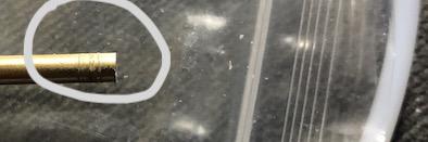

Bill Eh? Posted January 27, 2023 Posted January 27, 2023 I have tried to cut a 2.5 mm slice off a 1/8" K & S brass tube. I have tried using my K & S tube cutter with no success. A friend suggested using an X-acto knife by rolling on a hard surface. In both cases the blade wandered. I have attached a pic to show what happened. So those who are familiar with and work with brass, how would you go about ding this? Any advice would be appreciated.

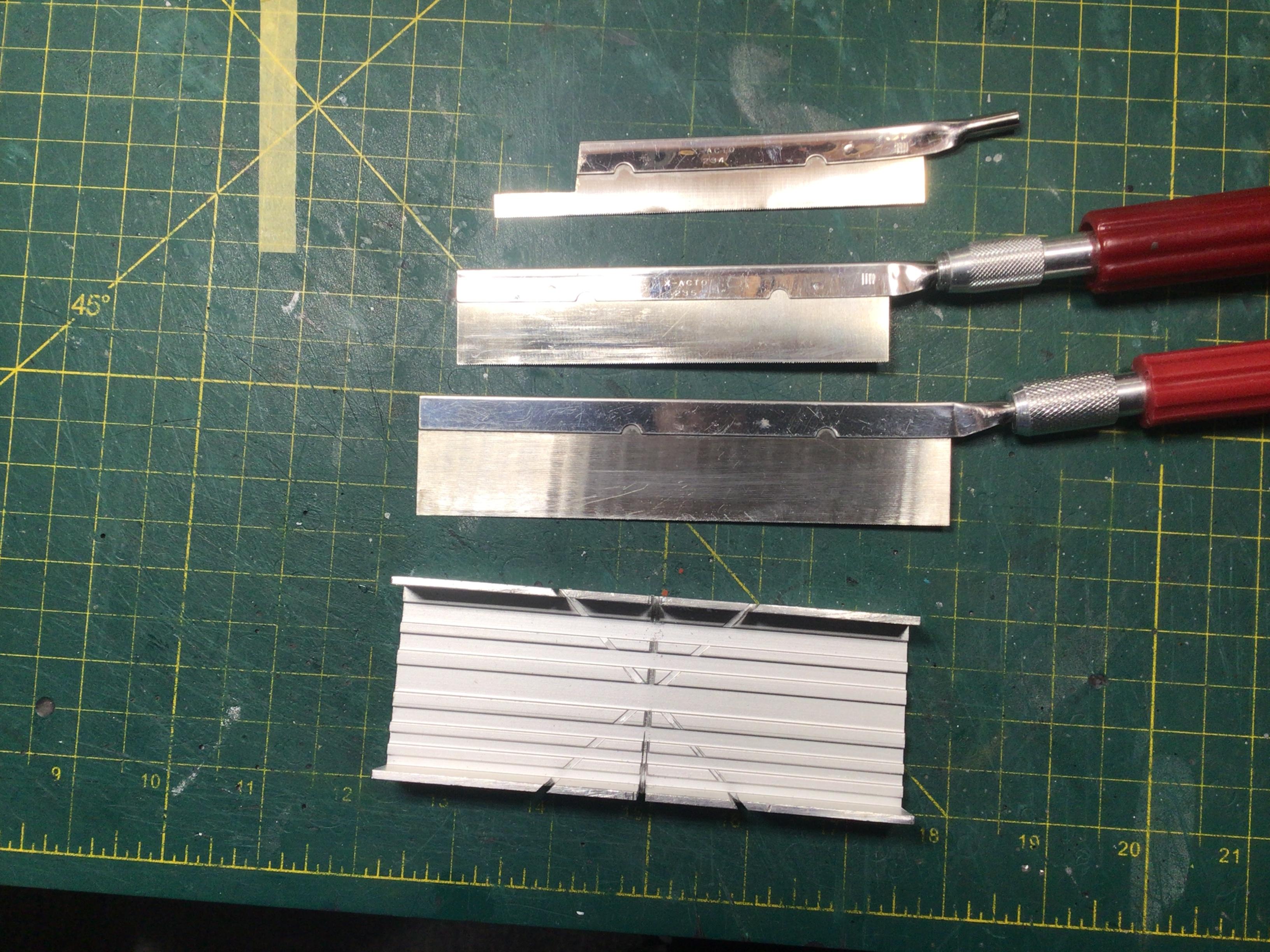

Bill Eh? Posted January 28, 2023 Author Posted January 28, 2023 8 minutes ago, yh70 said: a very fine saw and miter box is what i use..but also you can heat the brass with a lighter and it will soften the metal like if u cutting large solid rods..a trick the aircraft - armor builders use.. works great on bending Brass also.. Thanks Dave. No matter which method I choose to cut the tube, I will definitely use a lighter to heat the tube before and during the cut. 7 minutes ago, NOBLNG said: I use both rolling the tube under a sharp hobby knife and the razor saw and mitre box. Greg, although I have a few razor saws, I have been using the saw and miter box box from UMM. I think it is time to invest in a larger miter box, like the one you have. LOL
