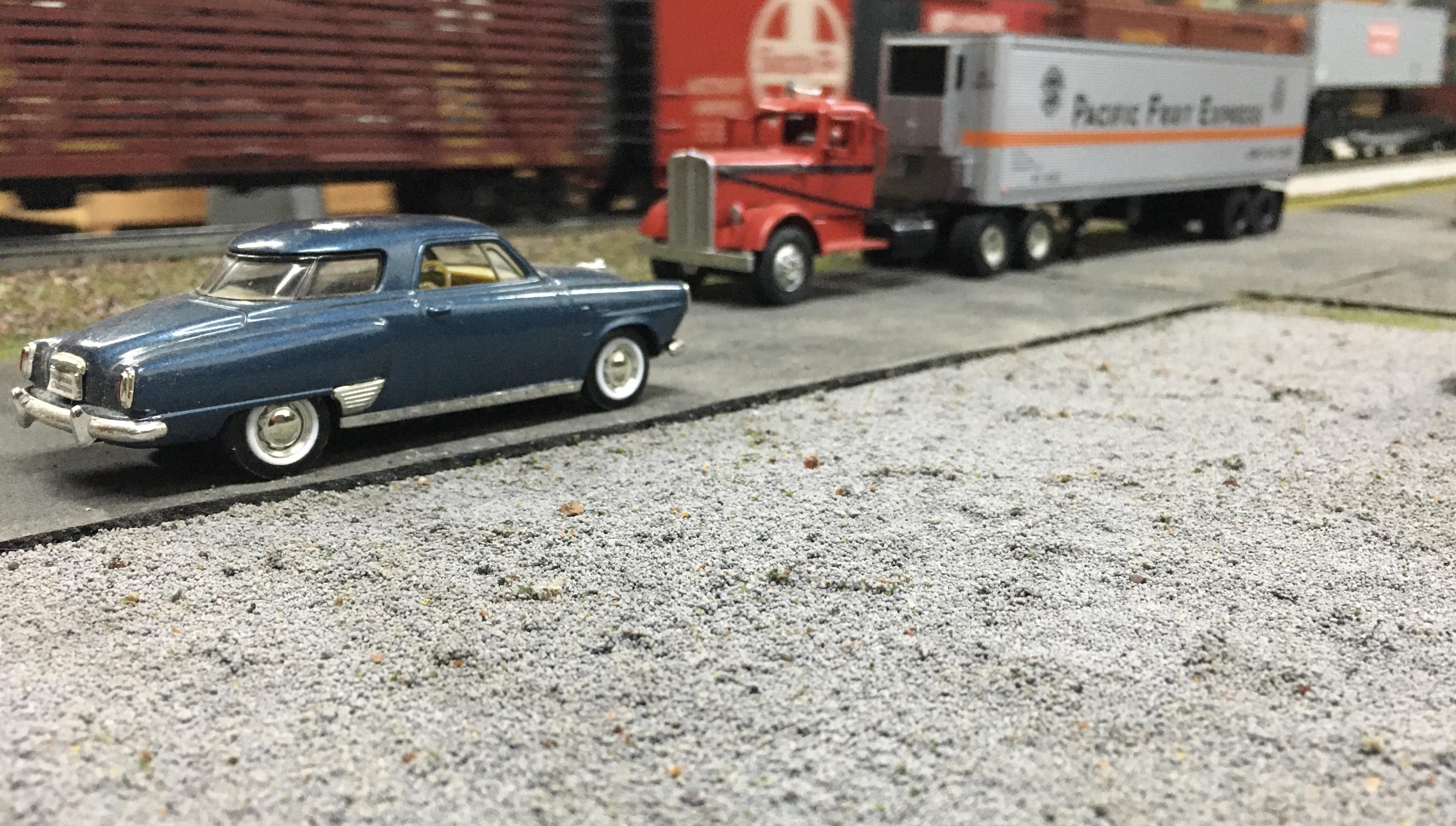

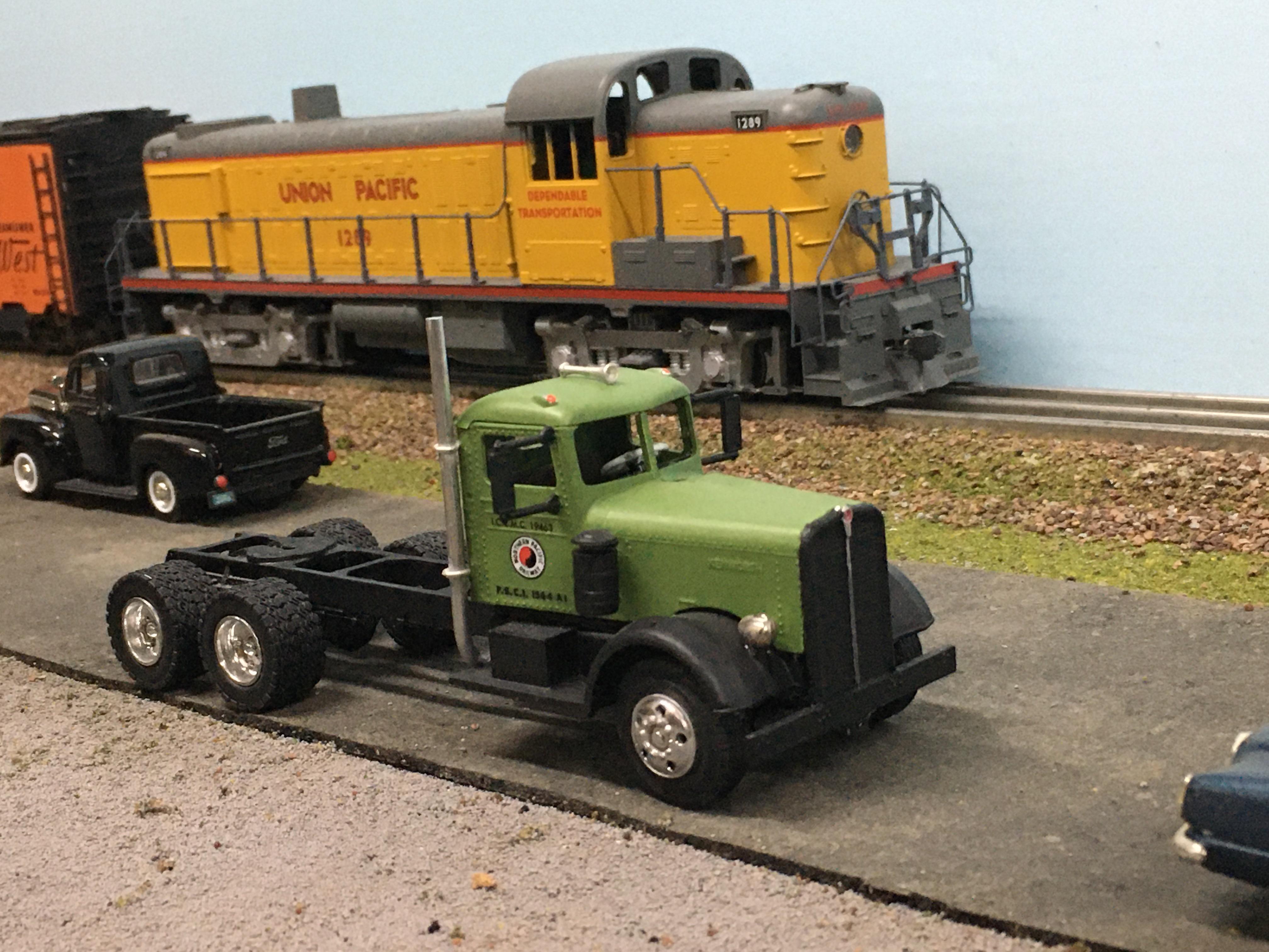

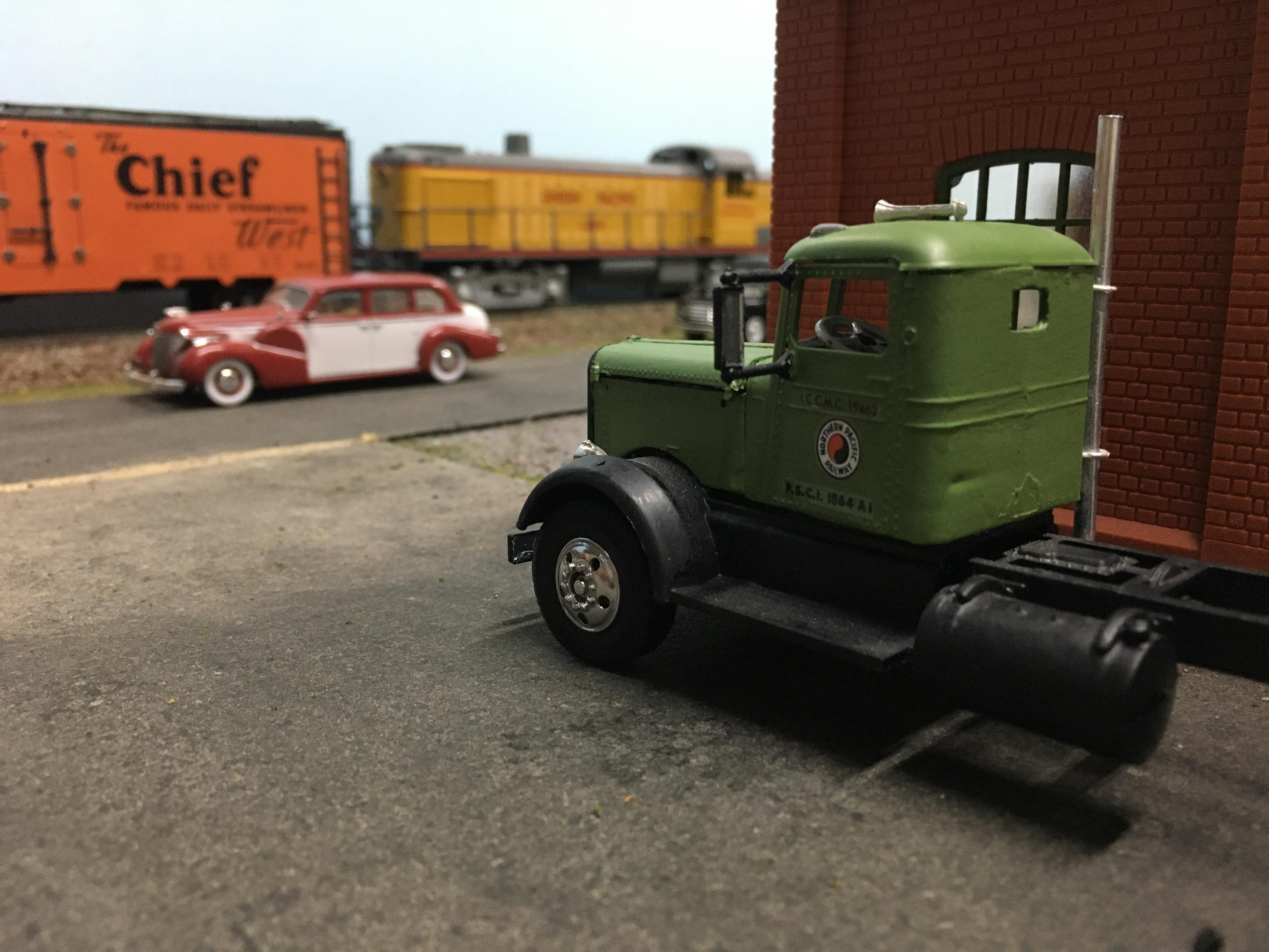

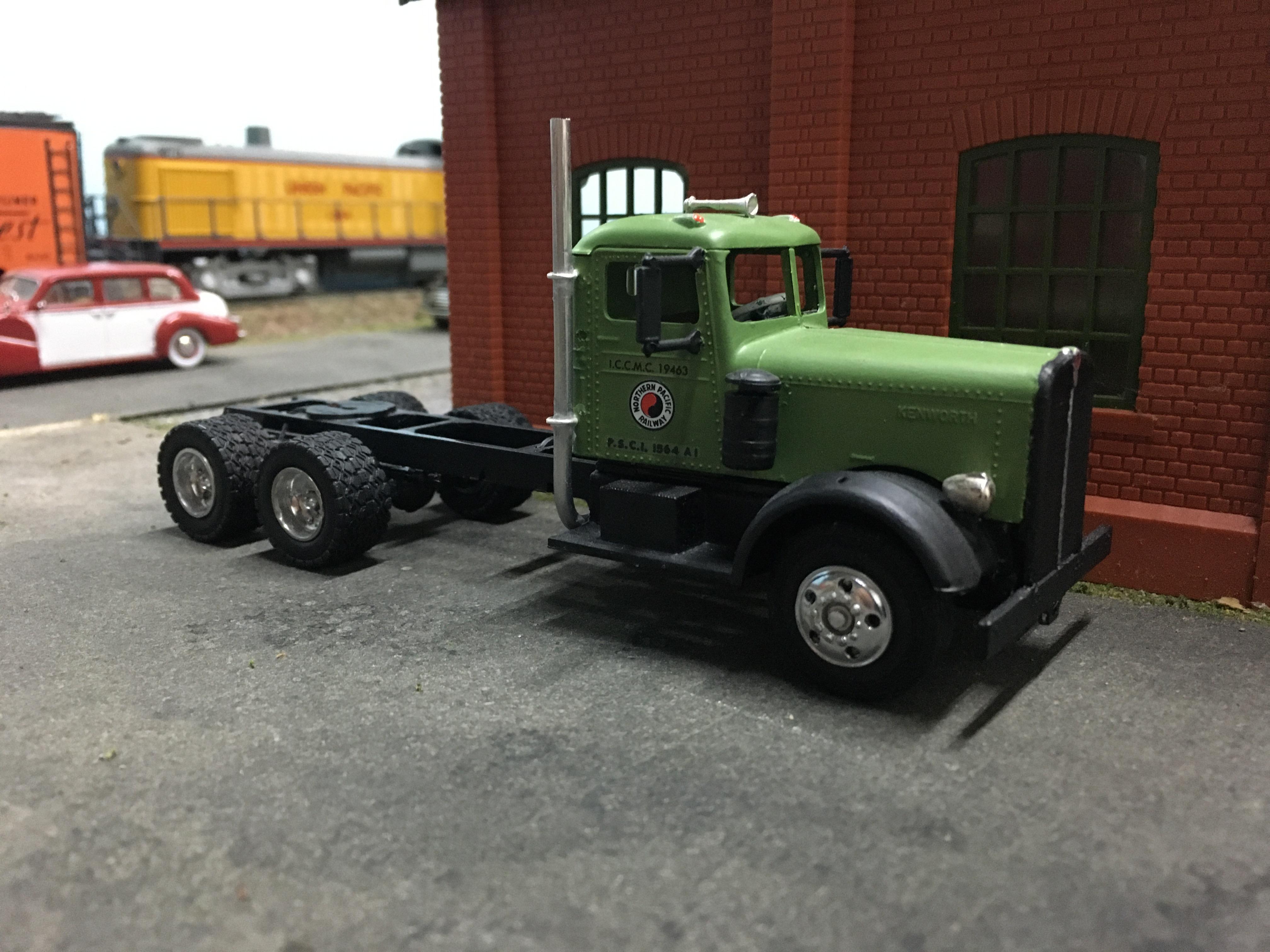

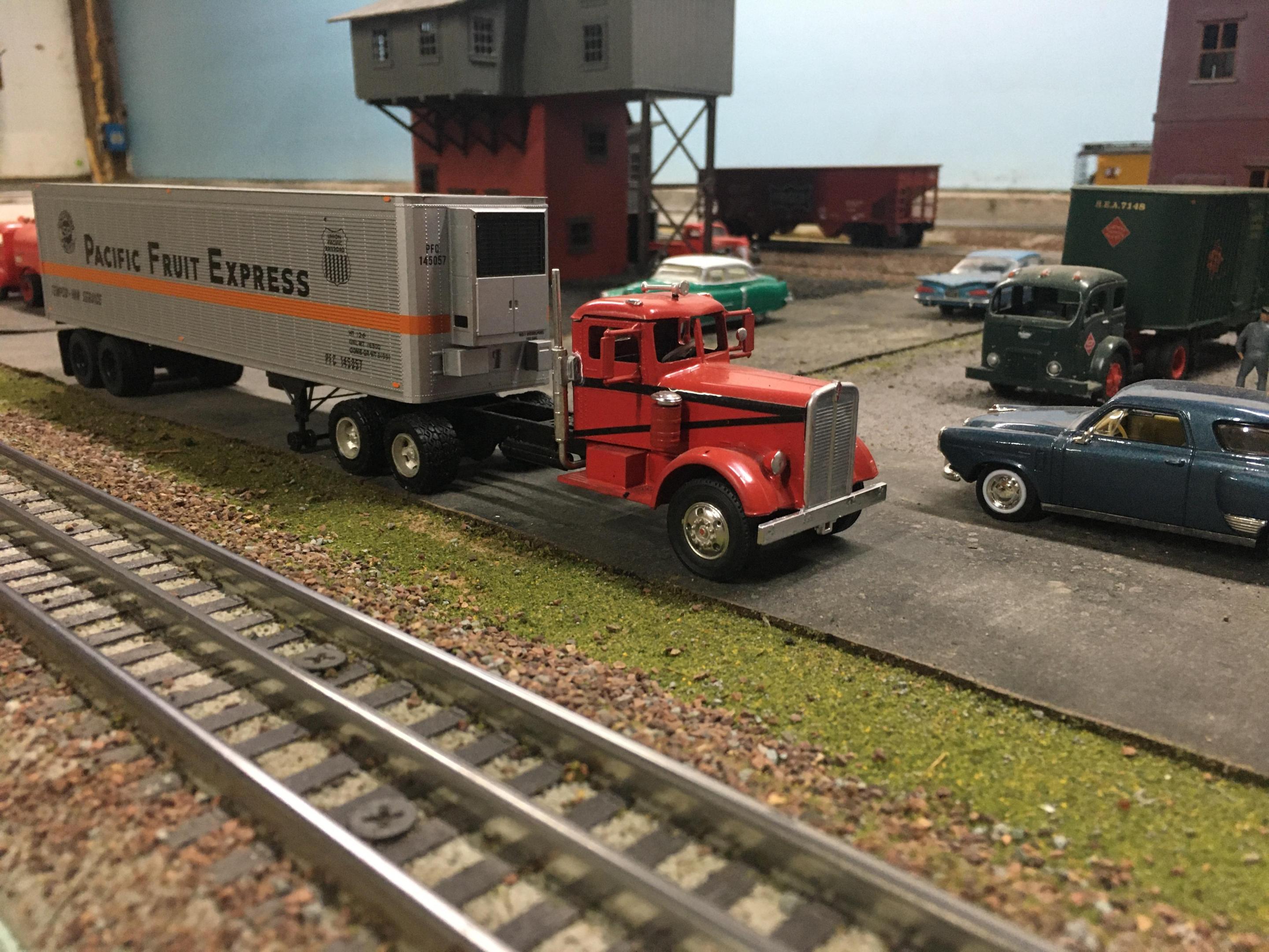

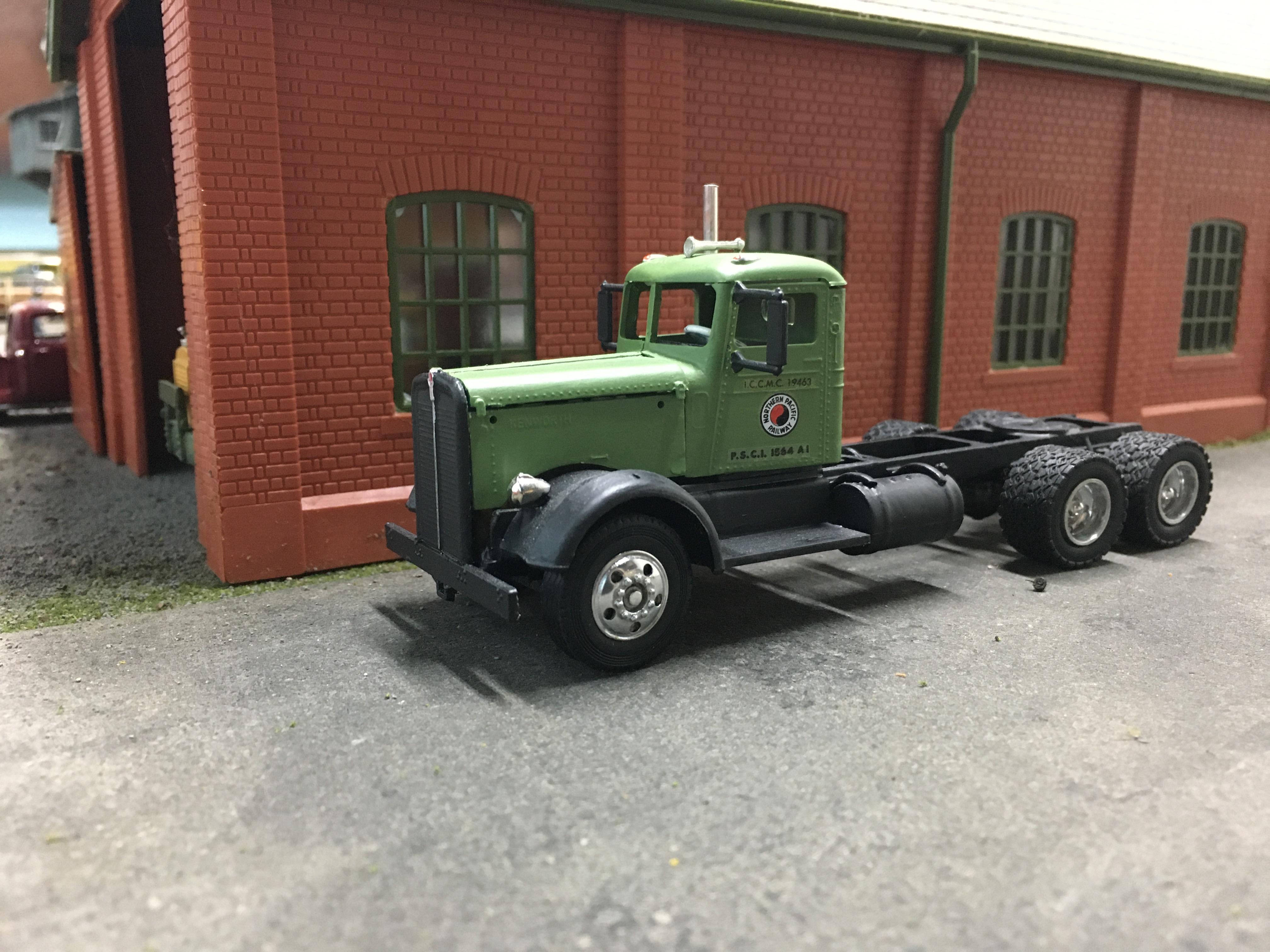

Dennis the Revell KW will work fine if you plan on putting the Stinger on you will have to modified the back of it. I have a couple of these kits and I’ve talked to Don for years. The Revell KW frame can be used on any of Dons Cabs if he still sells them. I’ve also used Dons wheels and tires on all my Revell KWs that’s on my O scale layout here’s a couple pics for you to look at as a guide of what they will look like with his parts and wheels and tires.

Thank you for confirming the use of the Revell kit and the wonderful photos.  Today I did make contact with Don, who also said the same thing.  Whenever in the past I got log truck parts from Don, I was smart enough to also buy wheels and tires.  I really like your NP Monad.  And I see you model O Scale, 3-rail.  I have an armload of O scale 2-rail, but currently am not doing anything with it.  Your photos are a really great help and encouragement.  You did a nice job with them all.  Thank you again,  Dennis in E WA state
