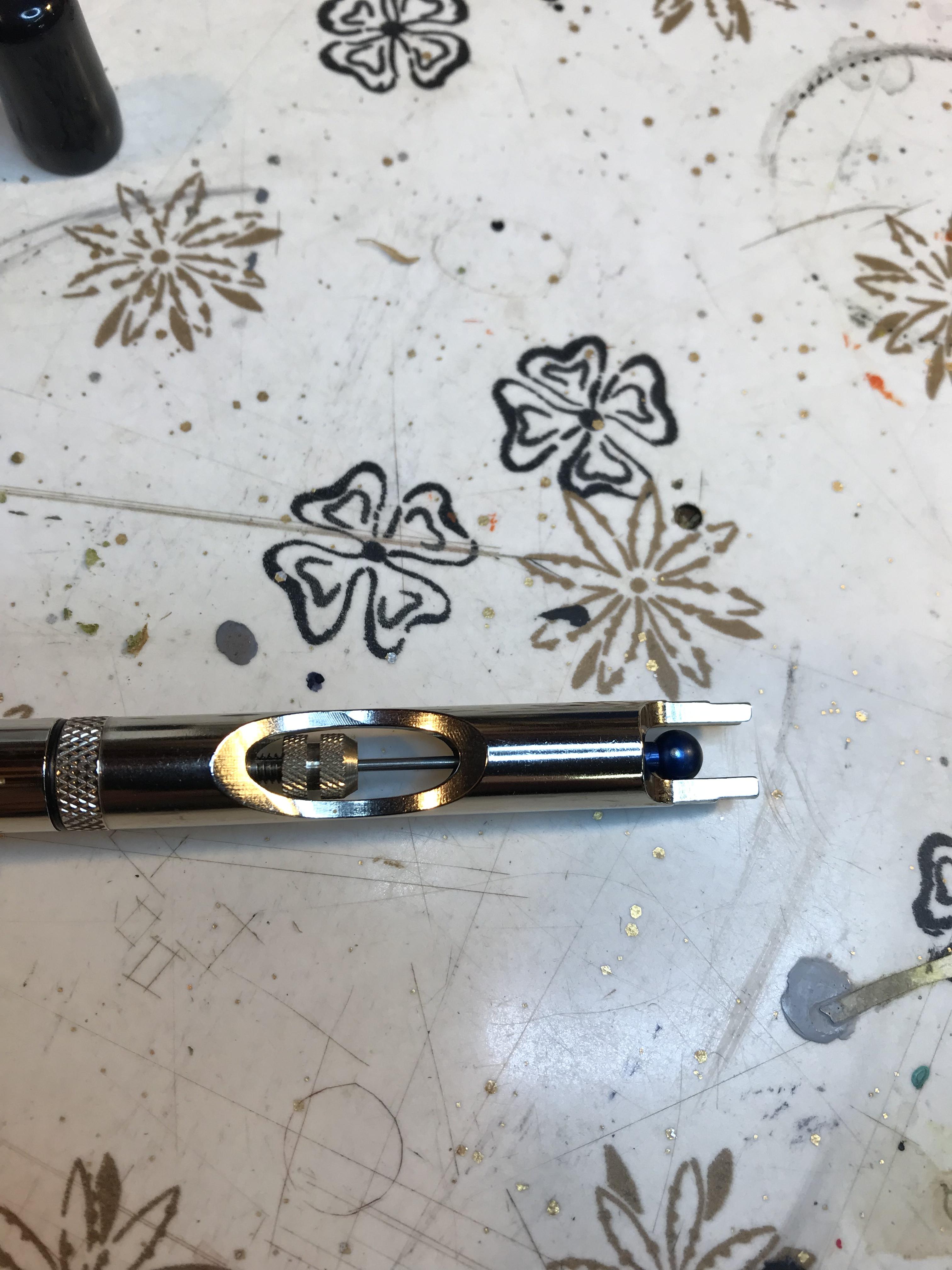

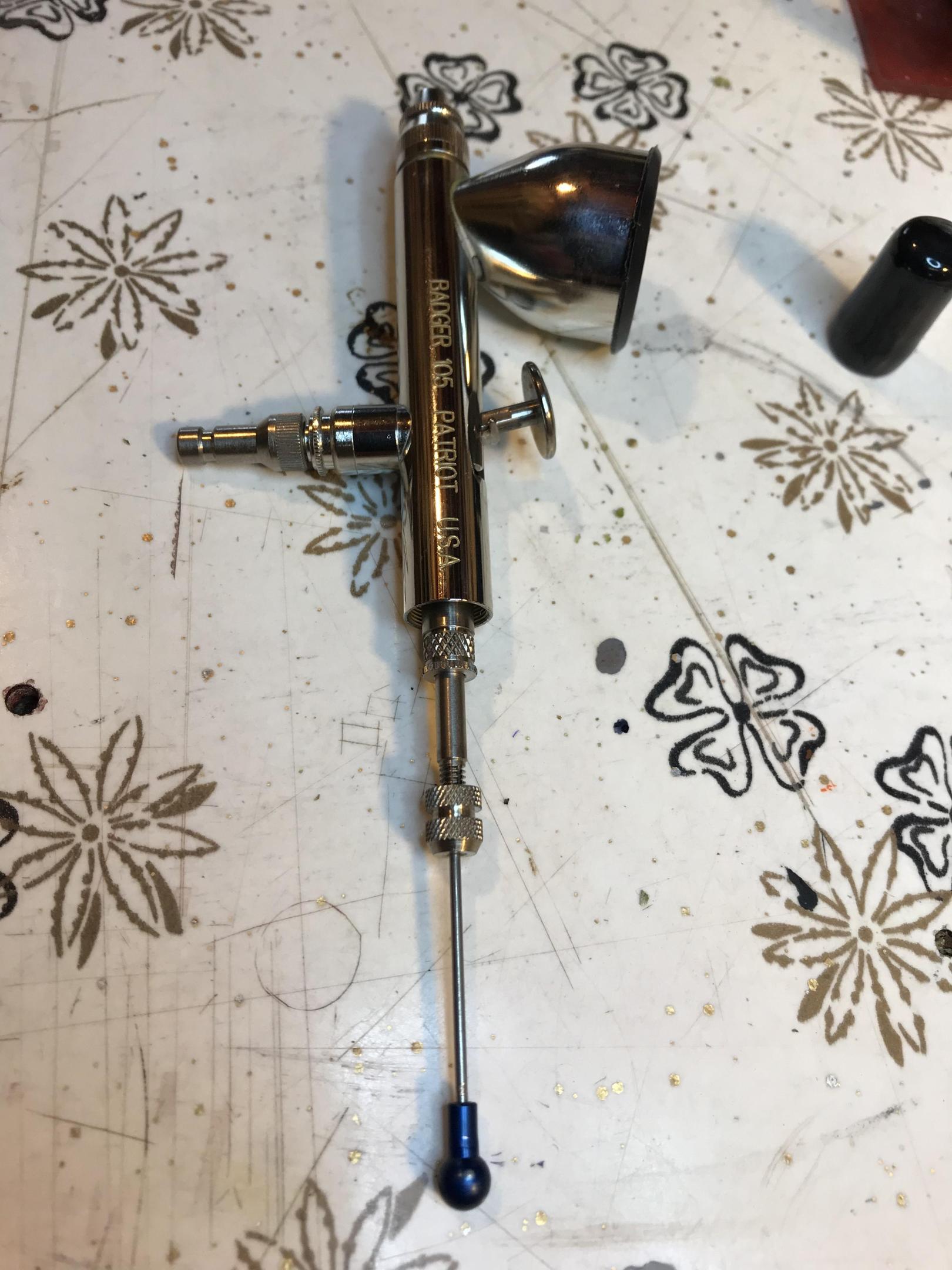

dragstk Posted February 4, 2023 Share Posted February 4, 2023 I am kinda new to the air brush situation. I started out with a $35.00 Master dual action. And have been getting better results. So about a year ago, I bought a Badger 105 Patriot. And for some reason Ive struggled to get the same results as I have with the Master. One day when I pulled it apart, I noticed that the needle (blue) had a slight bend in it about 1 1/2"down from the tip. Thinking that this might have been the problem, I got a new needle. Looks straight when I got it, now has the same warp. So I put my silver needle in. (See picture) what ever needle I put in, it always slightly rubs at the top of the body. Is this normal? Is it possible the body of the 105 is machined wrong or its bent? Or is this a case of the 2 air brushes I have are different enough, that I need to just learn more about the Badger? Any help would be appreciated. Thanks Quote Link to comment Share on other sites More sharing options...
Jon Haigwood Posted February 4, 2023 Share Posted February 4, 2023 4 minutes ago, dragstk said: I am kinda new to the air brush situation. I started out with a $35.00 Master dual action. And have been getting better results. So about a year ago, I bought a Badger 105 Patriot. And for some reason Ive struggled to get the same results as I have with the Master. One day when I pulled it apart, I noticed that the needle (blue) had a slight bend in it about 1 1/2"down from the tip. Thinking that this might have been the problem, I got a new needle. Looks straight when I got it, now has the same warp. So I put my silver needle in. (See picture) what ever needle I put in, it always slightly rubs at the top of the body. Is this normal? Is it possible the body of the 105 is machined wrong or its bent? Or is this a case of the 2 air brushes I have are different enough, that I need to just learn more about the Badger? Any help would be appreciated. Thanks I would contact Badger for answers, If the airbrush is defective they may fix it or replace it Quote Link to comment Share on other sites More sharing options...

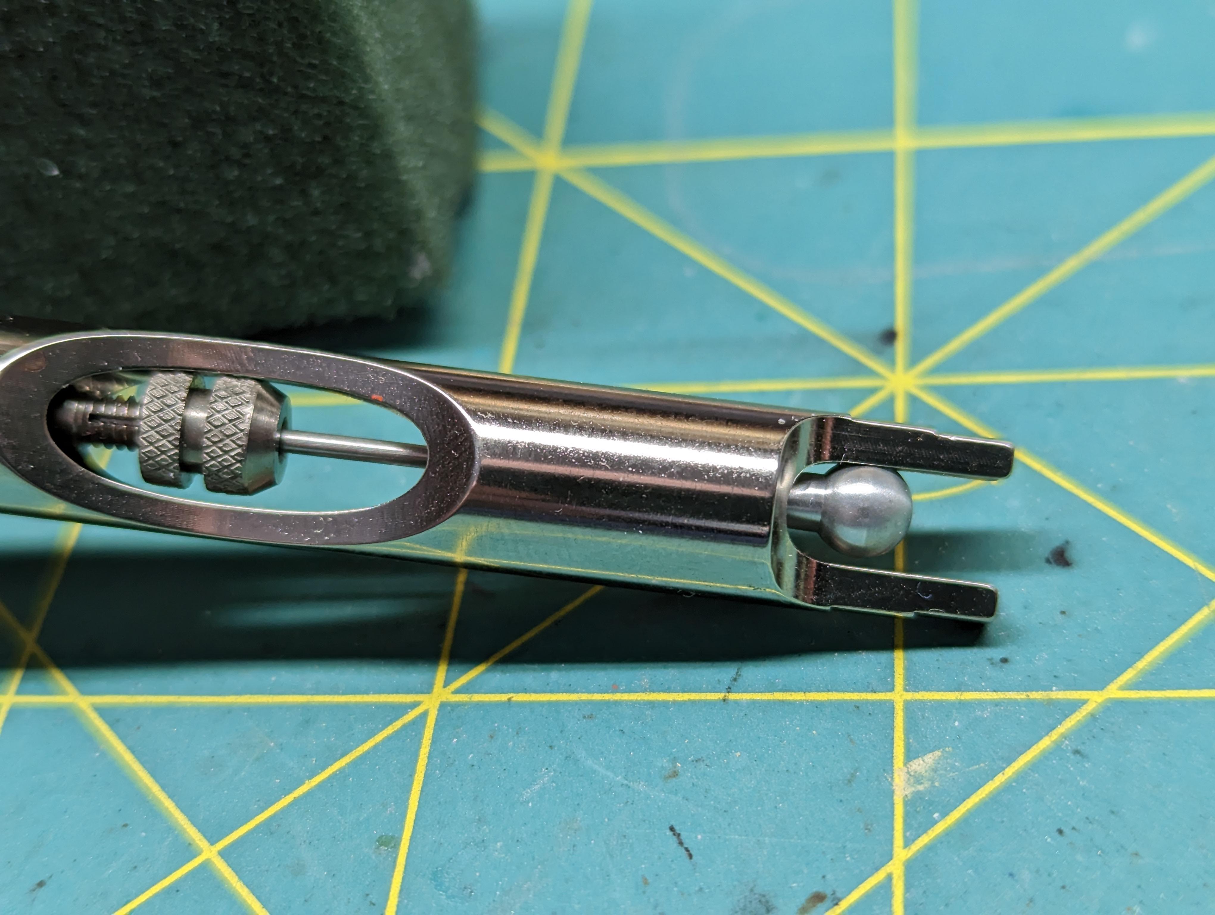

Bainford Posted February 4, 2023 Share Posted February 4, 2023 Not normal at all. Something very wrong there. Something is bent or out of alignment, or assembled wrong. A bend 1.5” back from the tip would put it at the needle bushing. Looking at the photo, something is definitely out of whack. The back of the body itself could be bent and holding the needle off centre, but it looks deeper than that. On mine, the needle is biased to the bottom, but not by any force. Reaching through the window, the needle wiggles up and down effortlessly. Remove the back of the body and check the concentricity of the needle holder assembly to the housing. Everything should be centred. Look deeper for bent parts, especially in the needle holder/trigger area. The head is pretty robust on these, but worth checking for straightness there too. The airbrush may have been dropped at some point, even before you got it. Quote Link to comment Share on other sites More sharing options...
dragstk Posted February 4, 2023 Author Share Posted February 4, 2023 (edited) Thanks for the replies guys. @ Jon-Do you think Badger would do anything? I dont have the receipt, even forgot where I bought it. It would be nice if they did something, but I feel it comes down to their word against mine, as to who is responcible @Trevor-I took the back of the body off. There is no play at all when I try to wiggle the holder, right at the body. And it certainly looks like it is centered. It operate very smoothly. It takes more effort to center the needle in the back, than I want to put on it. Any tips on checking straightness of the body? Edited February 4, 2023 by dragstk Quote Link to comment Share on other sites More sharing options...
dragstk Posted February 4, 2023 Author Share Posted February 4, 2023 Jon-you were on to something. I googled around and found a couple of sites that says that Badger has a lifetime replacement on the needle bearing. So, Ive contacted Badger to see what they think Thanks for pointing me in the right direction 1 Quote Link to comment Share on other sites More sharing options...

Bainford Posted February 5, 2023 Share Posted February 5, 2023 5 hours ago, dragstk said: @Trevor-I took the back of the body off. There is no play at all when I try to wiggle the holder, right at the body. And it certainly looks like it is centered. It operate very smoothly. It takes more effort to center the needle in the back, than I want to put on it. Any tips on checking straightness of the body? Nothing specific, just a good visual inspection, sighting along the assembled airbrush and checking concentricity of parts. Looking at your photo it appears as though the needle collet is jammed against the body, too. Might just be the photo angle though. Either way, your decision to contact Badger is the right one. As others have said, they are very good to deal with. Curious to know what the problem is, when you get it sorted. Quote Link to comment Share on other sites More sharing options...

dragstk Posted March 6, 2023 Author Share Posted March 6, 2023 So I just got my air brush back from Badger today. It was gone a month. I mailed it out 2/6. They received it 2/10. The $21.00 bench fee/shipping check cleared the bank on 2/14. Then radio silence I called them on 2/27. I was told they would start repairing it that week and they would give me a call on 3/3, to settle up if there was any costs. No call on 3/3 or 3/4. On 3/4, I get an e mail from Badger saying that a shipping label was printed. I checked the tracking several times and it showed no movement. Yet, it arrived today. They said they cleaned and serviced it. They installed a new needle bearing and a new plunger. No cost to me. But it came back the warped needle I sent it with, no new needle. And the needle still sits like in my original picture. I havent used it yet, but I really dont know what to think about all this. 2 Quote Link to comment Share on other sites More sharing options...

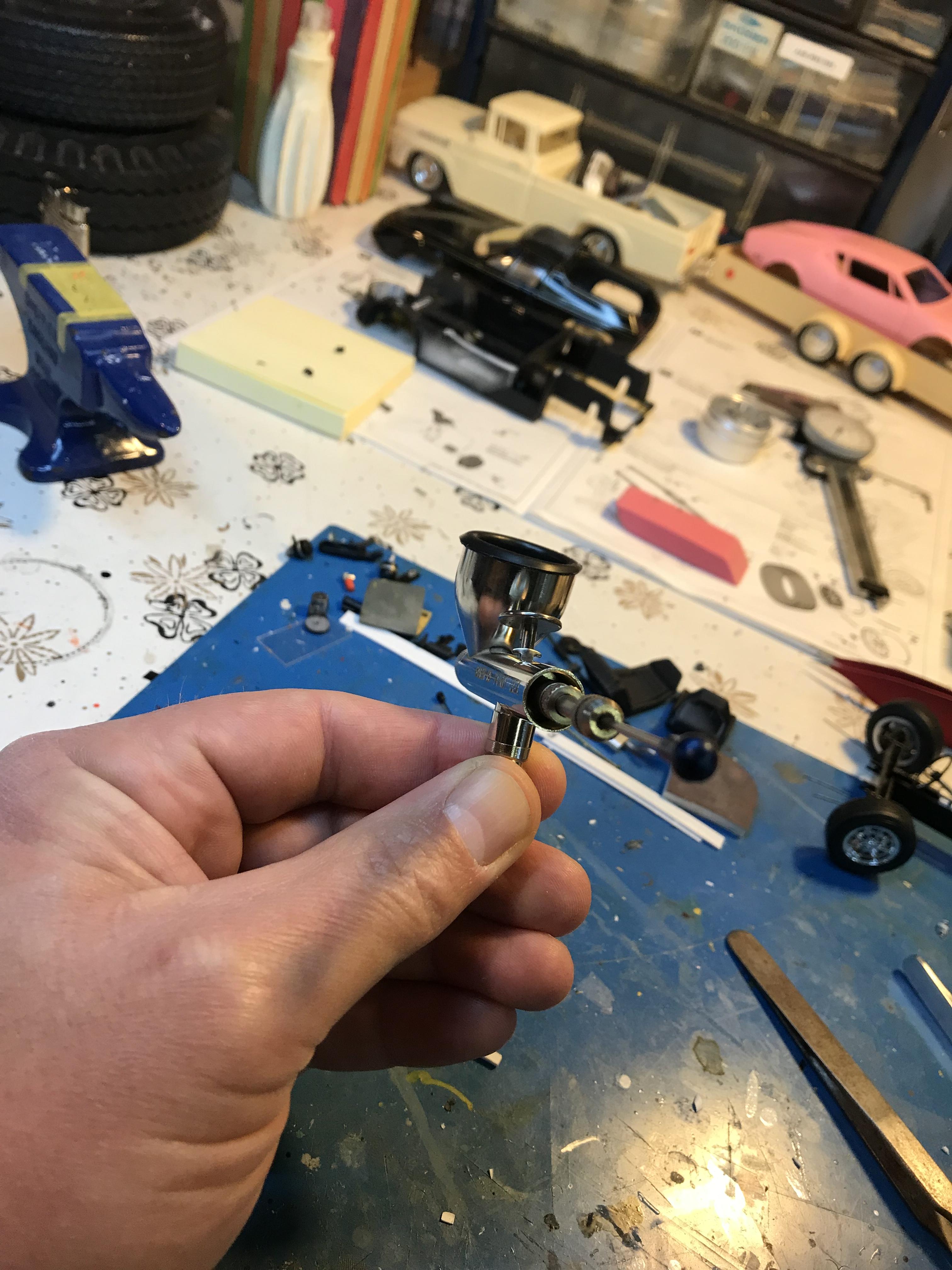

dragstk Posted March 15, 2023 Author Share Posted March 15, 2023 No, your question was not silly. If you dont know something, you have to ask. One thing I have noticed since I have gotten the air brush back, is there is a slight catch as I start to pull back for paint. I didnt notice this before but maybe Im noticing it now because Im focused on it. The catch was clearly coming from the trigger against the the curved piece behind the trigger. I lightly sanded each piece with 1500, the a drop of Badger lube. and it works really smoothly now I hope to have some spray time this week, to see if anything has changed Quote Link to comment Share on other sites More sharing options...
