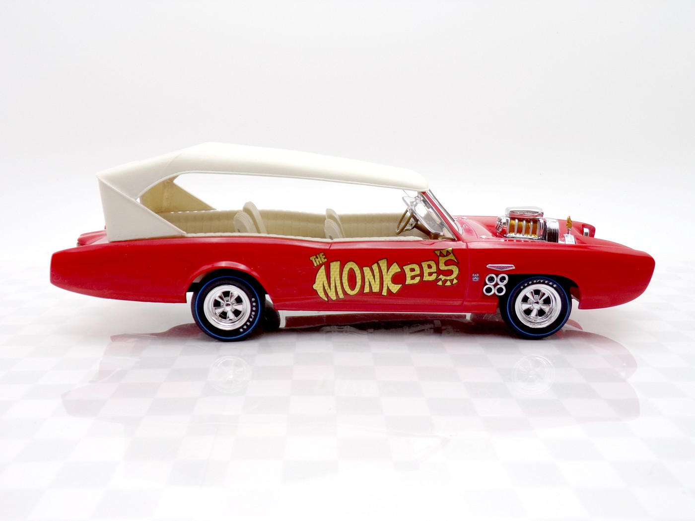

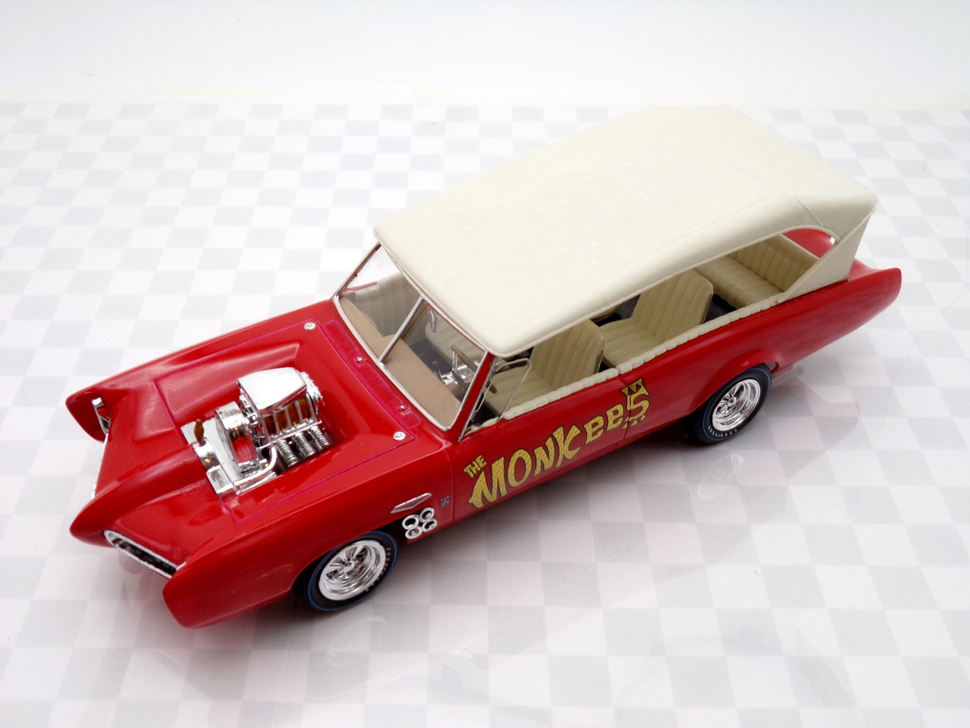

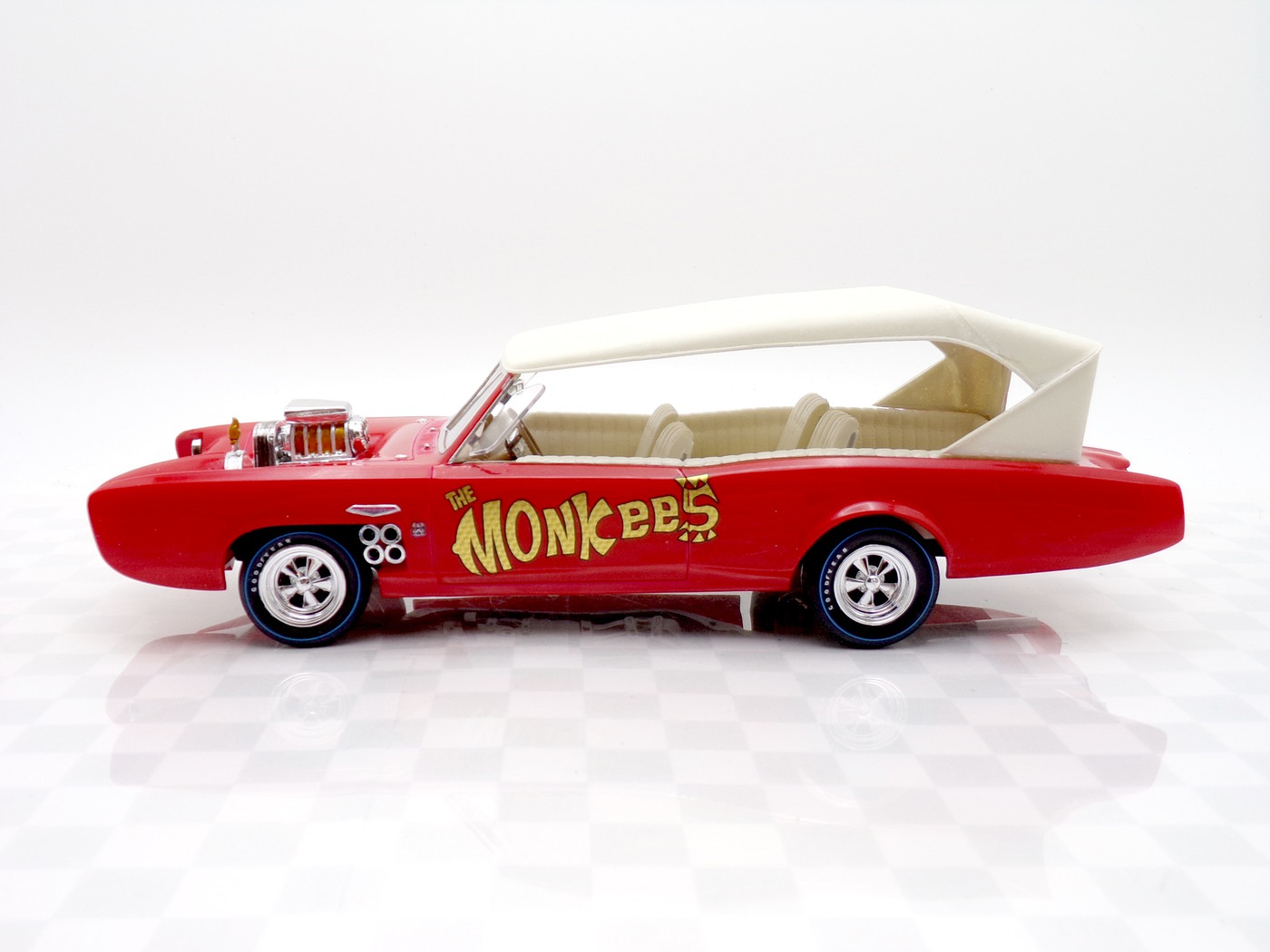

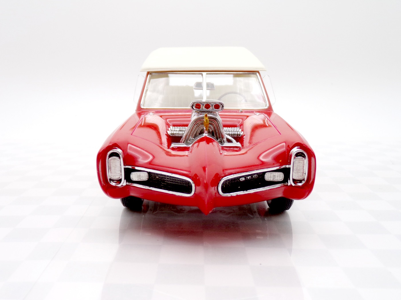

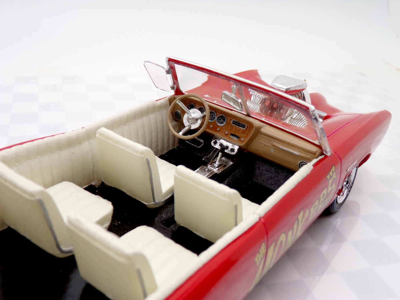

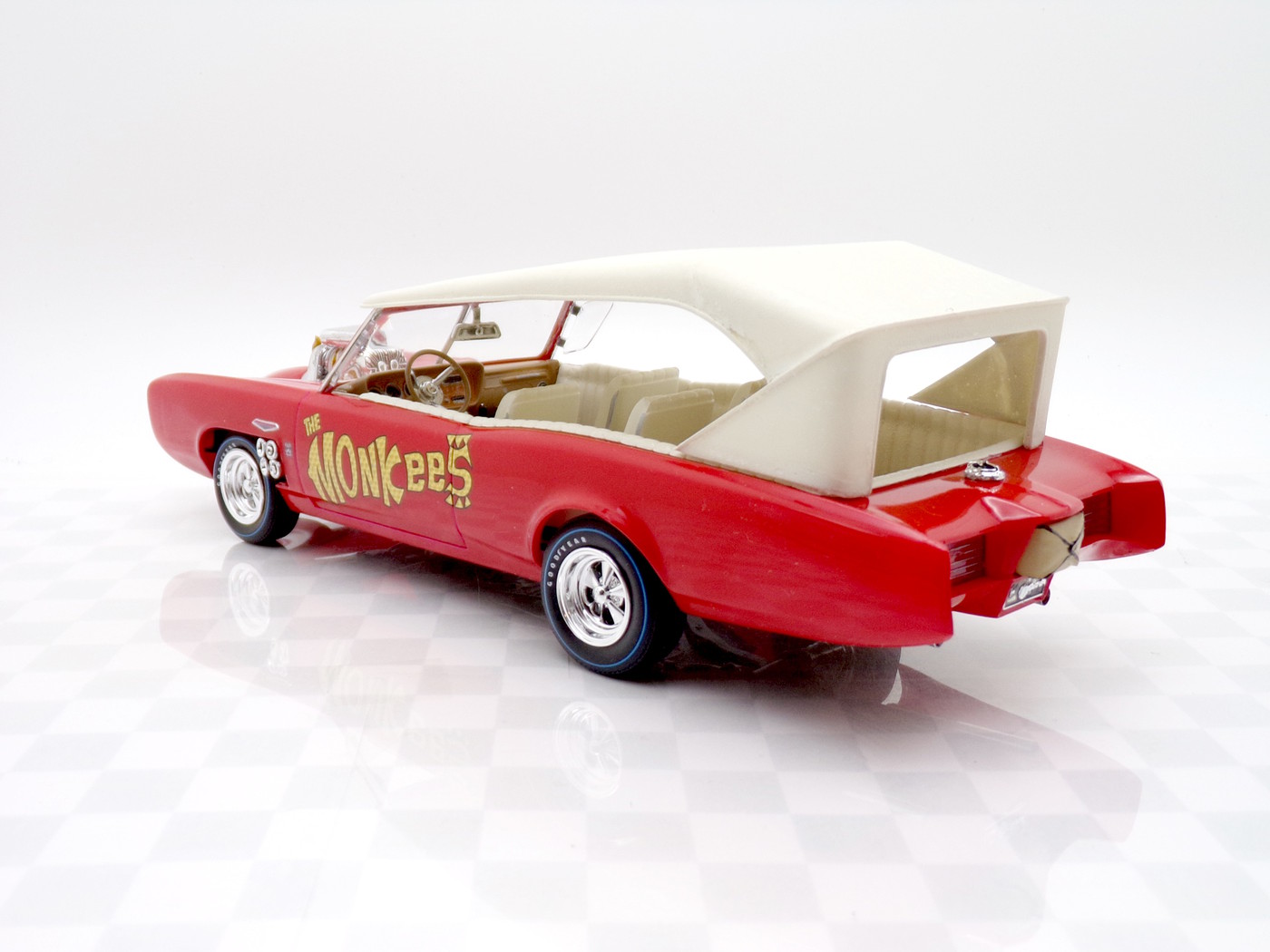

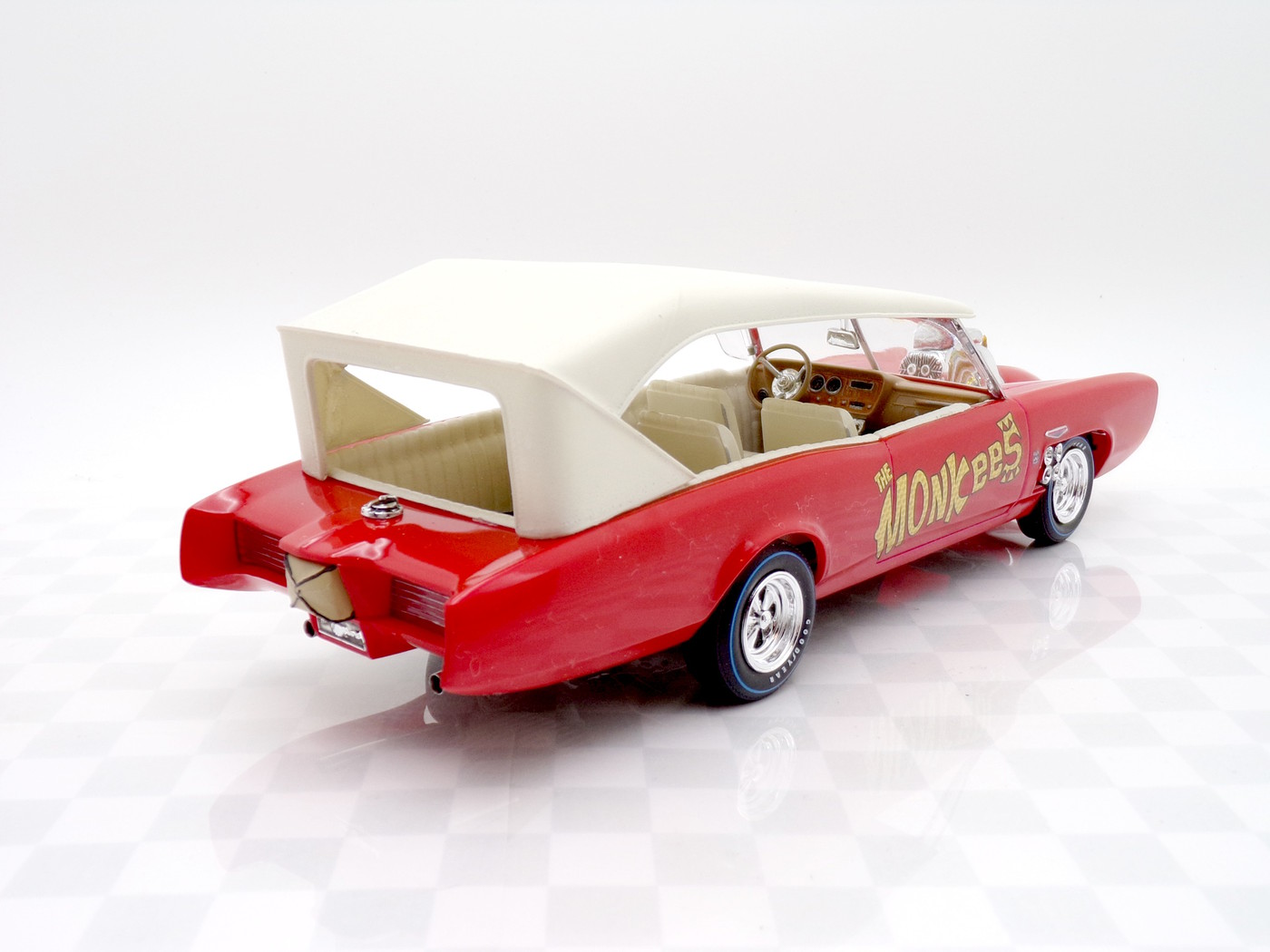

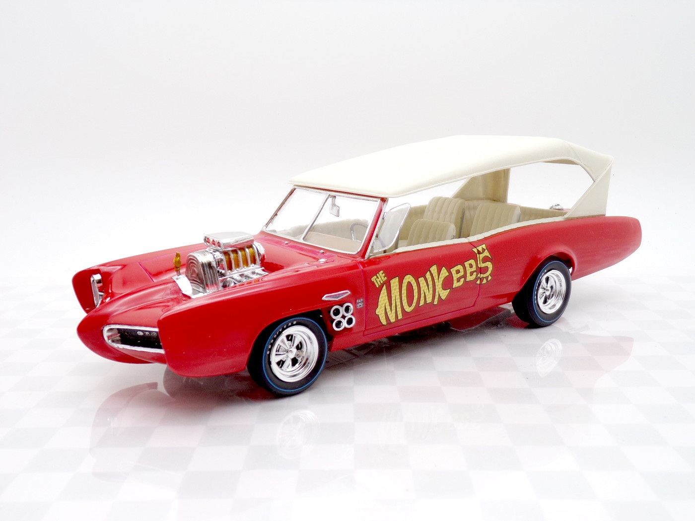

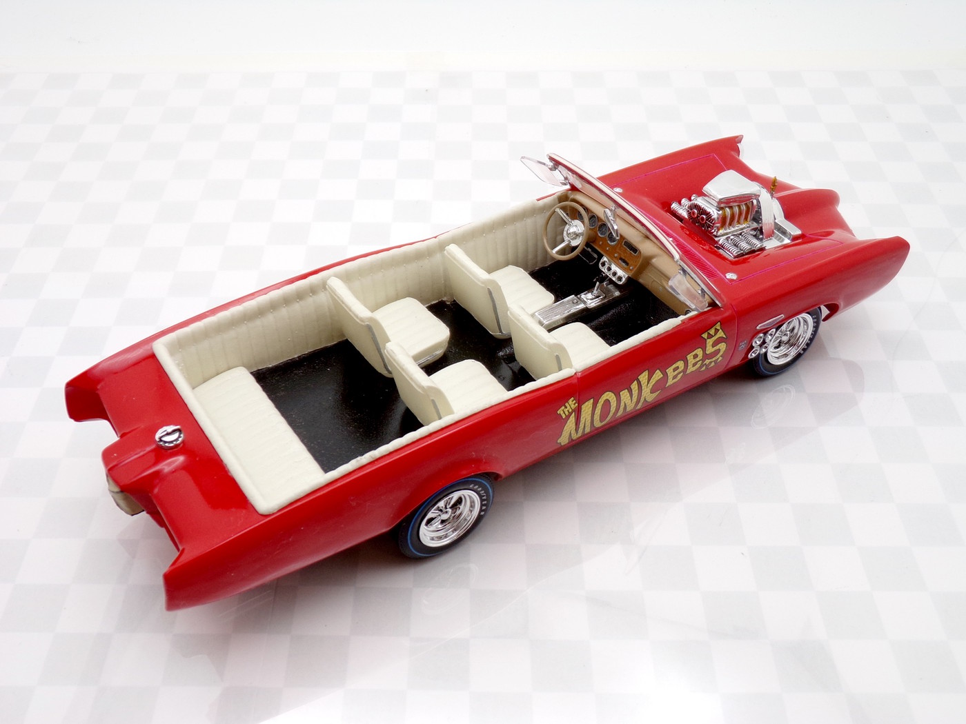

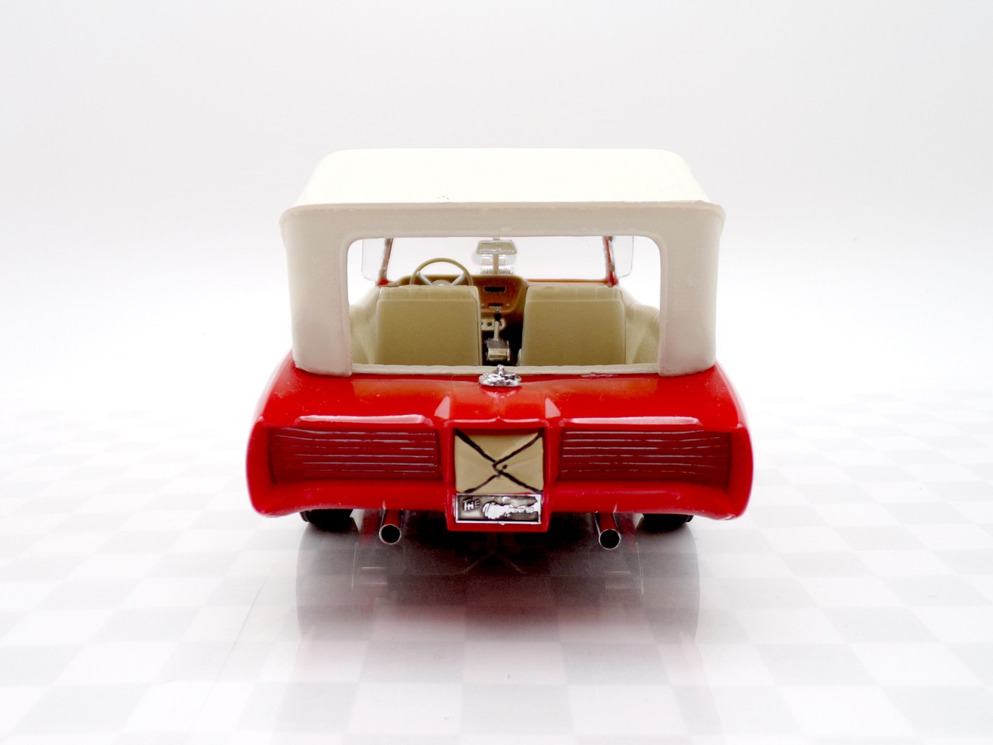

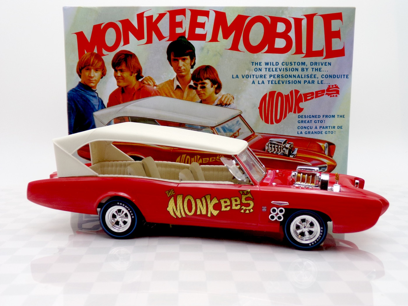

TooOld Posted February 8, 2023 Posted February 8, 2023 (edited) Even though I grew up in the 60's and watched the television show I've never had much interest in building this kit , but I like nice tires and when I saw the blue line Goodyears in this latest reissue I decided to give it a try . It's a very basic kit , typical of these types from the 60's . The only real issue I found was that out of the box the tires aren't centered in the body openings , so I spent the time to correct this by relocating the axles . At the same time I widened the front track 3/16" and narrowed the rear track the same 3/16" so the tires fill the openings correctly , or at least better than they did . So here's my Monkeemobile , built out of the box except for aftermarket decals and some polished aluminum tailpipes . I also added my own 6.5 Litre and Dean Jeffries badges , they're a bit larger than I planned but I still think they look okay . Paint is Tamiya TS-8 Italian Red and Krylon Ivory . Thanks for looking ! All comments welcome . Edited February 8, 2023 by TooOld 4 1
