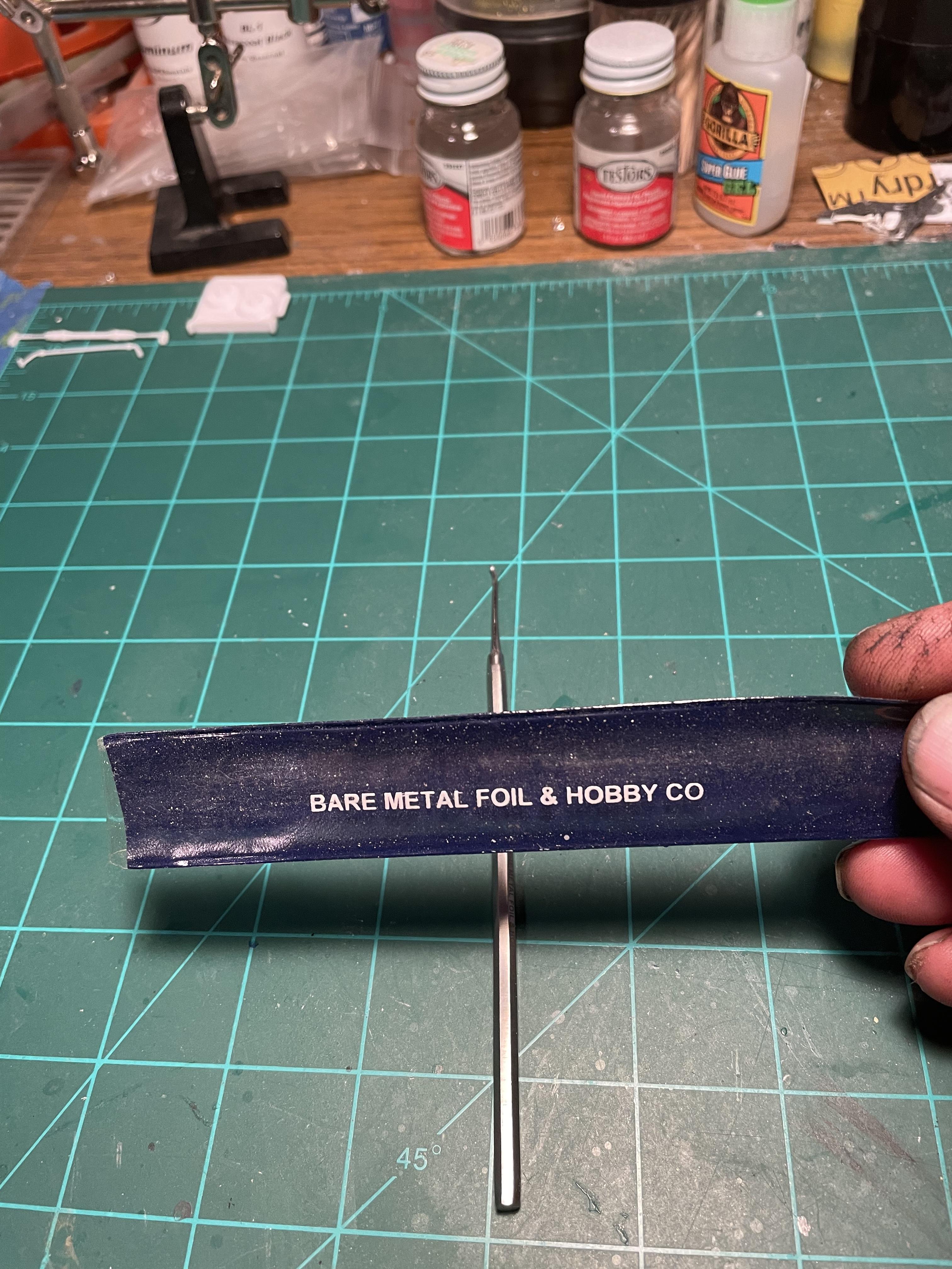

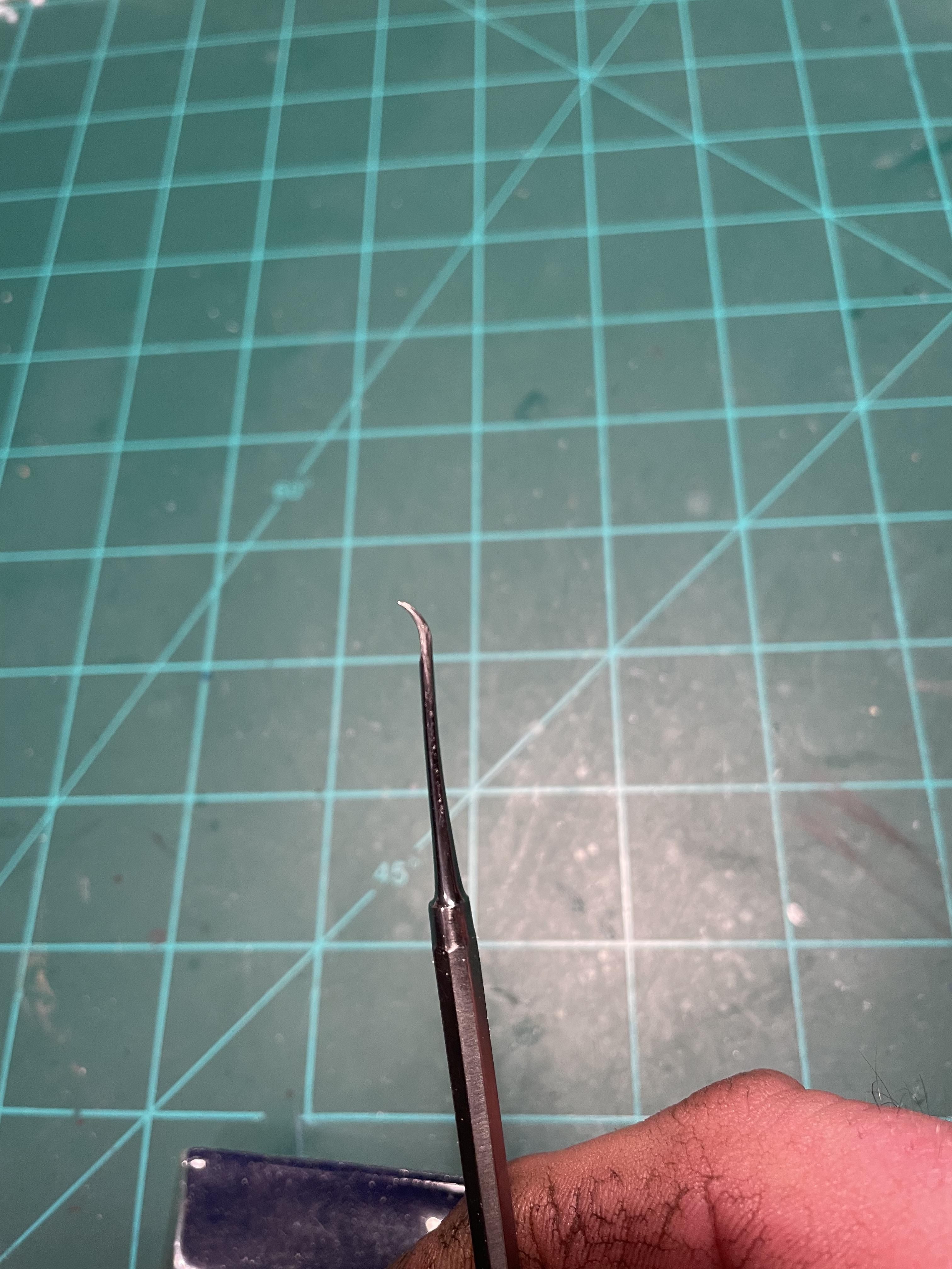

tbill Posted February 11, 2023 Posted February 11, 2023 I have this one, works well for me , hopefully the picture will be good enough.

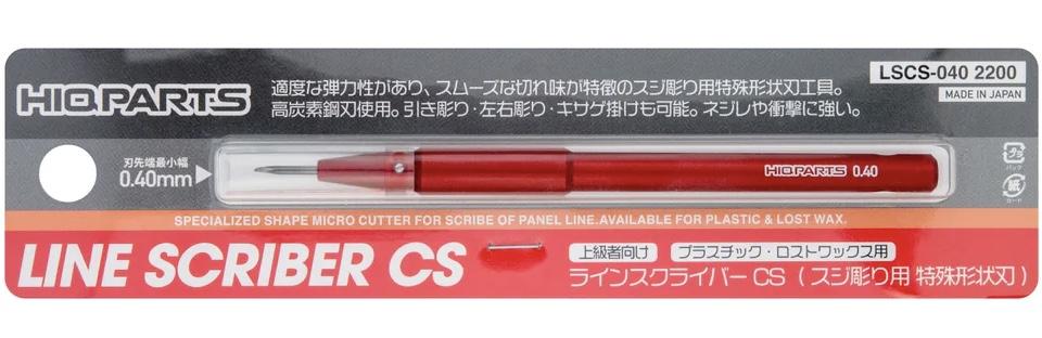

Dpate Posted February 11, 2023 Posted February 11, 2023 (edited) 57 minutes ago, Sidney Schwartz said: I bought the Tamiya scribing tool and don't care for it at all. It's a "chisel" type and I found it very difficult to get a decent line with it. A while back I had a scriber with a round tip and would like to get another like it. Can someone recommend one that they've used and like? Thanks. You bought the wrong tamiya tool, but there are tons of different scribing tools on the market. The one i use is by tamiya, but you'll pay about $25-$30 for it in the states. The one is the pic is a 0.2mm engraving tool for scribing. HiQparts has a few from 0.04mm and up as well. Edited February 11, 2023 by Dpate 1

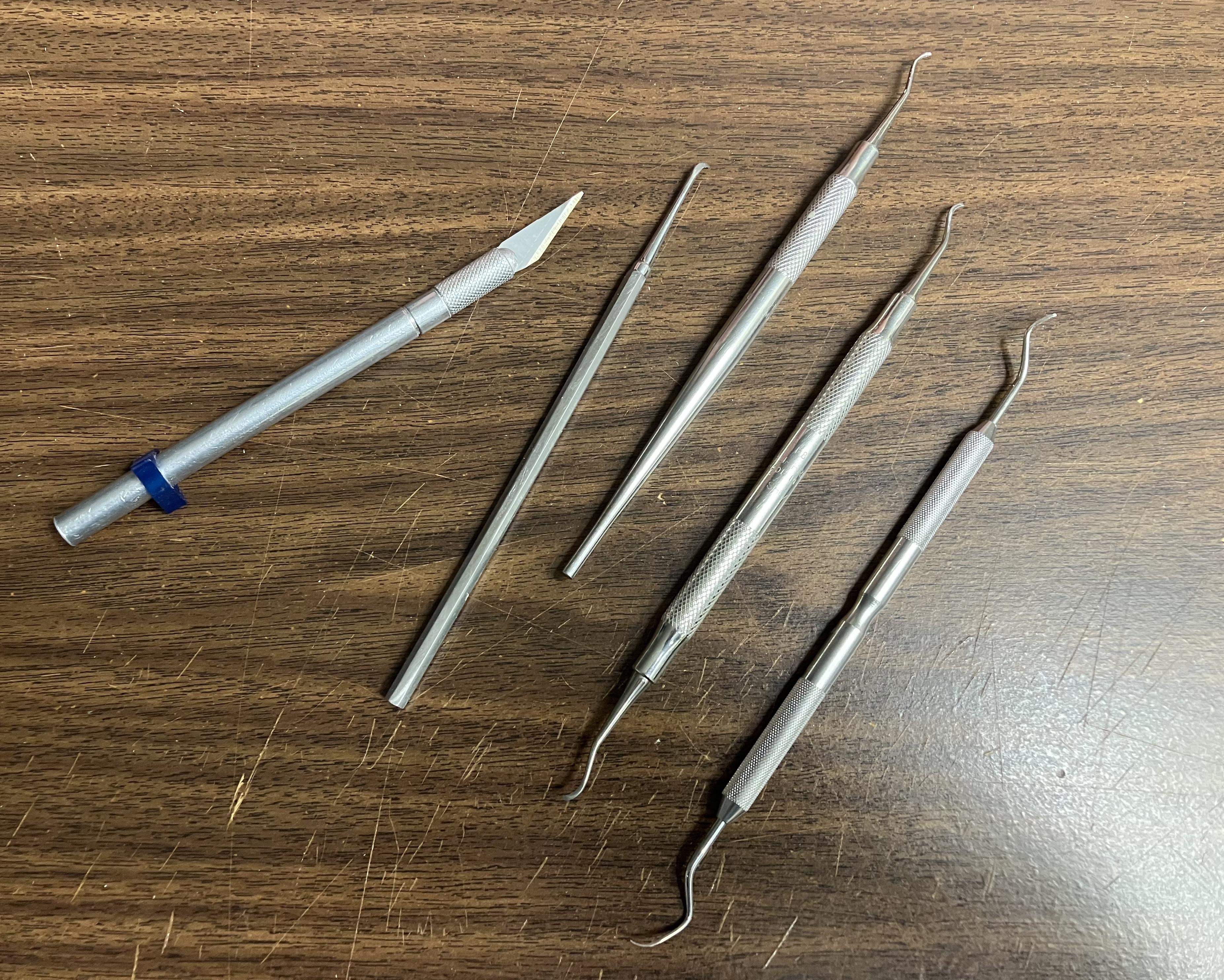

Joe Nunes Posted February 11, 2023 Posted February 11, 2023 (edited) I use one like that shown in tbill's post. I also use various dental cleaning tools that I obtained for free from my dentist. However, the best scribing tool for me is to use the back edge of a well worn #11 X-ACTO blade, preferably one that the point on the blade has either broken off or worn down. ? Joe Edit: added photos Edited February 11, 2023 by Joe Nunes

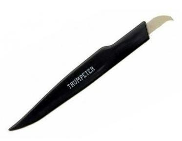

NOBLNG Posted February 11, 2023 Posted February 11, 2023 12 hours ago, Sidney Schwartz said: I bought the Tamiya scribing tool and don't care for it at all. It's a "chisel" type and I found it very difficult to get a decent line with it. A while back I had a scriber with a round tip and would like to get another like it. Can someone recommend one that they've used and like? Thanks. I just picked up one of those Tamiya scribers yesterday. I am going to return it though because I don’t think it’s much different than my cheap Trumpeter scriber. The more expensive ones like Dusty shows look good but very pricey.? I will trade the Tamiya one in for this one. It is still expensive, but like the better Tamiya, it will do a flat bottom groove. I have also used the butt end of a #80 drill bit in a pin vise and it works very well….but the more tools the better.?

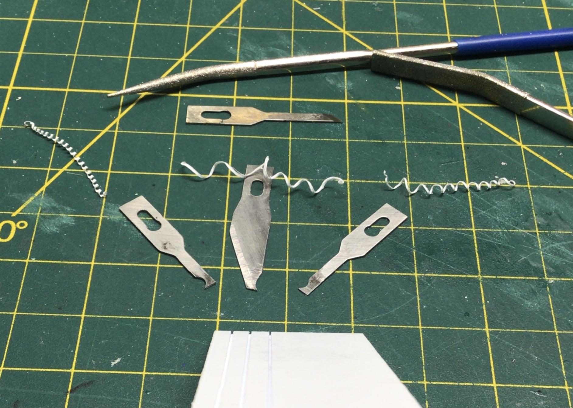

NOBLNG Posted February 11, 2023 Posted February 11, 2023 (edited) 1 hour ago, NOBLNG said: I just picked up one of those Tamiya scribers yesterday. I am going to return it though because I don’t think it’s much different than my cheap Trumpeter scriber. Actually, I think I will trade it in on something else.? I just made these scribers from some hobby blades by grinding the profile on my bench grinder. A little smoothing with a diamond file and they do a real nice square groove. The one on the right I thinned down to .012” (.3mm) from .020” (.5mm). Edited February 11, 2023 by NOBLNG Change pic. 1
Fat Brian Posted February 11, 2023 Posted February 11, 2023 I agree on the dental scraper, I even took a file to the end of mine and thinned it a bit closer to a panel line. I also made a scriber from a wooden dowel that I drilled a piece of guitar string into. 1
Dpate Posted February 11, 2023 Posted February 11, 2023 (edited) 6 hours ago, NOBLNG said: I just picked up one of those Tamiya scribers yesterday. I am going to return it though because I don’t think it’s much different than my cheap Trumpeter scriber. The more expensive ones like Dusty shows look good but very pricey.? I will trade the Tamiya one in for this one. It is still expensive, but like the better Tamiya, it will do a flat bottom groove. I have also used the butt end of a #80 drill bit in a pin vise and it works very well….but the more tools the better.? Yeah there expensive in the states for some weird reason. There cheap on plazajapan and that's where i get a lot of my tools from when i do a big order. Those HiQparts scribers are $16 on there, and I'm gonna get there smaller size ones as well. It's not even just there tools too it's there tape and cotton swabs etc just very expensive in the states. $2 pack of tape is bout $6 in the state, $2 pack of swabs bout $5-$6, and list goes on and on. I only paid bout $20 for mine with the holder which would of cost me bout $40 in the states. I just LOVE japan made products great quality stuff. Edited February 11, 2023 by Dpate
