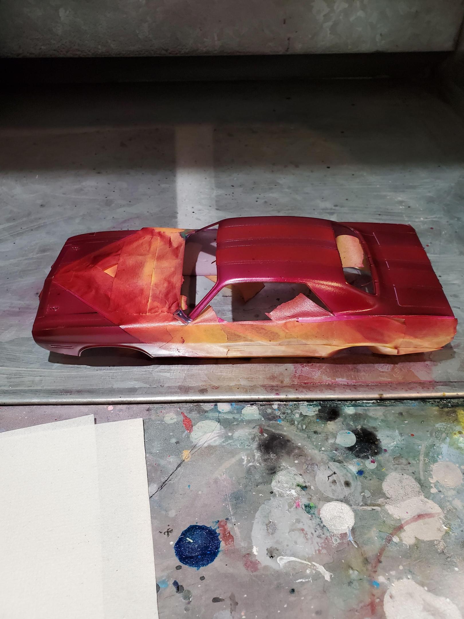

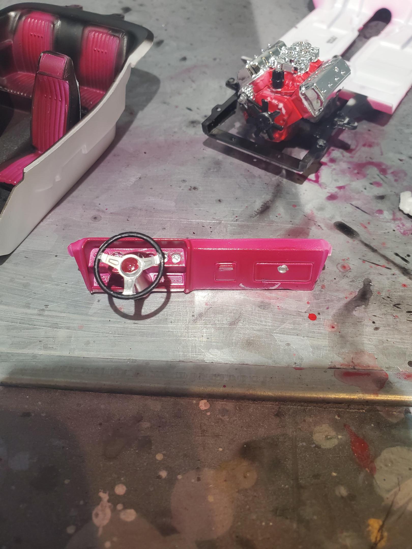

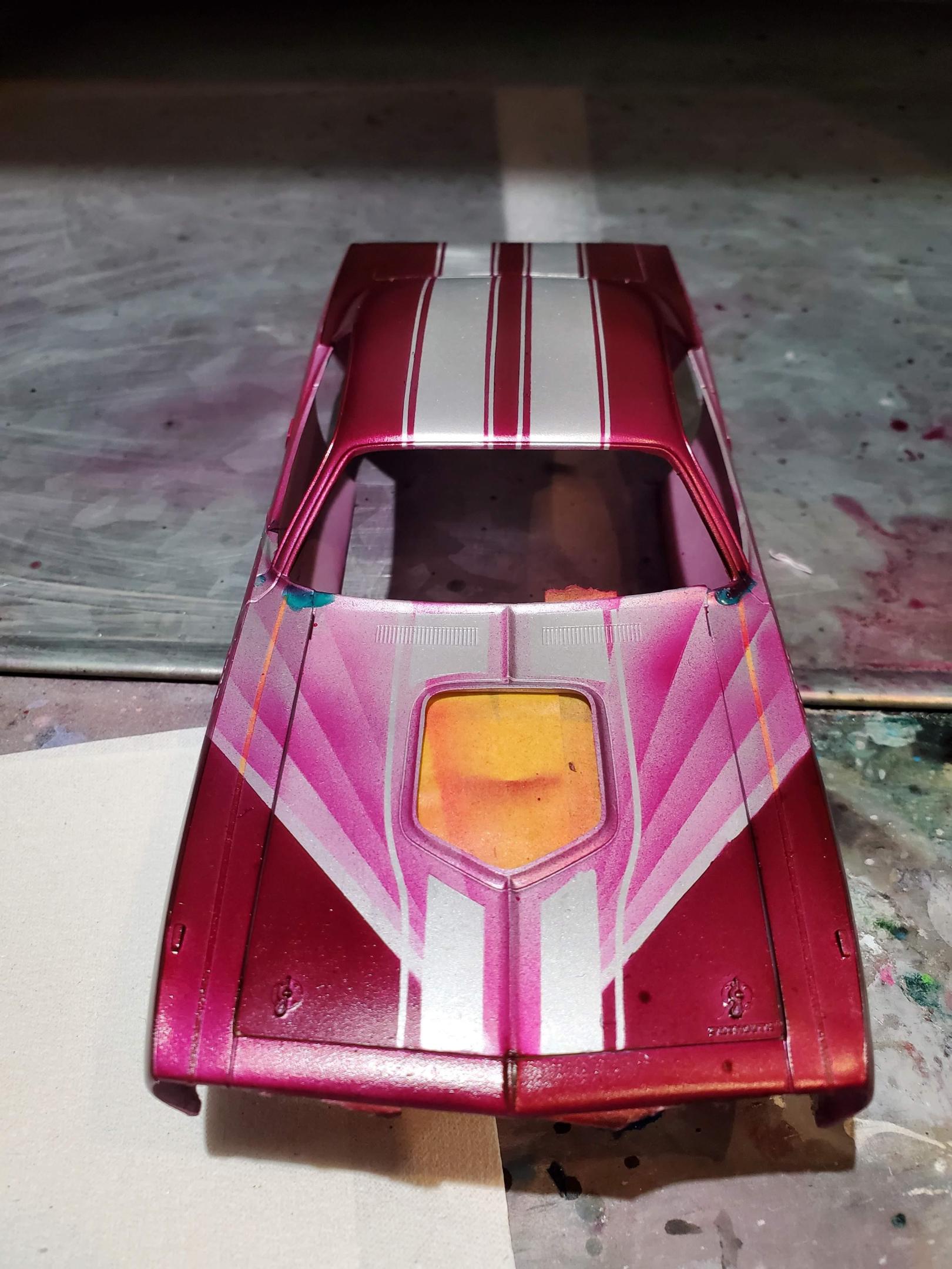

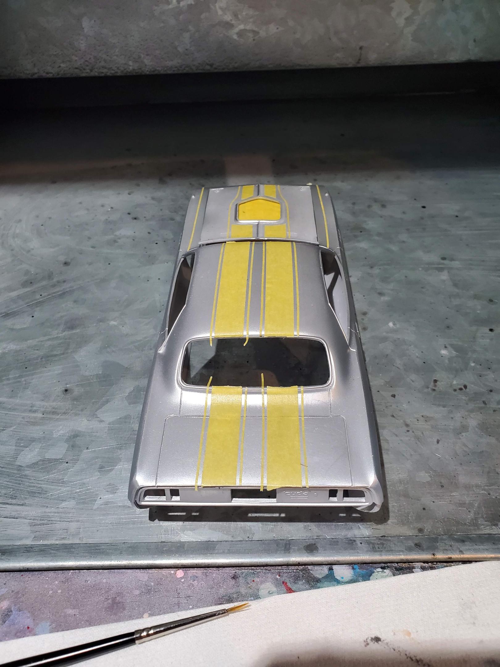

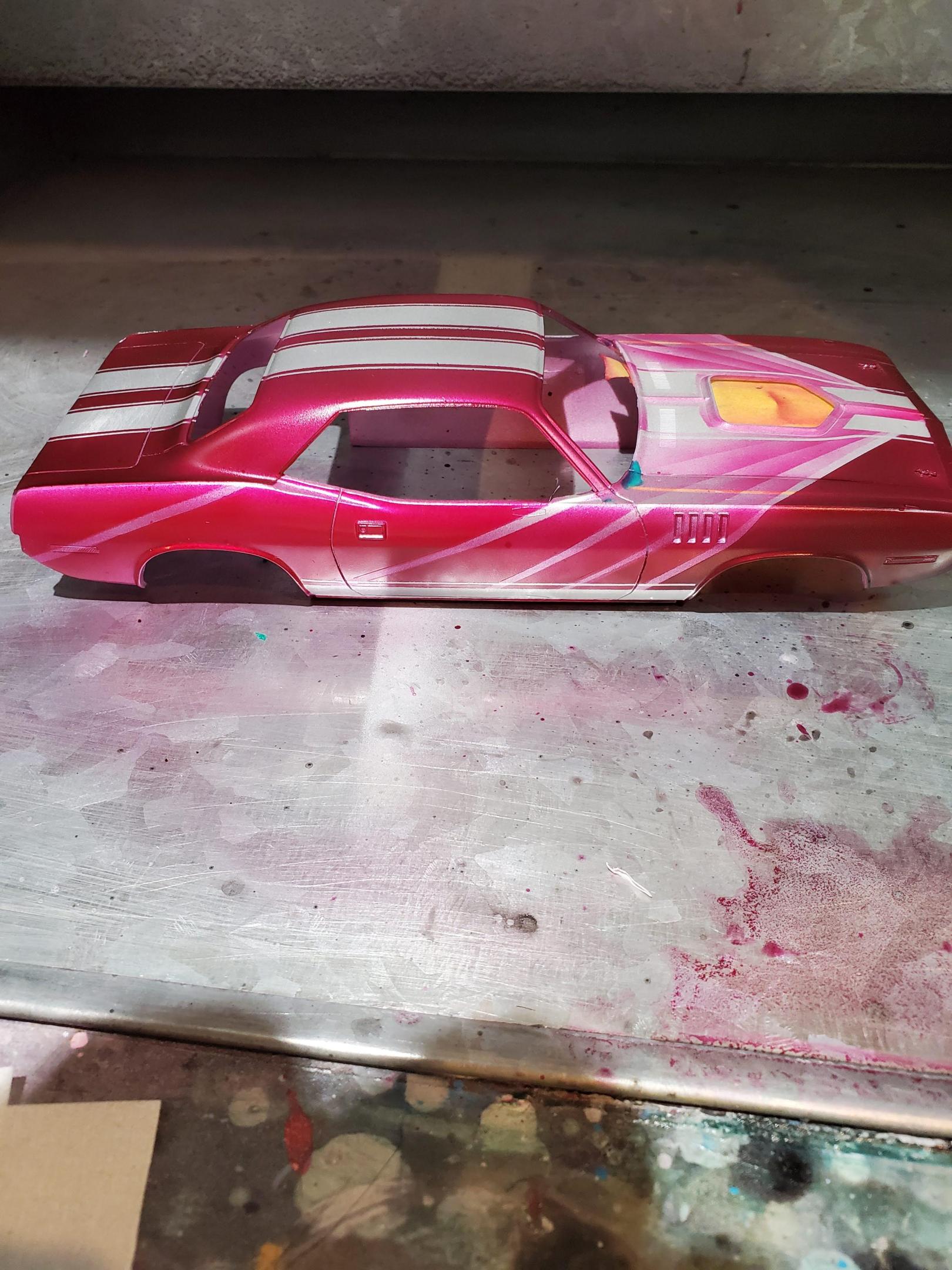

LAV25 Posted February 12, 2023 Posted February 12, 2023 So I got a 71 Hemi Cuda from Revell last summer and a membership at a local modeling makerspace. I've never really used an airbrush before, but I've been watching a lot of youtube tutorials and here's where I am so far: 3
Tcoat Posted February 12, 2023 Posted February 12, 2023 Great start! I have been doing it for years and wouldn't be much better at that fading. 1

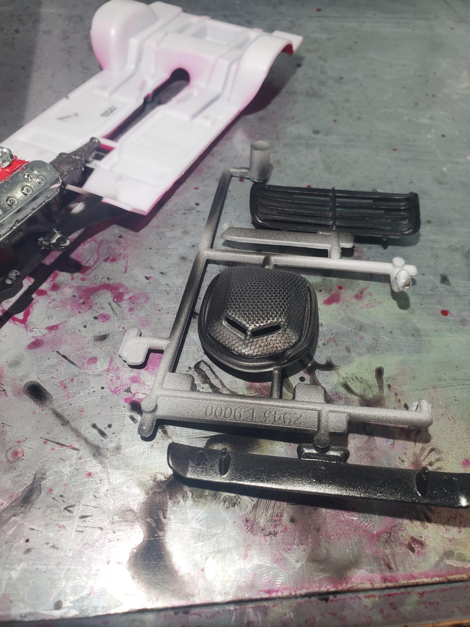

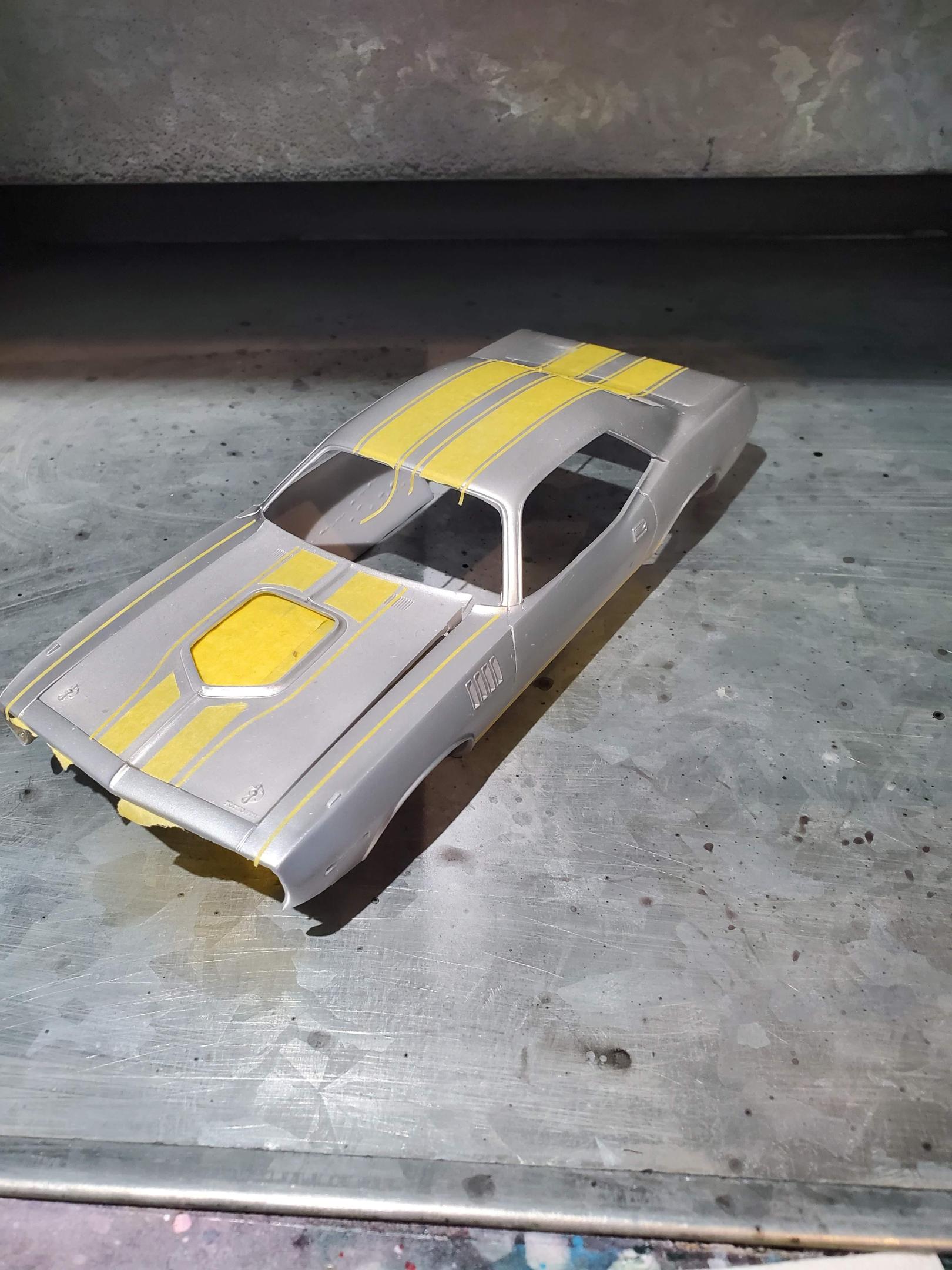

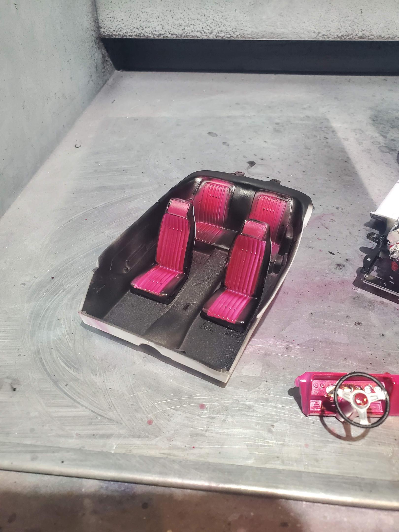

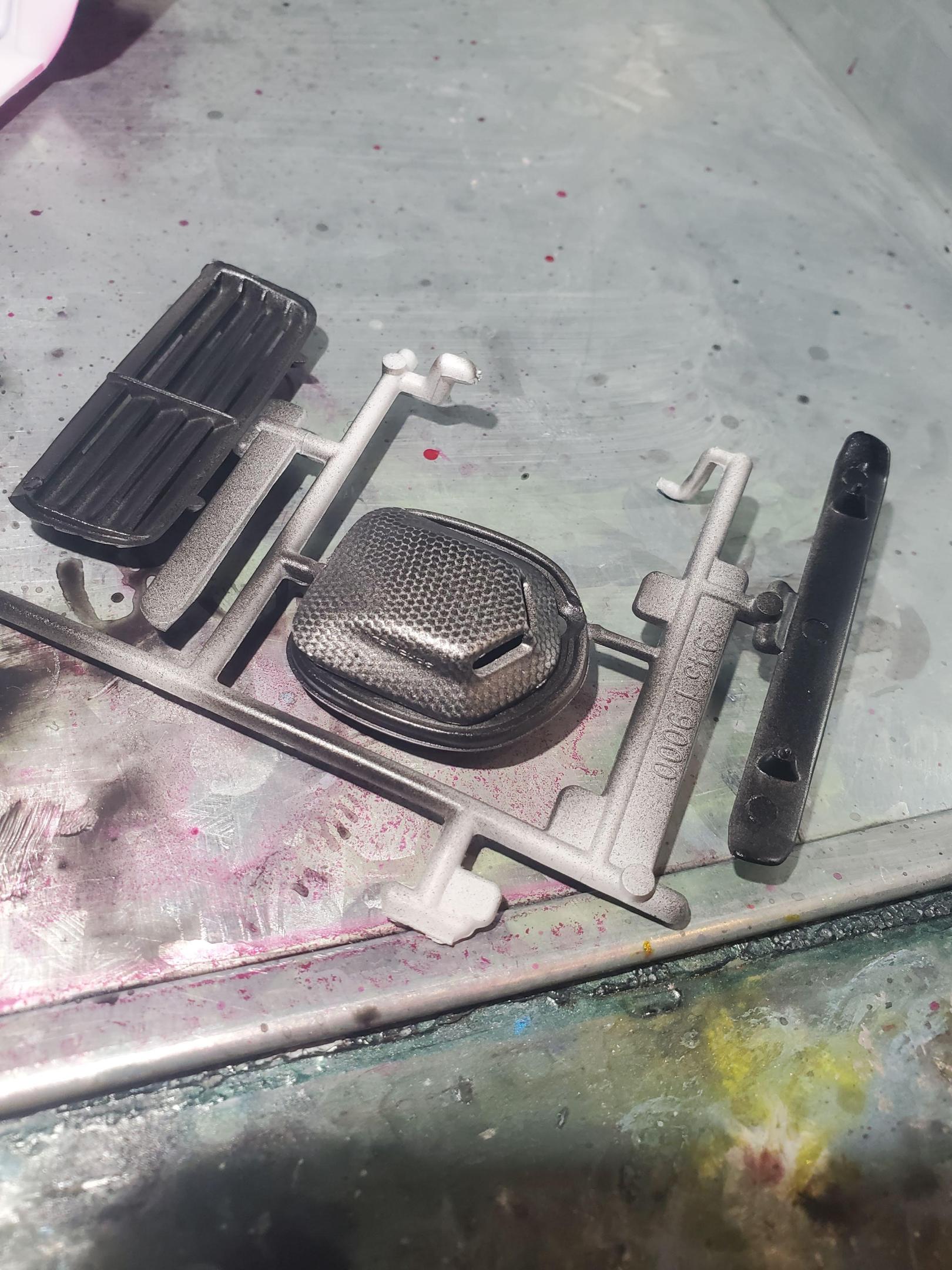

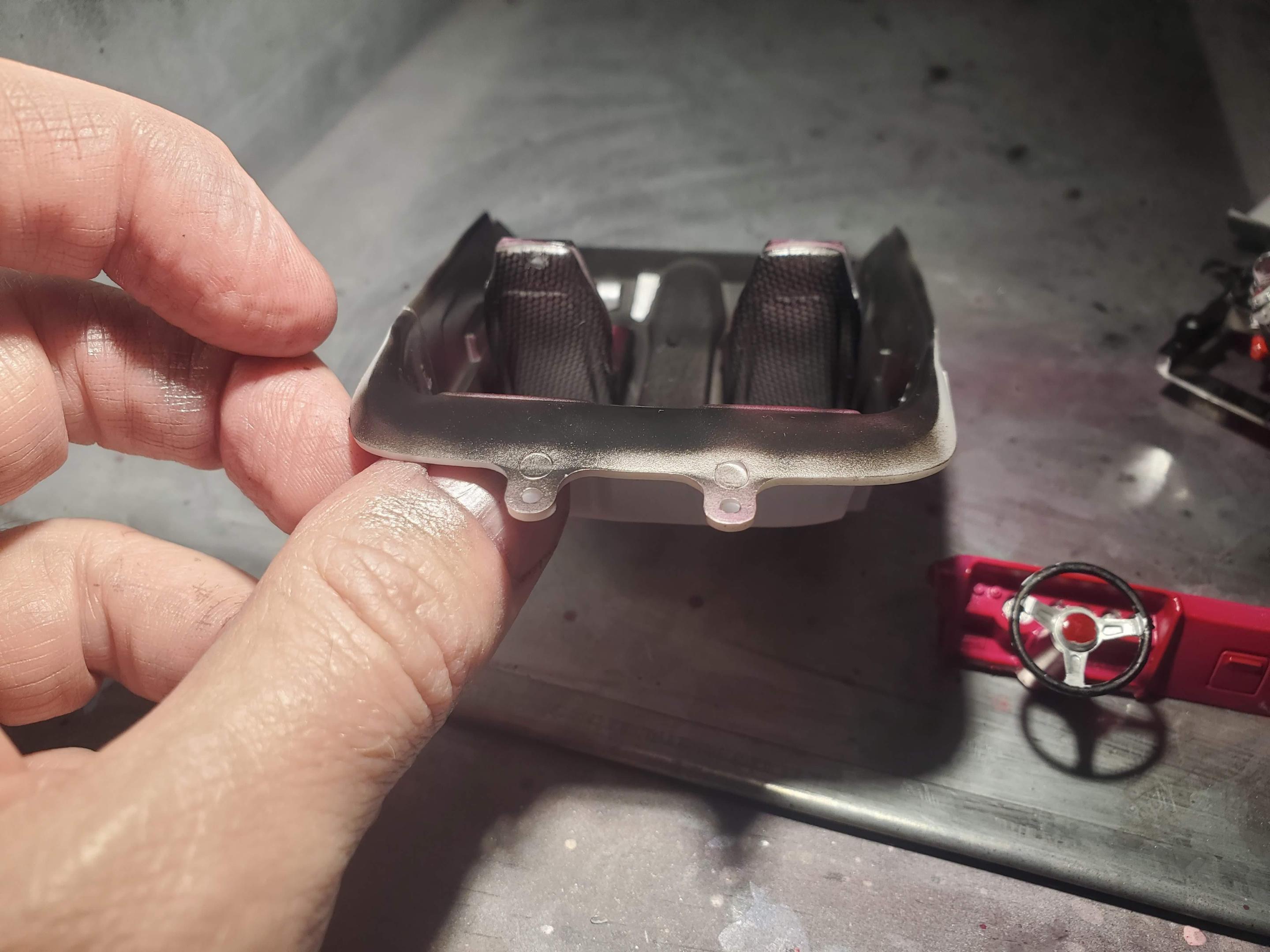

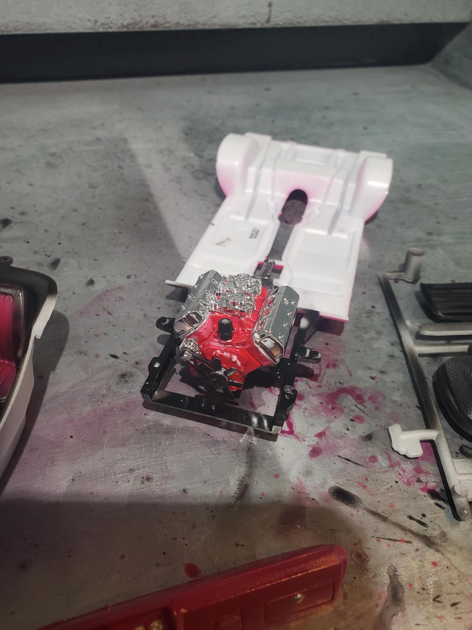

LAV25 Posted February 13, 2023 Author Posted February 13, 2023 Some more progress today, think I'll finish it tomorrow most likely. Does anyone make a carbon fiber shaker? They do now. Carbon fiber seats too it seems 3
NOBLNG Posted February 13, 2023 Posted February 13, 2023 You’re a natural!? It looks like you’ve mastered that airbrush on your first attempt.? Is that carbon fibre pattern airbrushed too? What did you use for a mask? 1
David G. Posted February 13, 2023 Posted February 13, 2023 Your airbrush work looks great! It took me quite a while just to learn how to lay down a good coat of paint and you're already doing custom masking. And quite well I might add. David G. 1
LAV25 Posted February 13, 2023 Author Posted February 13, 2023 6 minutes ago, NOBLNG said: You’re a natural!? It looks like you’ve mastered that airbrush on your first attempt.? Is that carbon fibre pattern airbrushed too? What did you use for a mask? Thanks Greg! I've still got a long way to go though. As for carbon fiber, I put down Tamiya grey primer (sorry to be so basic but I'm in a really basic point here and have found a lot of little details that I thought wouldn't matter do), then enough Mr. Color Silver to coat. The mask was a piece of a fishtank net (for when you need to get the goldfish out to do a good cleaning) from the dollar store, held firm underneath and then sprayed with black. That's on the shaker, the seatbacks were black first then silver but I think I like majority black better than majority silver. Just now, David G. said: Your airbrush work looks great! It took me quite a while just to learn how to lay down a good coat of paint and you're already doing custom masking. And quite well I might add. David G. Thanks David! But I don't think I'm doing such a hot job of laying down the basic coats. I have a tendency to get impatient, open the air valve wide, pull the trigger all the way back, get in close... Basically I should just be doing melting paint jobs :). Still, this car and the Estima (under glass) are training pieces for a 66 Chevy Stepside I'm going to start on shortly. Make the mistakes here so that one comes out good.

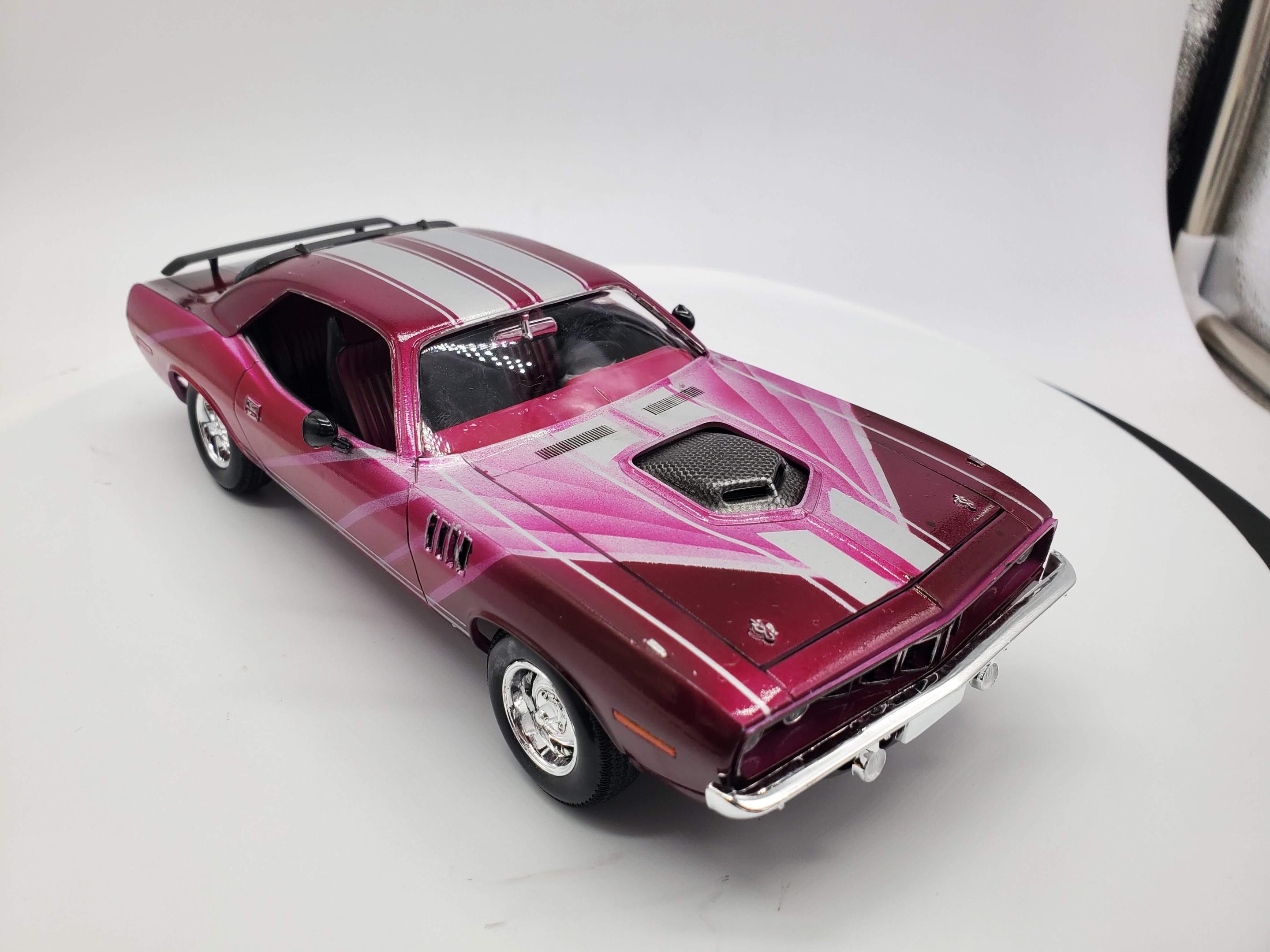

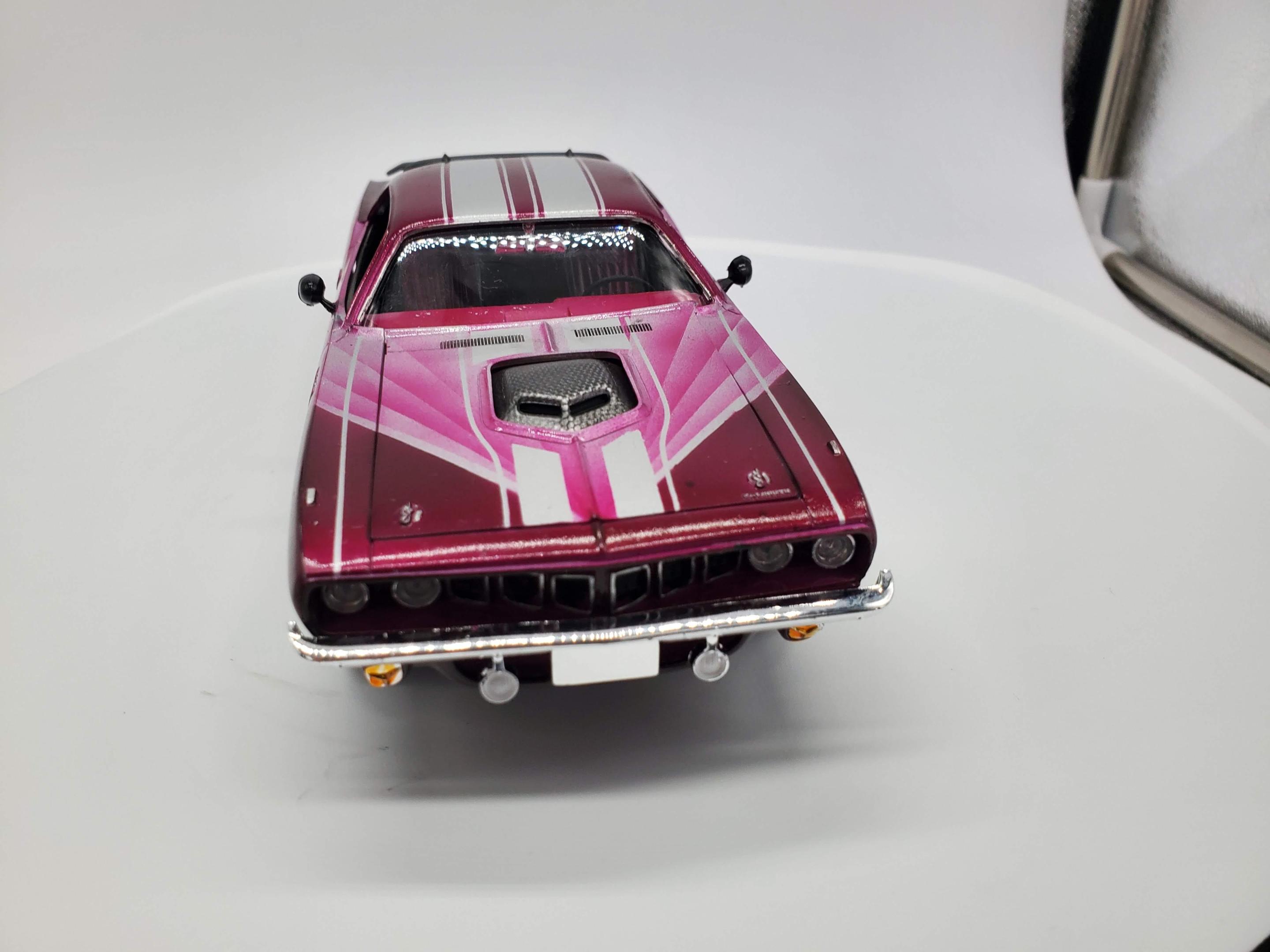

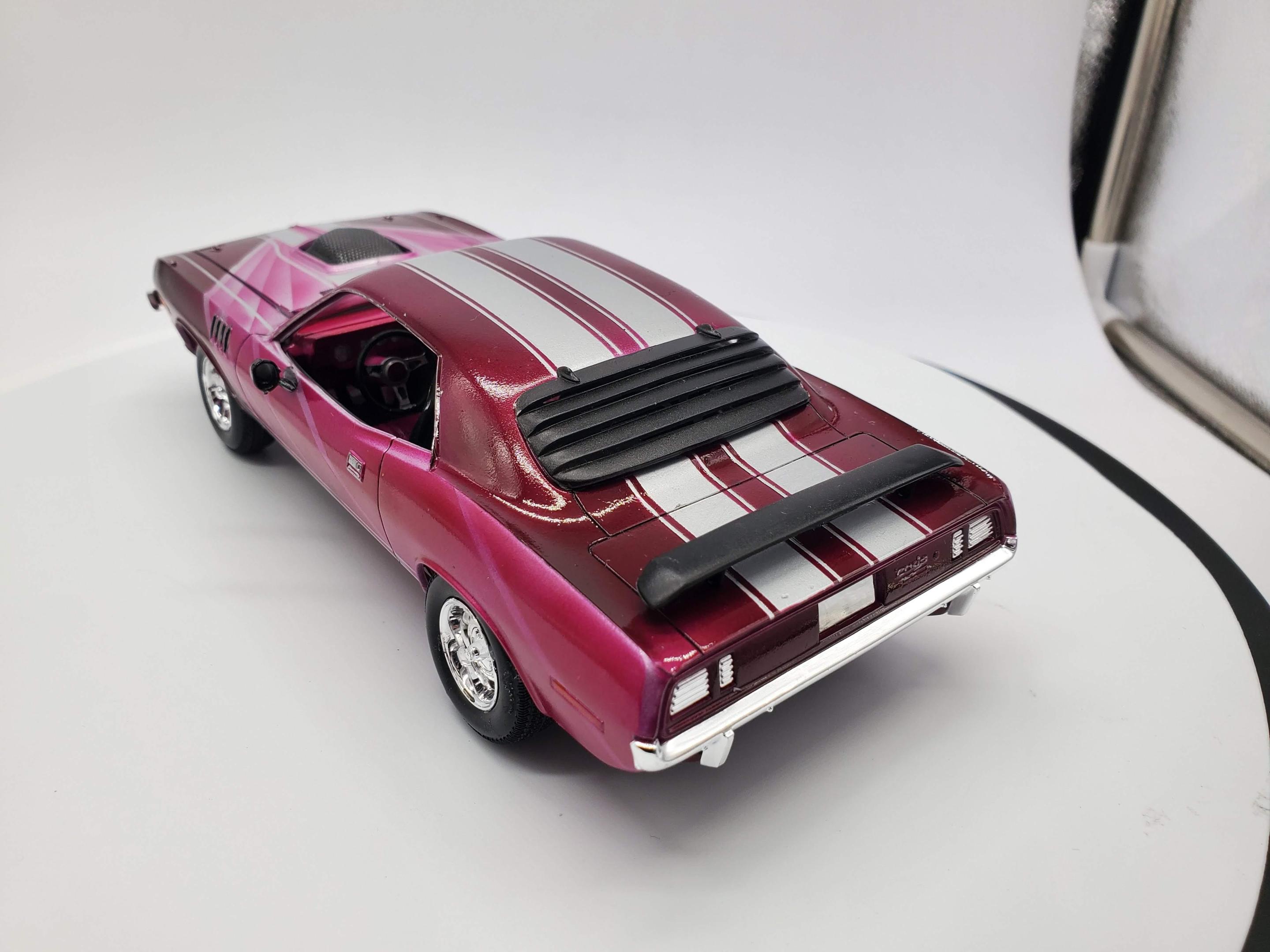

LAV25 Posted February 17, 2023 Author Posted February 17, 2023 I wanted to call this "Under Glass" but when I looked at the pics I found a couple things I can still fix. Notably the distributor cap is interfering with the proper seating of the shaker. The hood is also warped but I see from some other members' posts that this is an issue with the model. Anyway, almost ready for under glass status:
David G. Posted February 17, 2023 Posted February 17, 2023 Super Sharp! Great looking work for a first go with an airbrush. David G.
bytownshaker Posted February 17, 2023 Posted February 17, 2023 Absolutely fantastic result especially for first time using an airbrush.
