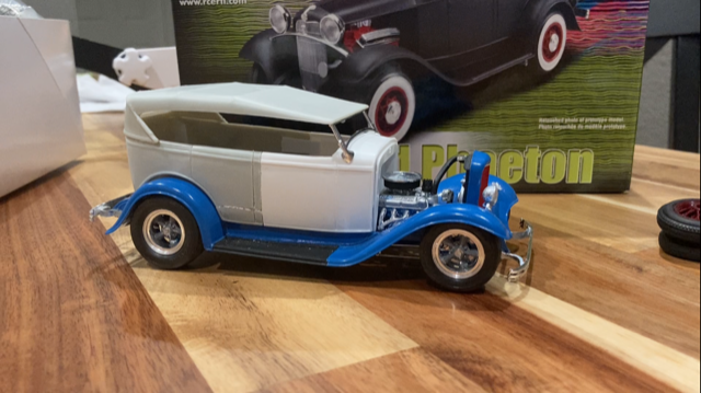

Dan Hay Posted February 16, 2023 Posted February 16, 2023 I finally did it. I've had this idea that I could make an AMT phaeton and a Revell roadster body have a baby, so I could build a Phaeton on a Revell chassis. It wasn't too hard. The build will be a highboy, for reasons explained in the video below. It wasn't a perfect conversion, but it'll work for my purposes. More details here 6

Dan Hay Posted January 6, 2024 Author Posted January 6, 2024 Finally back on this one. Scratch built the interior behind the front seat, modified the top and a bunch of other subtle mods. Full explanation in the video. Thanks for looking! 6

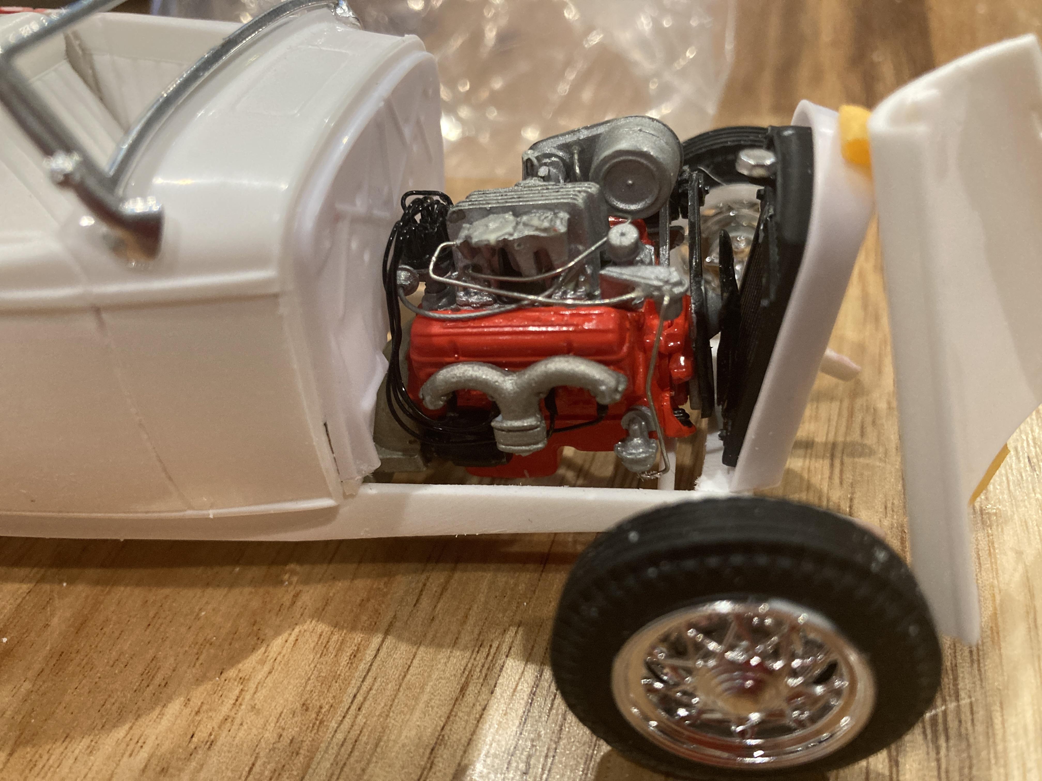

Dan Hay Posted January 16, 2024 Author Posted January 16, 2024 Thanks fellas! Body is in primer and looks really good. I think the rear portion could be widened to be more accurate, but I decided to live with it. It looks narrow from the back compared to a sedan and pics of Phaetons online. 4

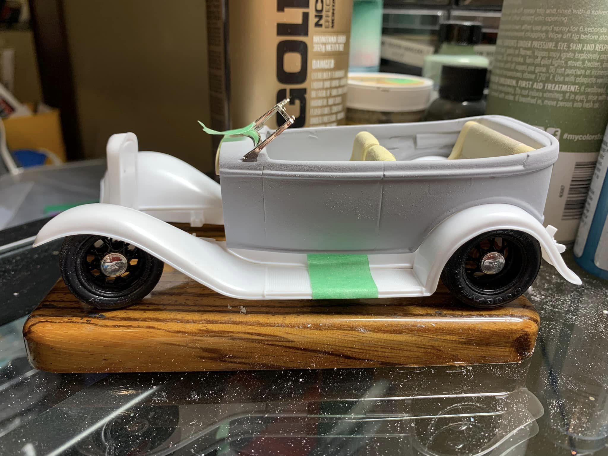

Finks Garage Posted January 16, 2024 Posted January 16, 2024 l love what you are doing! I I am working on one as well. It is more of a custom as I am using the Phantom Vicky front cowl and duval windshield and making it a 2-door phaeton. I used the top part of the 30 touring and scratch build the lower rear section and made new body line molding aruond the fenders. I plan to run fenders as shown. 4
