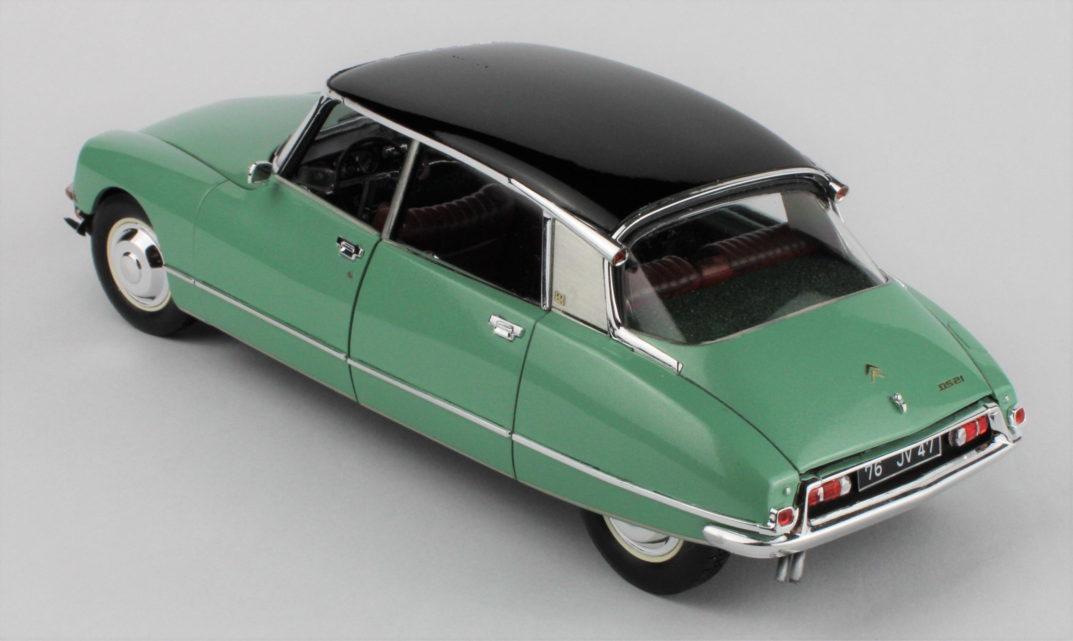

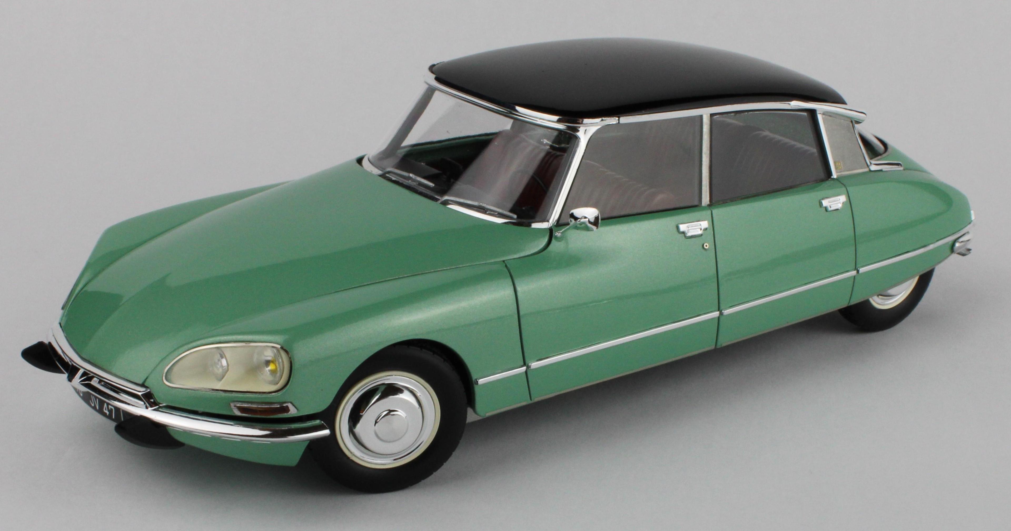

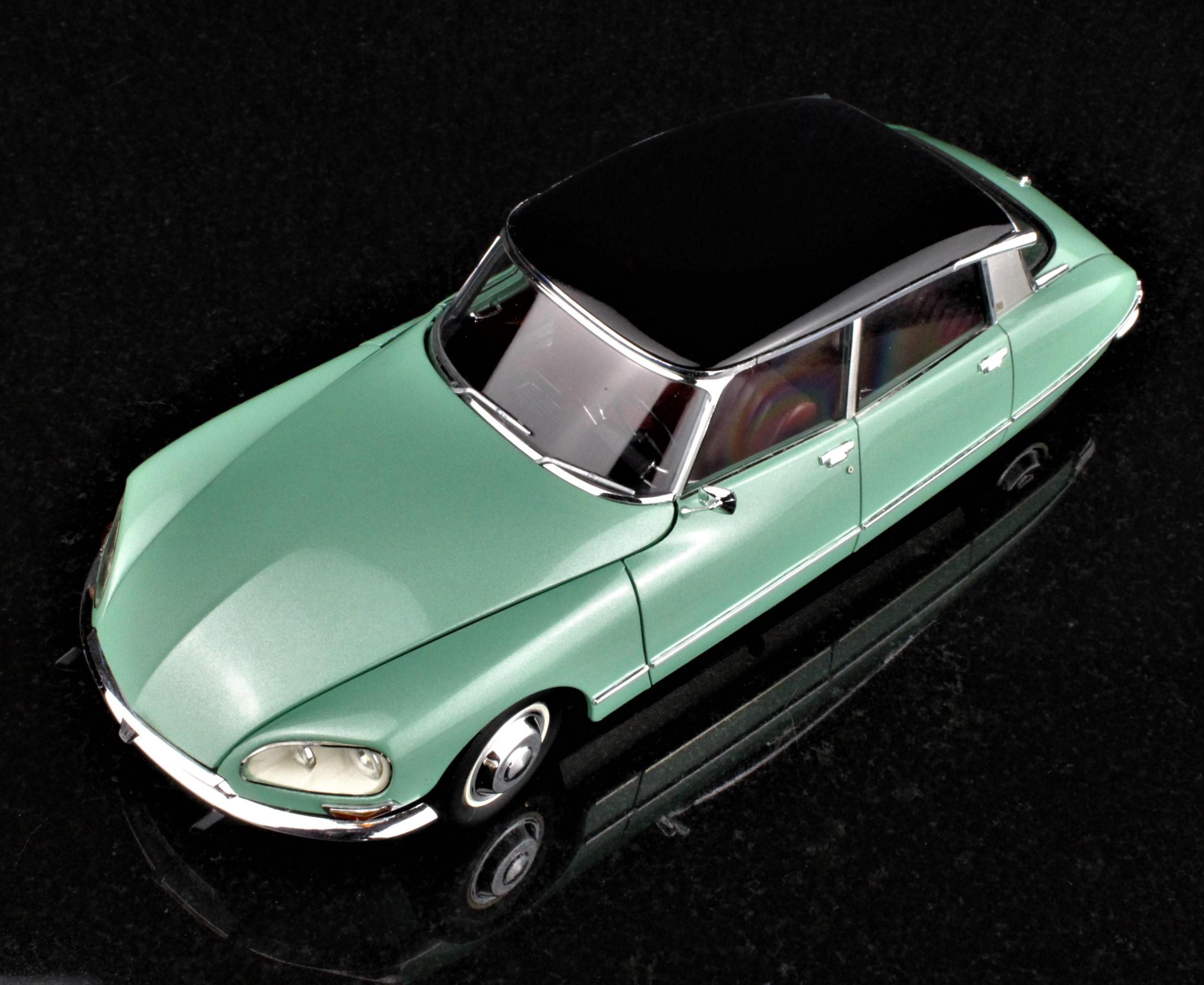

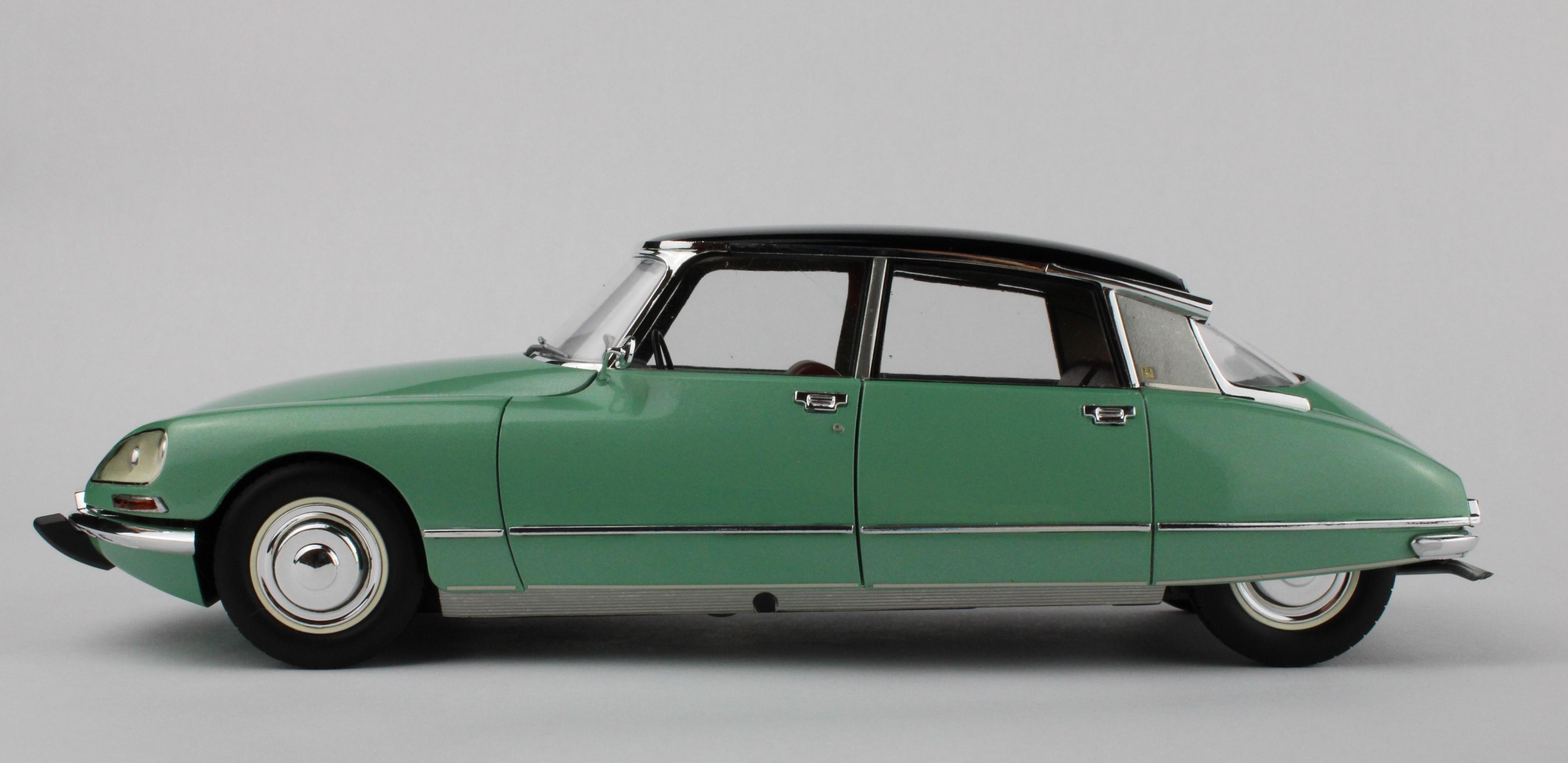

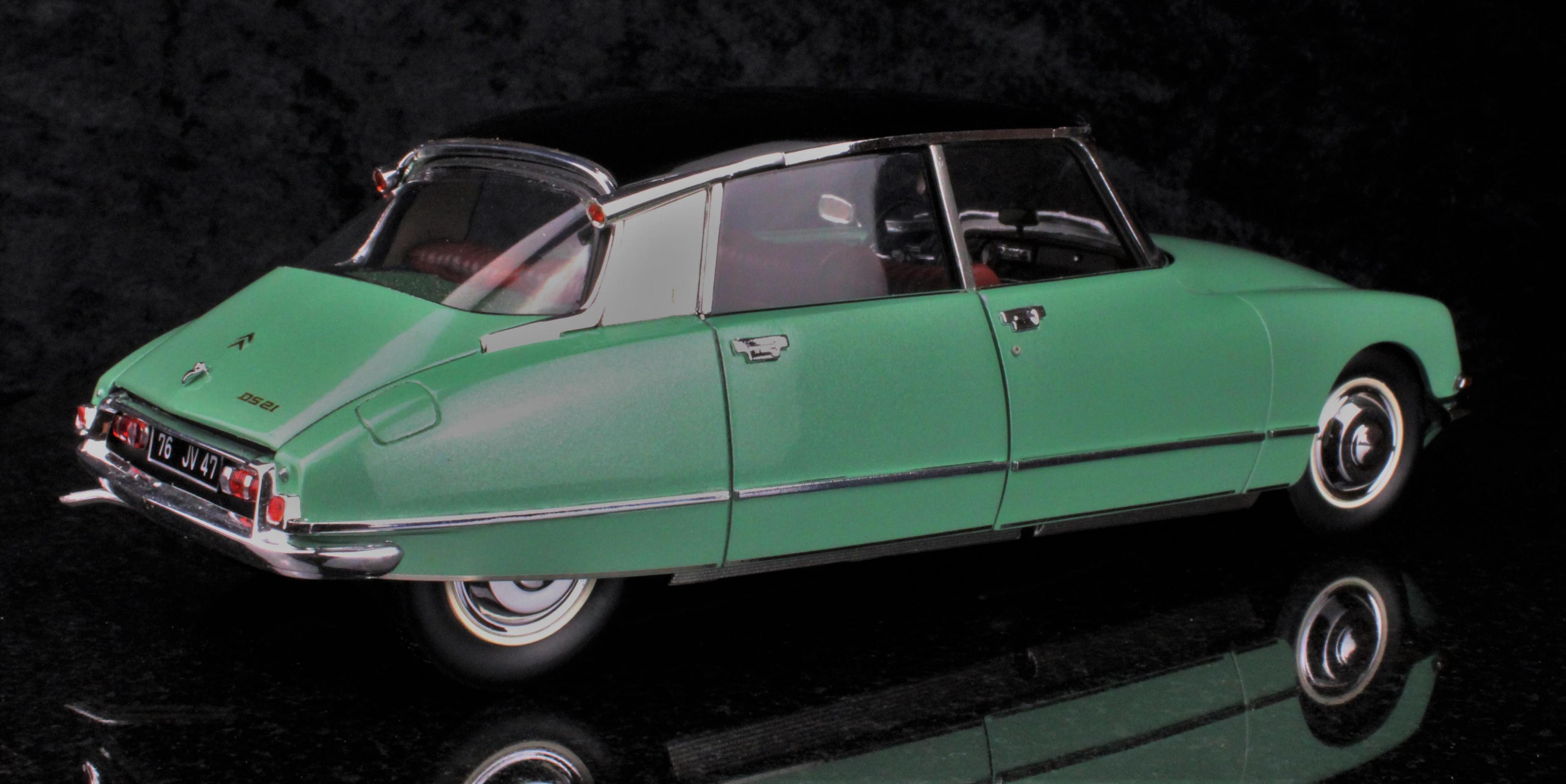

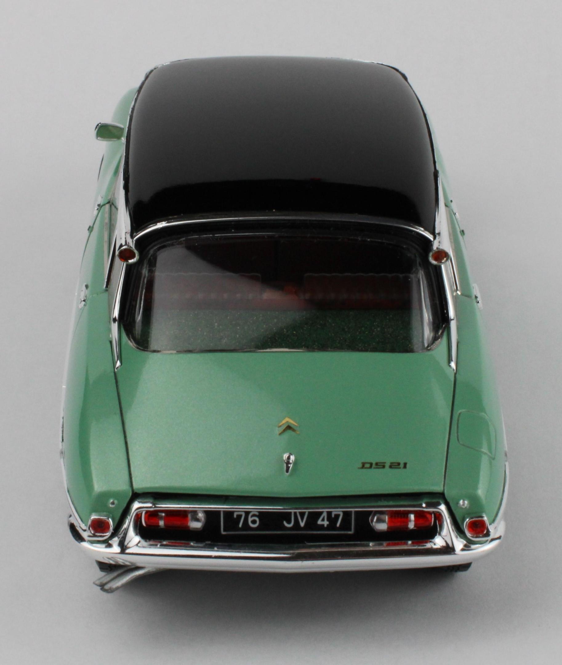

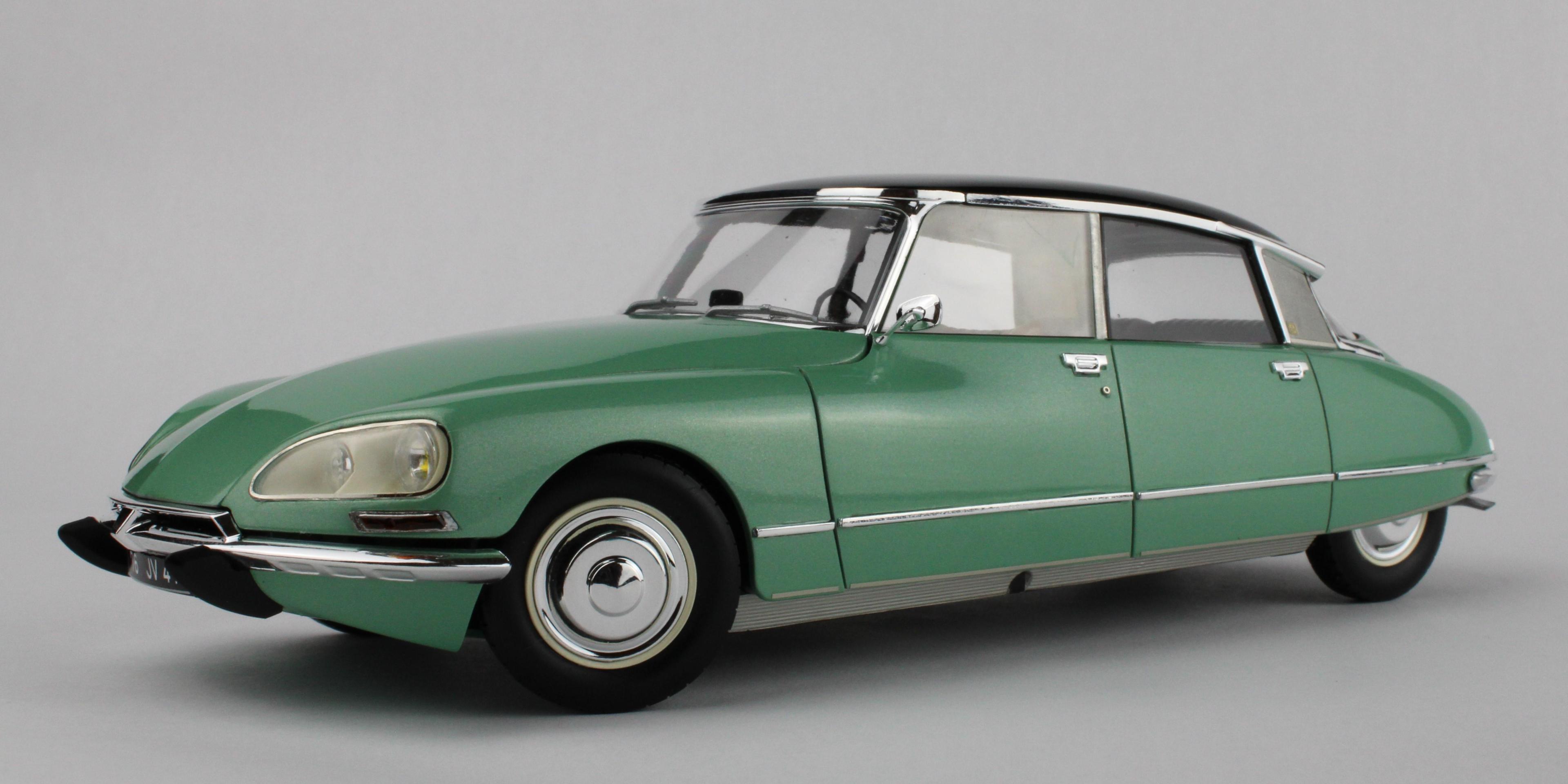

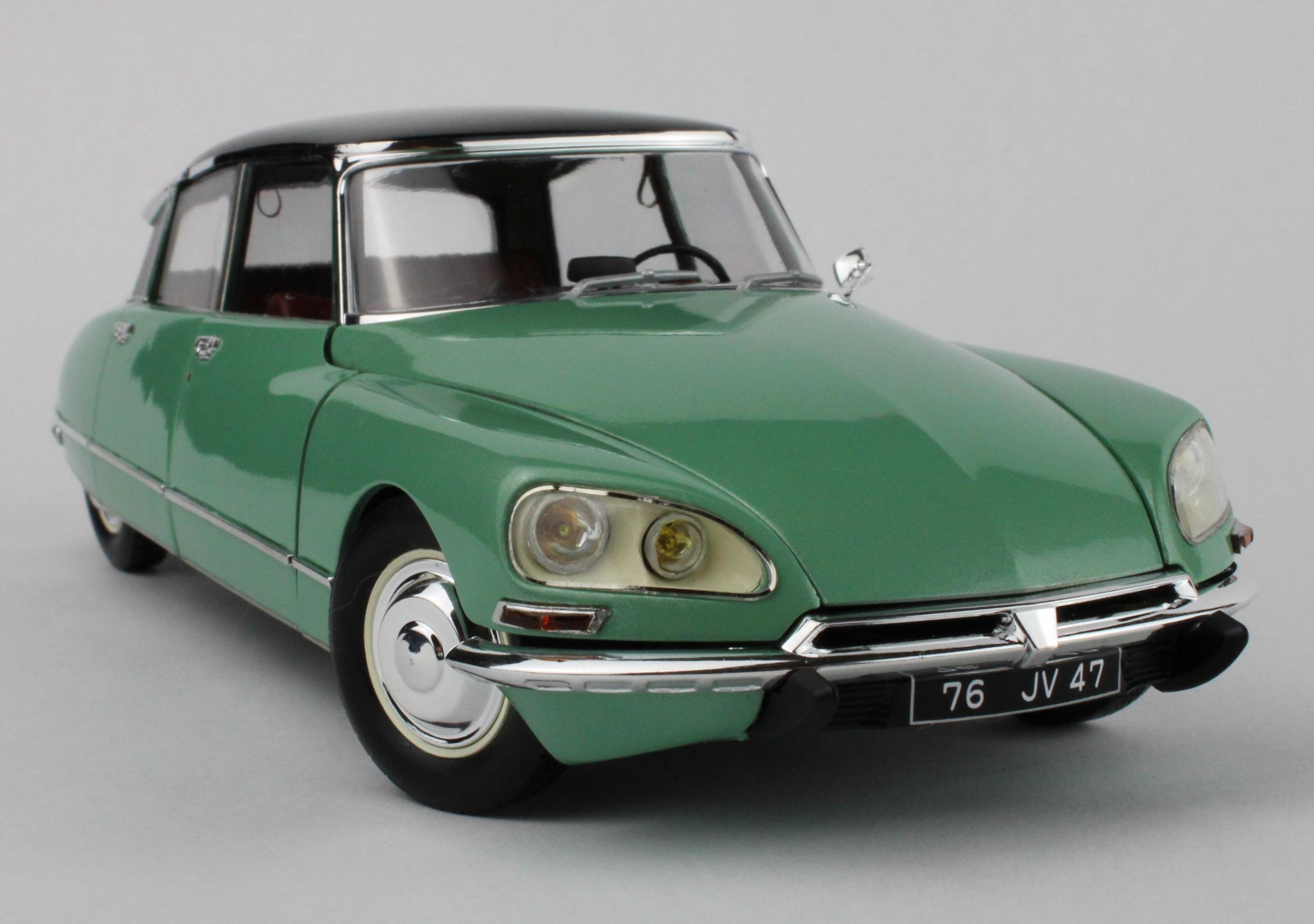

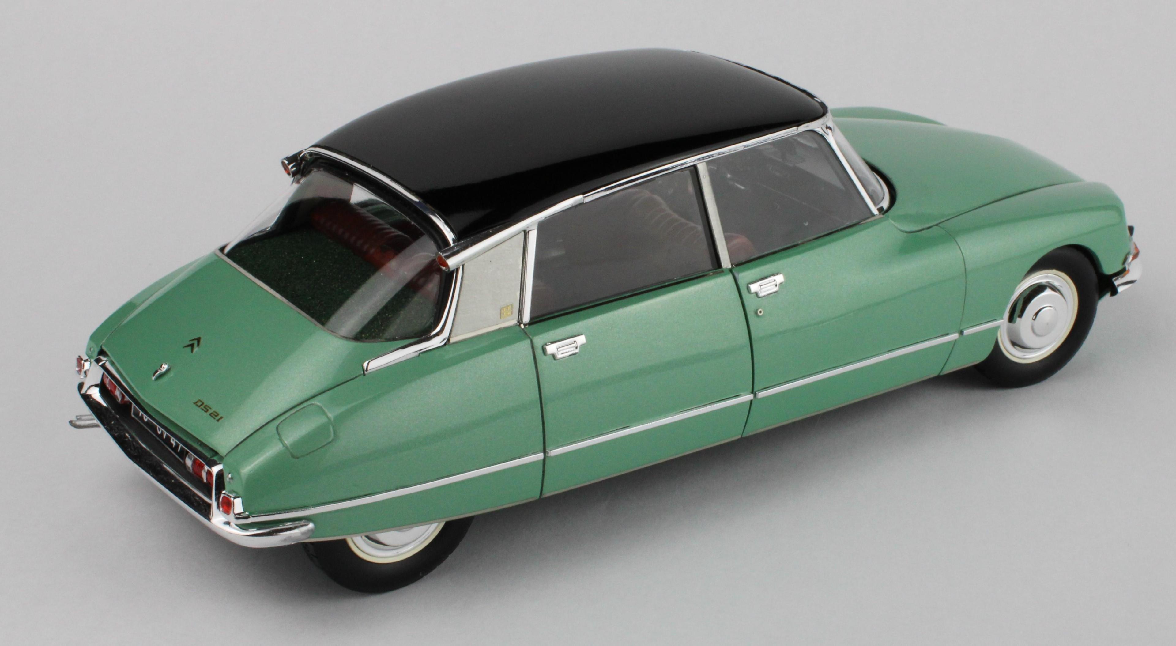

This is Ebbro's 1/24 scale Citroen DS21. When the DS19 was introduced in 1955, it was like nothing else in the world. Its complicated hydropneumatic system provided an incredible ride, a clutchless manual transmission, effortless braking and light power steering. Its styling, both inside and out, was radical. The DS was originally slated for an air-cooled flat-six engine, but development issues caused it to be produced with a development of the 4-cylinder unit in use by Citroen since the mid-30's.
The DS 21 was introduced in the late 60's, and introduced a sleek front end treatment with covered headlamps as well as more power and an updated interior. Ebbro's kit represents (sort of) an early 70's model. The DS was built until 1975.

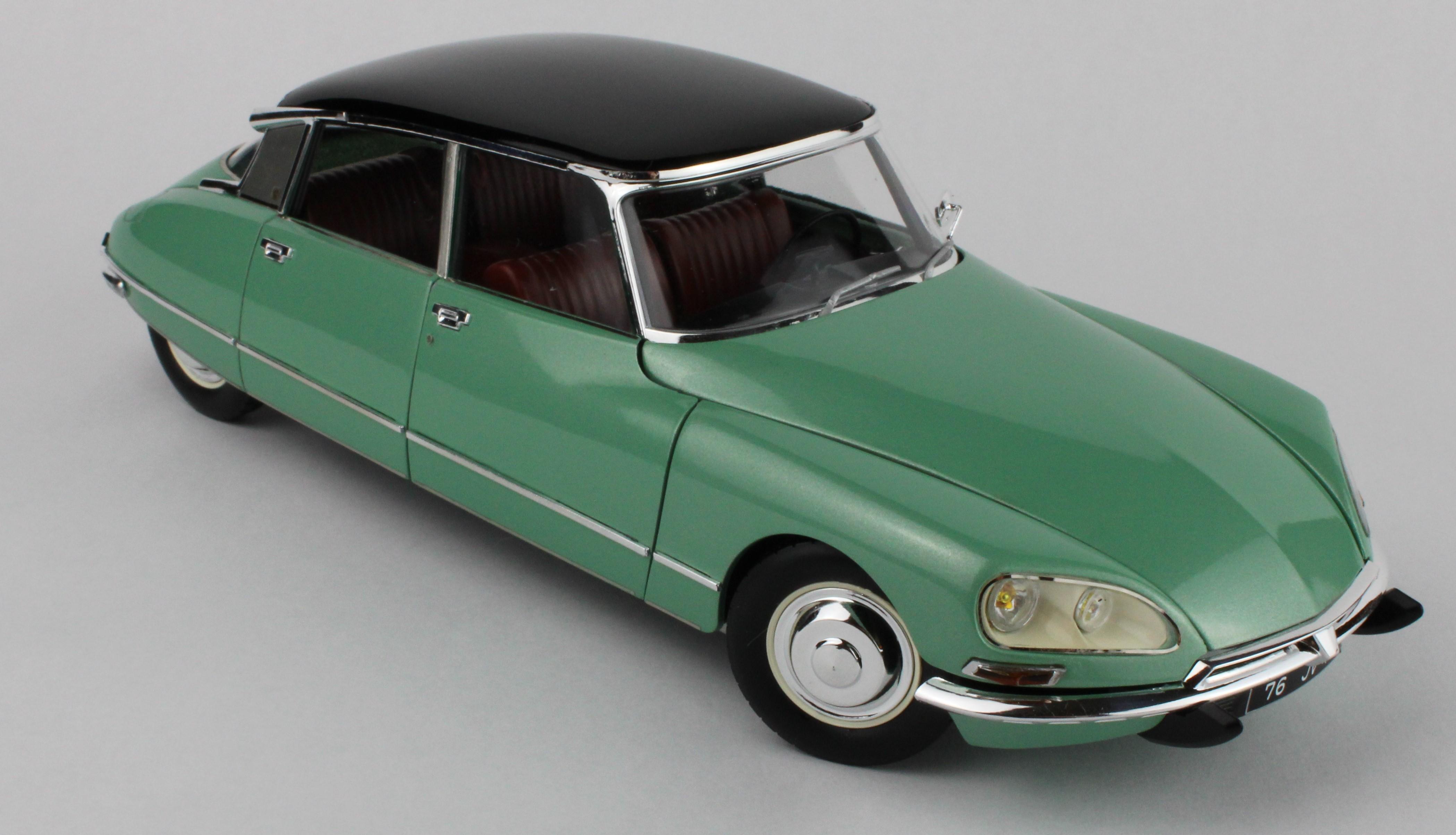

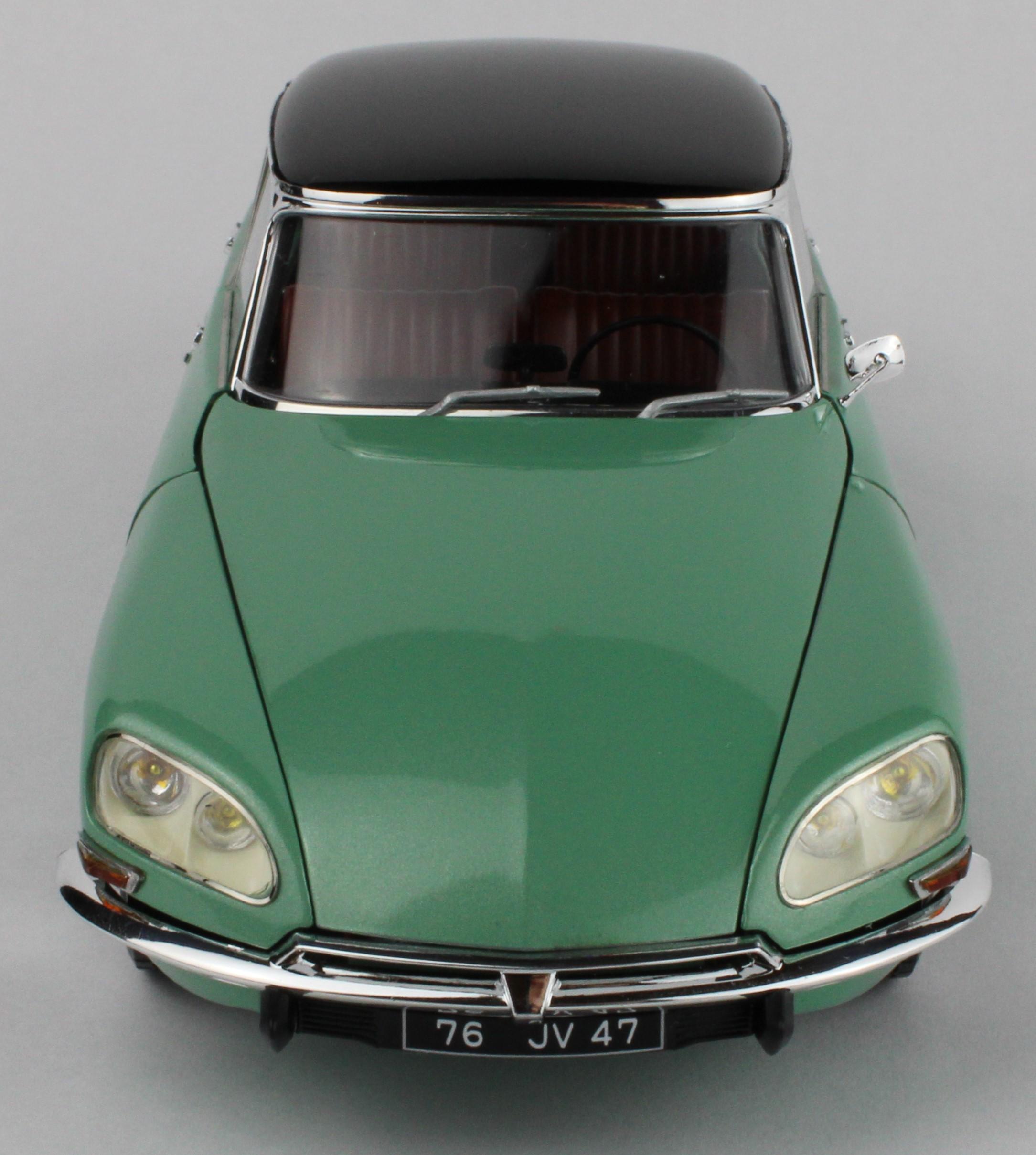

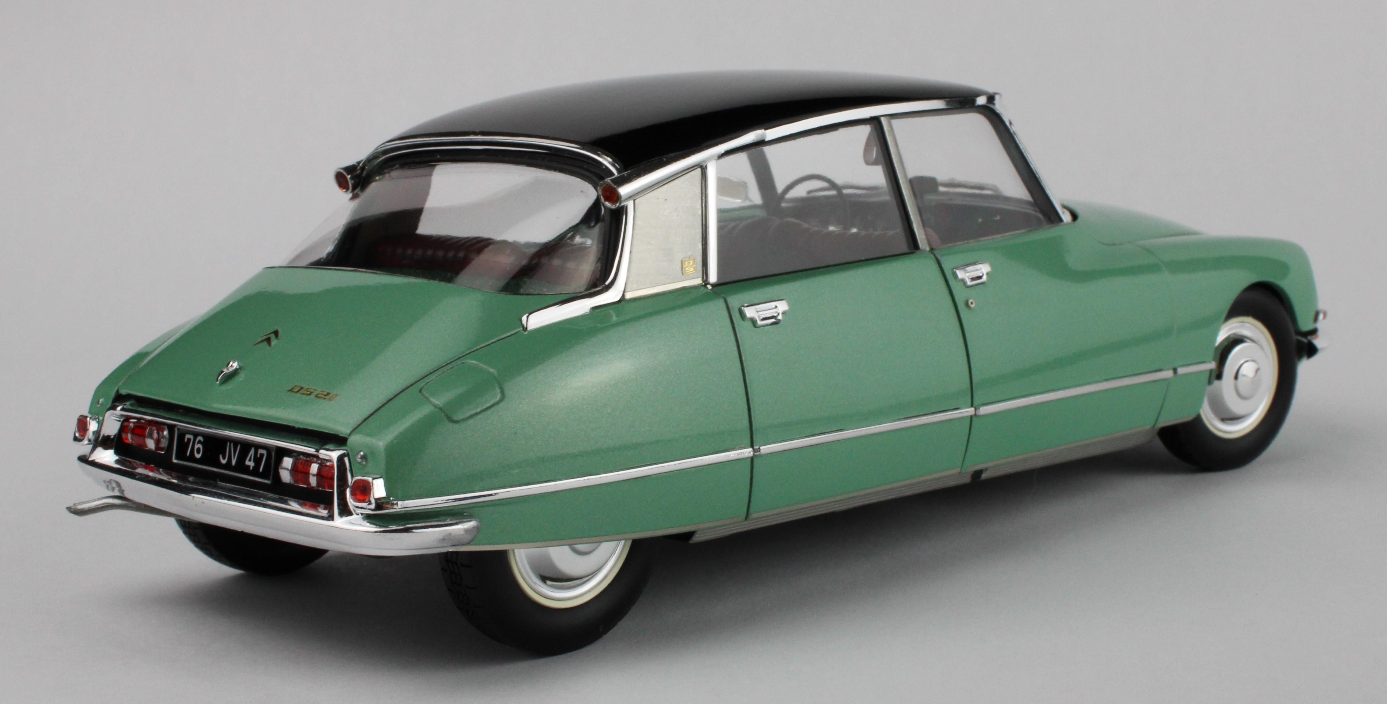

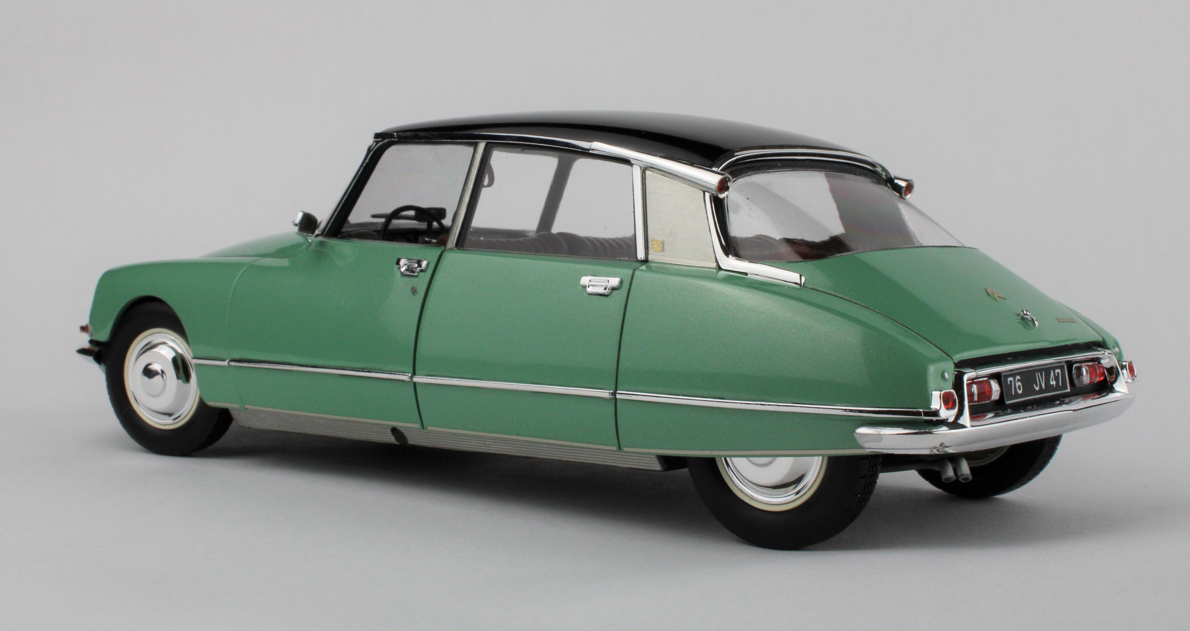

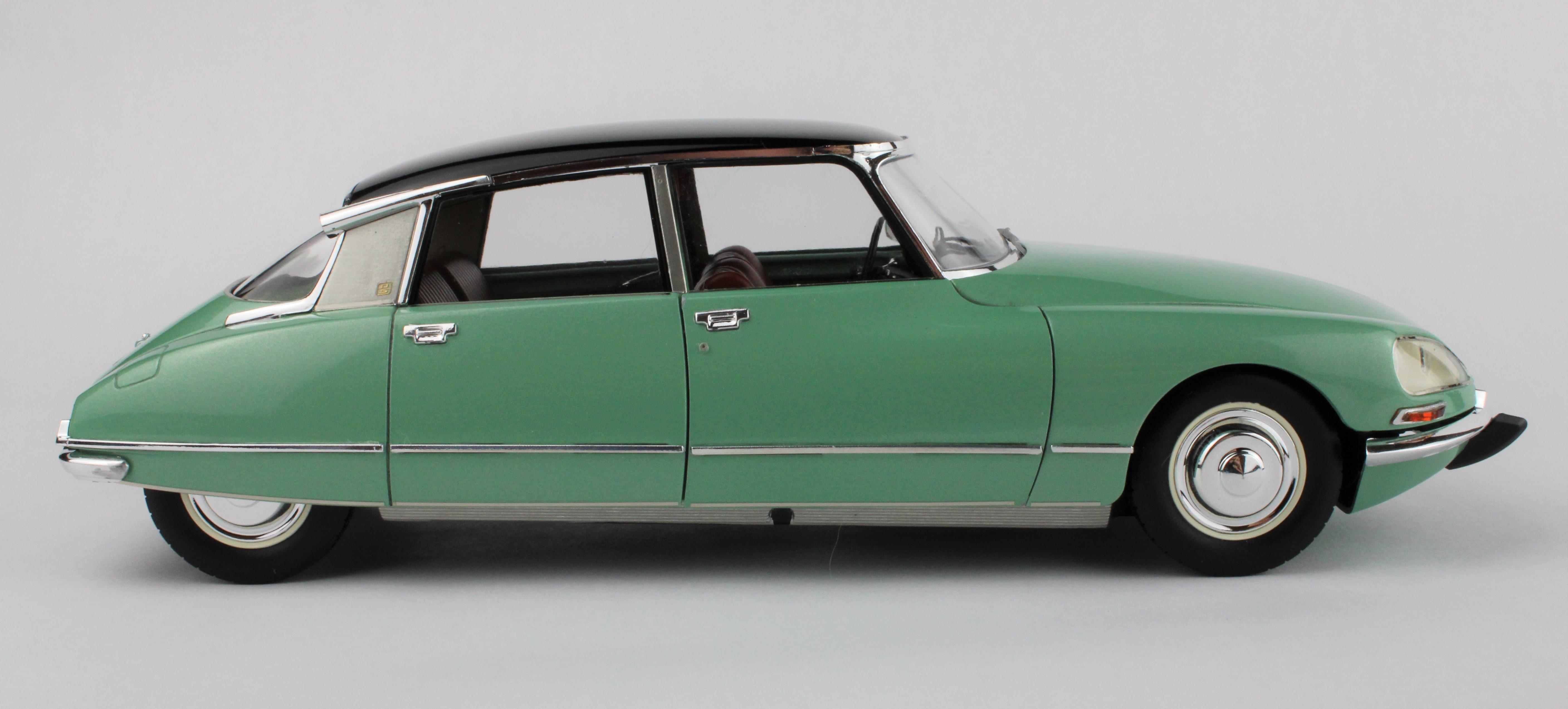

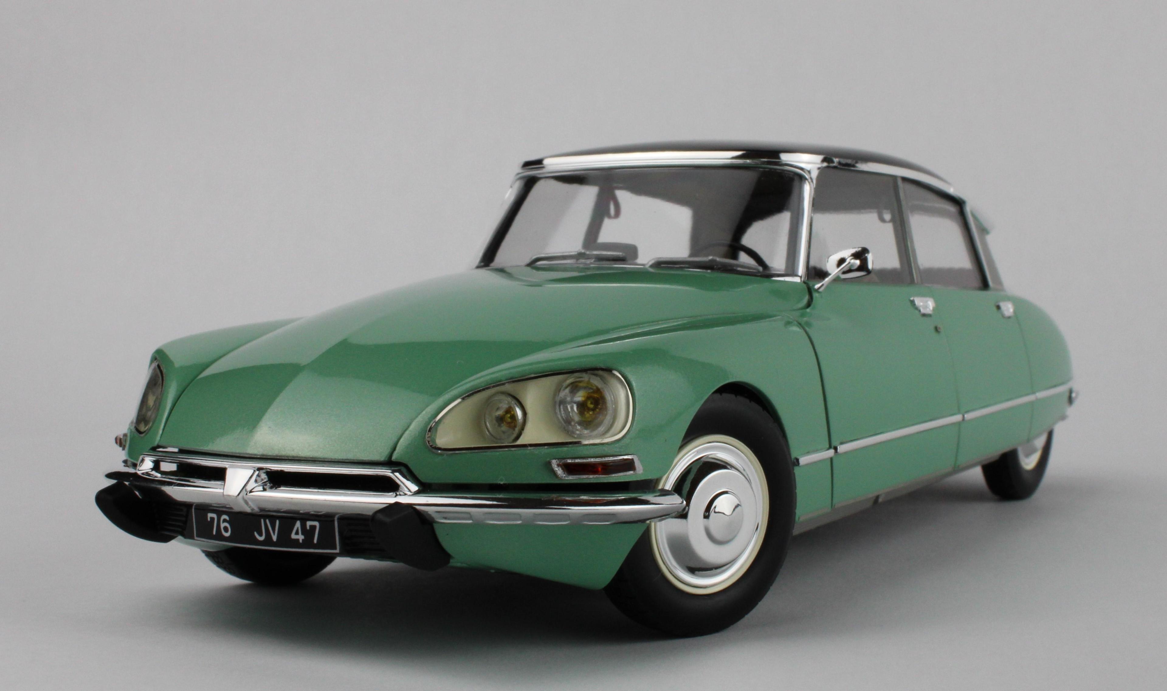

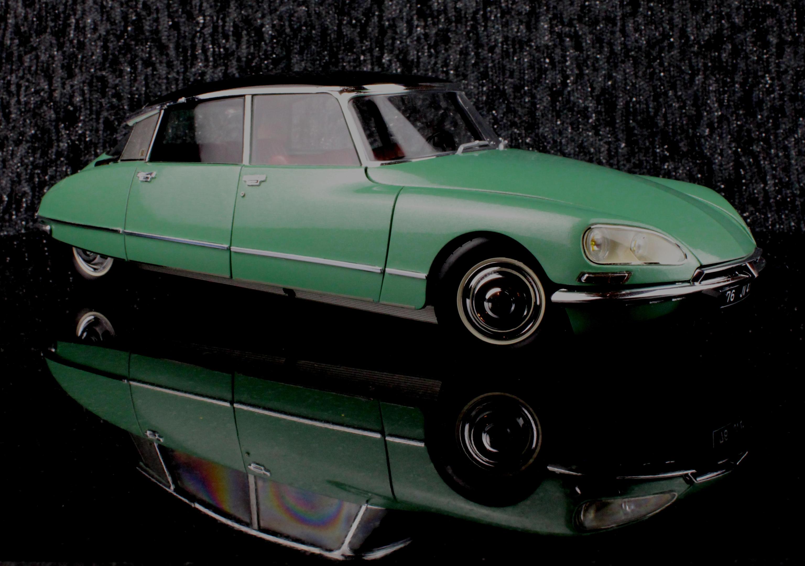

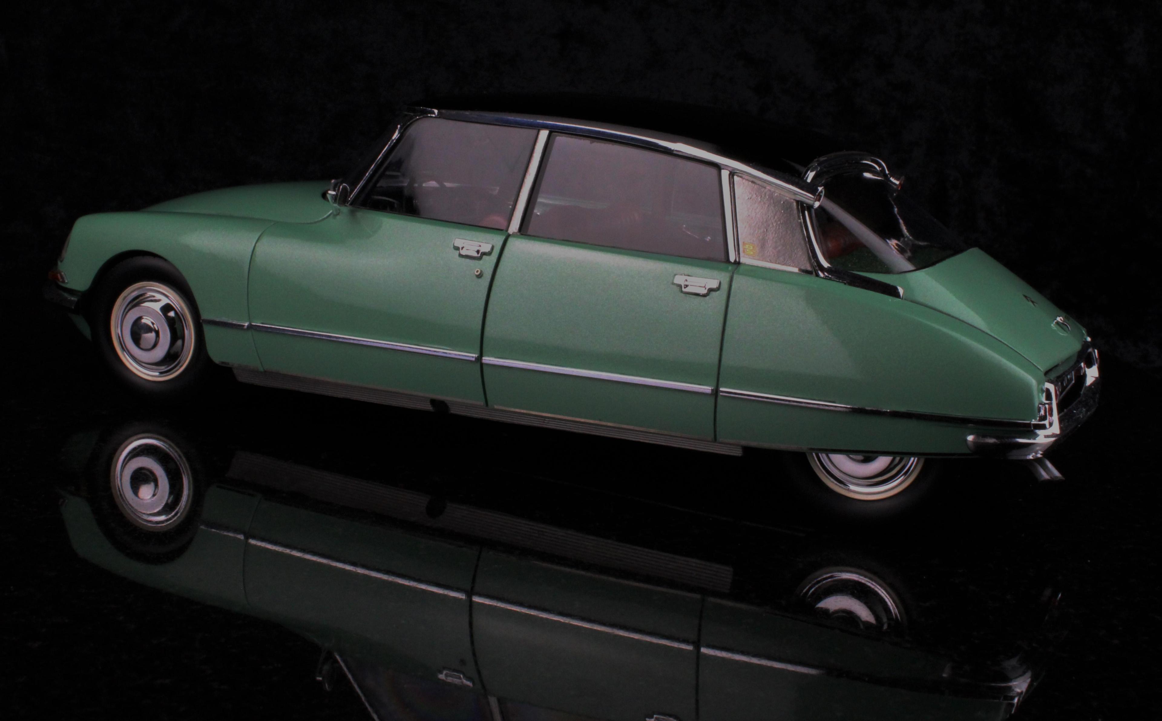

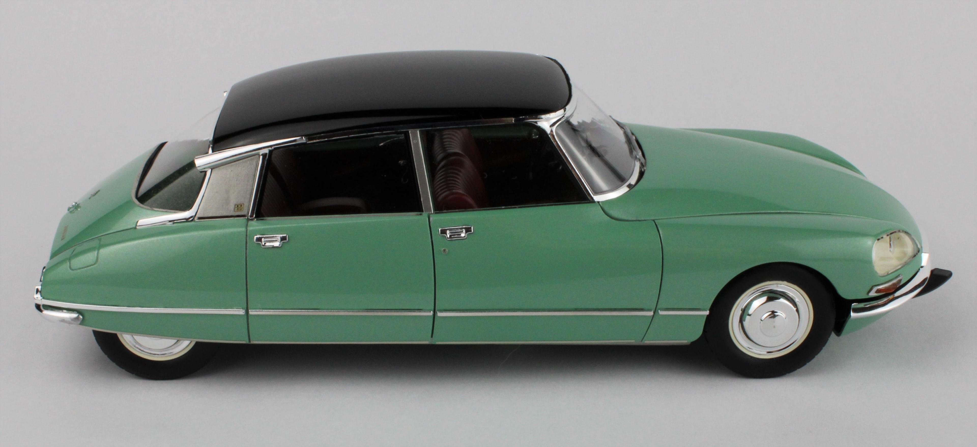

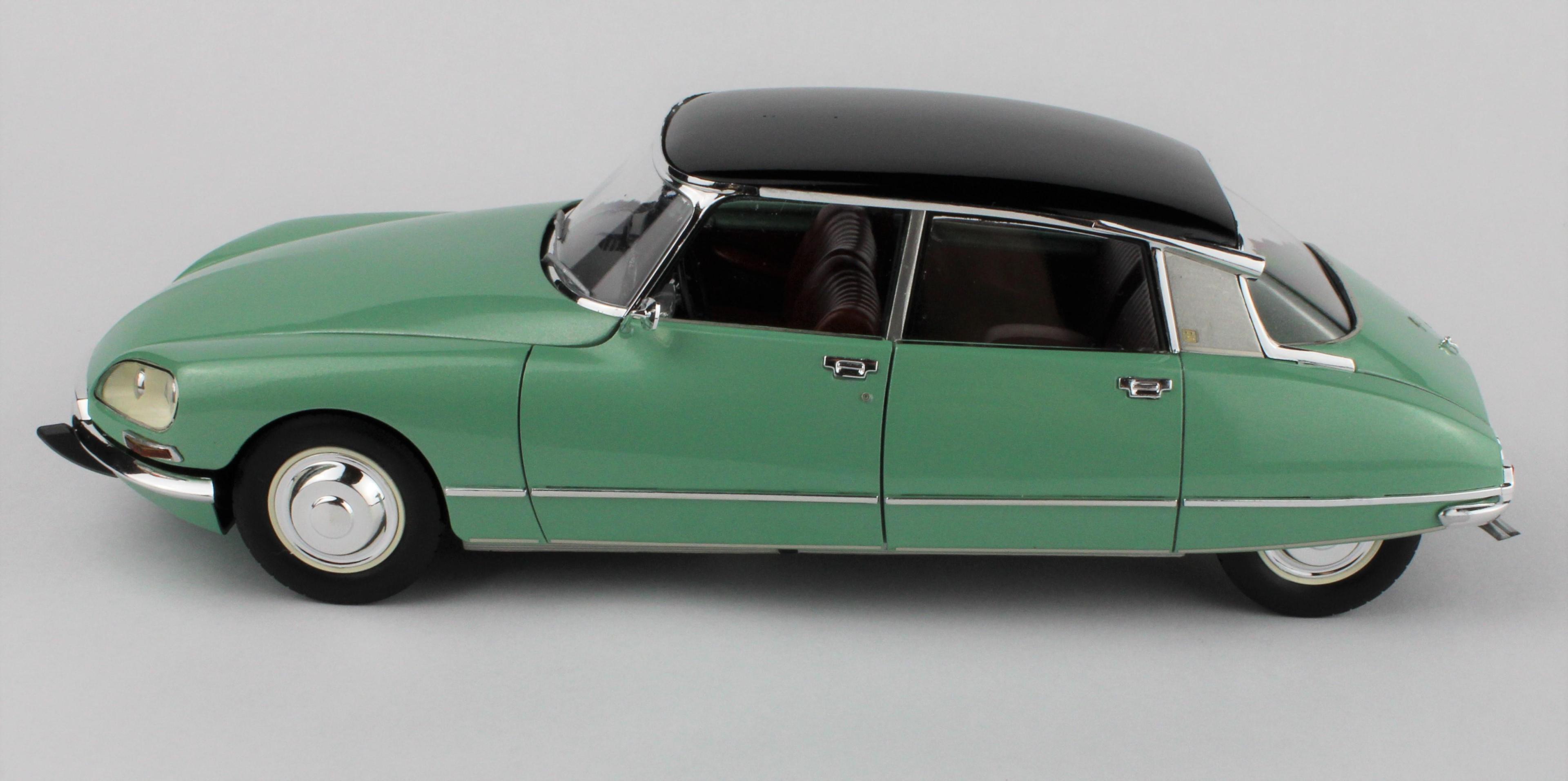

Much like the 1:1 DS21, the Ebbro kit is an update of their DS19 kit with an updated engine, interior (sort of) and body. It's a fairly intimidating kit when you open the box... parts are as scale-thin as possible, the front doors open and the chrome tree features nearly all of the chrome trim molded as thin separate parts. The remaining chrome trim, as well as the gold badges, are foil "wet transfers" that are applied like waterslide decals but feature a grippy adhesive that gives you seconds of working time before they become basically part of the model.

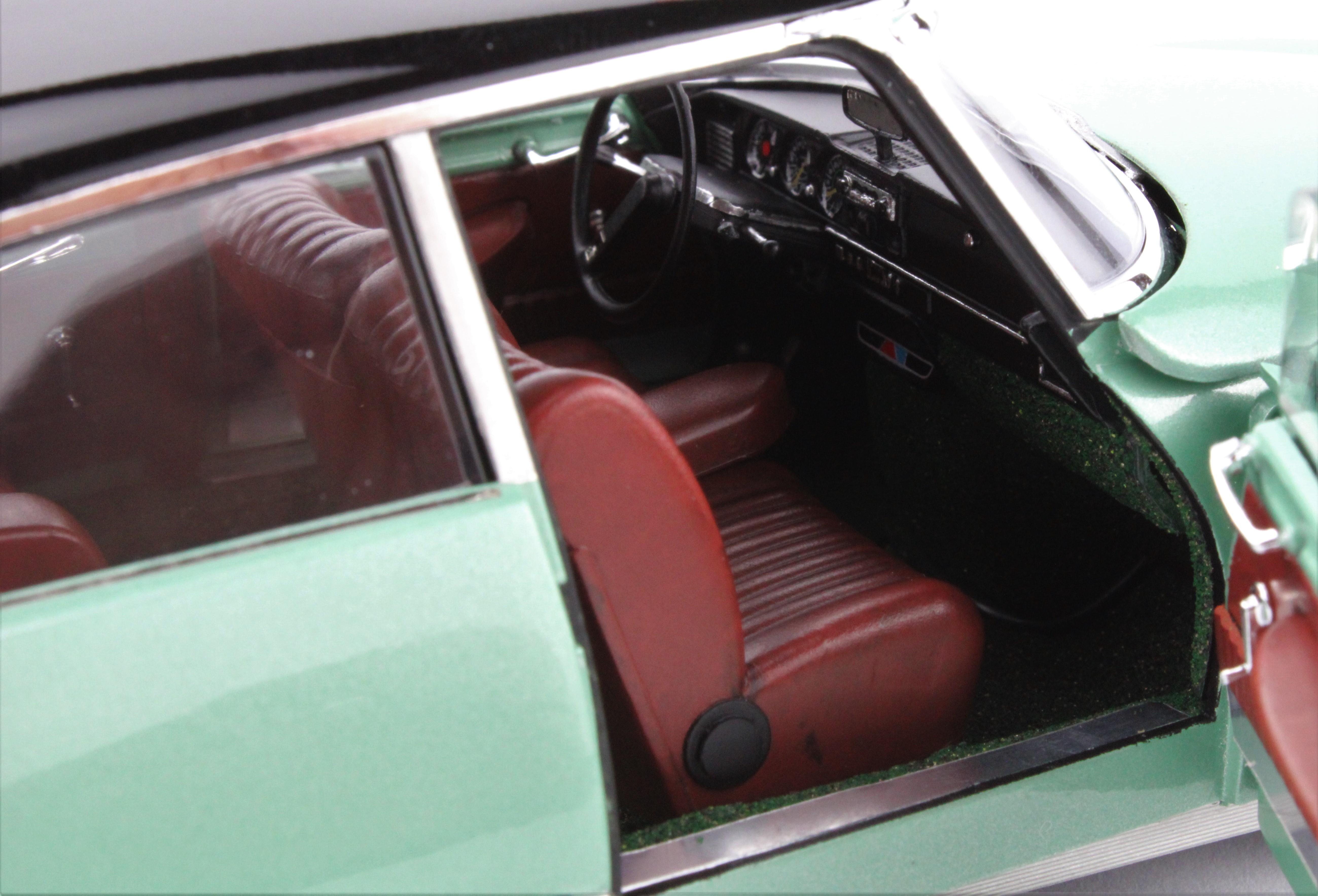

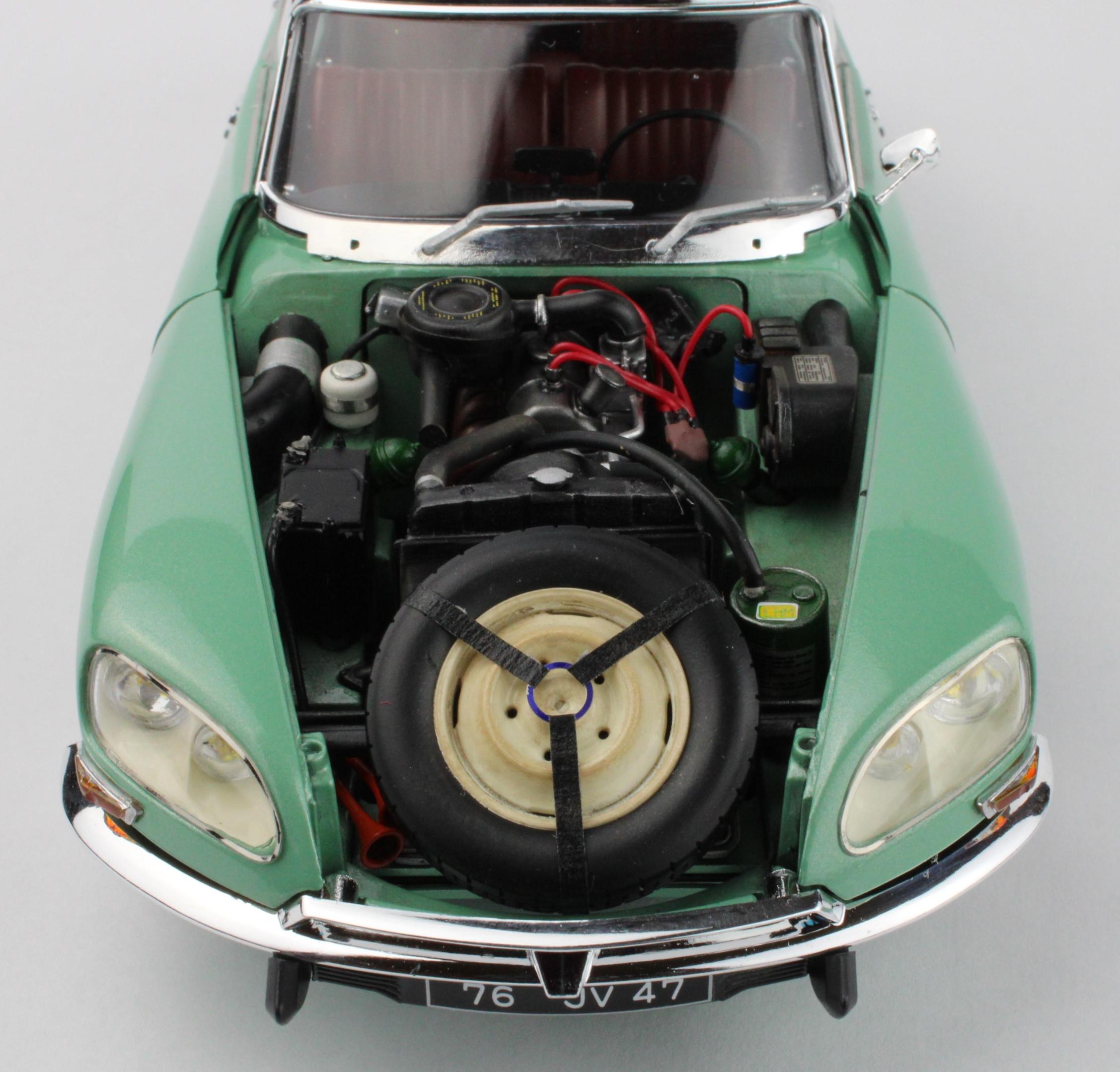

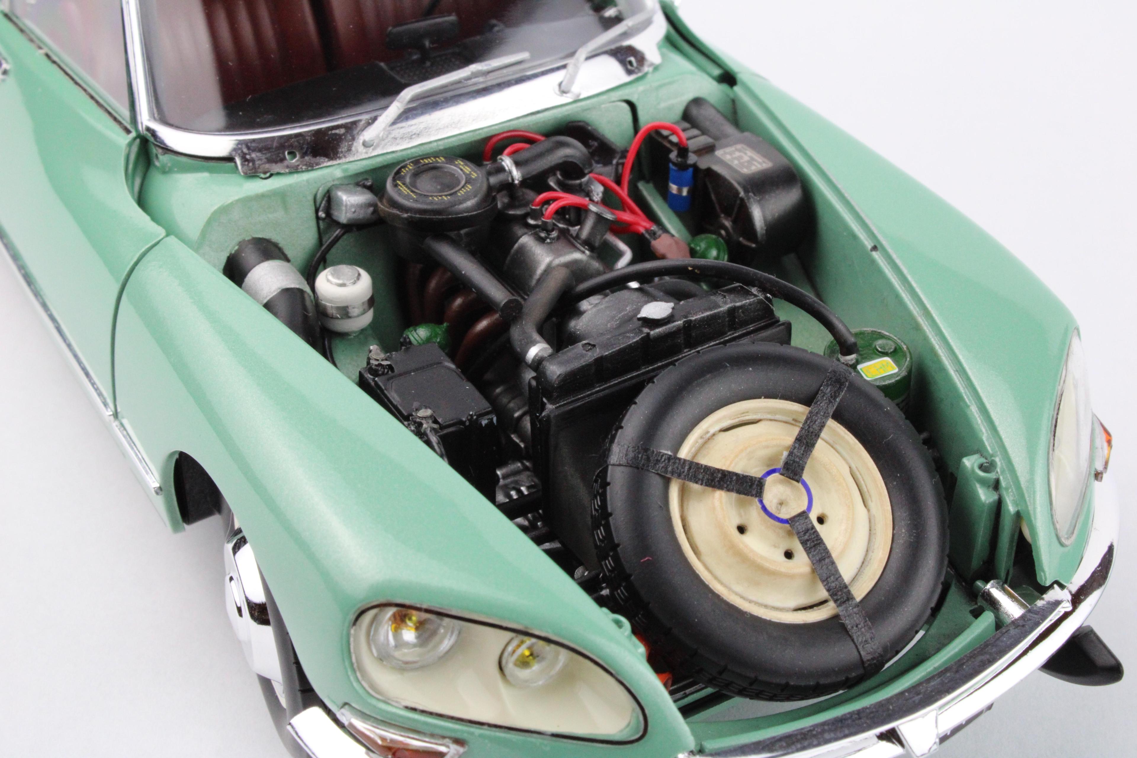

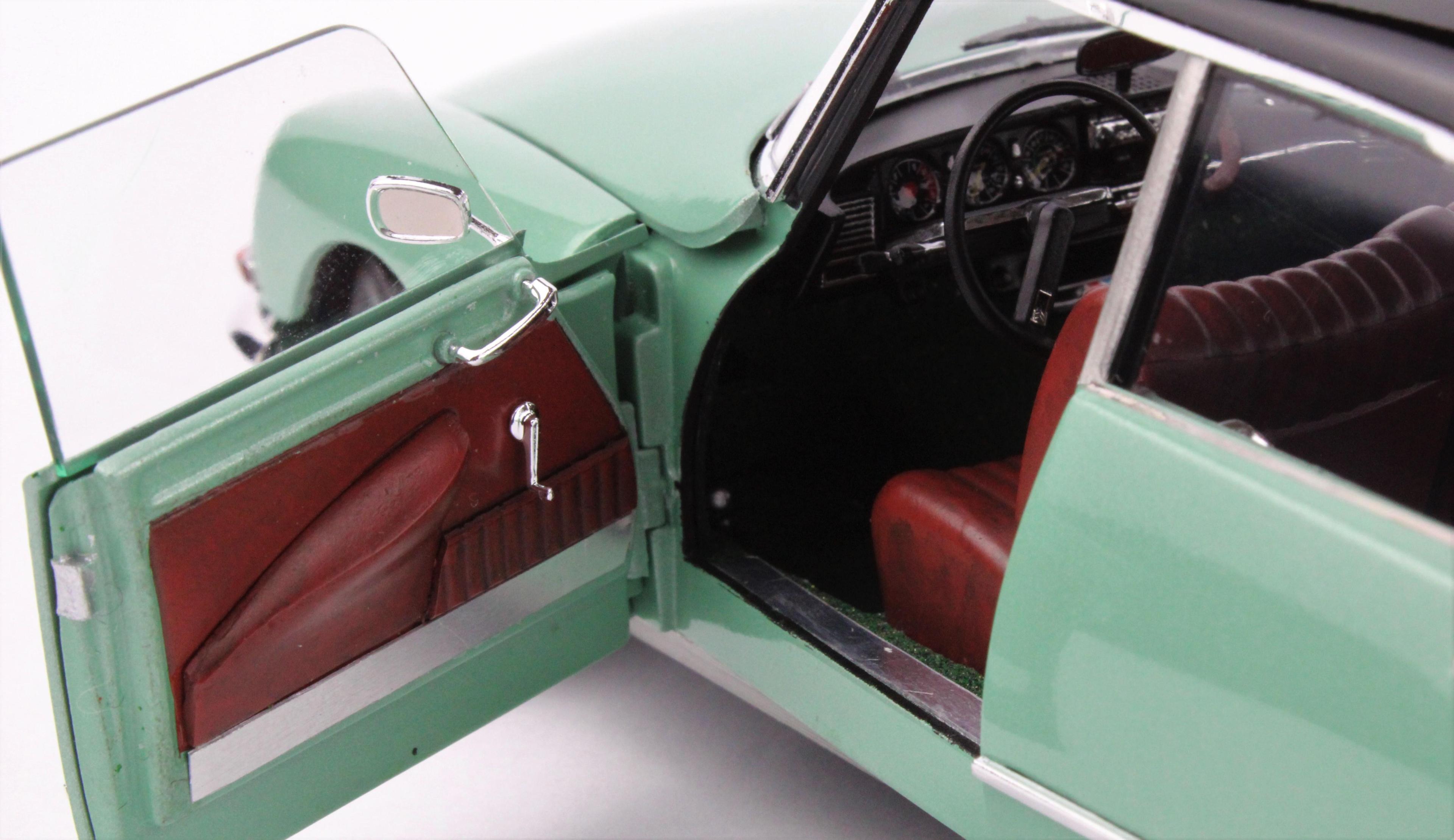

There's very little on this model that didn't come in the box. I added some scratchbuilt details to the door cards to better represent a DS21, aluminum sill plates on the interior, and custom-mixed embossing powder for the dark green carpet. I also added styrene pieces for the seat adjustment mechanisms. Under the hood I added scratchbuilt hold-down straps for the spare tire and a partially-scratchbuilt distributor with Albion Alloys tubing and Tamiya Epoxy Putty.

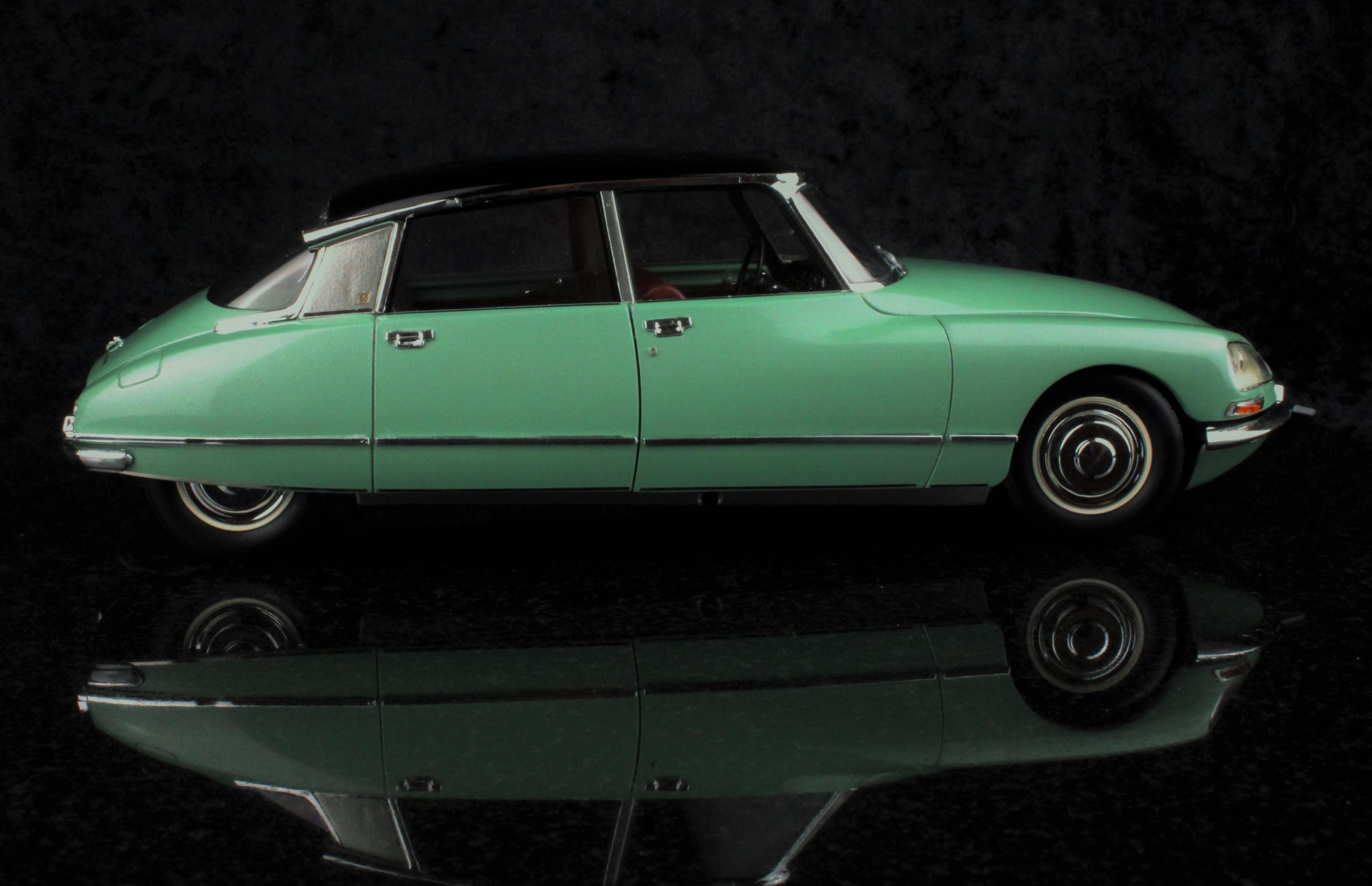

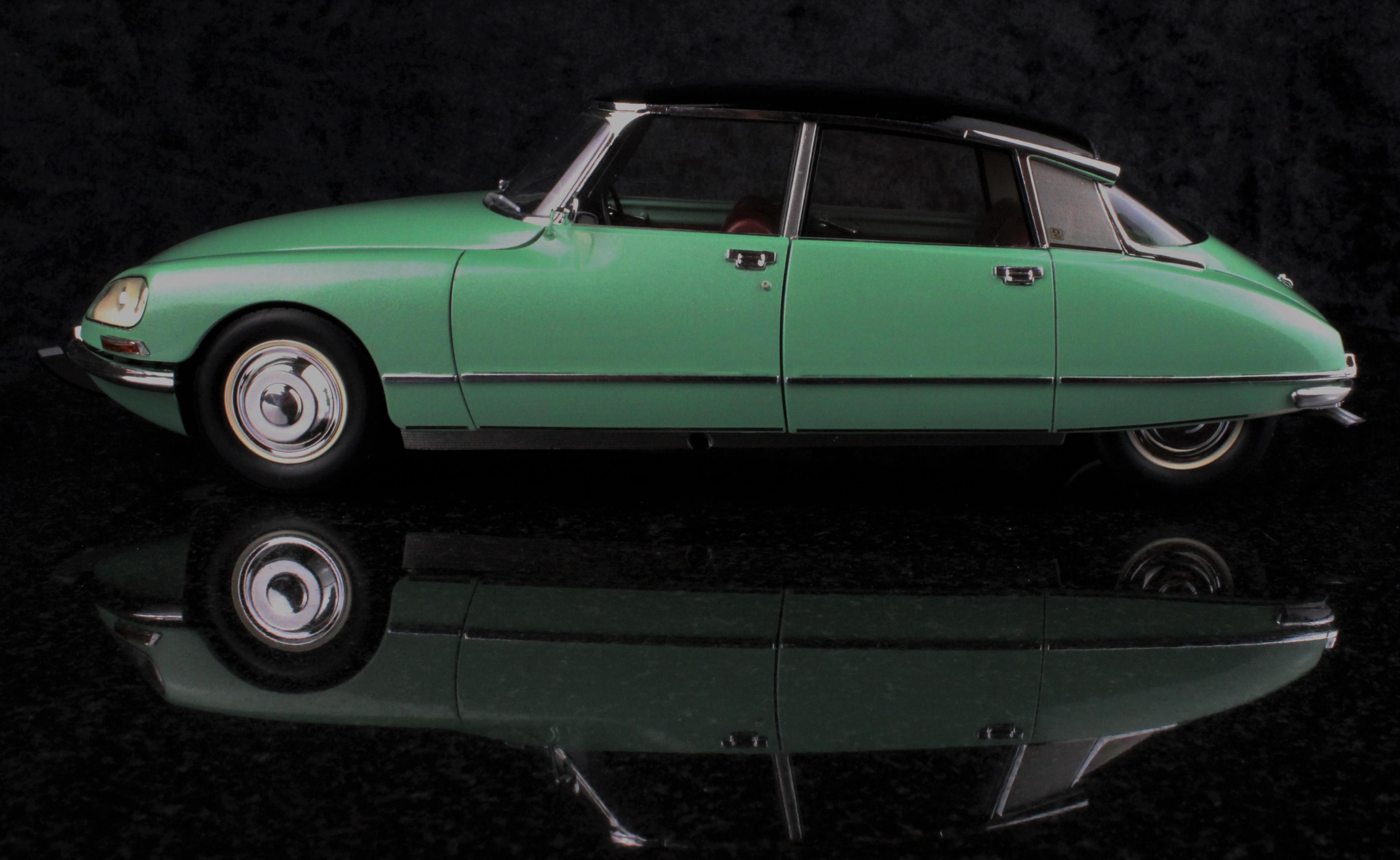

Paint is Tamiya TS60 Pearl Green over grey primer. This looks pretty close to Citroen's Vert Argent color. I used Tamiya Red Oxide primer with Vallejo washes and a satin clear coat for the cognac upholstery.
This was an incredibly enjoyable build overall. It's not an easy kit, but it went together beautifully (check my build thread in WIP for in-progress pics and tips) and really builds into a nice replica. I highly recommend it for anyone looking to build something a little different. On to the pics!

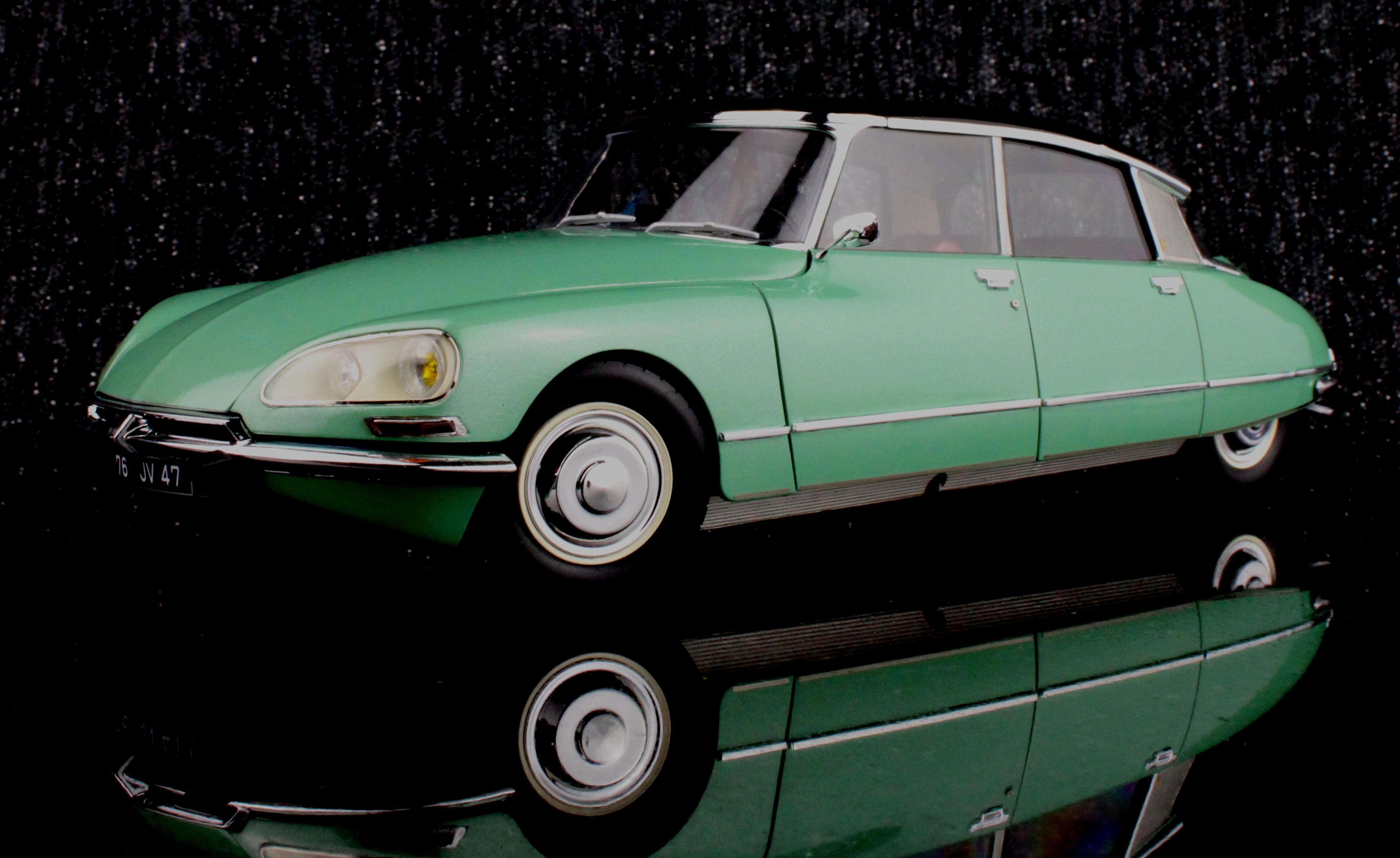

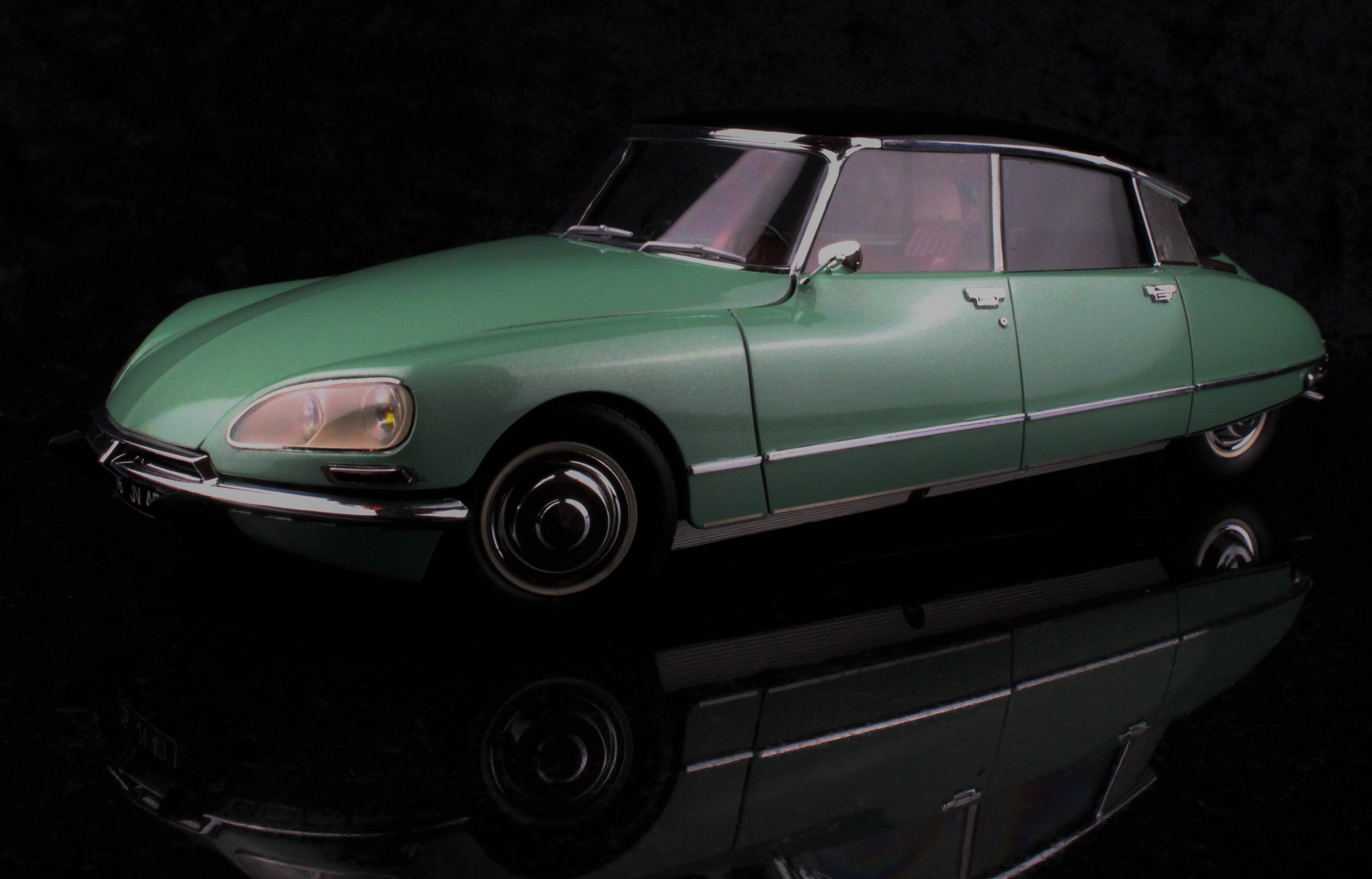

That’s absolutely lovely, Jason.. A stunning build of a beautiful car, fabulously photographed. It could be the real thing in most of the pictures, save for having the cleanest engine bay any DS has ever had in the world… Fantastic job… congratulations.

Thanks Matt, the pics against the white background needed no editing whatsoever beyond cropping but the dark background required judicious use of photo editing software. That engine bay is maybe a little too tidy, I used some washes and Tamiya pastels to give it the "well-kept driver" look. I was tempted to give the model a more weather beaten look with mismatched panels, missing trim, etc. but I just couldn't bring myself to do it. Maybe if I get my hands on a DS19 some day...

Superb work. Flawless, really. That chrome is amazing. Did you do anything special with it?
Thanks man! This kit had some of the nicest chrome I've ever seen. I touched up attachment points with Molotow and used Molotow on the ends of the rear bumper where I had to sand down some mold lines. Other than that, it's all kit chrome.
