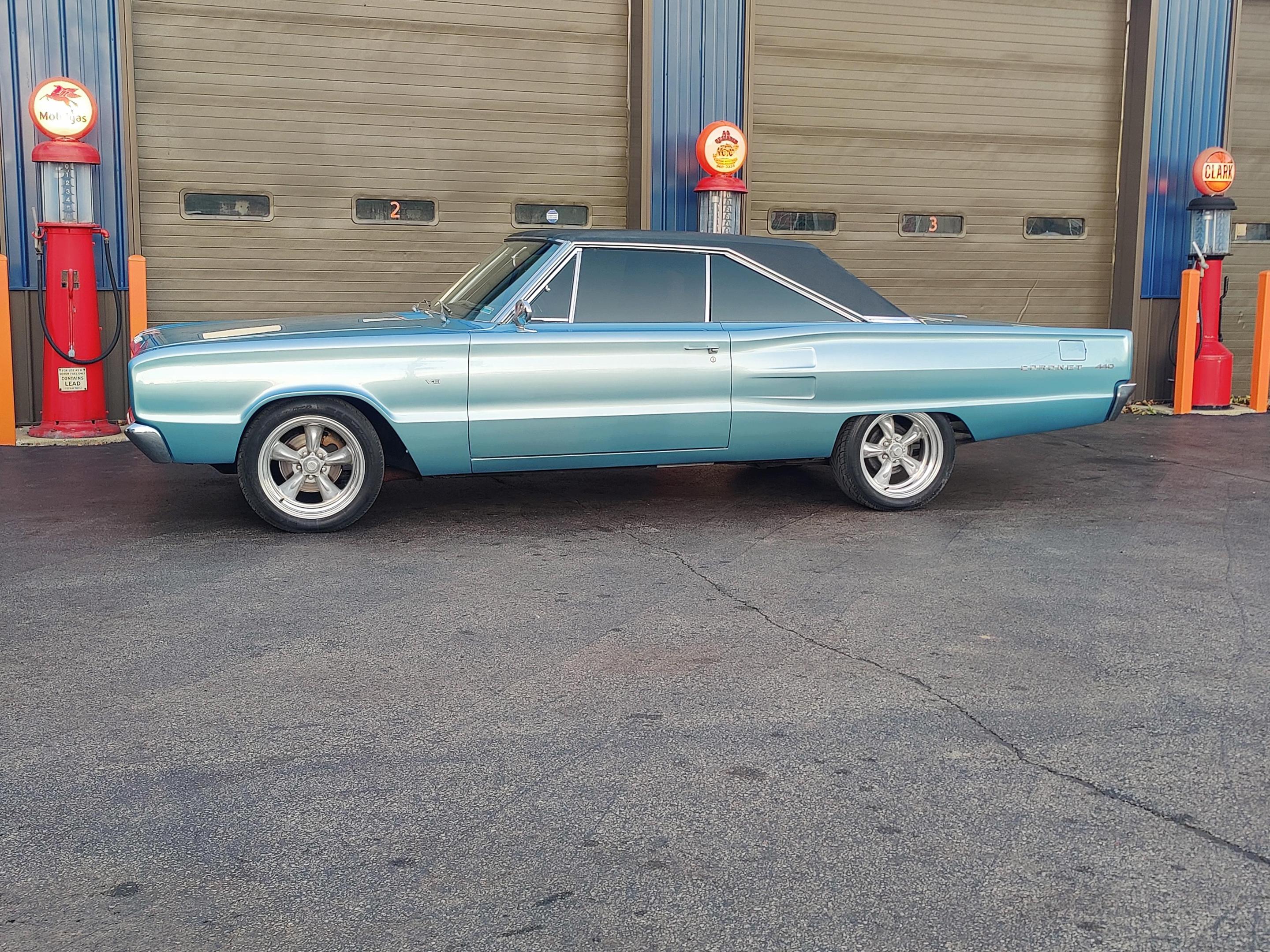

I have a 67 Coronet 440. I'd love to build a model accurate to my car. This is the closest example I've seen so far.
This is a picture of my car the day I picked it up from paint a few weeks ago.
Now you can see why I am so interested in this thread.
  • Like 2
