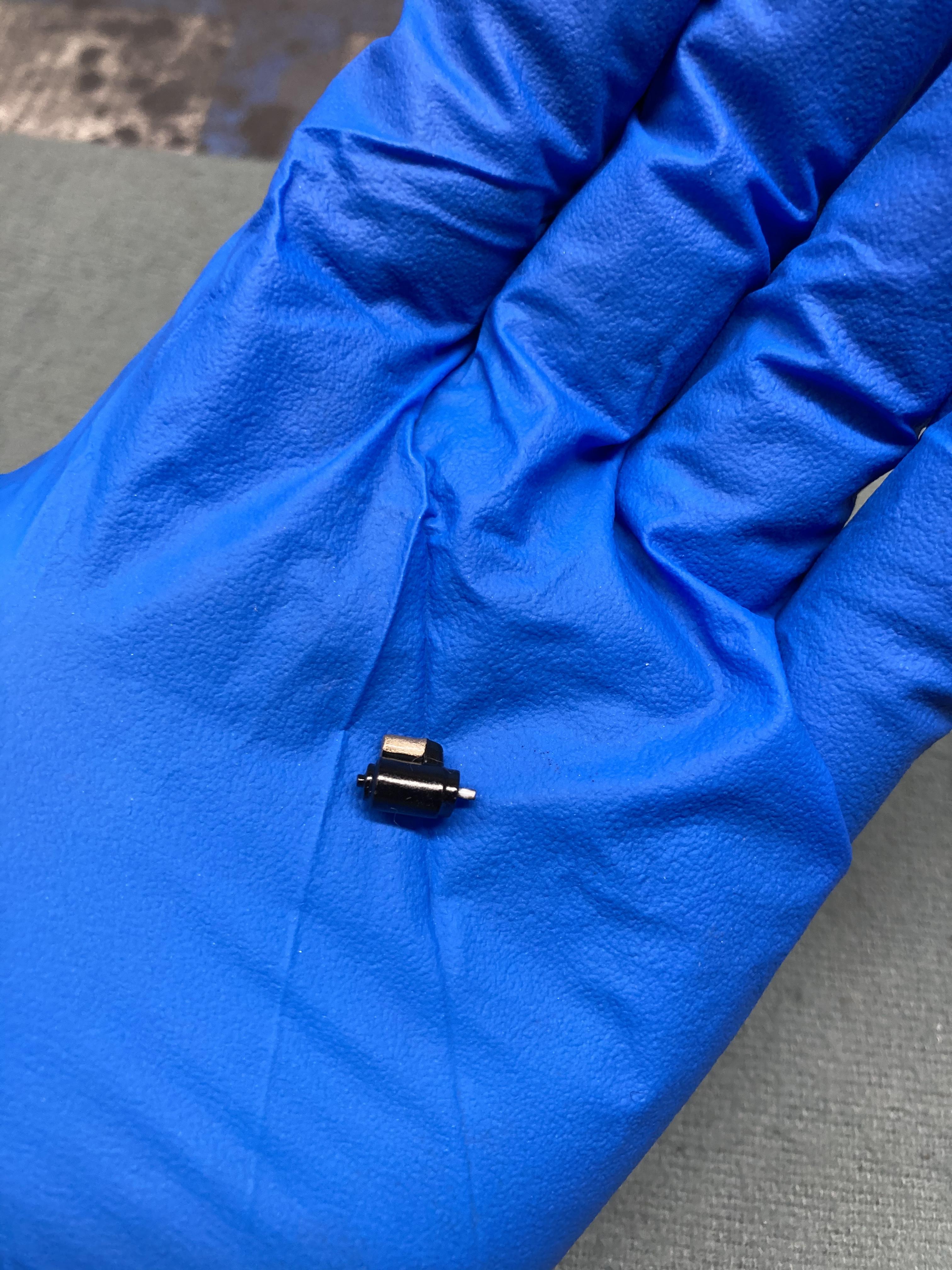

StevenGuthmiller Posted March 9, 2023 Posted March 9, 2023 If you’re airbrushing enamel, you can speed up drying time exponentially by thinning with lacquer thinner. As an example, I sprayed this oil filter and starter with enamel thinned with lacquer thinner Tuesday night. I added the decal to the oil filter, and painted the starter solenoid, (with Testors enamel) yesterday, and then sprayed a coat of Testors clear lacquer over both this morning. Both are easily dry enough to handle this afternoon. Steve 1
