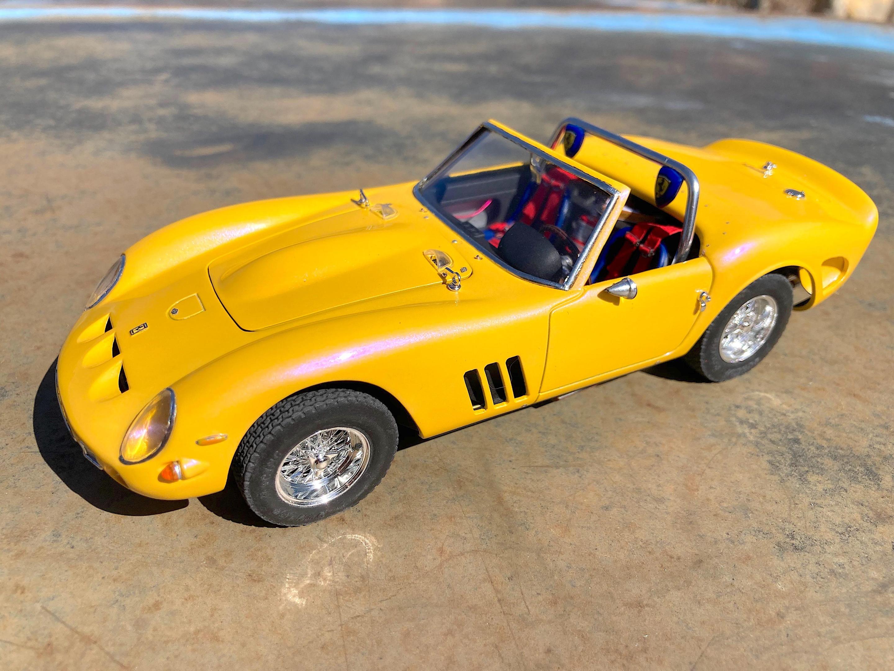

89AKurt Posted March 10, 2023 Posted March 10, 2023 Of course I will have to lurk for this build. Built it recently with slight modifications. ? I added the third vent. I have the Protar kit, also the Gunze without the engine.
Ace-Garageguy Posted March 10, 2023 Author Posted March 10, 2023 2 hours ago, 89AKurt said: Of course I will have to lurk for this build. Built it recently with slight modifications. Looks good topless, and in giallo. 1
