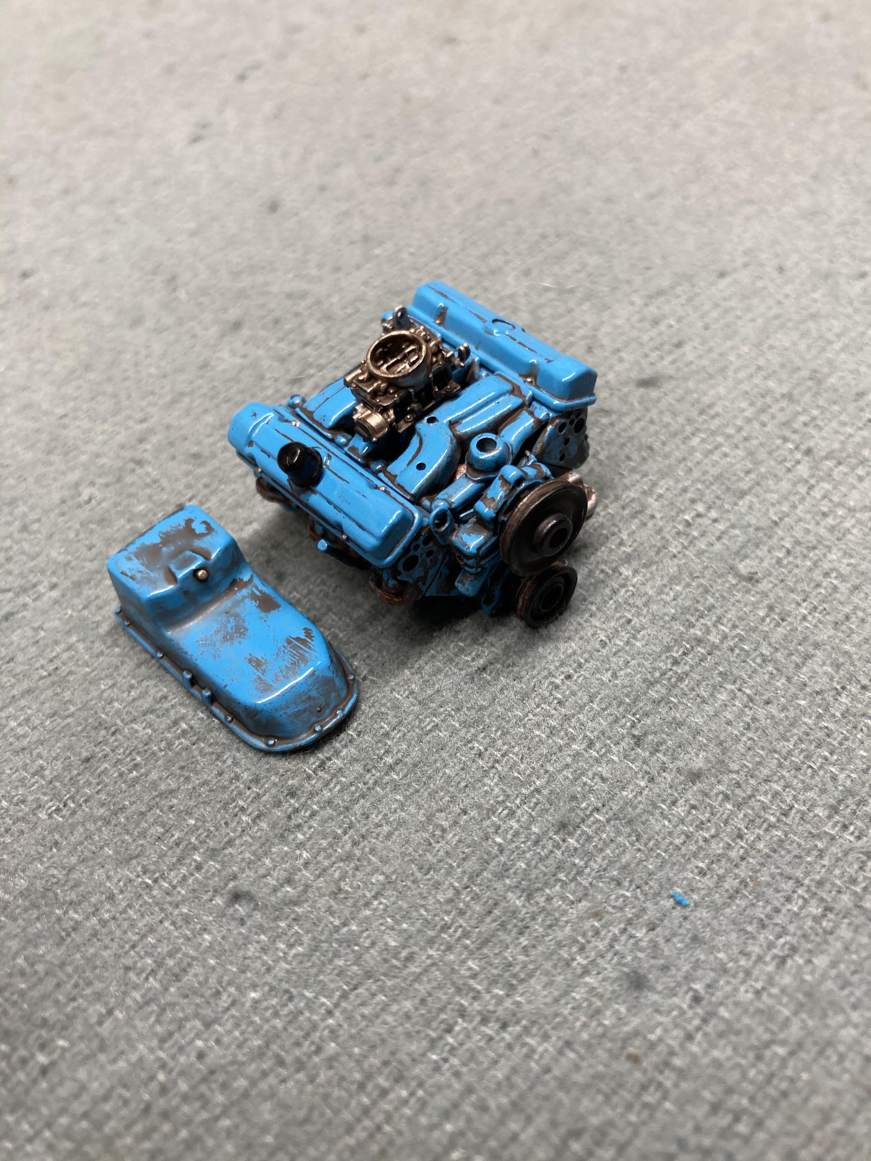

Dpate Posted March 13, 2023 Posted March 13, 2023 (edited) Yeah i wouldn't use oil paint and mineral spirits on lacquer unless you did a flat clear coat. I know oil paints thinned down as a wash works great on acrylics. In my situation a good example even though it's different from yours - would be like lets say a rim? In the picture below what i would do in that situation would be paint the rim silver lacquer basecoat, and than an acrylic black like tamiya on top. Once dry you would take acrylic thinner on a q-tip, and slowly remove the black on the edges leaving just the silver. Is this bout the same idea you're asking about with compatibility? I know enamel thinner doesn't hurt lacquer long as you're easy with it. If i was that unsure I'd do a test spoon done in lacquer, and start doing little bit of weathering on it with the oil paint n spirits. Sorry I'm just not to sure about all the compatibilities there are when it comes to weathering. Edited March 13, 2023 by Dpate

Dpate Posted March 13, 2023 Posted March 13, 2023 (edited) 31 minutes ago, ctruss53 said: The example I am thinking of is I saw on youtube where someone thinned down oil paints with mineral spirits and then brushed it on as a wash to bring out details and add a little weathering. But in this video he was not specific about what type of paint he was doing this over. So I was asking about compatability so I would know what type of paint I can do this on top of. Based on your post, it sounds like this would work on acrylics, but not on lacquers? Mineral spirits would dissolve the lacquer paints I'm assuming? Yes I've seen it done on a plane propeller doing a wood grain finish with acrylics, and than took and made a oil paint wash, and used that over the propeller. I would be in the same boat as you as i only use automotive lacquers for car bodies. I'm not sure how fast it would dissolve, but it would damage the finish for sure. Most of the weathering i see done on lacquer is using either enamel or acrylic based washes etc. You can't use try other products or you just prefer oil paint weathering? I think the only way mineral spirits would be safe on lacquer is if it's done over a clear coat. You could try turpentine to thin the oil paint because turpentine wont dissolve lacquer, but i would test on something first. It's safer on lacquer than spirits, and would soften it a little, but i wouldn't dissolve it like spirits would. Edited March 13, 2023 by Dpate
