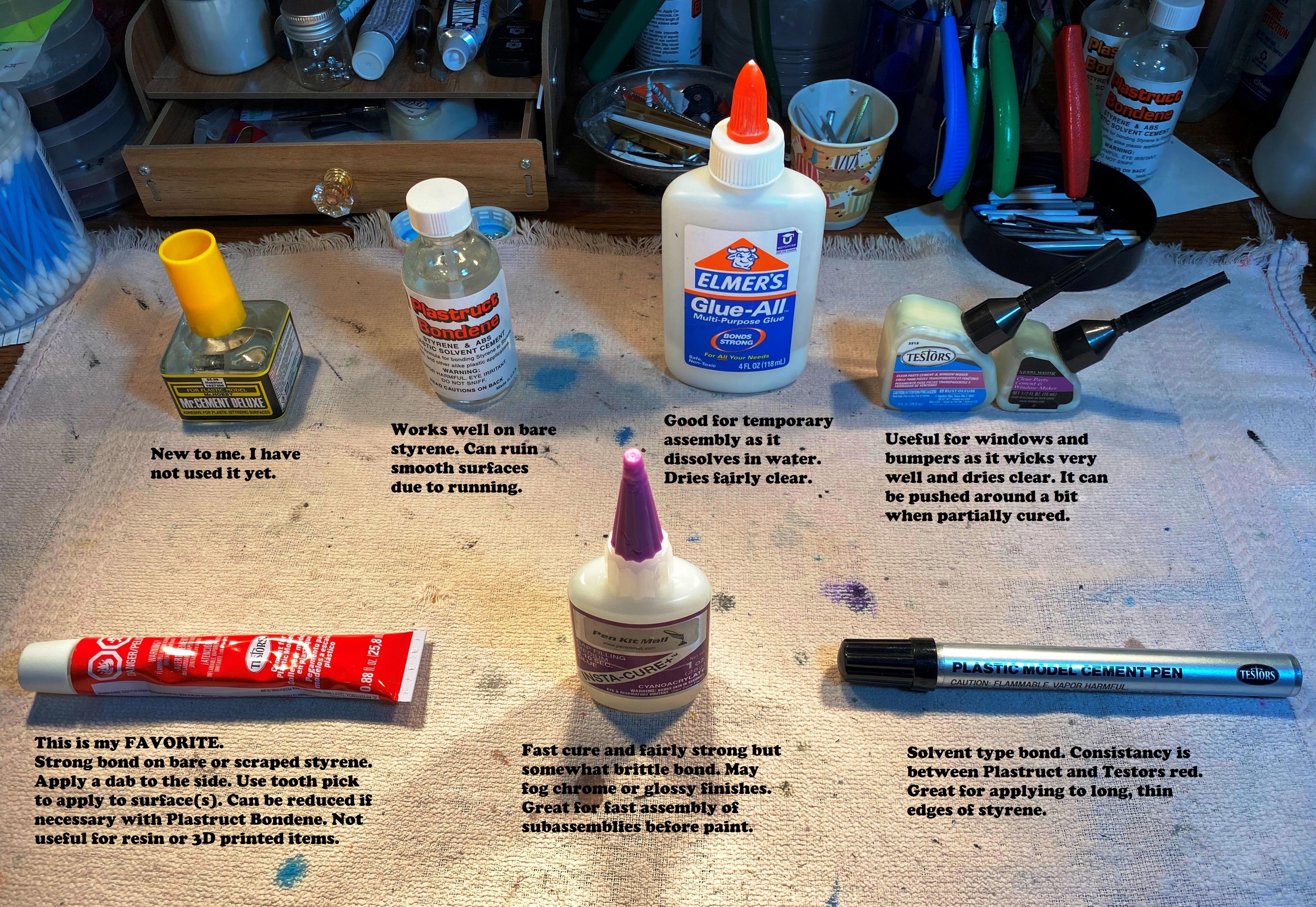

Bills72sj Posted March 16, 2023 Posted March 16, 2023 I have a number of glues I use. I tend to avoid direct adhesion on painted surfaces. I almost always scrape the surfaces to be joined down to bare plastic. Except for photo-etch onto painted surfaces. For that I use Future/Pledge floor finish. Below is my arsenal. I have heard clear 2 part epoxy works well but have not gone down that path.
