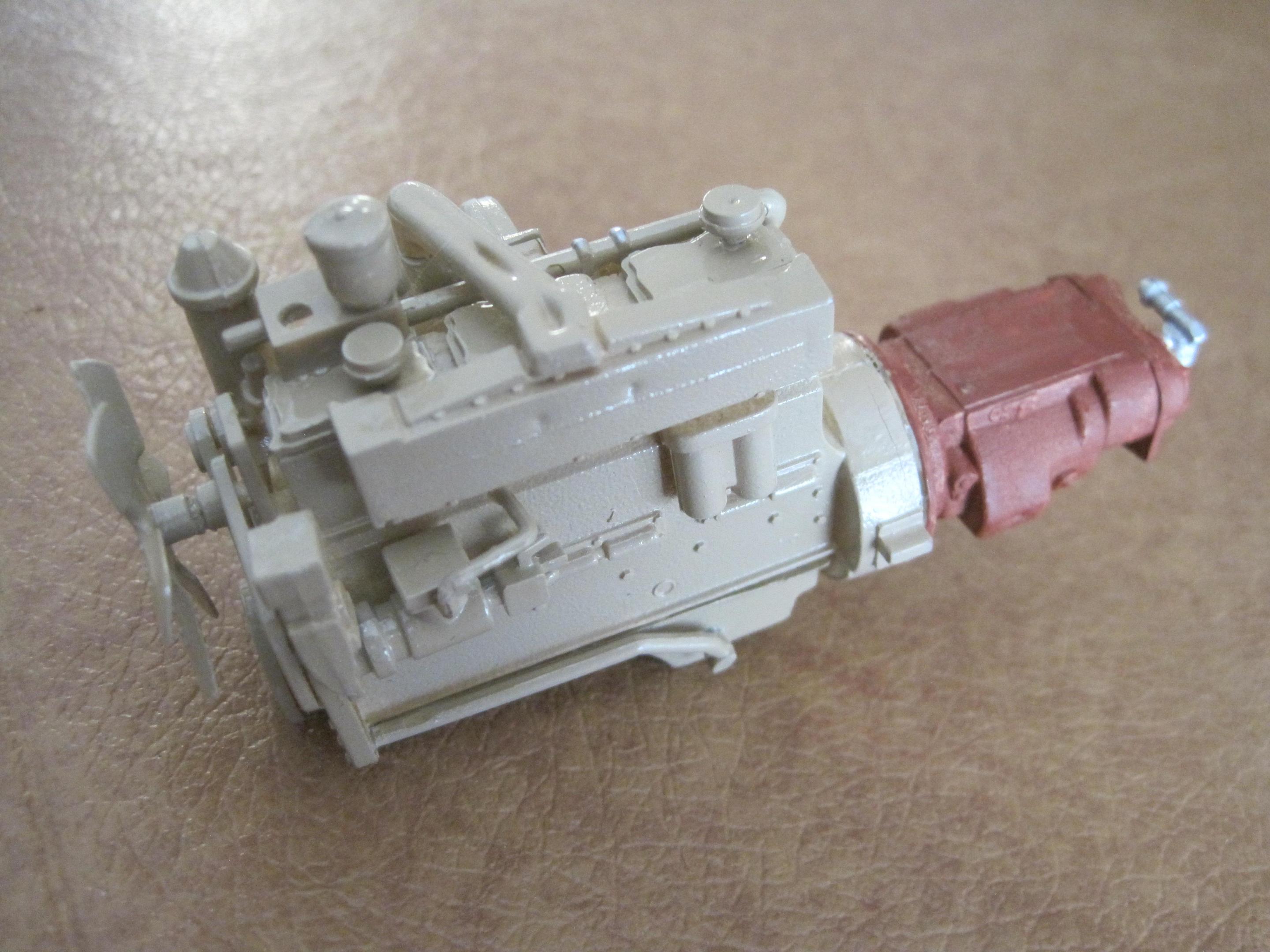

leafsprings Posted March 18, 2023 Posted March 18, 2023 (edited) I chose the Revell version for the best candidate for the Movin' On KW group build. It will require kit bashing from several kits to get it as close as possible. The short hood is the most obvious and noticeable piece, but everything else is powertrain, suspension and wheel modifications. Based on the second season, will need to add a Cummins 6 cylinder engine, torsion bars suspension and 22" wheels and tires. Edited March 18, 2023 by leafsprings 1

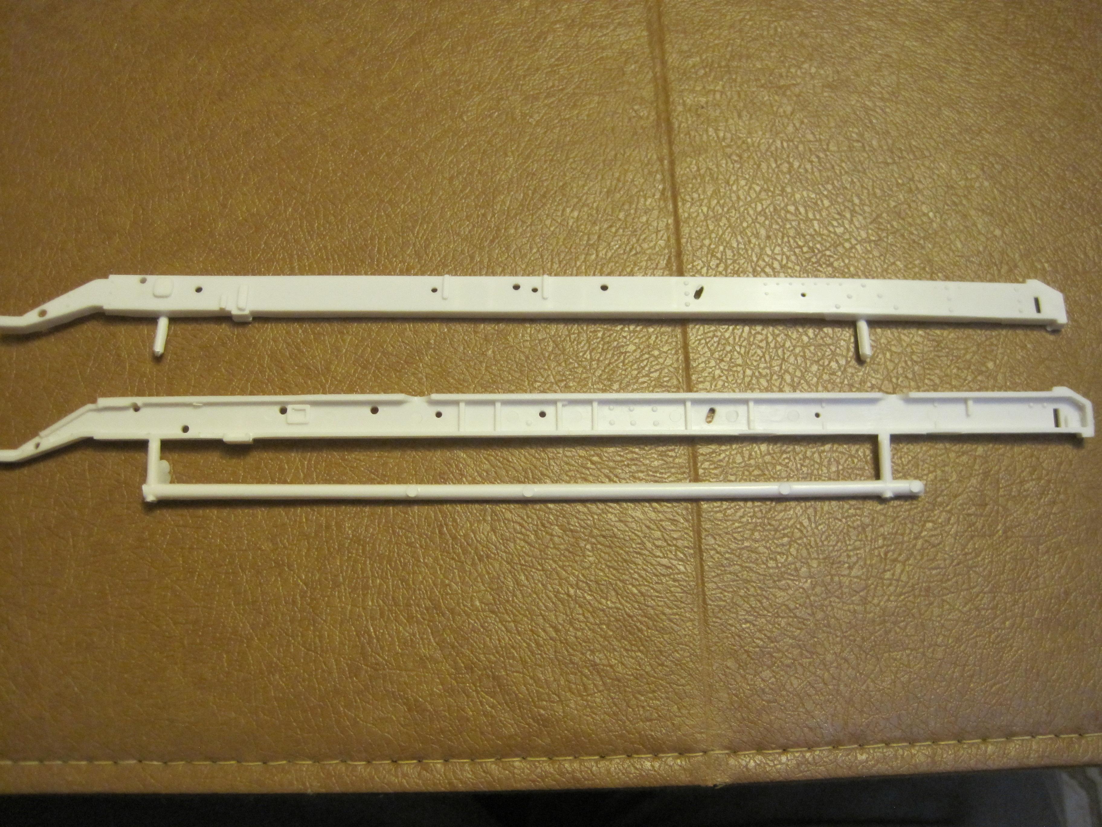

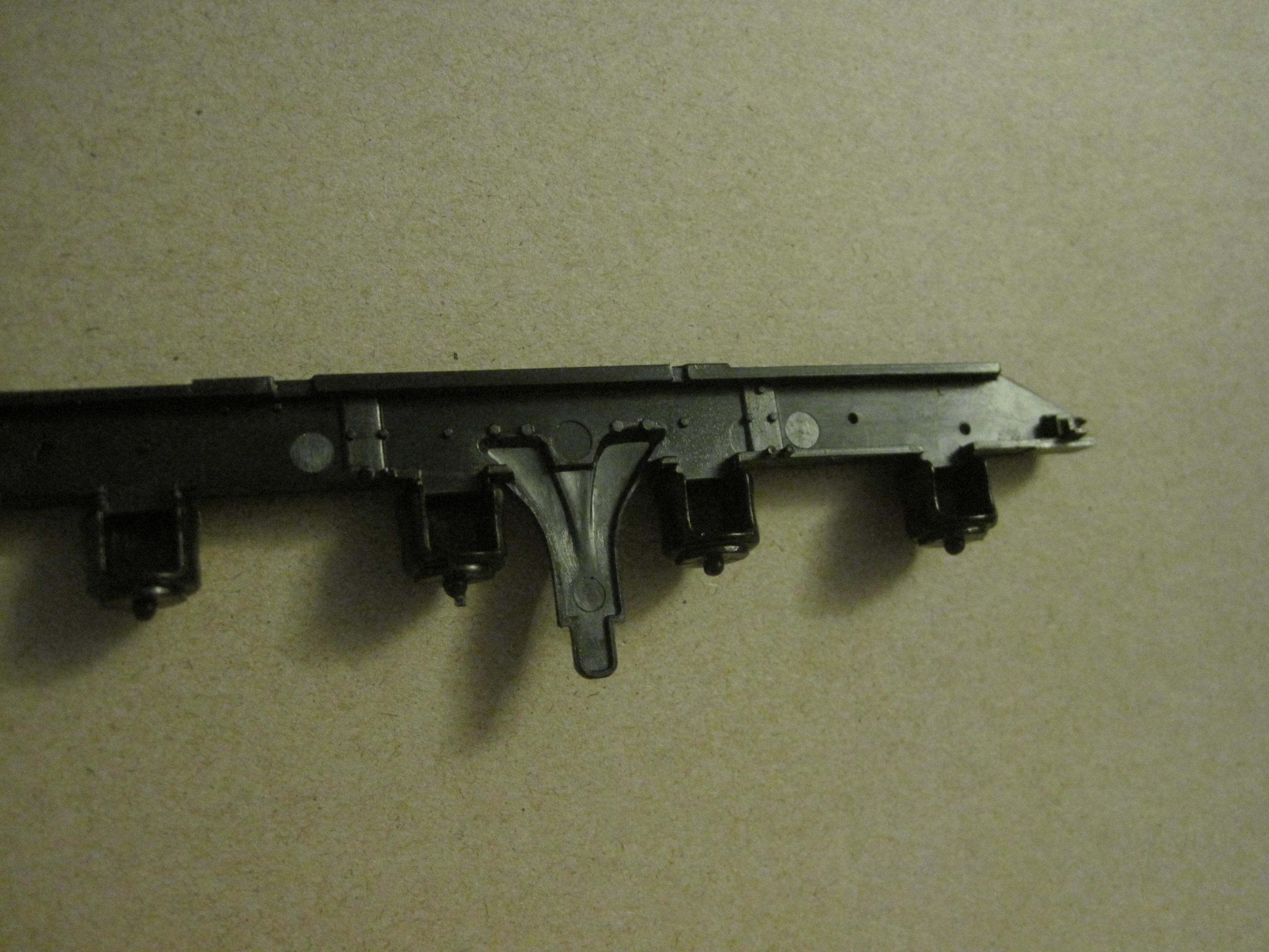

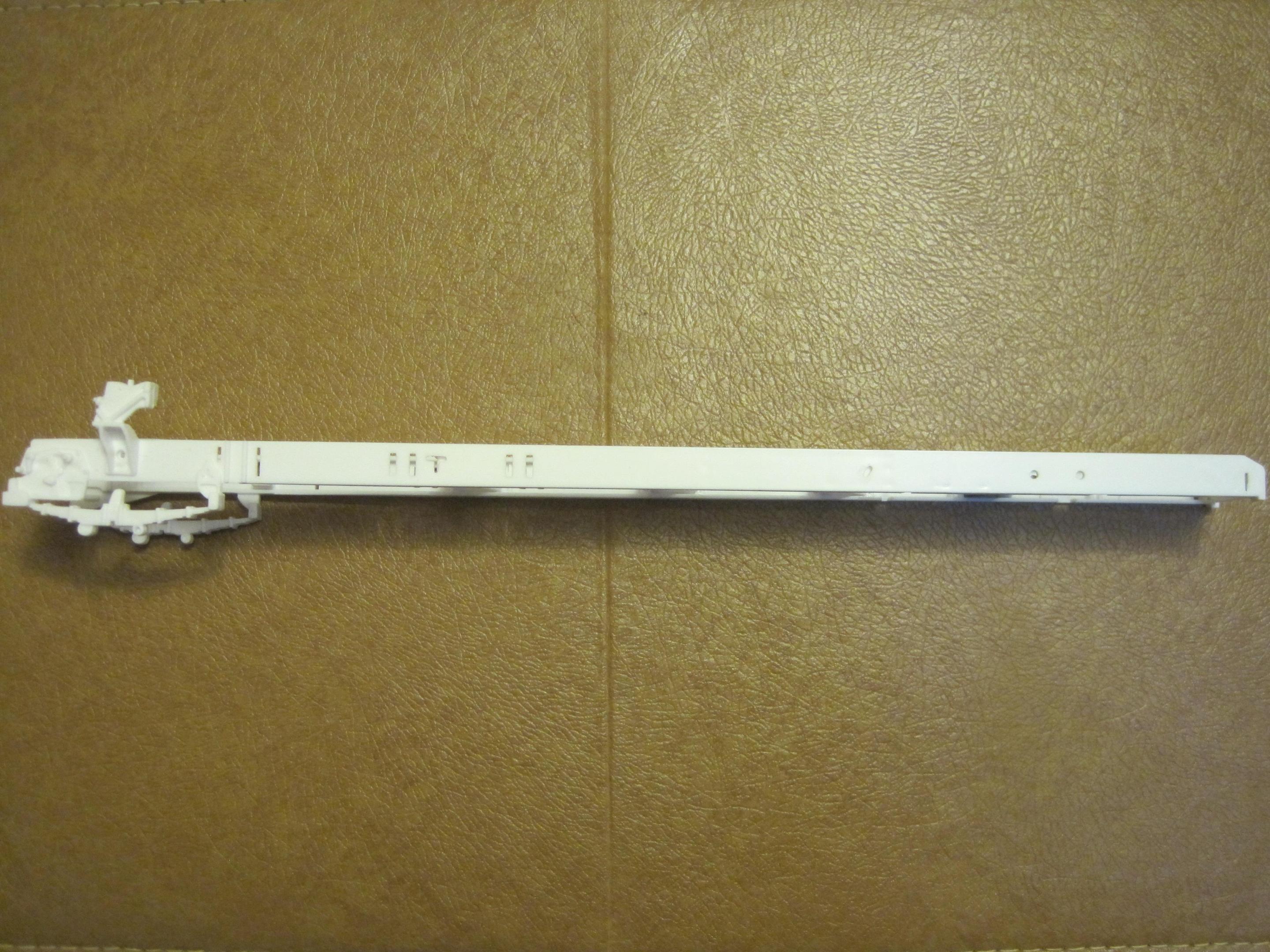

leafsprings Posted March 19, 2023 Author Posted March 19, 2023 Thanks for the encouragement! Now that I'm looking at the project a little closer, the suspension change will be more involved than previously thought. The Revell frame rails are not clean, they have airbags and center beam molded into them. Removing them will be very difficult and leave large opening gaps in lower frame rail. Looking at using a donor KW AMT frame now. 2

leafsprings Posted March 23, 2023 Author Posted March 23, 2023 (edited) Thanks for the link Russel, never seen it before. Trying to gather as much knowledge from the members on this forum on the Movin On KW. Member Force has been very helpful in his research on KW's used in Season 1 and Season 2. I agree about the current KW, shouldn't really be used for reference, not historically correct. Have a much cleaner AMT conventional frame to mount torsion springs to, but the wheelbase will be too short due to the longer VIT sleeper. Cummins and Roadranger completed. Edited March 23, 2023 by leafsprings 2
DRIPTROIT 71 Posted March 23, 2023 Posted March 23, 2023 I shaved all of the air ride stuff off of the frame in my T800 dump. It was a real pain and took some repair. What about using the front section of the Revel frame and the rear section of the AMT?

Force Posted March 24, 2023 Posted March 24, 2023 18 hours ago, DRIPTROIT 71 said: I shaved all of the air ride stuff off of the frame in my T800 dump. It was a real pain and took some repair. What about using the front section of the Revel frame and the rear section of the AMT? I was planning to do just that on my build when I get to it, splice in the rear section of the AMT chassis to the Revell AG front section.

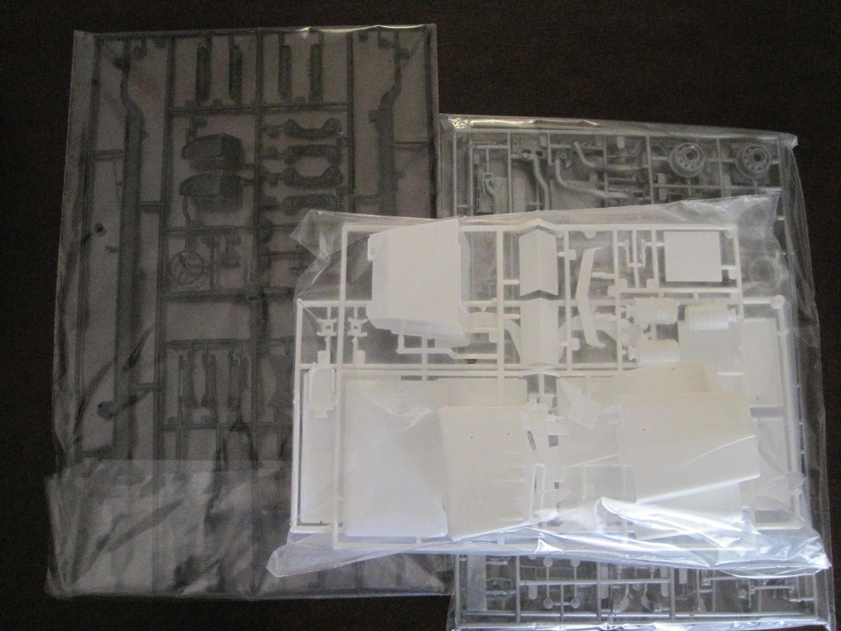

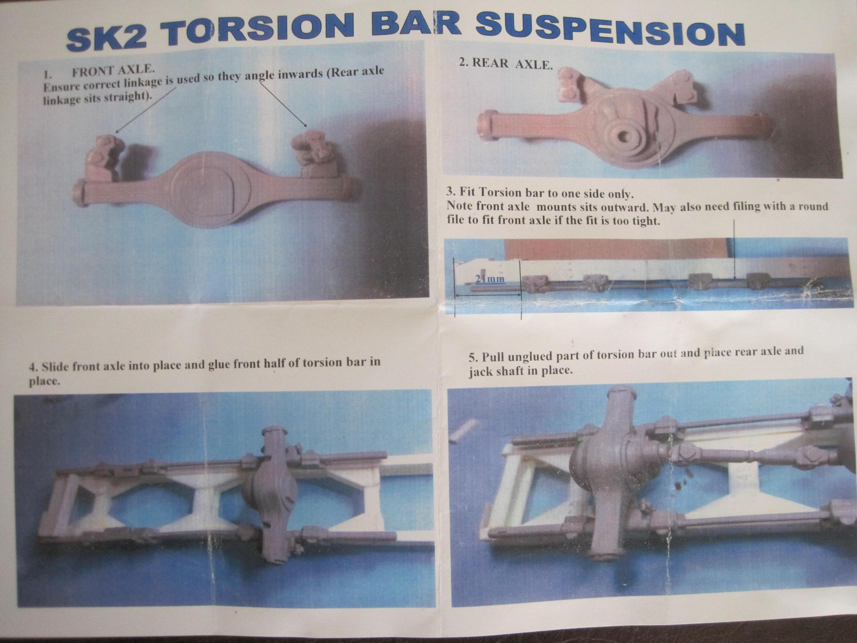

leafsprings Posted March 25, 2023 Author Posted March 25, 2023 (edited) On 3/23/2023 at 12:34 PM, DRIPTROIT 71 said: What about using the front section of the Revel frame and the rear section of the AMT? Looked at that possibility and noticed the Revell frame is more narrower than the AMT frame, almost as if it is molded in smaller scale. Have another AMT KW cabover frame that I can use as a donor for the conventional frame stretch. Resin Auslowe torsion bar suspension will be used, comes with nice instructions. Edited March 25, 2023 by leafsprings

Force Posted March 25, 2023 Posted March 25, 2023 7 hours ago, leafsprings said: Looked at that possibility and noticed the Revell frame is more narrower than the AMT frame, almost as if it is molded in smaller scale. It's funny, some people insists that the Revell Germany Kenworth W900 is 1:24th scale, yes some of the boxes of the different versions of this kit says 1:24th scale but all versions are based on the same kit bcause they did not do 2 different kits in different scales, and it really is 1:25th scale like it says on other boxes with versions of this kit. I covered all versions of the Revell Germany KW W900 kits in this topic back in August. I have not compared the chassis on the Revell and AMT kits but it could be like you say.

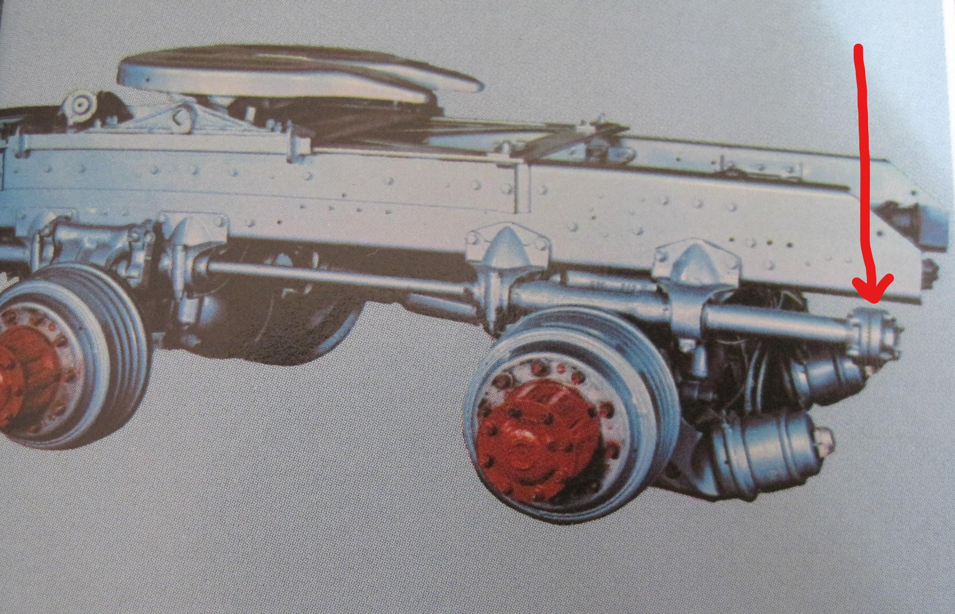

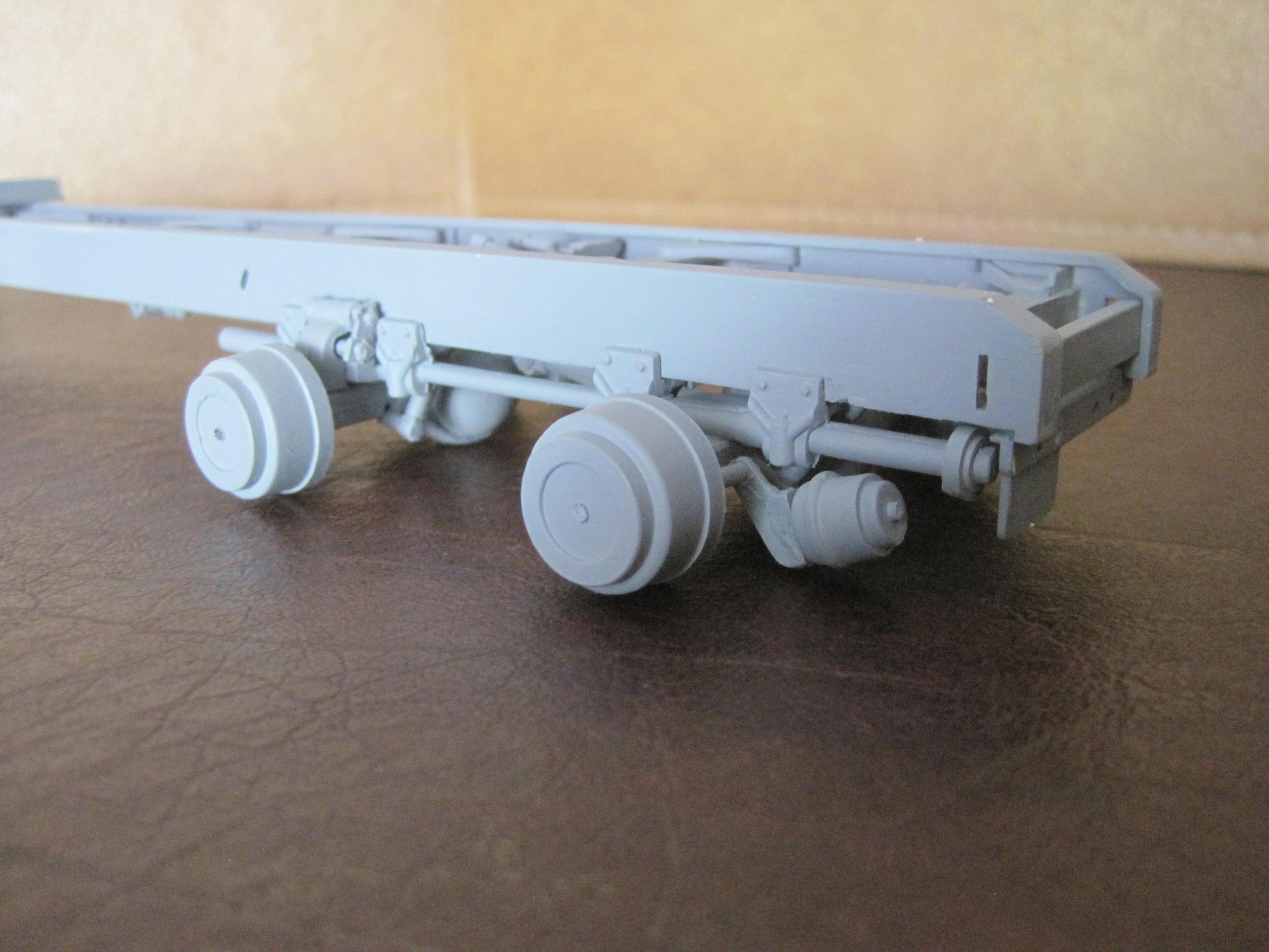

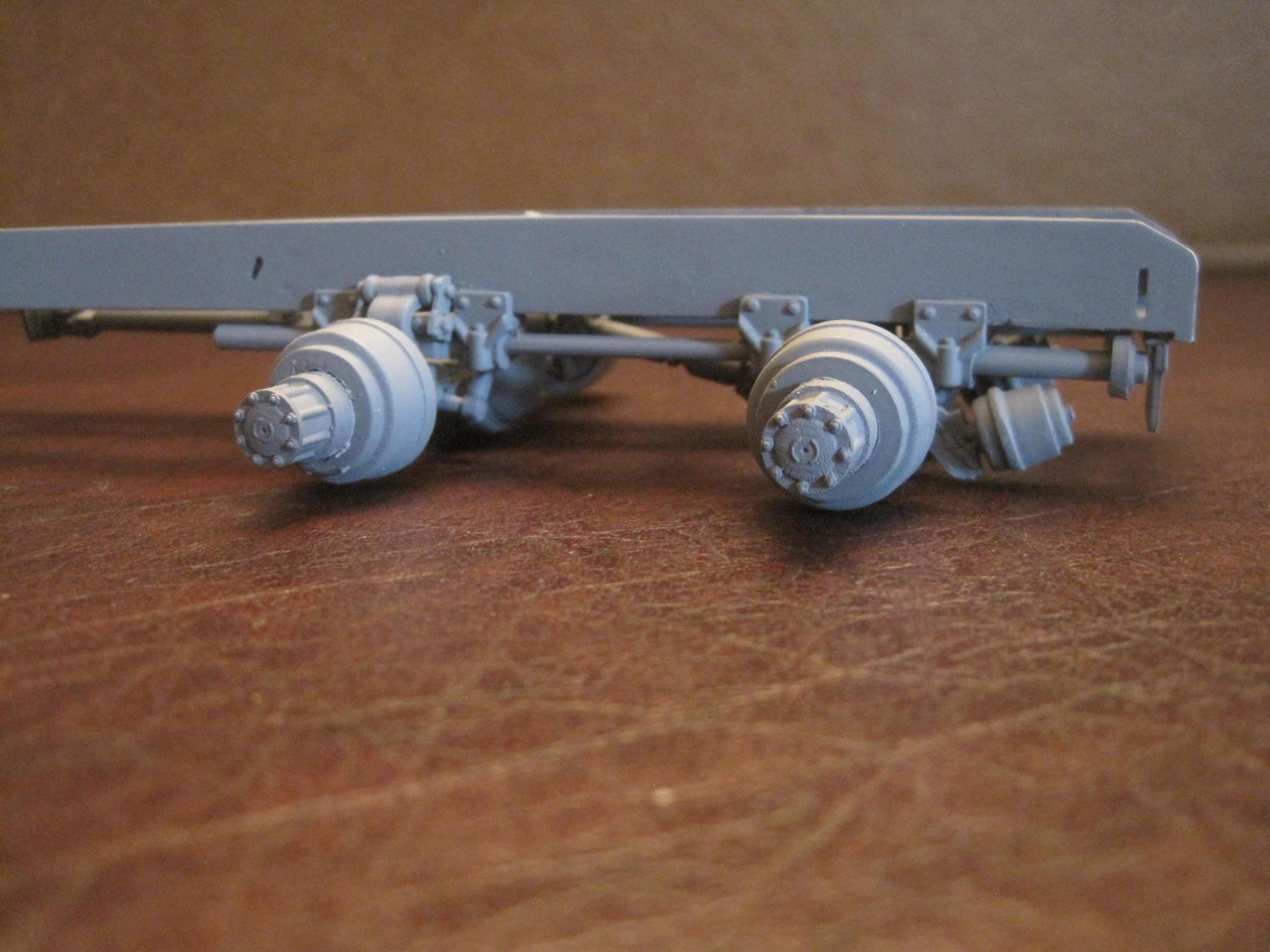

leafsprings Posted April 2, 2023 Author Posted April 2, 2023 (edited) Used the AMT frame for a more uniform and solid foundation to mount the torsion bar suspension, which was definitely more difficult to deal with than any other suspension system I've ever built, but luckily it was available in resin, original issue KW plastic would have been impossible to find. There is a donut missing on the end of the resin torsion bar conversion kit, had to fabricate something close, not sure if the AMT version had this part. Edited April 11, 2023 by leafsprings 2
Force Posted April 2, 2023 Posted April 2, 2023 No the end cap at the rear of the AMT torsion bar setup is not there, I have one W925 and one K123 originals with torsion bar suspension and I just checked. The aftermarket setup is easier to build than the original AMT setup.

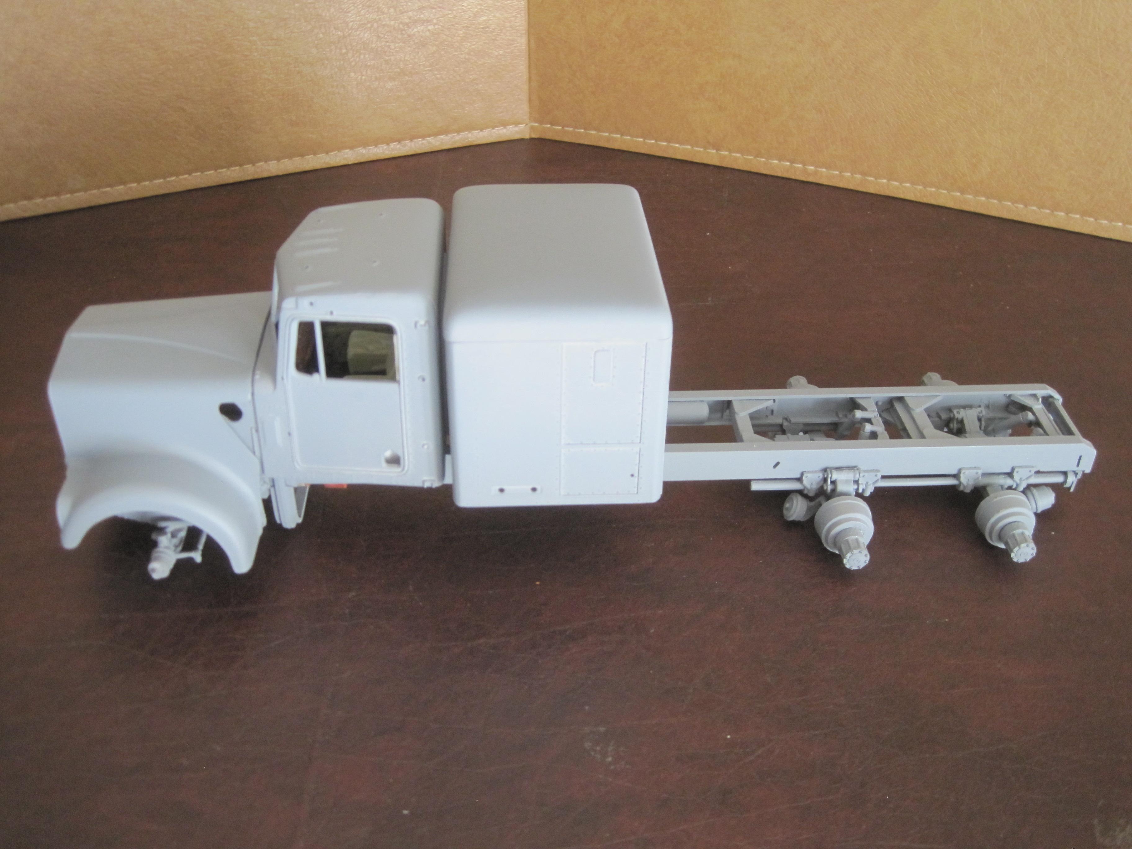

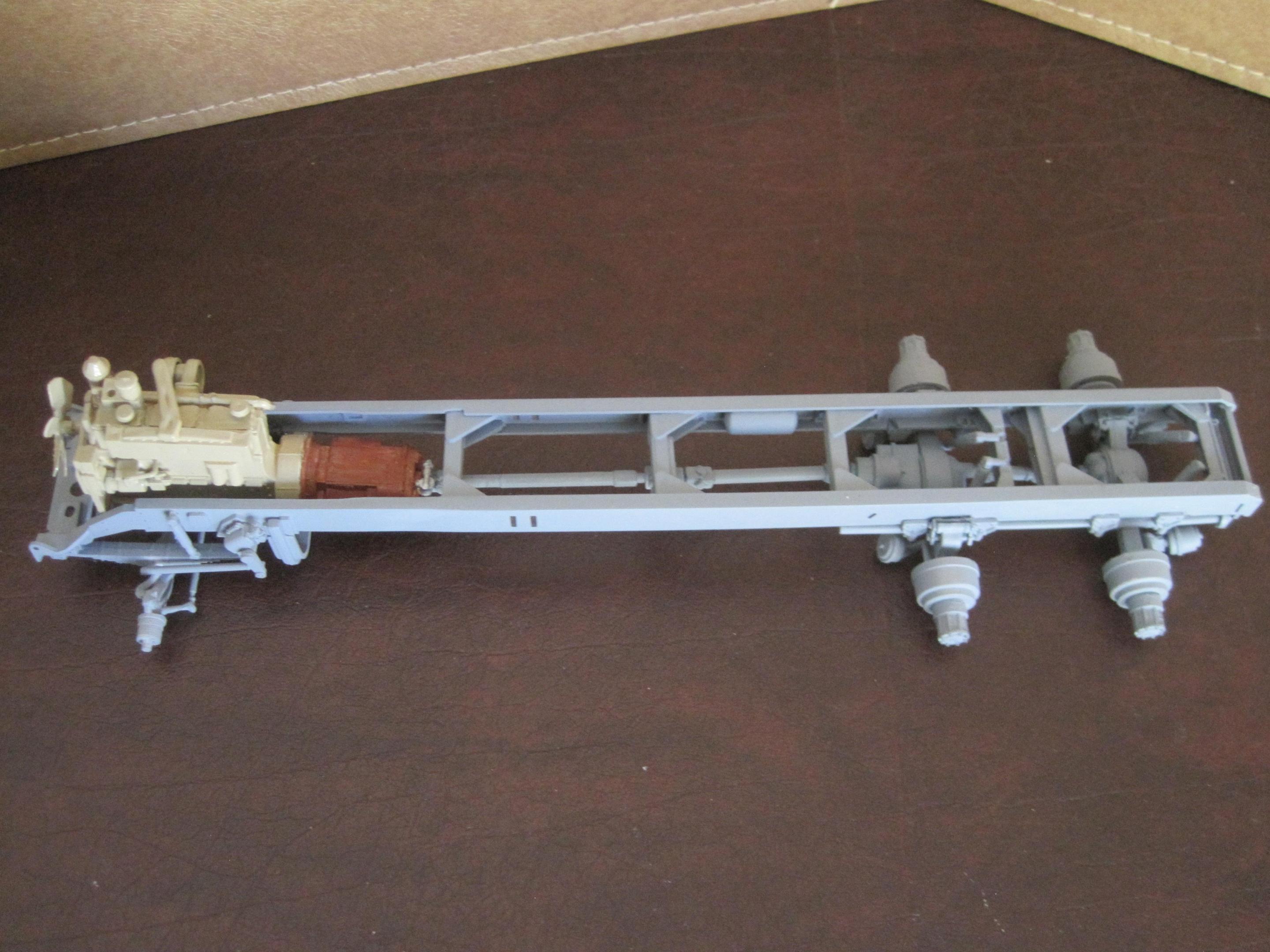

leafsprings Posted April 2, 2023 Author Posted April 2, 2023 (edited) Frame lengthened to 235" ( 1:1 ) to accommodate the longer 60" VIT sleeper. Thanks again Hakan for your research on the torsion bar suspension and wheelbase used on the Movin' On KW's. Rockwell hubs and drive line fitted. Edited April 9, 2023 by leafsprings 3

Force Posted April 13, 2023 Posted April 13, 2023 On 4/2/2023 at 10:53 PM, leafsprings said: Frame lengthened to 235" ( 1:1 ) to accommodate the longer 60" VIT sleeper. Thanks again Hakan for your research on the torsion bar suspension and wheelbase used on the Movin' On KW's. Rockwell hubs and drive line fitted. You are welcome, I had some help myself from a nice guy...KJ Humphries...who gave me the information on the wheelbase. Your build looks great so far.
