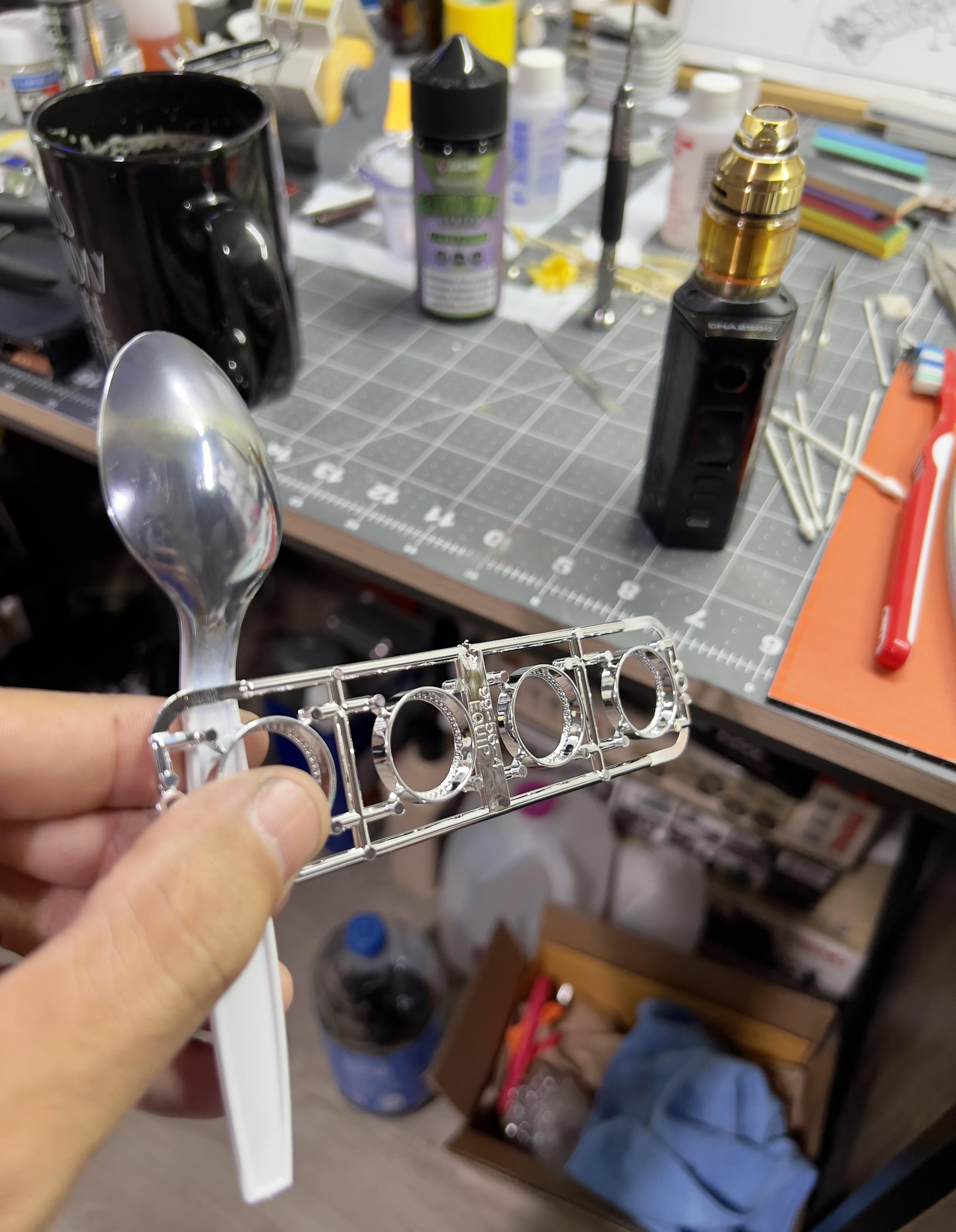

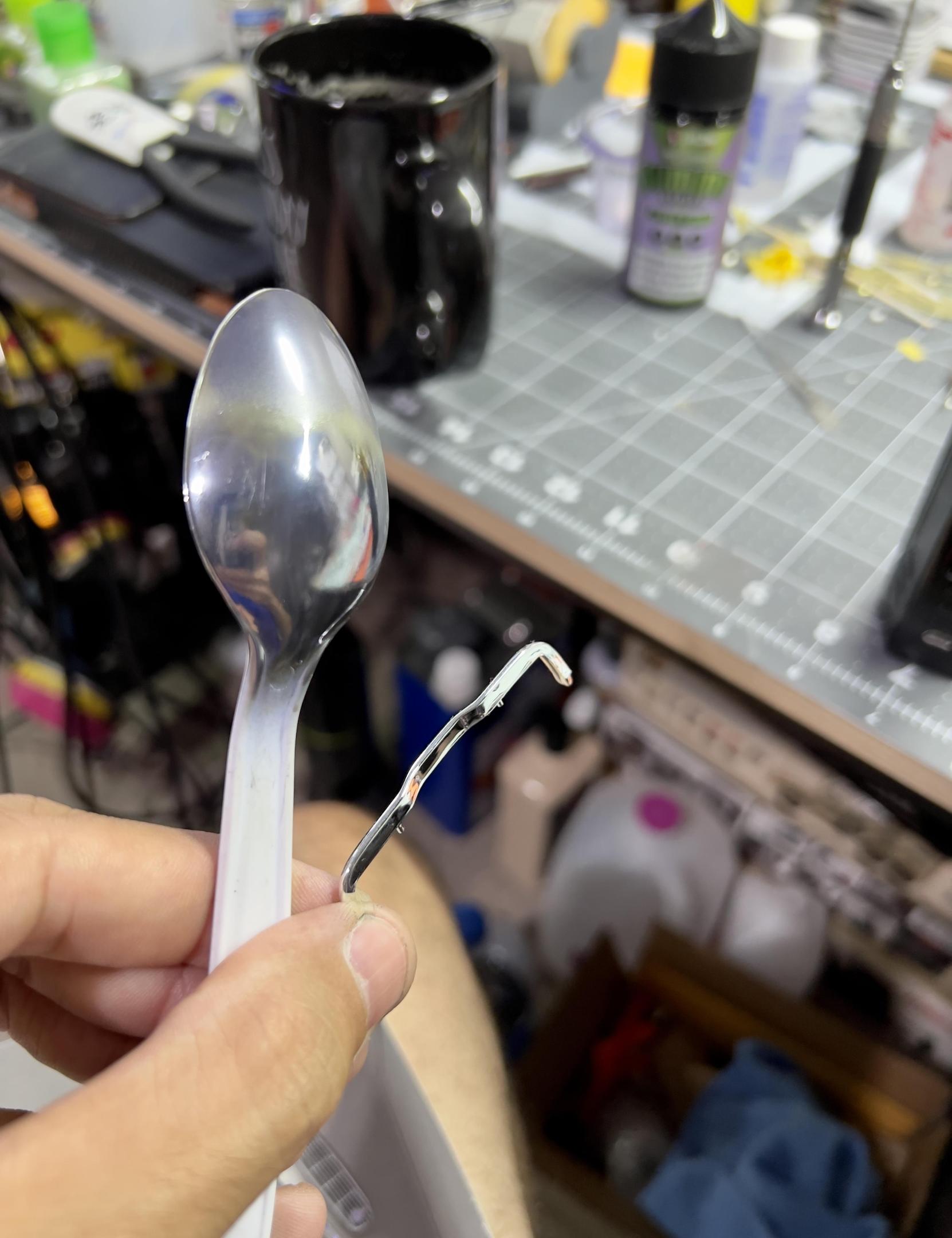

peteski Posted June 25, 2023 Posted June 25, 2023 There is something that looks off to me. While the samples here all look mirror-like reflective, they all look dark. Sort of like black chrome. This could be because the surroundings that are reflected in the "chromed" surface are dark. Dusty, is there any chance you could take a photo of your "chrome" sample along with on any original kit's chromed part (like a bumper)? That would show whether the painted "chrome" is in fact darker than standard vacuum-metalized kit part.
Dpate Posted June 25, 2023 Posted June 25, 2023 (edited) Did the best I could hear as the spoon has been through the works since last pics. But if I had the proper blue base it would look even better like the C1 picture. From Tamiya & aoshima kit. This spoon was just Tamiya light pearl blue l, and cheap Mr hobby clear 46. With the proper metallic blue, and even better clear coat it would look like the C1 pic. Edited June 25, 2023 by Dpate
peteski Posted June 26, 2023 Posted June 26, 2023 Perfect! Thanks Dusty! The kit chrome does have a bit different look, but the sprayed on chrome looks pretty darn good (especially in the last photo, using natural (Sun) lighting
