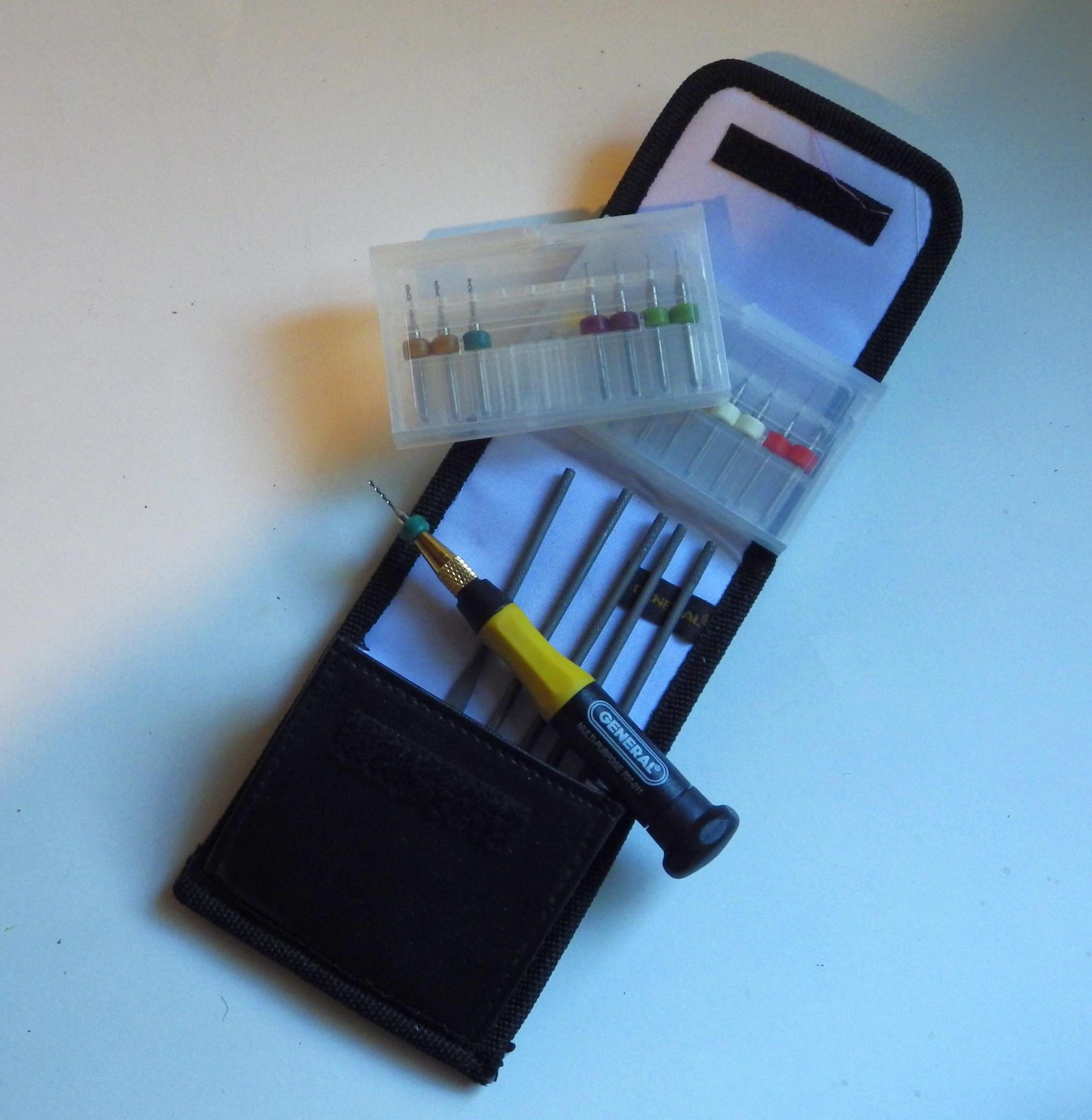

bluestringer Posted March 20, 2023 Posted March 20, 2023 I've got a set of General mini files that has a handle. The carbide mini bits I got from Harbor Freight fit perfectly in the file handle. I also have a Hobbico pin vise I've had for 40 years, it came with 6 bits stored inside it. The file handle with the carbide bits is easier to use than the pin vise, but the carbide bits are very fragile and break easily. I keep an extra set on hand.

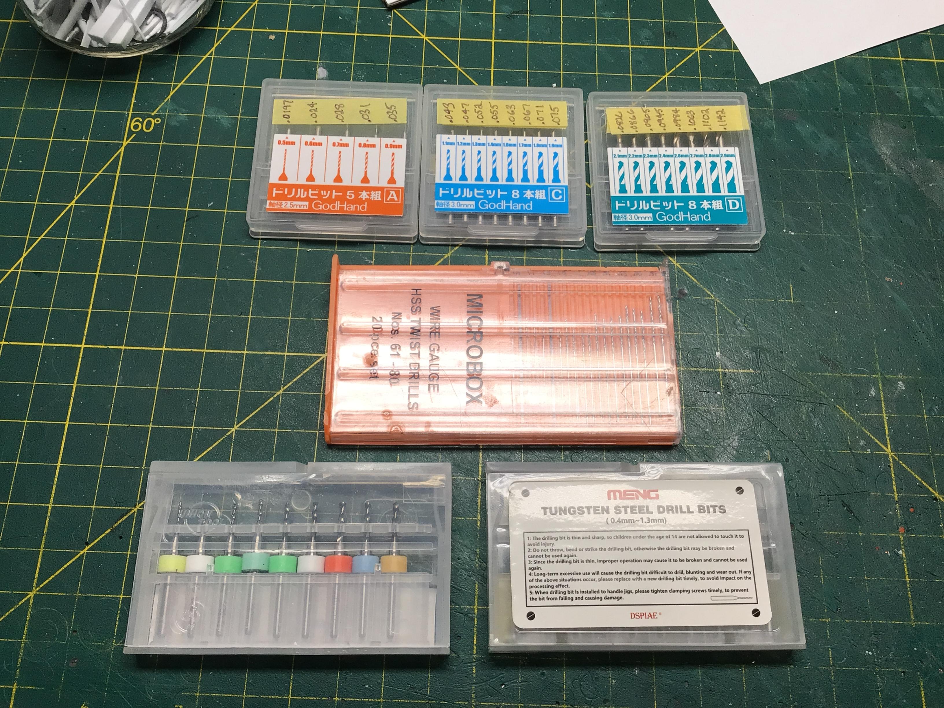

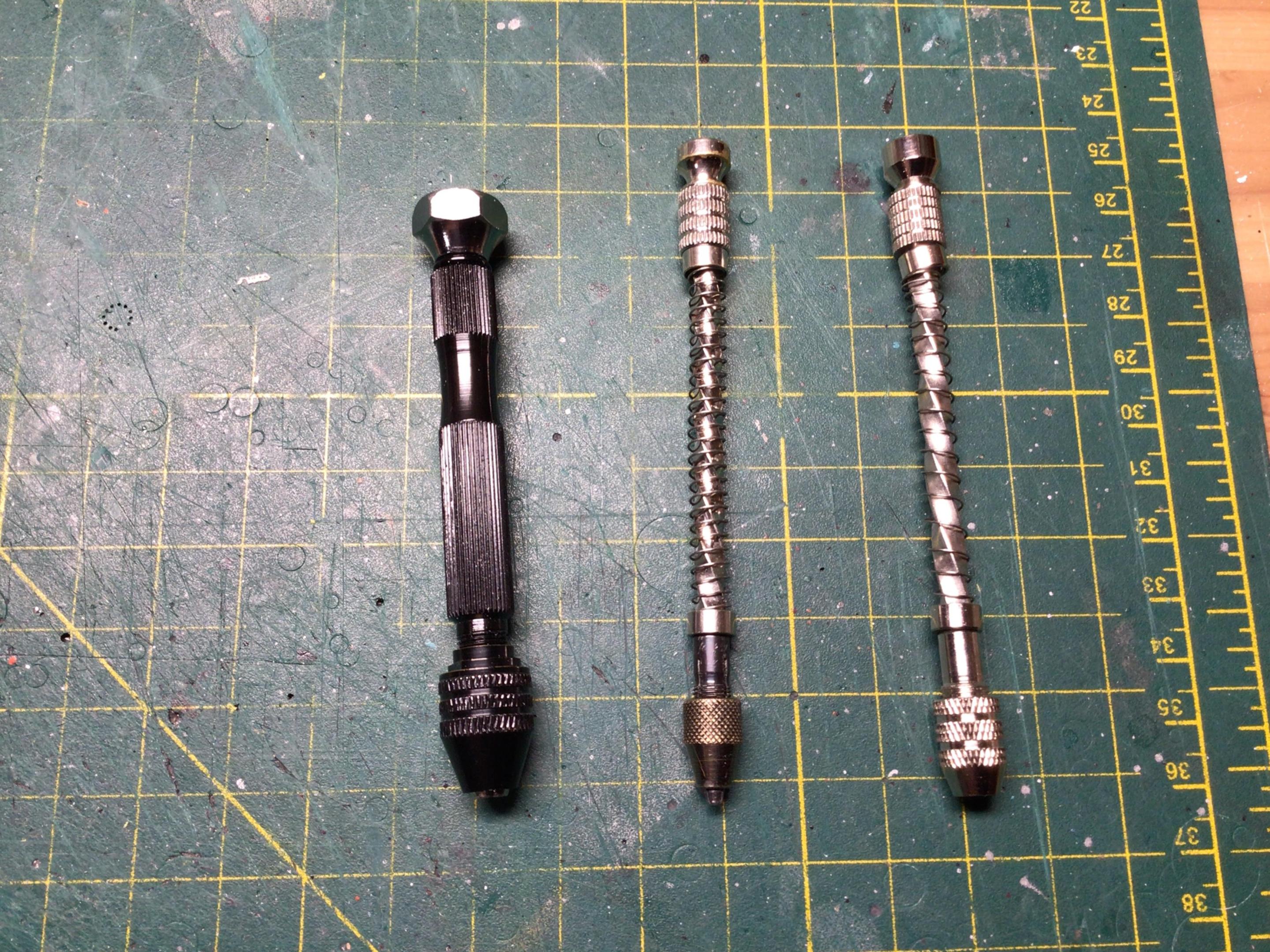

NOBLNG Posted March 20, 2023 Posted March 20, 2023 (edited) By far the best bits I have are the GodHand ones. The Vallejo ones in the orange case are also very good. The carbide/tungsten PC board drill bits in the bottom two cases are sharp and accurate, but extremely brittle!? Smaller ones like I needed for plug wires didn’t last long. Better to spend a bit more and get decent ones. The pin vise on the left and the drill in the center are nice (from a local HS). The one on the right I bought online real cheap….but it has a huge collet on it making it less desirable. The drill bits that came with the cheap one would not even drill plastic.? I also bought a real cheap set of four pin vises at a local HS, but they would not even hold a drill bit straight inline with the handle.…I threw them away!? Edited March 26, 2023 by NOBLNG

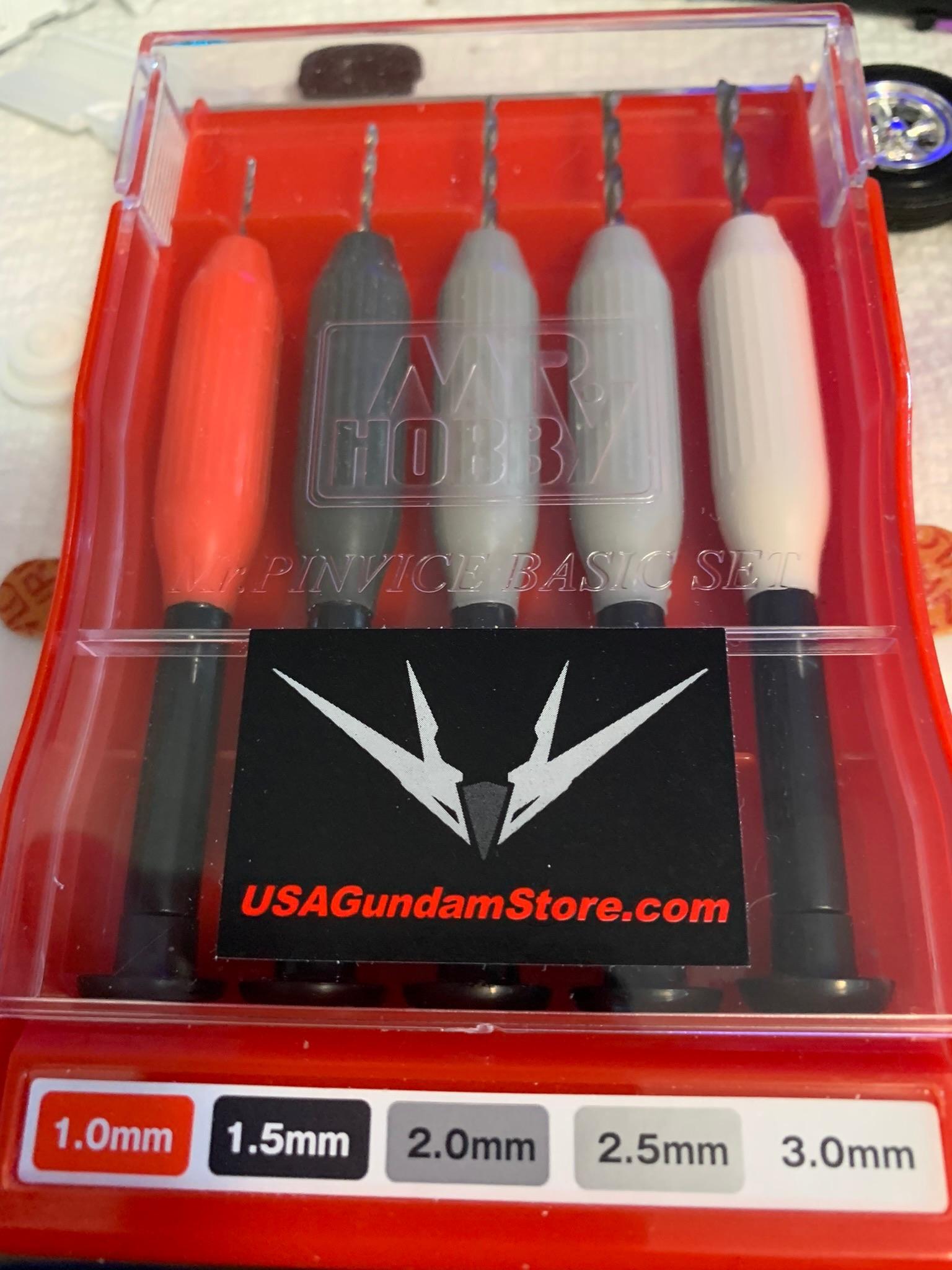

R. Thorne Posted March 20, 2023 Posted March 20, 2023 You are right about the pin vise “rabbit hole”. I have a number of pin vises from Harbor Freight to Dspiae. While it probably won’t help you in drilling plug wire holes, this Mr. Hobby set is one of the handiest I have for larger holes (1mm and up) and the quality of the “built in” drill bits (not replaceable) is extremely good.
ctruss53 Posted March 20, 2023 Posted March 20, 2023 Yes, I have that MR Hobby set as well. Very nice. And The bits bend instead of breaking. Don't ask.....

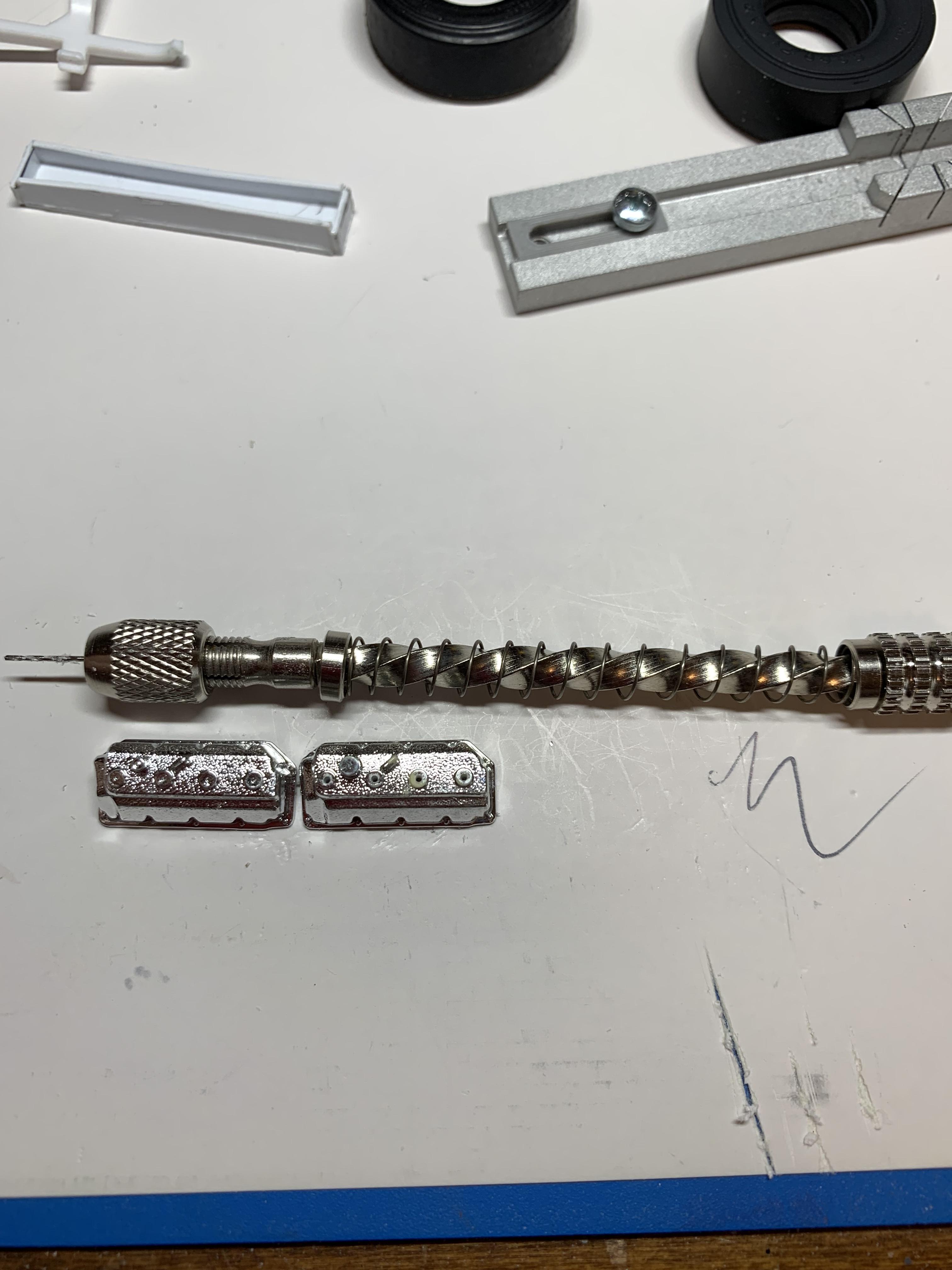

R. Thorne Posted March 24, 2023 Posted March 24, 2023 Thanks to this post, I decided to order a $7.00 screw type pin vise and try it. I like it, especially for plug wire holes .025”. I used an old Triumph, I think, drill bit u.s. made that I purchased many years ago for drilling out accelerator pump squirter openings on 4gc carburetors (1/1 cars). It worked out so well I am making it my dedicated drill for plug wire openings complete with a rubber cap to protect the bit. The rubber sleeves are used for pencils, but I used them for hobby knife grips.
