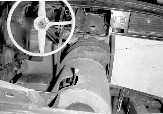

Steamboat Posted March 21, 2023 Author Posted March 21, 2023 Great photos! That is going to be a huge help. I was wondering what to do with the dash. I guess "instrument delete" will be the operative term! 1

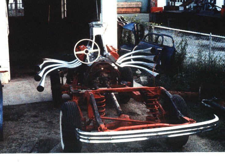

Straightliner59 Posted March 22, 2023 Posted March 22, 2023 15 hours ago, Steamboat said: Great photos! That is going to be a huge help. I was wondering what to do with the dash. I guess "instrument delete" will be the operative term! I thought I had a few more color shots, with the body off. If I run across them, I'll post them, here. It's one of my favorites! I plan to build an "inspired by" one day with an AMT '41. In fact, it's kind of started on.

Steamboat Posted March 23, 2023 Author Posted March 23, 2023 On 3/22/2023 at 1:36 AM, Straightliner59 said: Found 'em! Any ideas what the idler pulley in this photo is used for? I have a belt set that puts the generator up above the driver side valve cover and a PS pump forward of the head. Photos of the replica car don't show the generator, but it's not on the passenger side. I'll delete the PS, but am curious as to where to put the generator.
