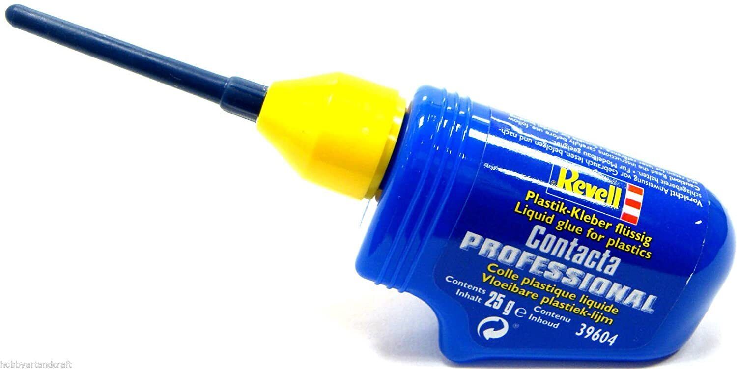

espo Posted March 26, 2023 Posted March 26, 2023 I have used the same Model Master glue forever. When I saw that Revell was offering their Contacta #39604 I wanted to try it. While I like it maybe even a little better than the Model Master product, I have to keep removing the delivery needle and cleaning it out after just a few uses. I do cap it right after use, but it still keeps getting blocked. They also offer a Contacta Clear, for windows and mainly clear parts. This has a brush applicator and is thicker consistency. I have used it for many other applications, and I'm pleased with how it has worked.

charlie8575 Posted March 28, 2023 Posted March 28, 2023 I've been using the Contacta Professional, and it's very good. I've had a problem with the needle coming out of the bottle, though, when I take the cap off. That aside, great glue. Charlie Larkin

ctruss53 Posted March 28, 2023 Posted March 28, 2023 I still have some of that Model Master Cement. It is my go to for painted parts. I use Revell Contacta Professional as a replacement. I am not happy with the Contacta Professional though because the metal applicator tube doesn't stay in the bottle like it should. As a second replacement for the Model Master cement I use the Testors red and white jar with the brush applicator. I think the MM, Revell, and Testors cements are all pretty equivalent. I would not be surprised if they were all the same stuff in different packaging. Now the best glue in my mind for bare plastic is the Tamiya cement with the orange cap. If you want a quick bond for parts that fit very well together with no gap, then Tamiya with the green cap is awesome.
