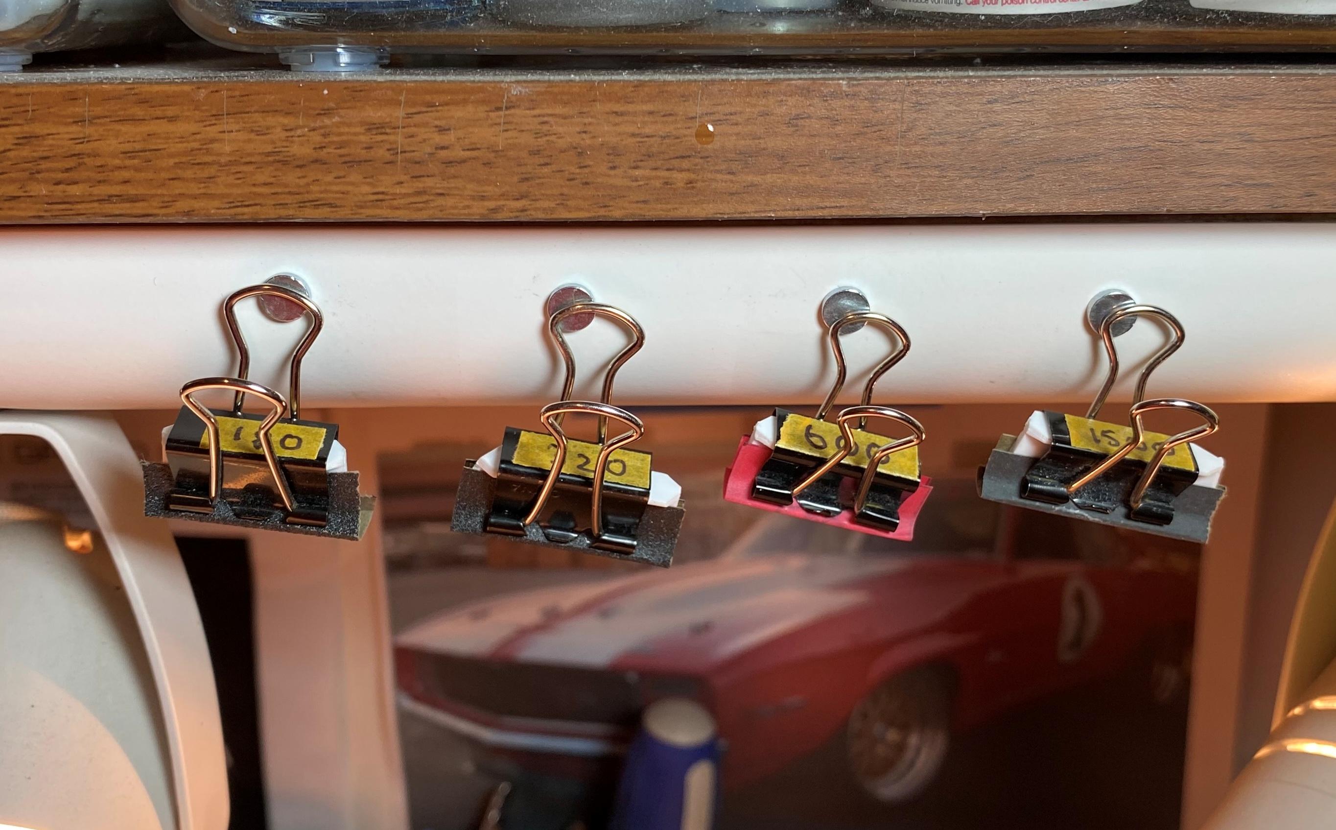

Bills72sj Posted March 28, 2023 Share Posted March 28, 2023 Make and use these. I sand diagonally a couple of strokes then diagonally the other direction. It is how bodymen sand with a longboard. 3 1 Quote Link to comment Share on other sites More sharing options...
