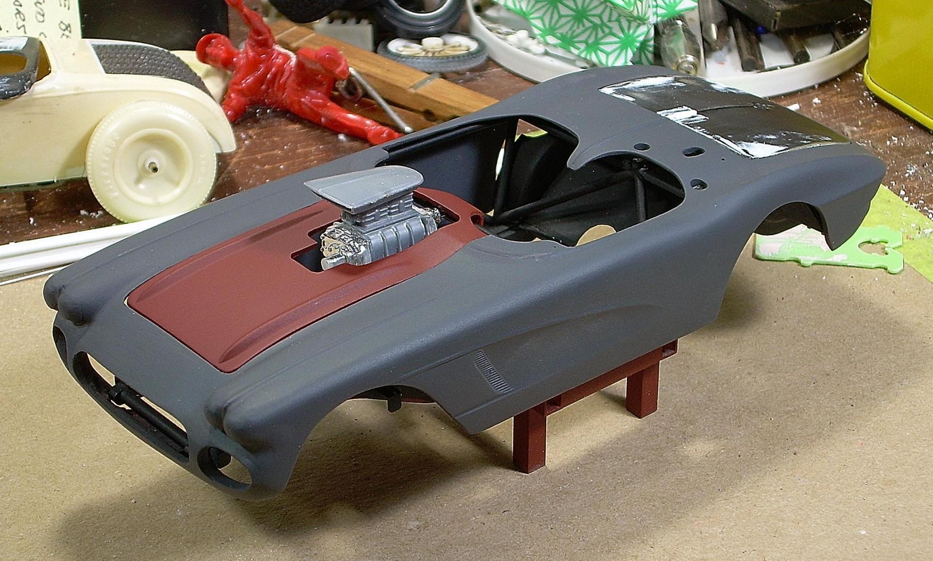

Ace-Garageguy Posted April 1, 2023 Posted April 1, 2023 1 hour ago, Dave Van said: I'd also look at Dupli-color primers, semi gloss black LAQUER. Not the OP's question (which is about air-brushable Tamiya acrylics), but Duplicolor also makes a specific dark-gray "hot rod primer". 1
