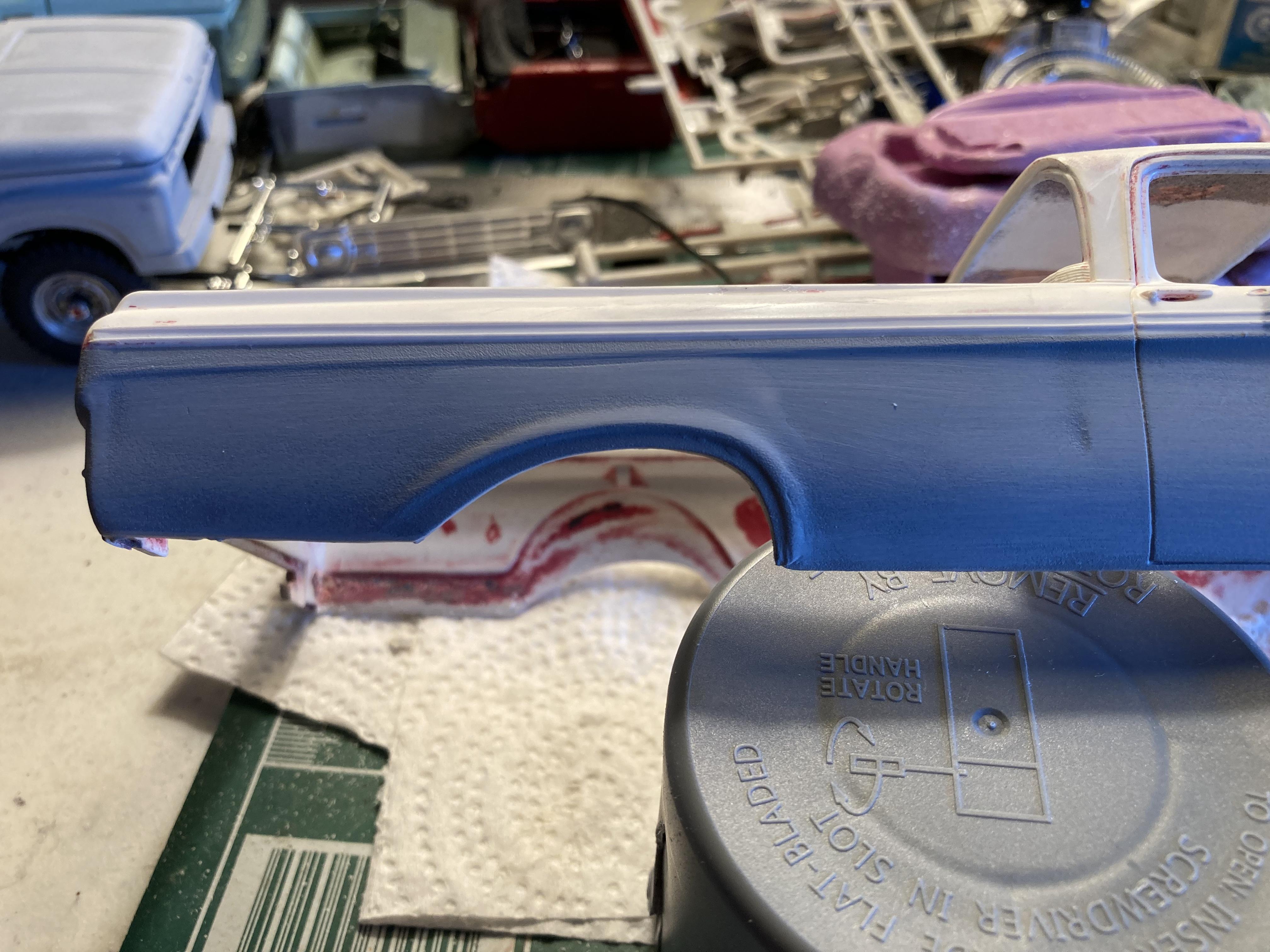

Ever since I traveled the "thumb" area of Michigan (anyone remember the Ubly Dragstrip of the 1960's???) as the Ford Sales Zone Rep during 1979-81, I've been fascinated with the 1961-63 Ford Unibody F100 pickup.  So much so that I spent $40 (in 1980 Money, the equivalent of $146 today. the most I've ever spent on a model kit) on a pristine unbuilt AMT 1963 F100 customizing kit at the old Herb Jackson/Bill Enders store in Farmington Hills, MI.  I actually planned to build it but it never happened.  Probably around 20 years ago I bought a second kit -the reboxed 1964 release - in a partially built form with some body damage and the like.
Sometime in 2021 I set out to actually build the second kit.  I'll save the envisioned build details for later, but the bottom line is this one has been a struggle almost from day one.
I spent months fixing the damage, and more profoundly, fixing all the imperfections (sink marks, crooked side body molding, et al.) of the original AMT body shell.   Then the paint...including multiple mishaps that again I will explain later, most recently a severe case of orange peel from an application of Tamiya TS Clear over well dried Testors Coat Lacquer.
I do still work on it from time to time, but guys this one has been discouragement city!  Anyway, shot a couple pix of it today in its current state.
Thanks for looking and listening to the summary of my sad, sad story on this one!  Cheers...TIM

On 4/5/2023 at 6:47 PM, tim boyd said:
PS - and yes, there is a reason (to be revealed later, but hopefully not too far in the future) why I am showing this one at this time ..TB
I'm going to bet one shiny penny on this kit getting one of Round 2's retool / reissues, as a variation on the '60 truck that has already been announced.
I will bet another shiny penny on Tim Boyd completing this long-term project by the time the reissue comes out....and I hope I win on both bets :D

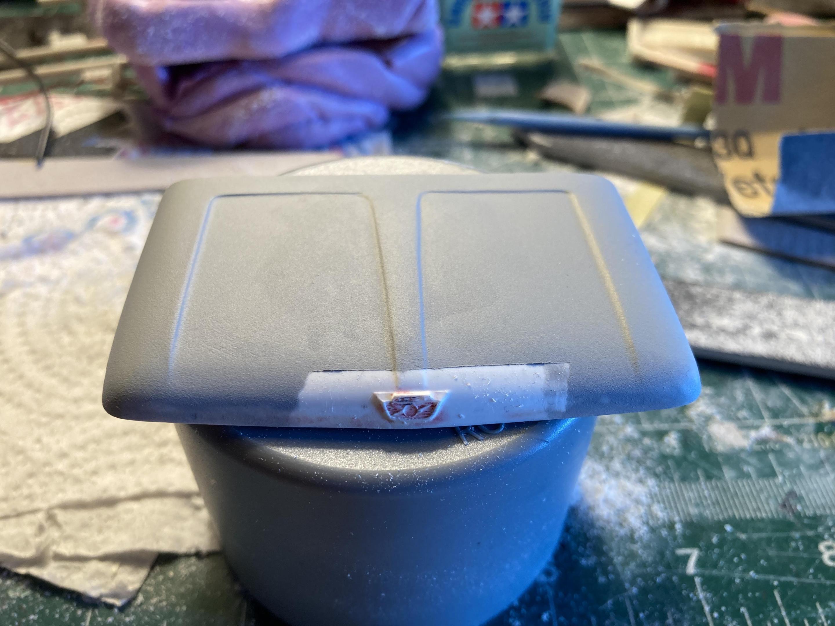

UPDATE 4-21-23:  Today, after finishing a couple of magazine contributions, finishing 2023 taxes, etc, etc, finally sat down and took to that orange peel with a brand new 2400 grit (yes, the really serious stuff) Micro Mesh sanding pad and soapy water.  Took a couple of hours, and avoided sanding through except the very top of the tailgate which was an easy fix.
Just shot the Mr. Super Clear Gloss about an hour ago (8:10pm 4-21-23), appeared to go on without sags for flaws (except one small one on the hood that should rub out OK).  Last checked it was drying nicely.  Next step will depend on how much the paint shrinks as it dries.  Would love to straight to polishinng compounds, but that may be too much of a stretch.  Best...TB

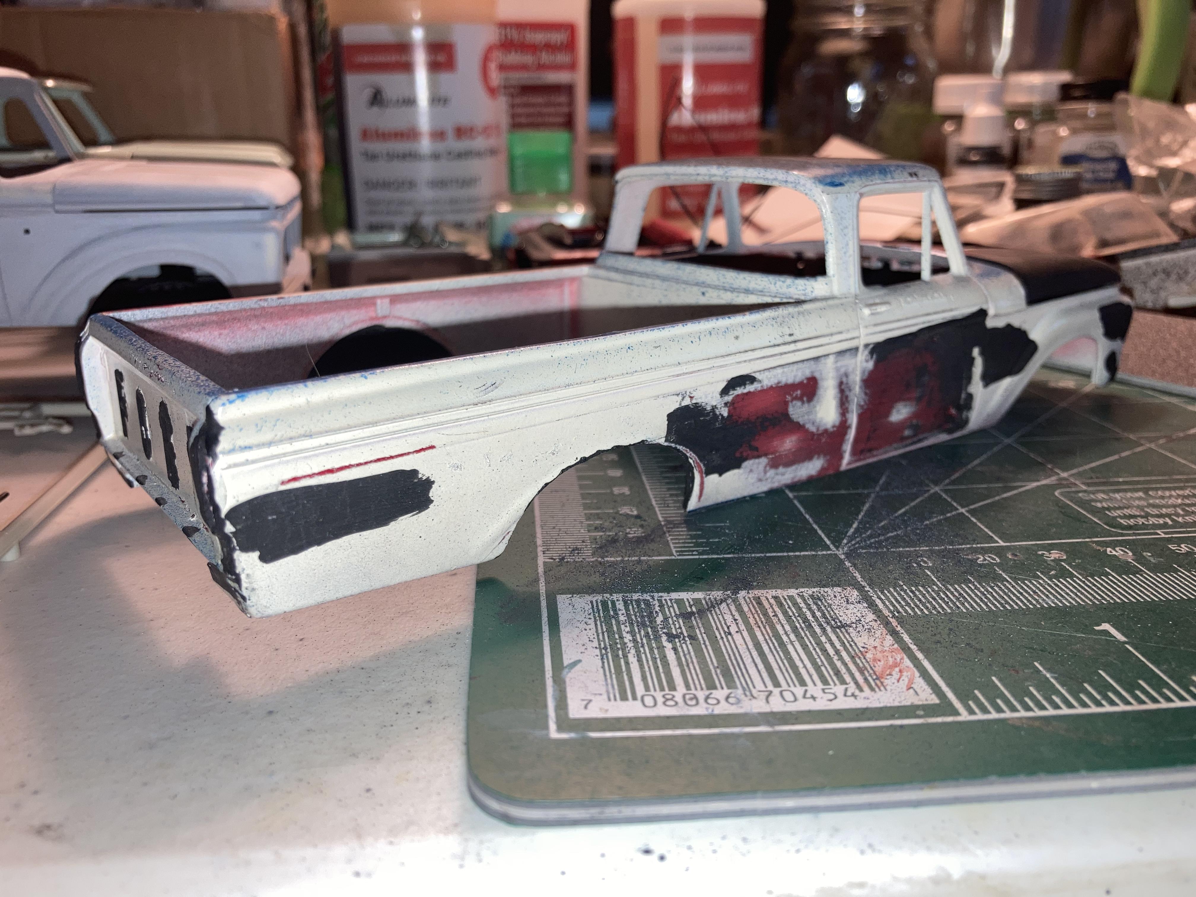

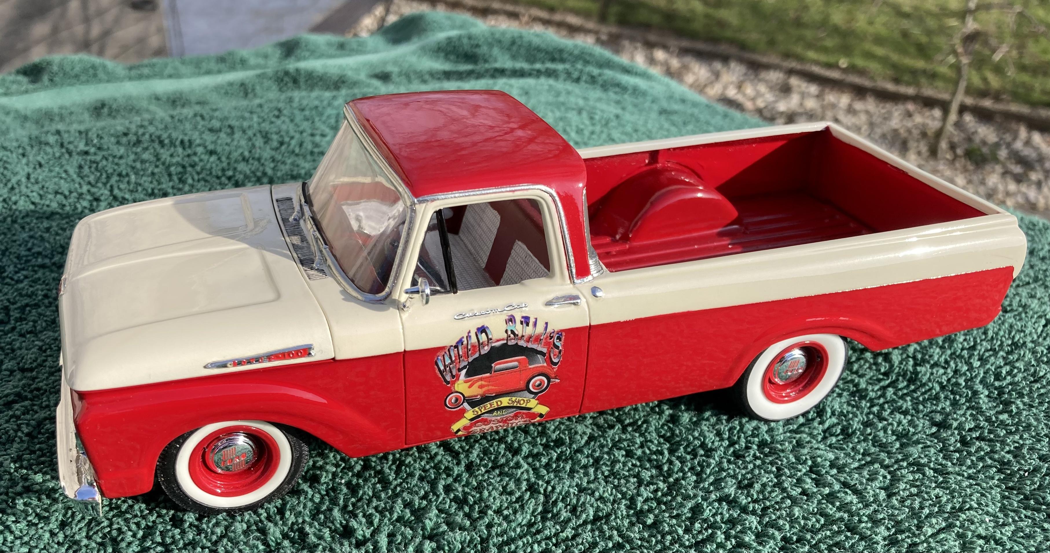

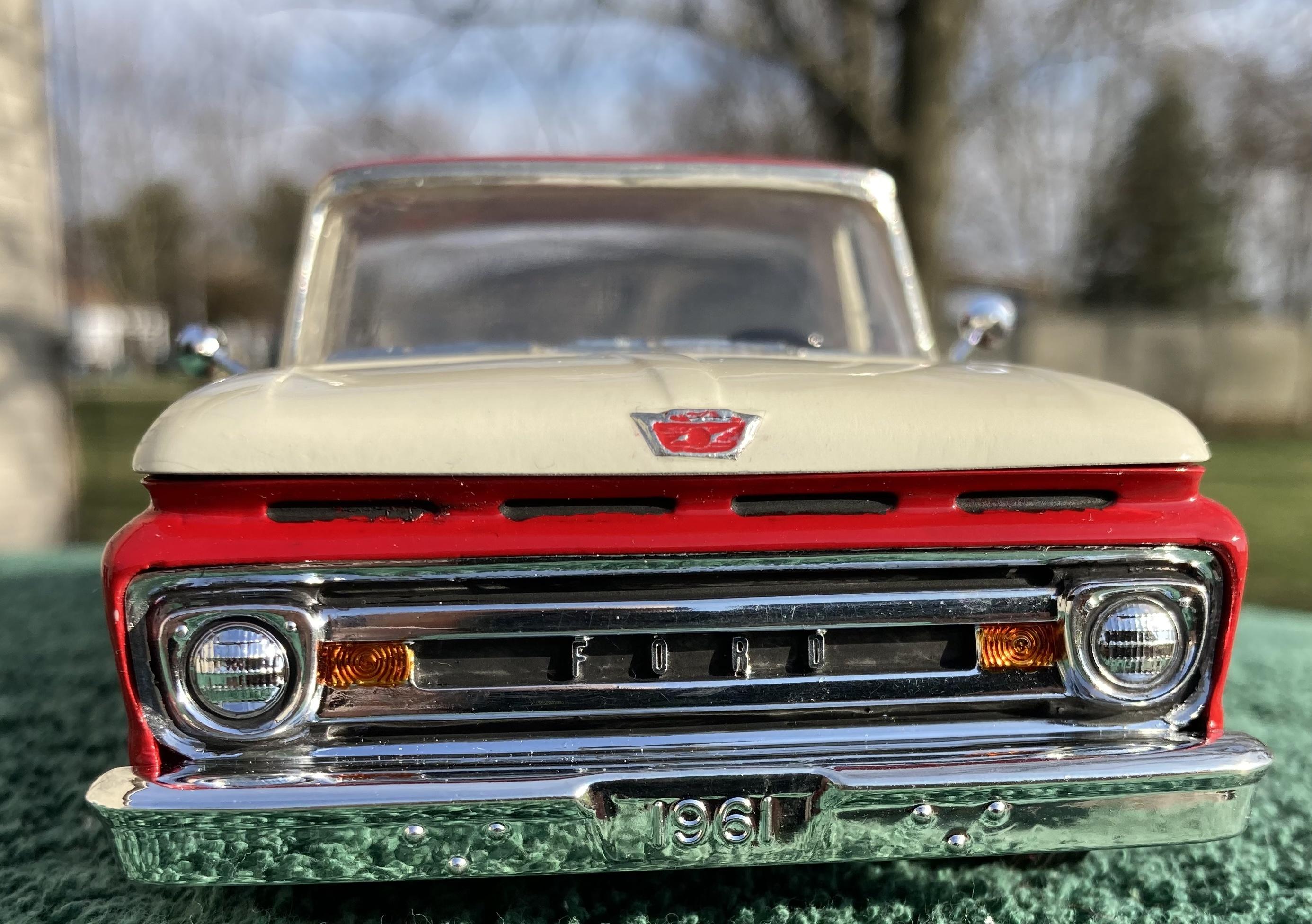

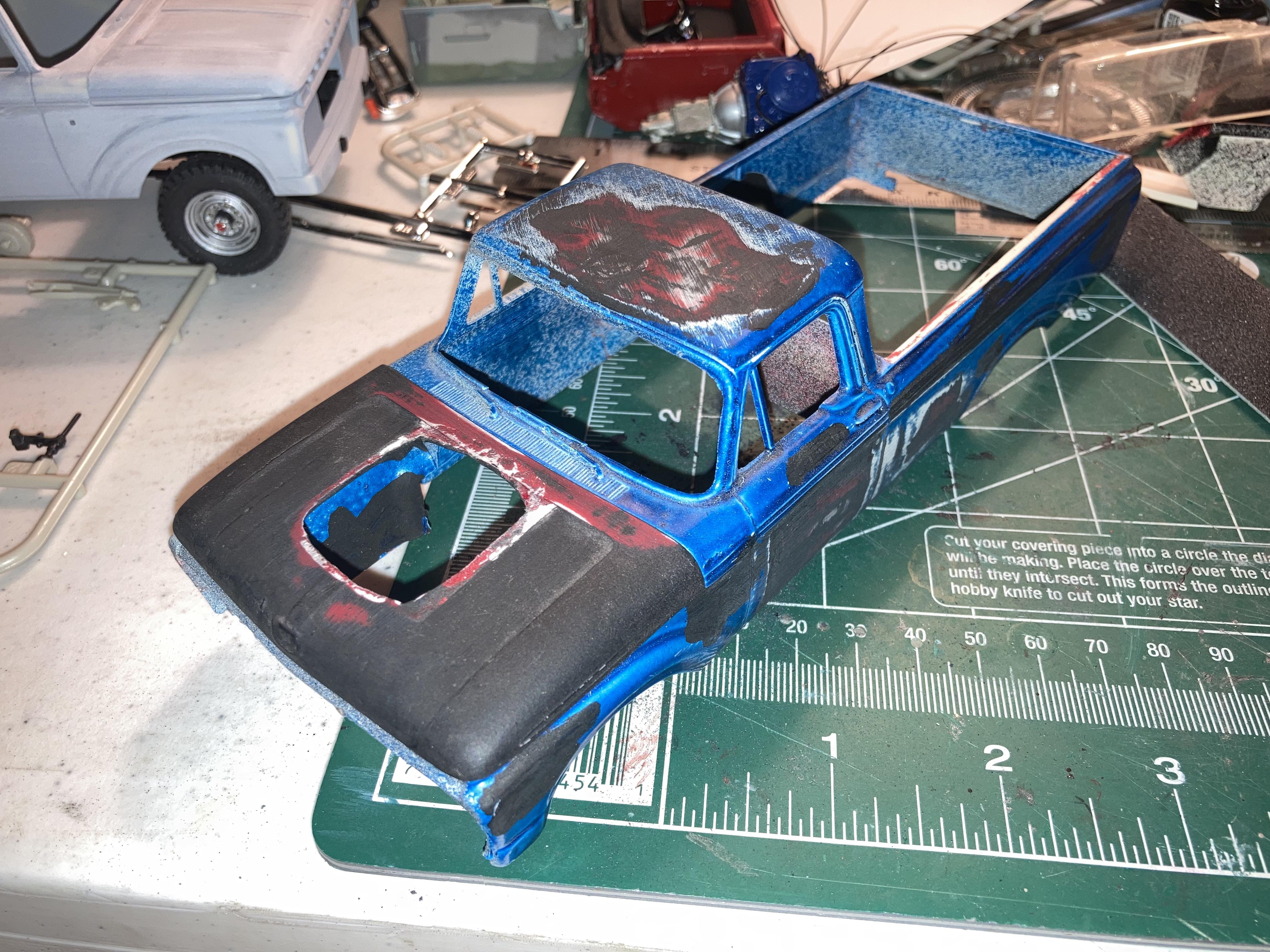

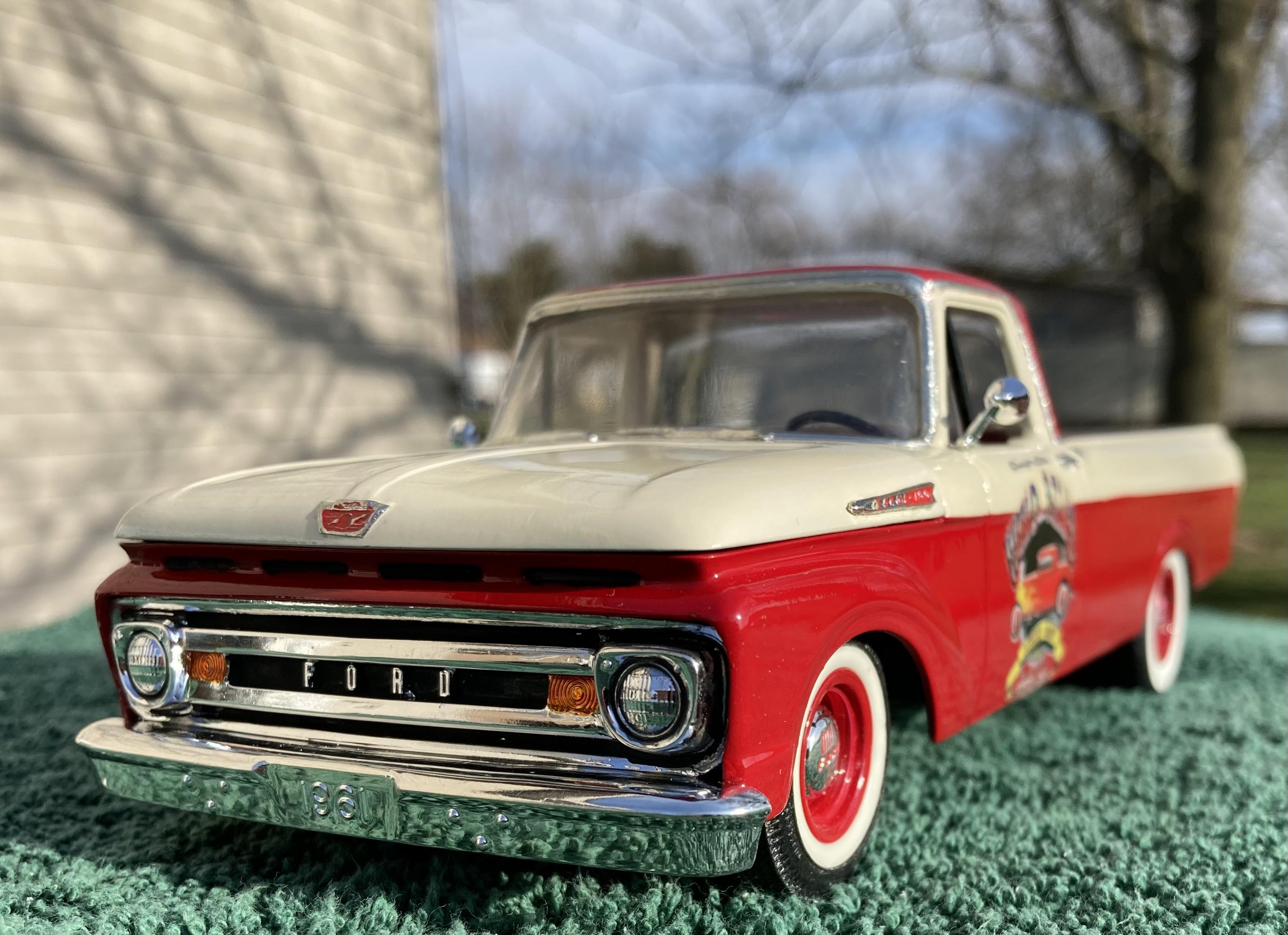

Tim, here’s one I finished not too long ago. I bought it new in the late sixties. It’s the second issue 63 kit. It was rough after my childhood modifications and sloppy paint. Luckily I kept it and my skills caught up so I could repair it. Yours looks great.
  • Like 3
Dennis...that is one sharp build.
Having worked many hours to fix the body issues on mine, I was highly impressed to see how you did yours.
Then I saw those pictures at the bottom showing what you started with.  Pretty amazing stuff.  Big congrats from this corner!   TIM
  • Thanks 1

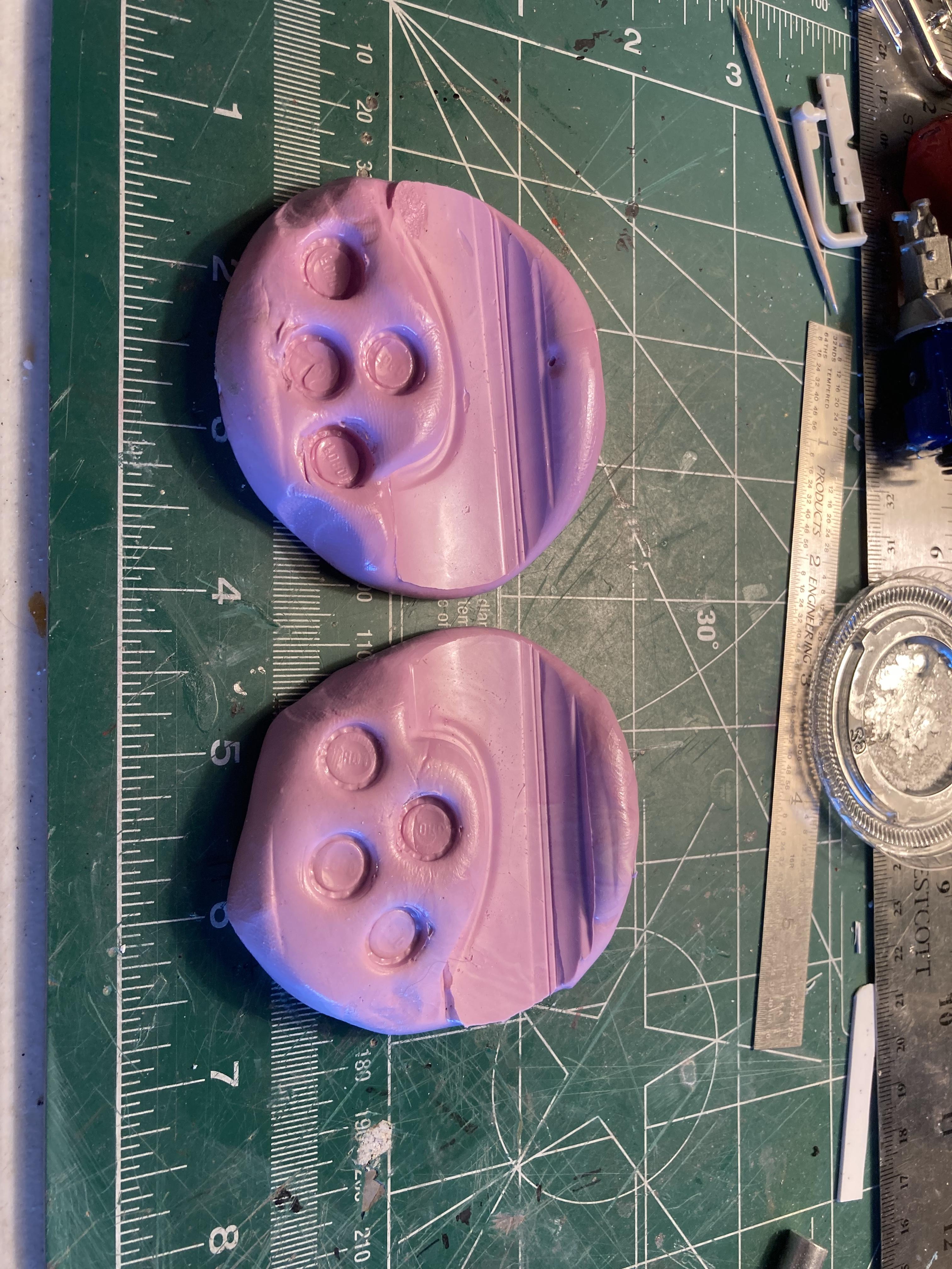

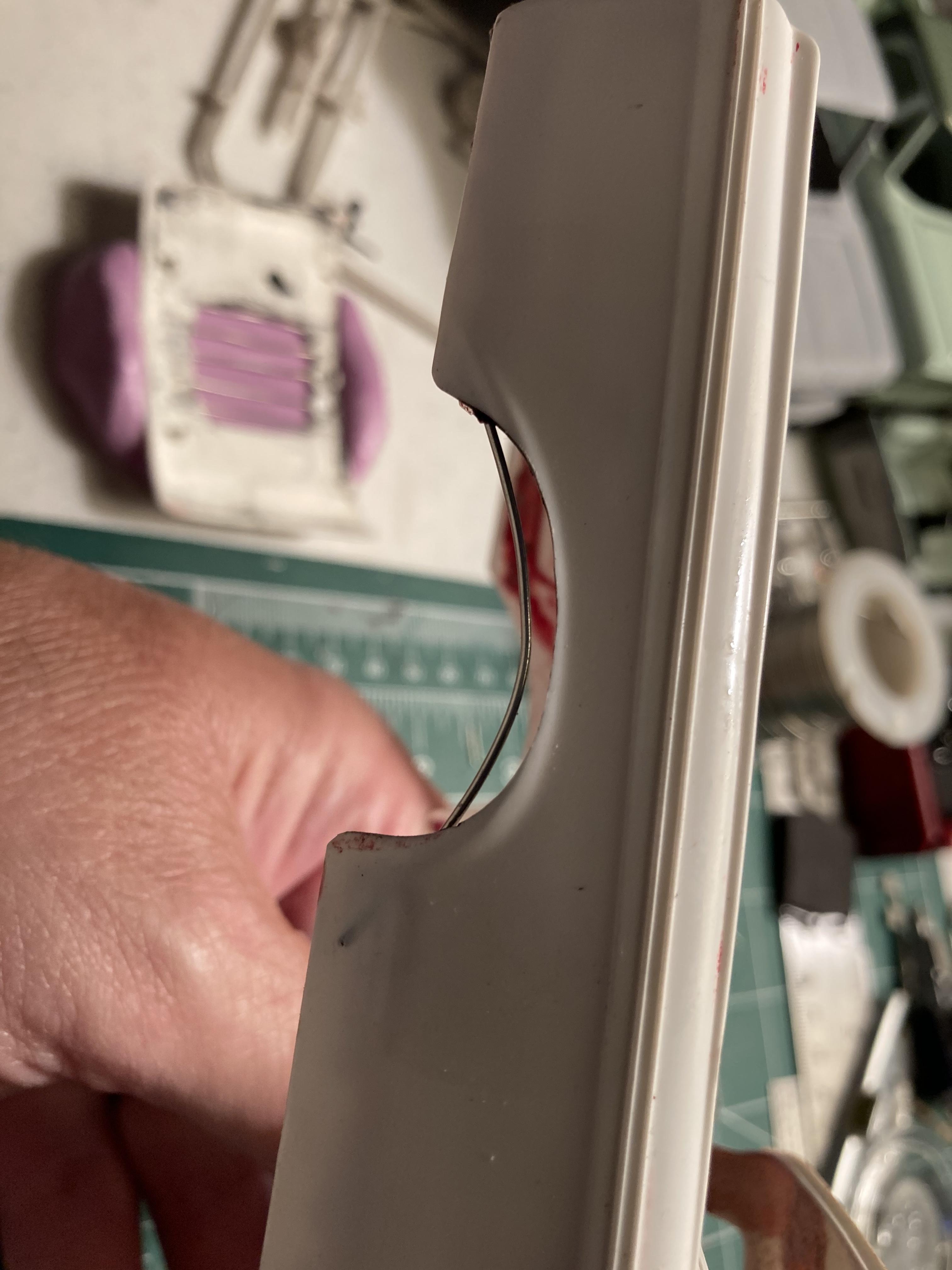

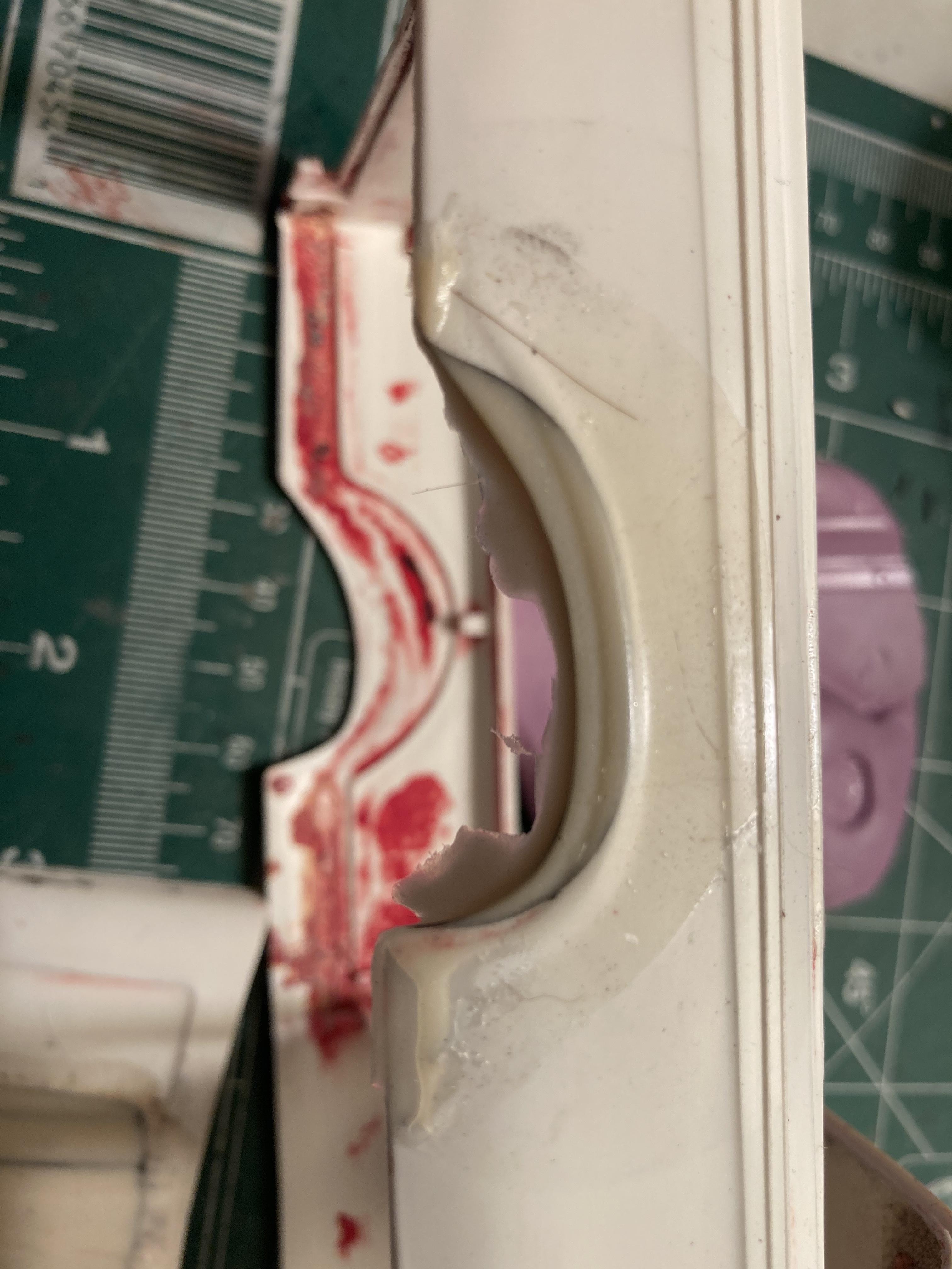

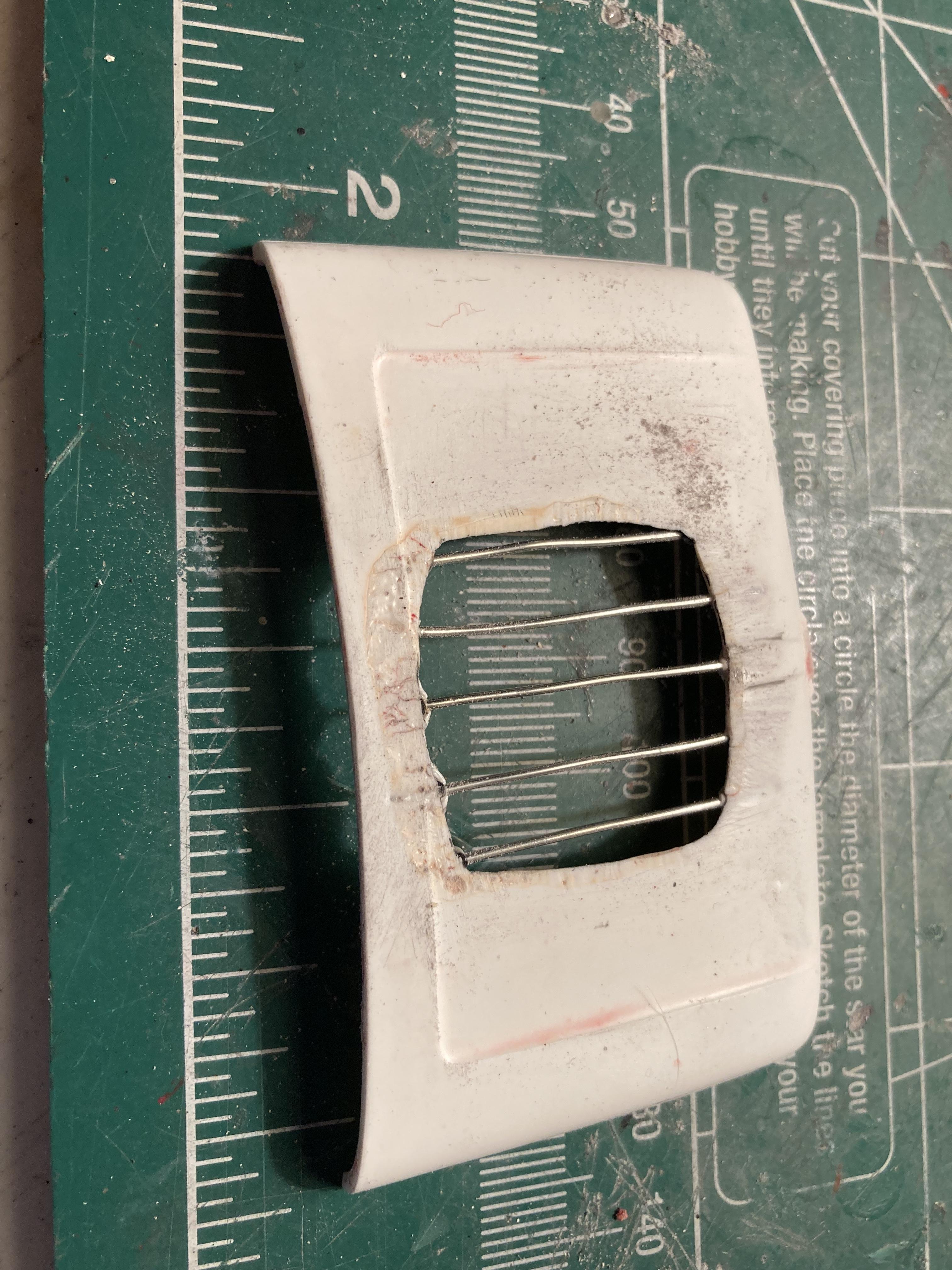

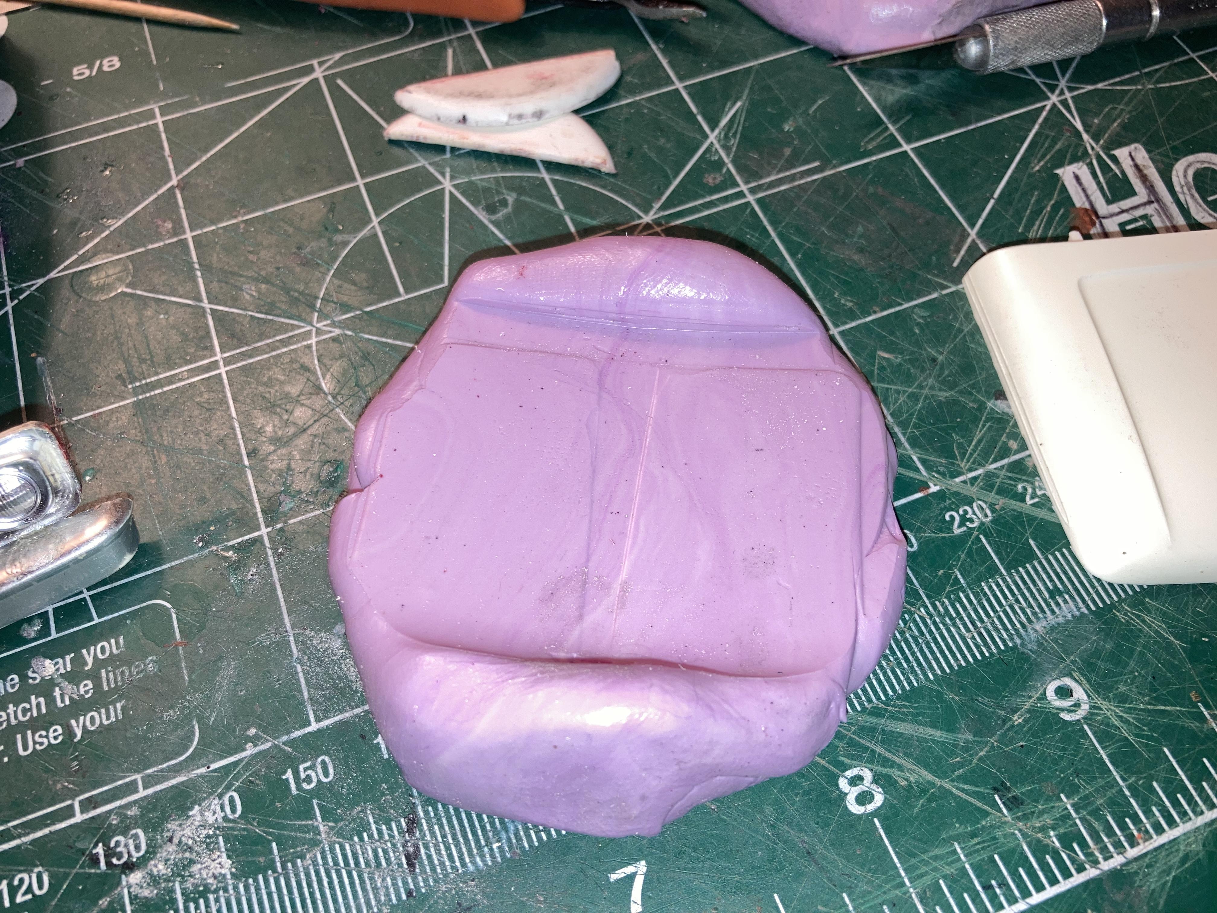

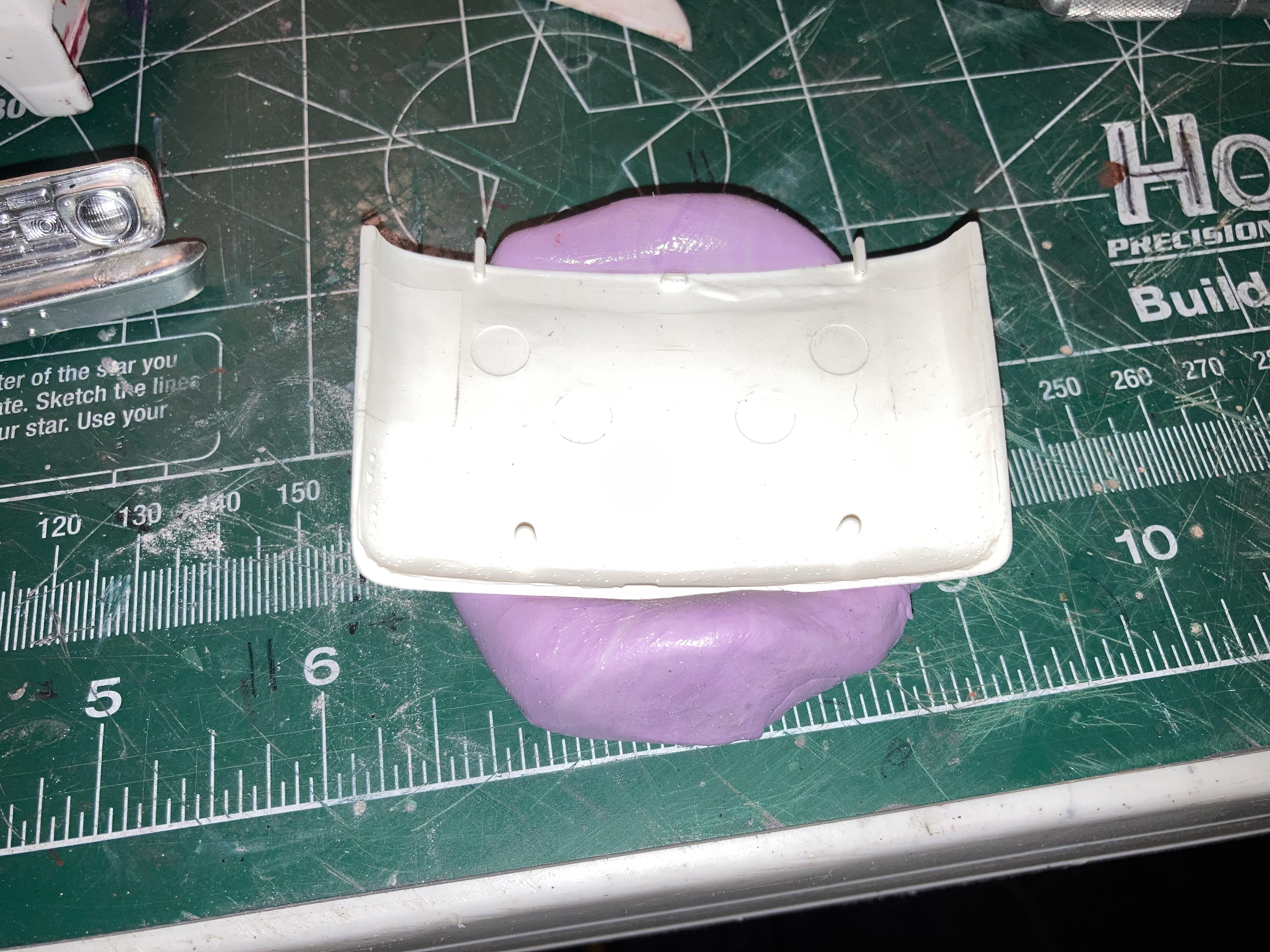

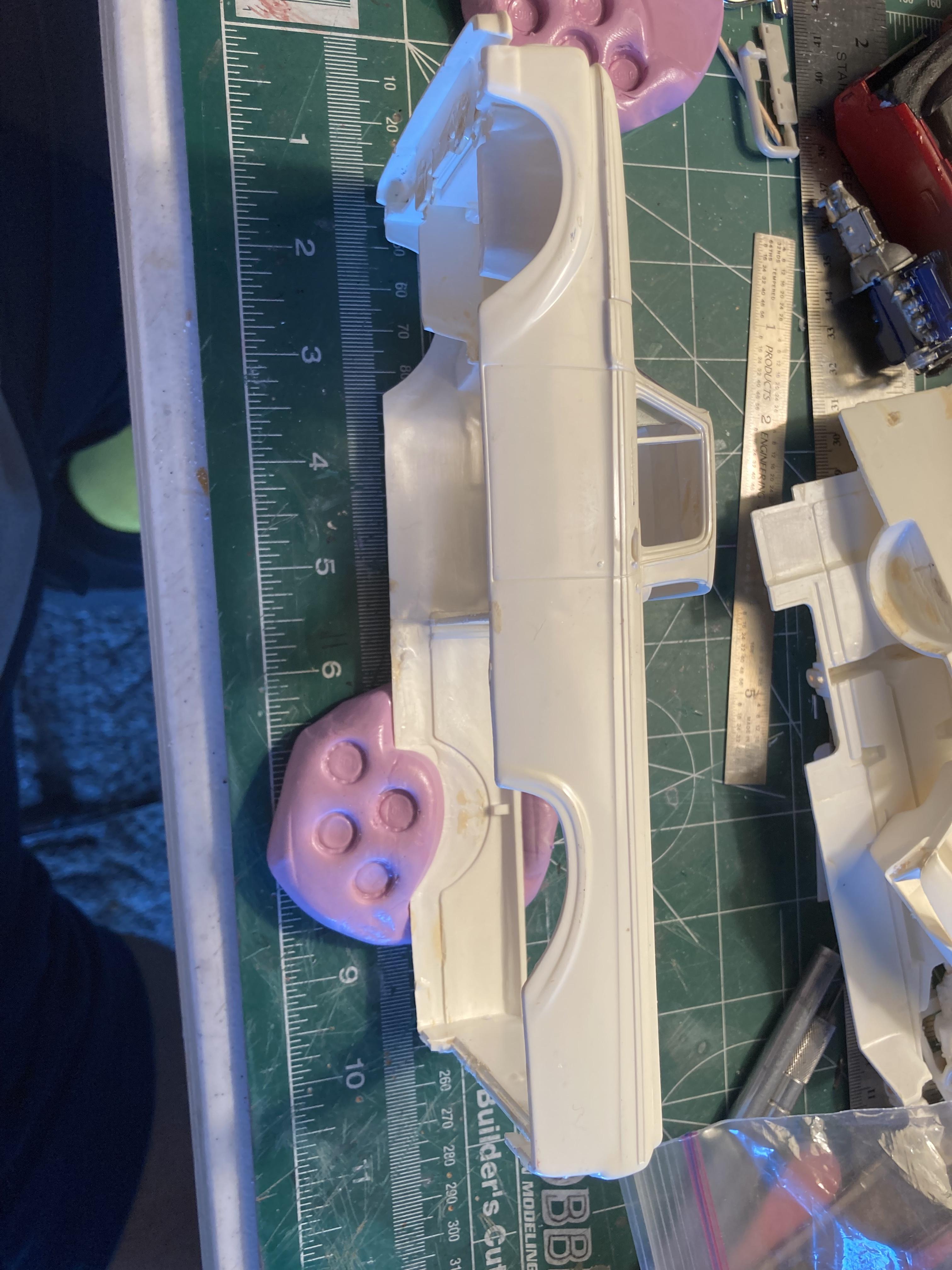

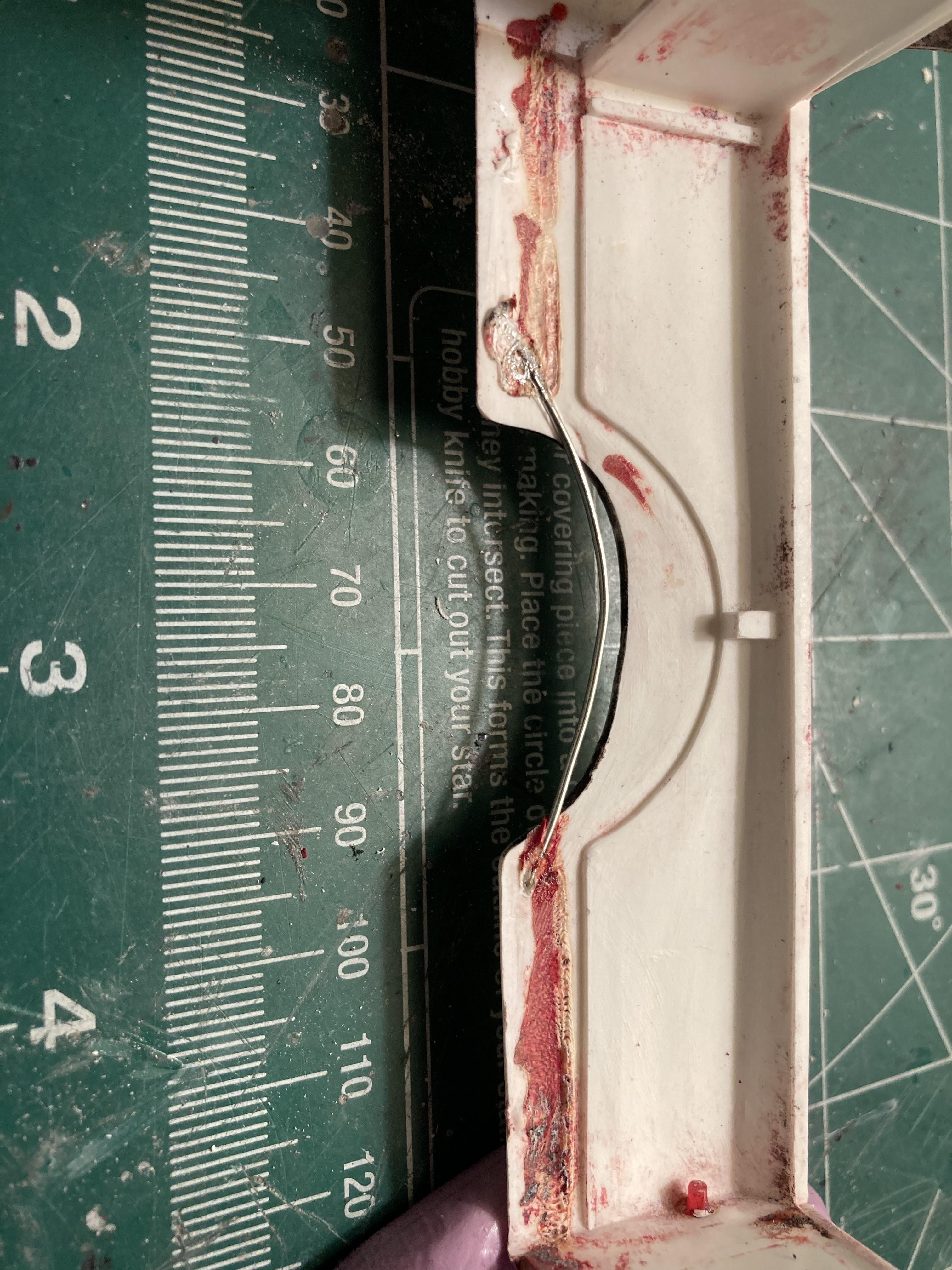

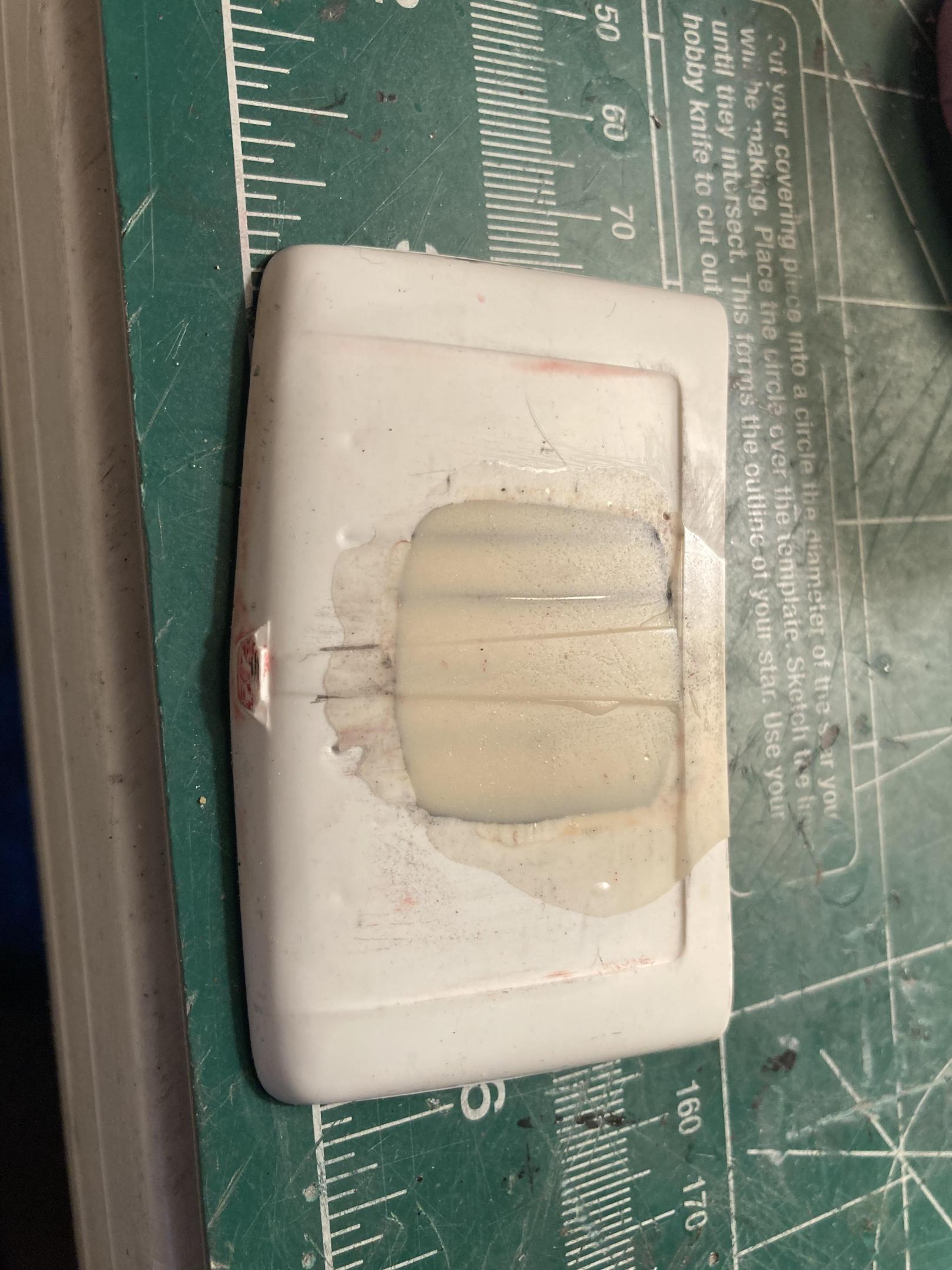

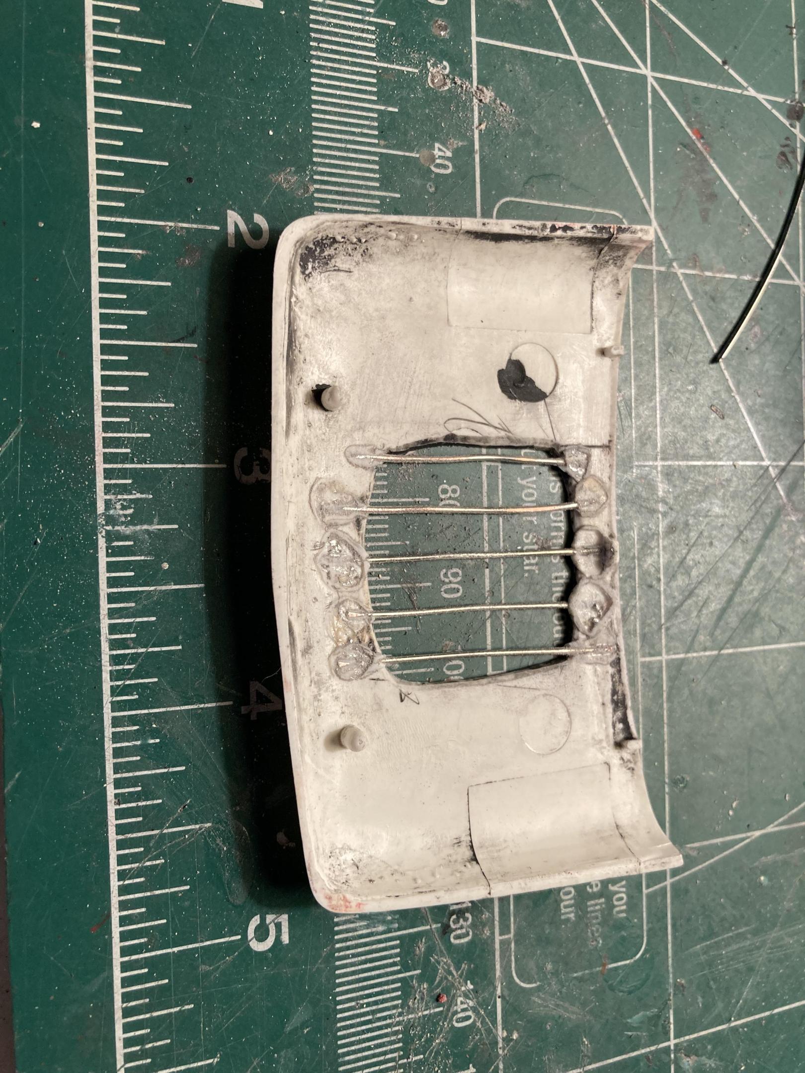

Tim, I thought I would show you a few pictures of how I repaired my Unibody pickup. I also have a mint 63 kit. So I made molds of the rear wheel openings and a mold of the hood. I reinforced the cut out areas of my original cut up body with wire melted into the opening with a soldering iron. The placed the damaged parts in the molds and poured in resin. It worked out well and hardly any sanding and filling. I also built a complete frame a body pan. I used the front and rear suspension from a AMT Thunderbird NASCAR kit.
  • Like 3
Very impressive work.  And that chassis/frame looks great!   TB
  • Thanks 1

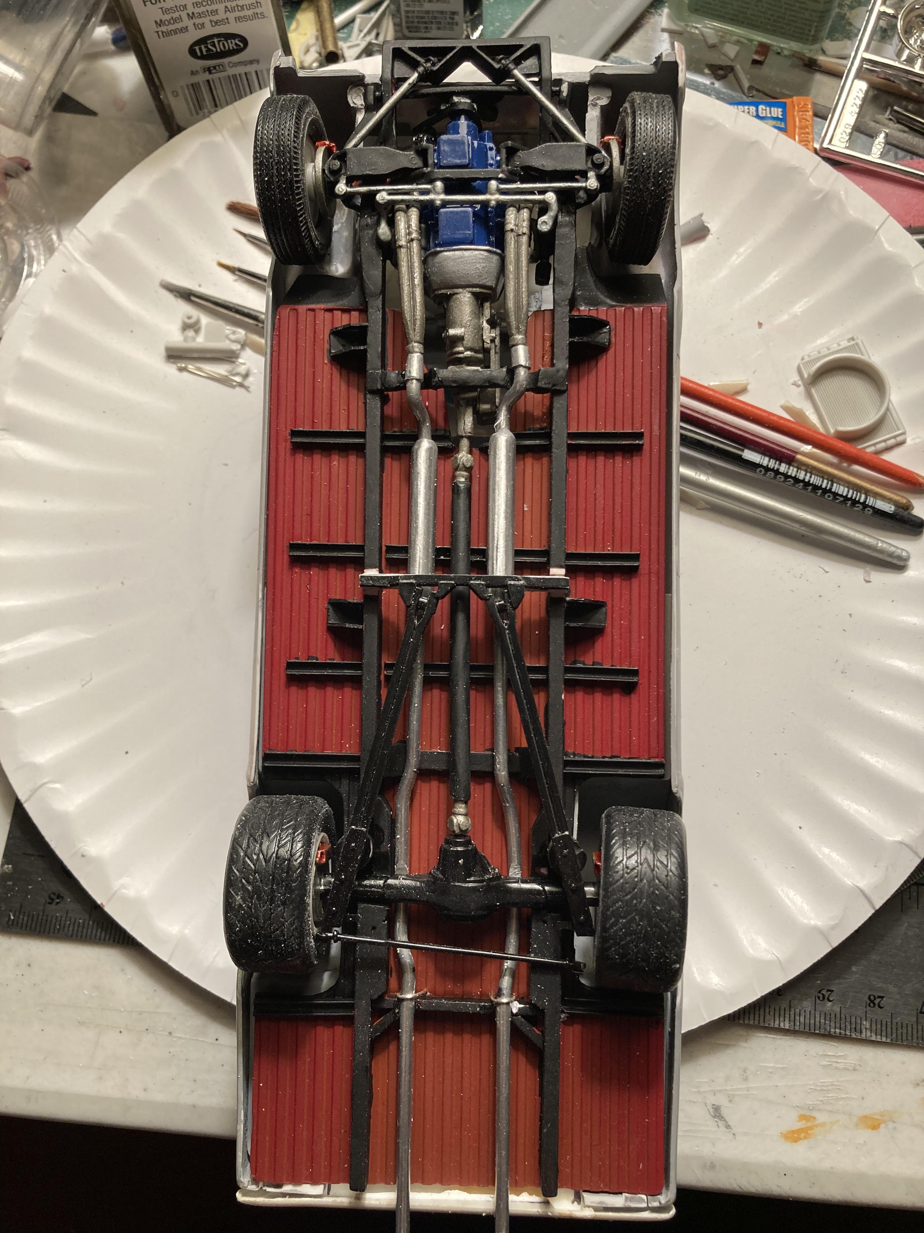

Nevertheless, over the last few months I put together a new chassis based on a shortened version of the Moebius LWB Bumpside series kits. While this is not 1/1 scale correct as the Moebius kit, of course, includes the Twin I=Beam suspension that did not appear on the 1/1 until the 1965 model year, it was envisioned as a way to get a detailed chassis vs. the one-piece promo style unit in the AMT kit.  (In retrospect, it may have been better (i.e. more feasible/correct to the 1/1) to use the Moebius chassis in combination with the front leaf spring suspension in the Revell '56  F100, but that ship (i.e. my build) has long since passed that decision.)
As seems so common when looking at a conversion like this, what looks simple turns out to be more than a little complex, especially fitting the chassis with the Twin I-Beam to the front underbody of the AMT kit.  But now the chassis is done, along with a slightly dropped stance to the front and rear suspension.
The interior has been modified to use the Moebius kit floorboard, but still needs to be painted and finished.  Still planning to use the FE engine from the Revell Foose F100 kit.  Had also planned to use the wheels and tires from that Foose kit but am waiting to get my hands on a second new AMT F100 kit and may use the steelies in that instead.
